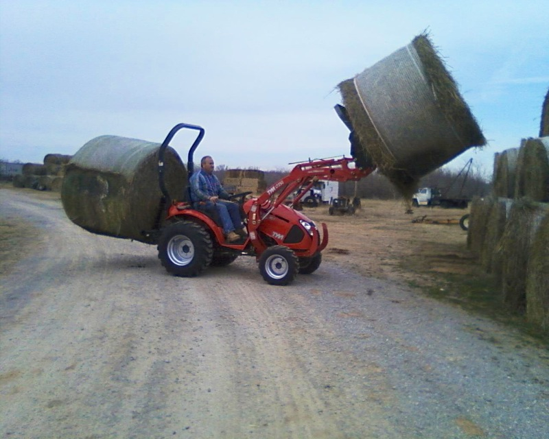

I'm 99% sure the TYM T273 with TL200 loader comes standard with skid steer quick attach. (my local dealer only sells the large TYM)
   / New here - Should I care about written specs? #17
edit: TYM T293 with TL250 pictured, sorry
