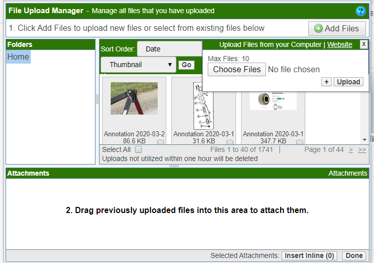

When replying look at lower RH corner of page for box labeled "go advanced",click on that box then click on box labeled "manage attachments" a larger box will appear then just follow instructions. Photos I upload must be saved to my computer. If you're accessing TBN by cell phone my info may be incorrect.
Good Luck,Jim
