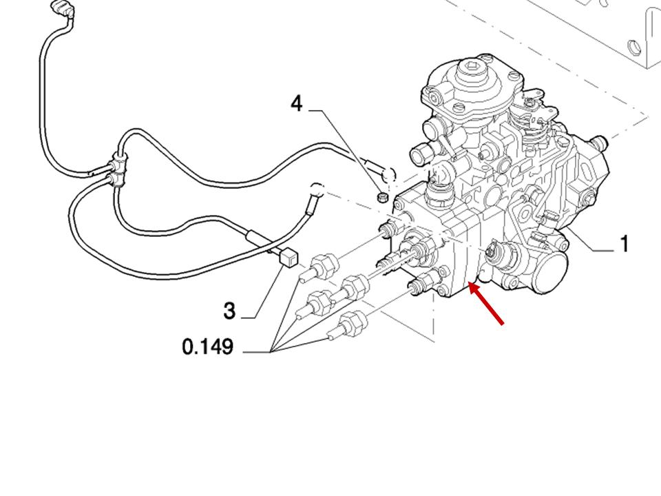

EDIT: I posted about the fuel leak in another thread. My LB75 had to go back to the dealer for a repair because it was leaking fuel. They picked it up last Monday.
I spoke with the dealership yesterday about my LB75 fuel leak. They have ordered a seal kit and will install it when it comes in. I expect to have it back early next week. I've attached an illustration of the pump with an arrow pointing to the manifold head where fuel was dripping at a rate of 1 drop per second.

Jim,
While they have it, ask them to blow out all your lines. Clean out your sediment bowl and if the filters are old, change them too.
Mine is a lot older then yours, 1998, and I'm sure that it's not an issue for you, but I had all sorts of small, tiny rocks in my line. They were probably realy pieces of rust, but they looked like tiny rocks when I finally figured out why I was loosing power. Sediment bowl was filled up, which is embarrasing to admit, but something that I overlooked in my maintenence routine. I cleaned out my hoses one at a time and found one to be almost full. It was all before the filter, and I the change was dramatic after doing this, so I'm thinking I'm ok. It's been a couple of years and I'm on top of it now.

Thanks Eddie. They already put in a new fuel filter and I can't find a sediment bowl separate from that filter. What I'm thrilled about is the fuel filter, engine oil filter, air filter and other engine components are so open and easily accessible on this tractor. I lift the loader up and lock the loader arm safety support in place and remove the large side covers for total access. I can even reach under the left side of the engine and remove the oil drain plug without having to crawl under the tractor.:thumbsup:

Jim,
There is a sediment bowl on mine as part of the fuel pump. It's glass and you can look at it and see the fuel in there, all nice and clean. In time, it turnd dark and then gets nasty loooking. I never looked and let mine get full of junk.
