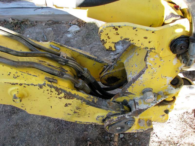

Well, the first "me induced" casualty occured yesterday. Actually, it wasn't so much me as the age of the hoses. The hoses to the dipper and bucket are exposed just below the boom pivot. I guess over the years, the hoses get dragged on all kinds of things as people crowd up against piles and back into things. Anyway, when I went to move the tractor yesterday using the backhoe to pull it backwards a couple of feet. I noticed a condensation spray in that area. It turns out that the line going to the backhoe bucket curl side of the cylinder suddenly developed a pressure leak and is spraying about 1' down from the fitting where it attaches to rigid pipe. I'll try to get some pictures today as I remove the hose. It's about 5' long and goes under the bachoe boom and through the middle of the pivot to the joystick control valve. I think I can remove a cowling off the back of the platform for better access to the valve for removing the hose. If the dealer can't make a hose on-site, it can be ordered from NH for somewhere between $75-$100. I'll look at the others and may decide to get a spare to have ready because I think this is just the first of several in this area.

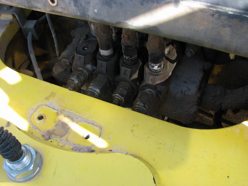

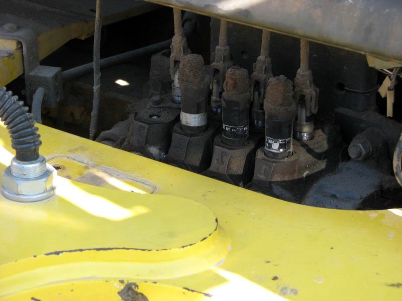

The busted hose is replaced and I'm back in business. Once I got wrenches to take the fittings off (38 mm open end or 1-1/2") I was able to remove the hose and take it to the dealer. The NH part number is stamped right on the crimped portion of the fitting and my dealer had one in stock. The parts guy told me that they try to keep a full set of TLB hoses in stock, so I can call ahead anytime and they will check before I drive 20 miles on a hunch that they might have the part. They don't make these particular hoses onsite because the fittings are pretty darn big. Anyhow, the hose was a bit over $79, but I was happy to pay that to be back in business.
Here are some photos of the old hose as I removed it. It has a clamp on the rigid tubing on the boom and then another clamp behind the boom for stress relief and make sure the hoses bend as the boom lifts. The hoses go through the swing pivot too, requiring another clamp before they get to the control valve. Trying to stuff a new hose through all these tight places and then get it bent so I could put the fittings together was a hassle, but at least it was doable for a fat ol' retired guy.:rolleyes: Thank goodness for ORFS fittings. They are the cat's meow. They get snug, you seat them, and they don't leak a drop. Woohoo!:D
