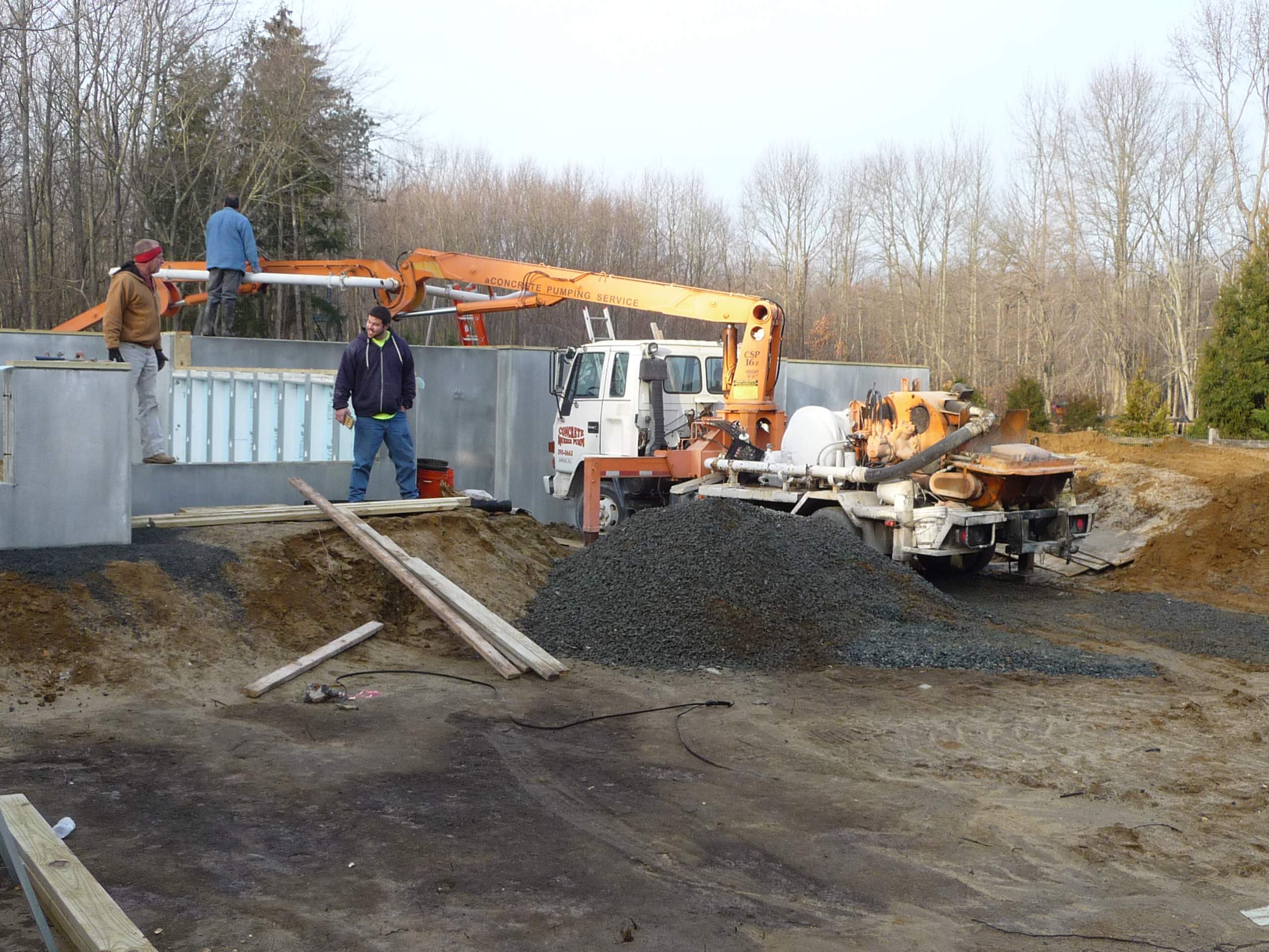

:hissyfit: One more day without a dang concrete truck showing up. The ramp created to let the trucks come up high enough to make it over the 9' walls settled too much in the rain last week while I was away and the front edge collapsed in the freeze/thaw cycles. No concrete today. They will do it tomorrow with a pump.

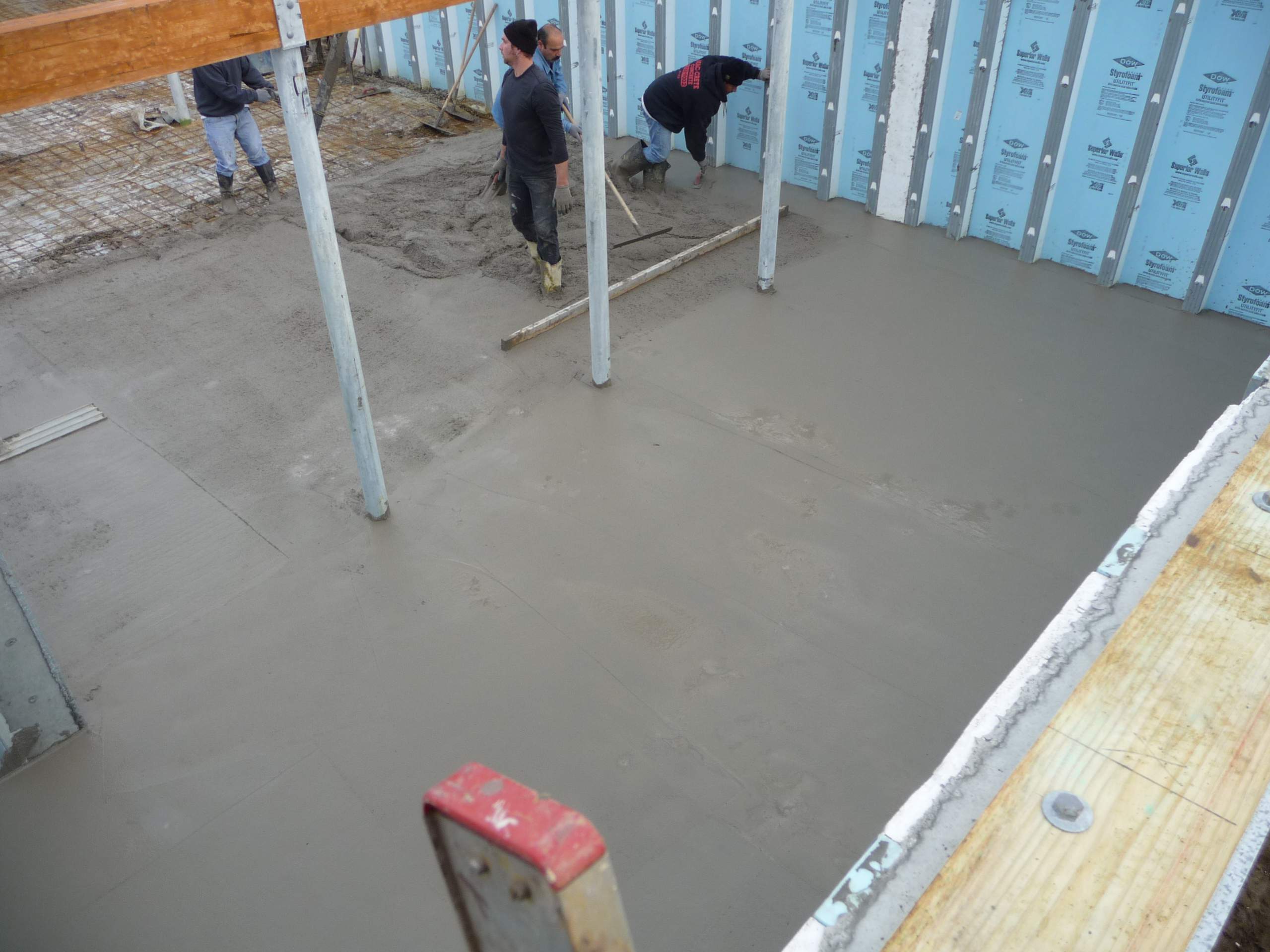

The basement slab is in and the framers will start tomorrow!!

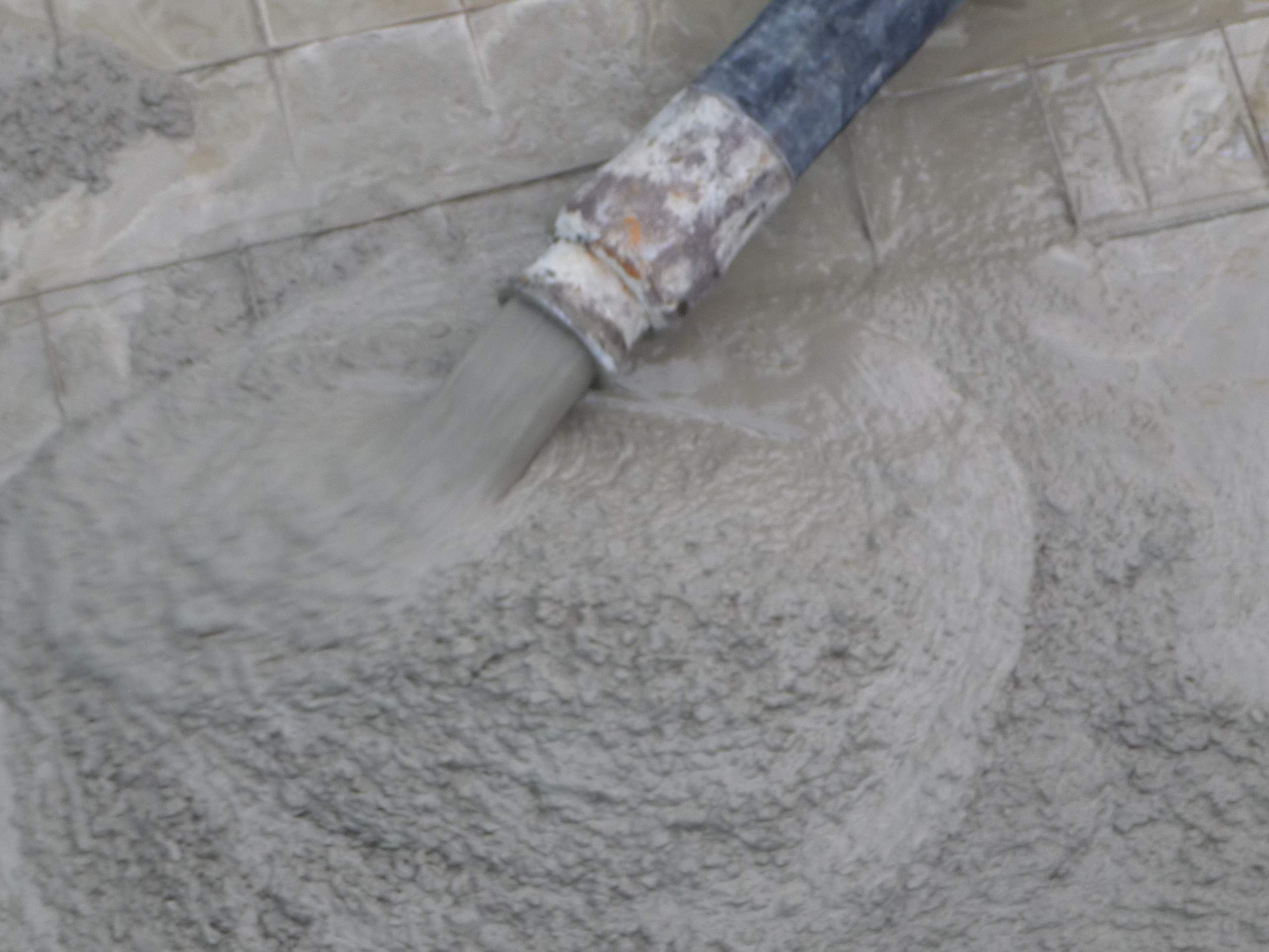

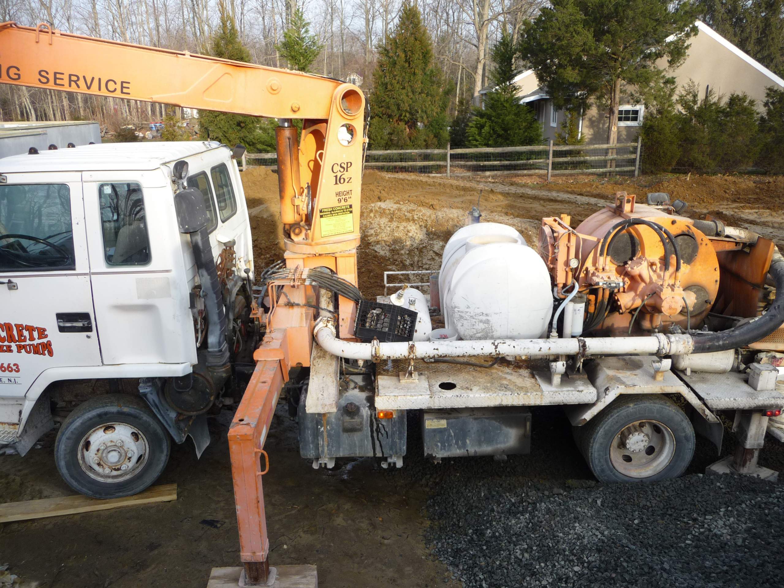

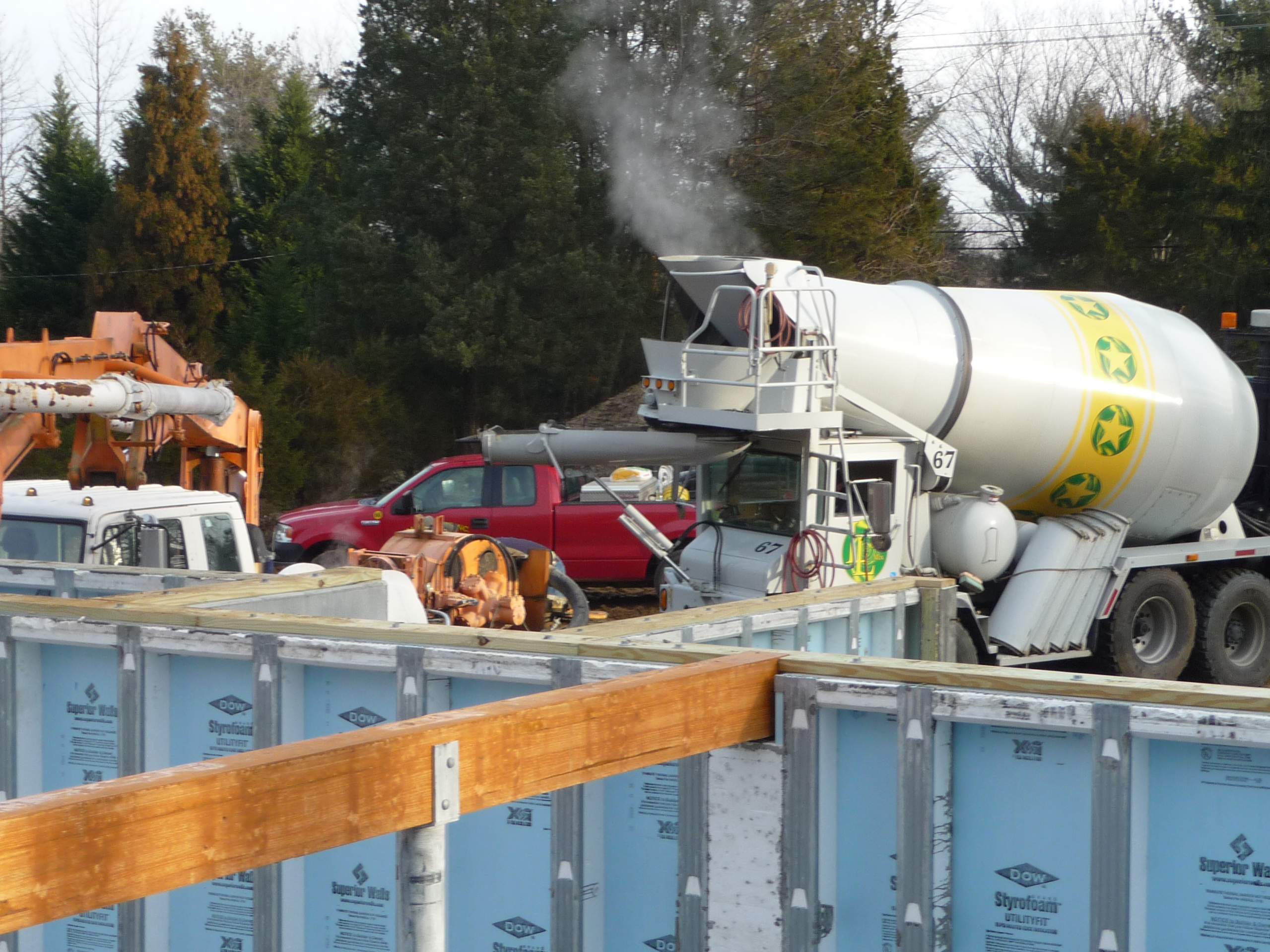

This was the small concrete pump ... 1/2 the price of the big ones and really easy to maneuver. The weather is expected to be in the upper 40s to near 50 for the next few days and lows in the mid 30s. Calcium was added to the mix also.

Thanks for sharing the pictures. That slump is VERY wet and the wire is on the ground. I'm at a loss as to what is going on here.
Eddie
   / New Home Begins
#268
Eddie
Eddie,
The picture of the flow was at the very beginning when the pump was still pushing out the priming. It was thicker as they went along. Yes, they pulled the wire up into the middle but you are correct, it's really easy to walk on it, pushing it down so I am sure that some of it is not in the ideal position. They screeded, pull it up, bullfloat and moved to next section.
The pump also needs smaller aggregate than would be typical.

Yes, its a little too soon to give MY opinion, however; the framers love how dead level it was as well as the bolt holes for securing the mud sill are all pre-drilled. They just drill the end of a sill plate, bolt that one in place, then drill all middle holes and attach in rapid fashion.
On the down side, since you can't backfill without the slab AND subfloor in place, then you need to make accommodations when the top of wall is above the reach of the concrete truck like I had. Either a ramp that is high enough and close enough or a pump.

I've never seen that small of a pump truck before.
