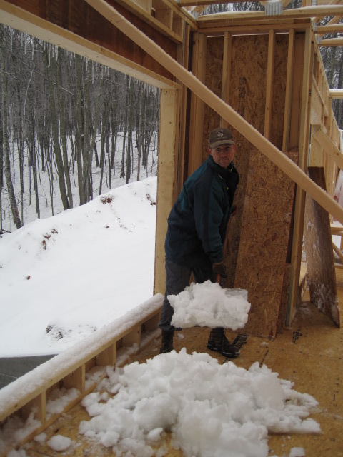

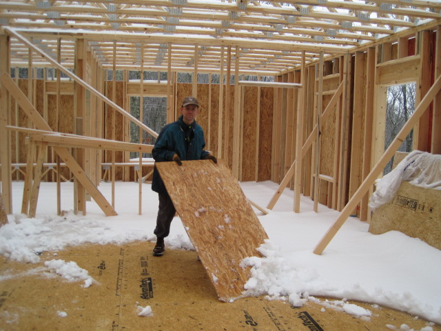

The basement slab is in and the framers will start tomorrow!!
This was the small concrete pump ... 1/2 the price of the big ones and really easy to maneuver. The weather is expected to be in the upper 40s to near 50 for the next few days and lows in the mid 30s. Calcium was added to the mix also.
Tom,
These temps are ideal for concrete. As close to freezing as possible but without freezing lets the concrete dry slowly which results in strong concrete.
I know you are glad to see some progress.
We framed our house during the winter, something I said I would not do. However, you do what you have to do. Our build worked out ok, even though that year we had one of the hardest winters our area had seen for 20 years.
