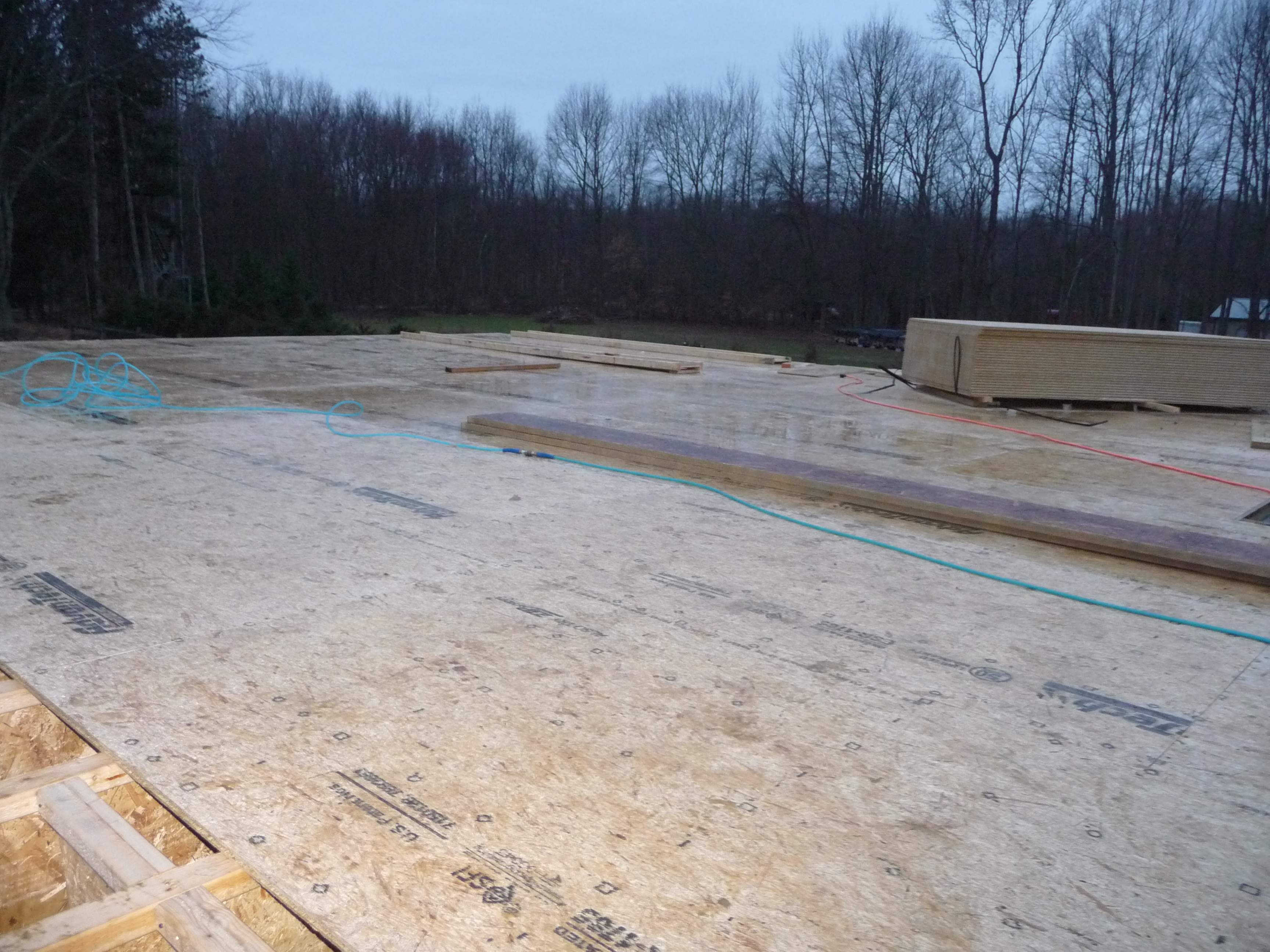

#277

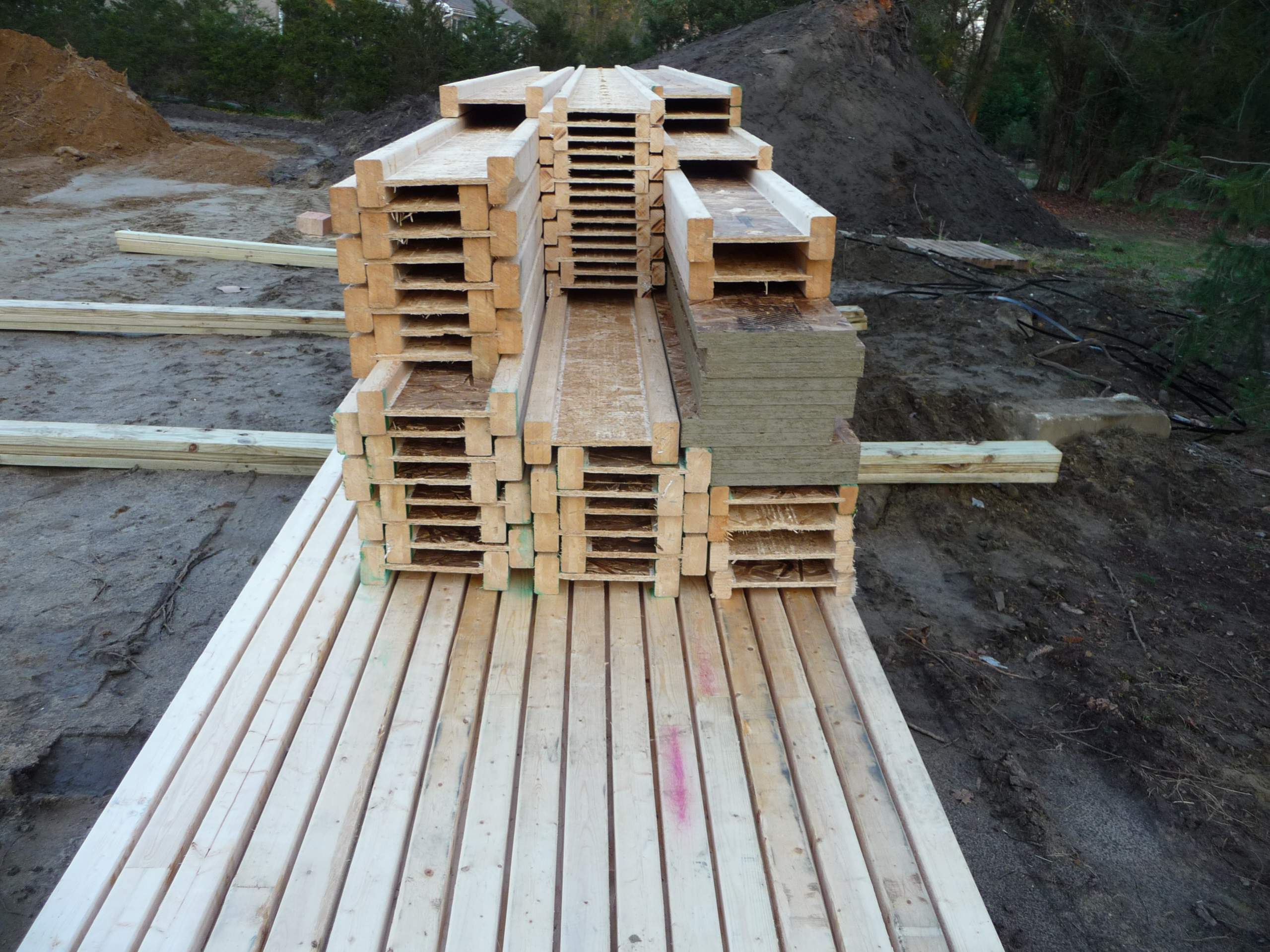

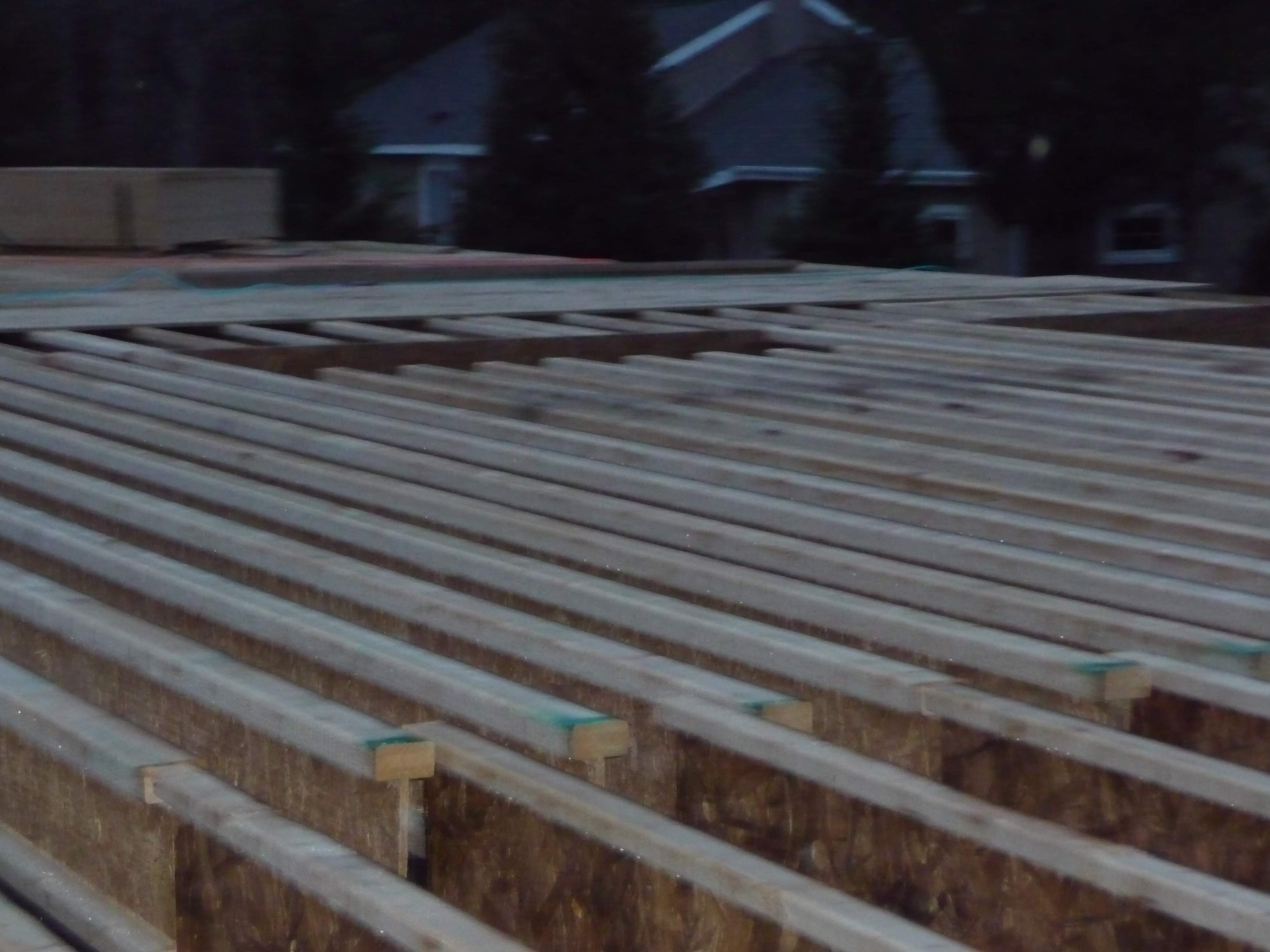

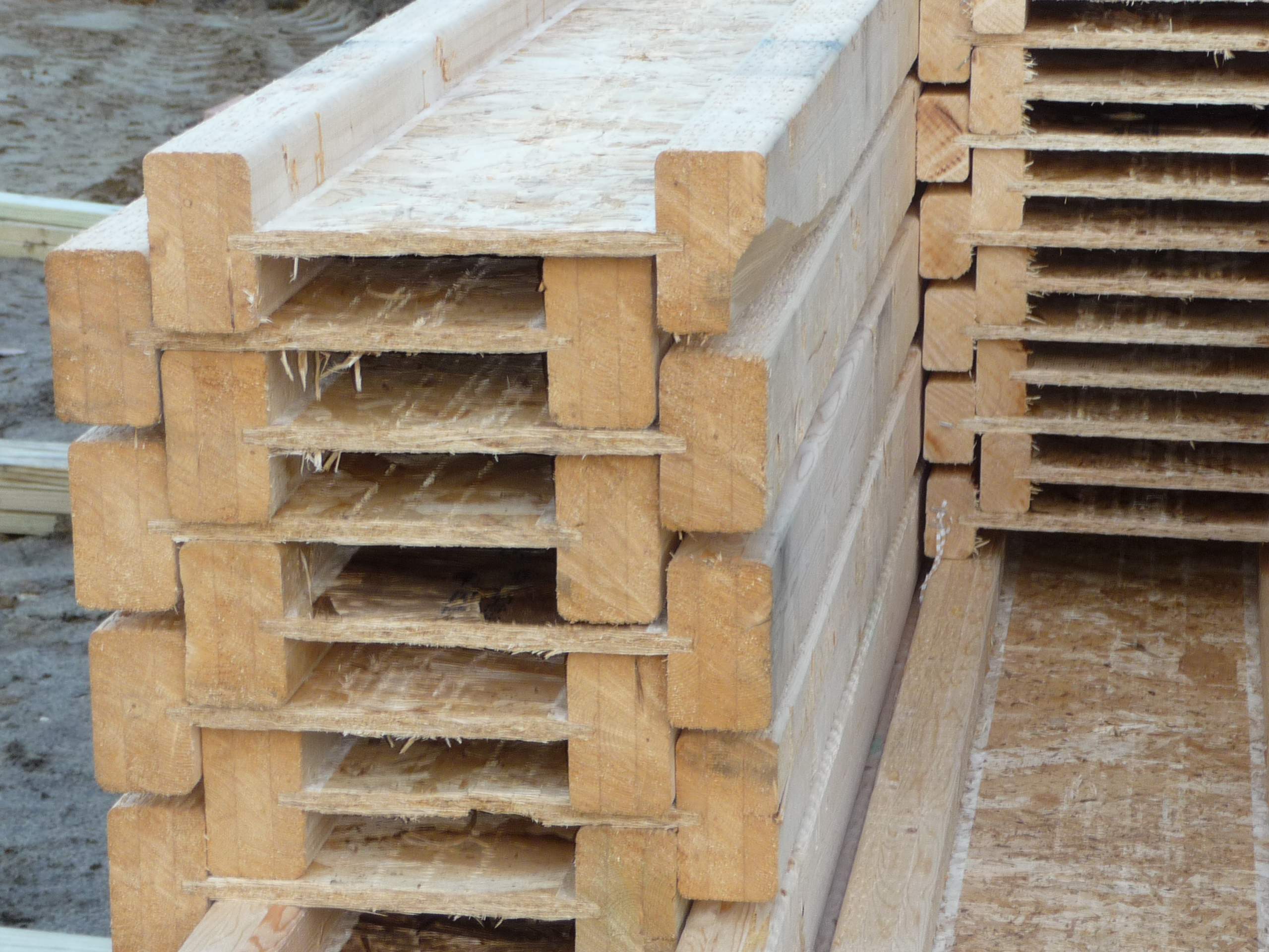

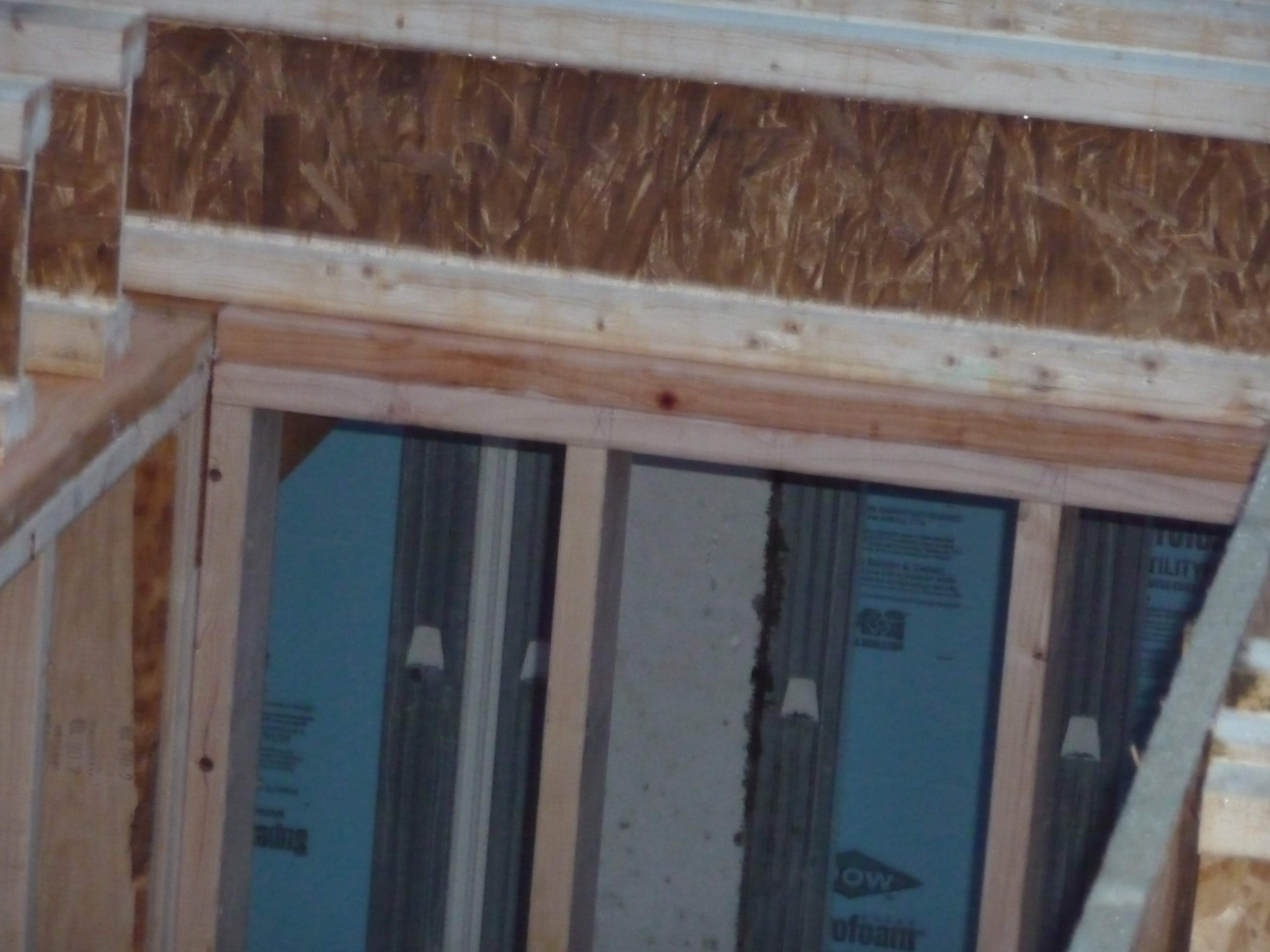

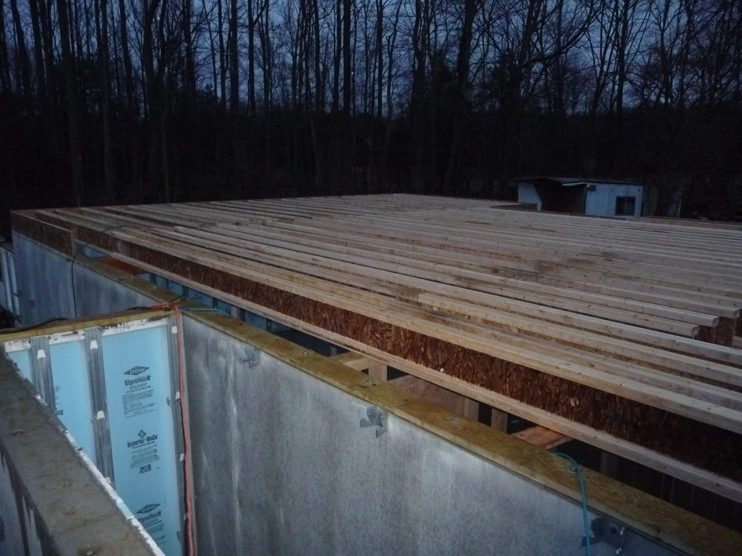

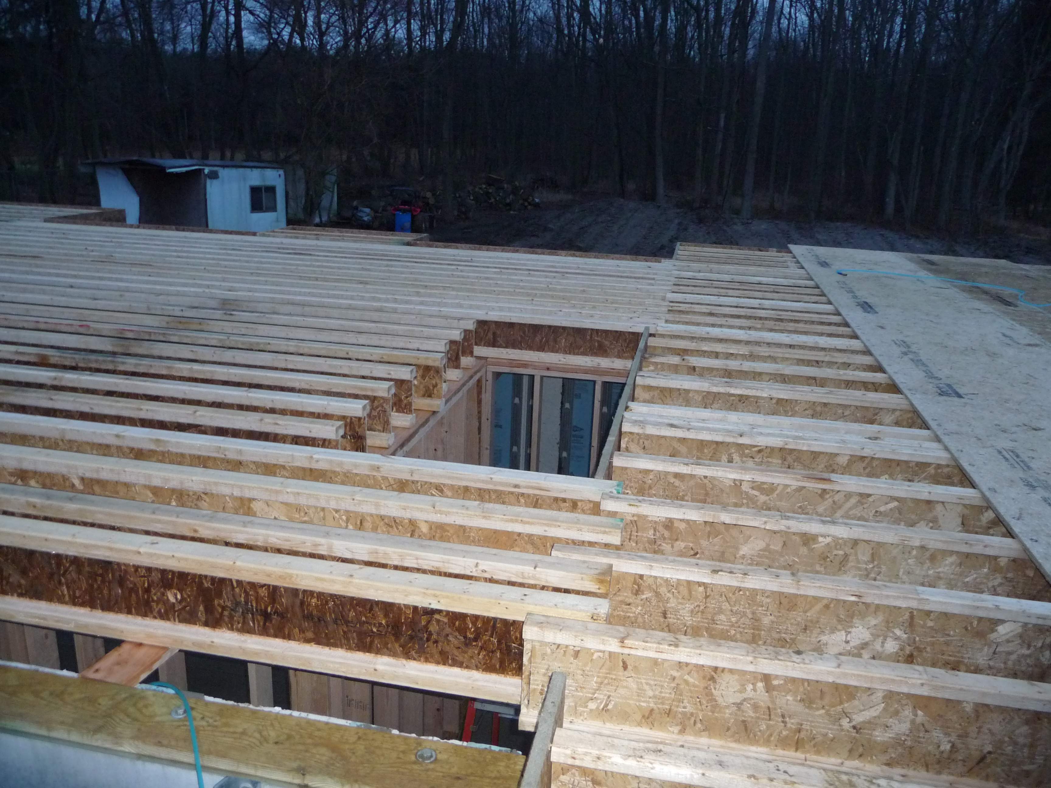

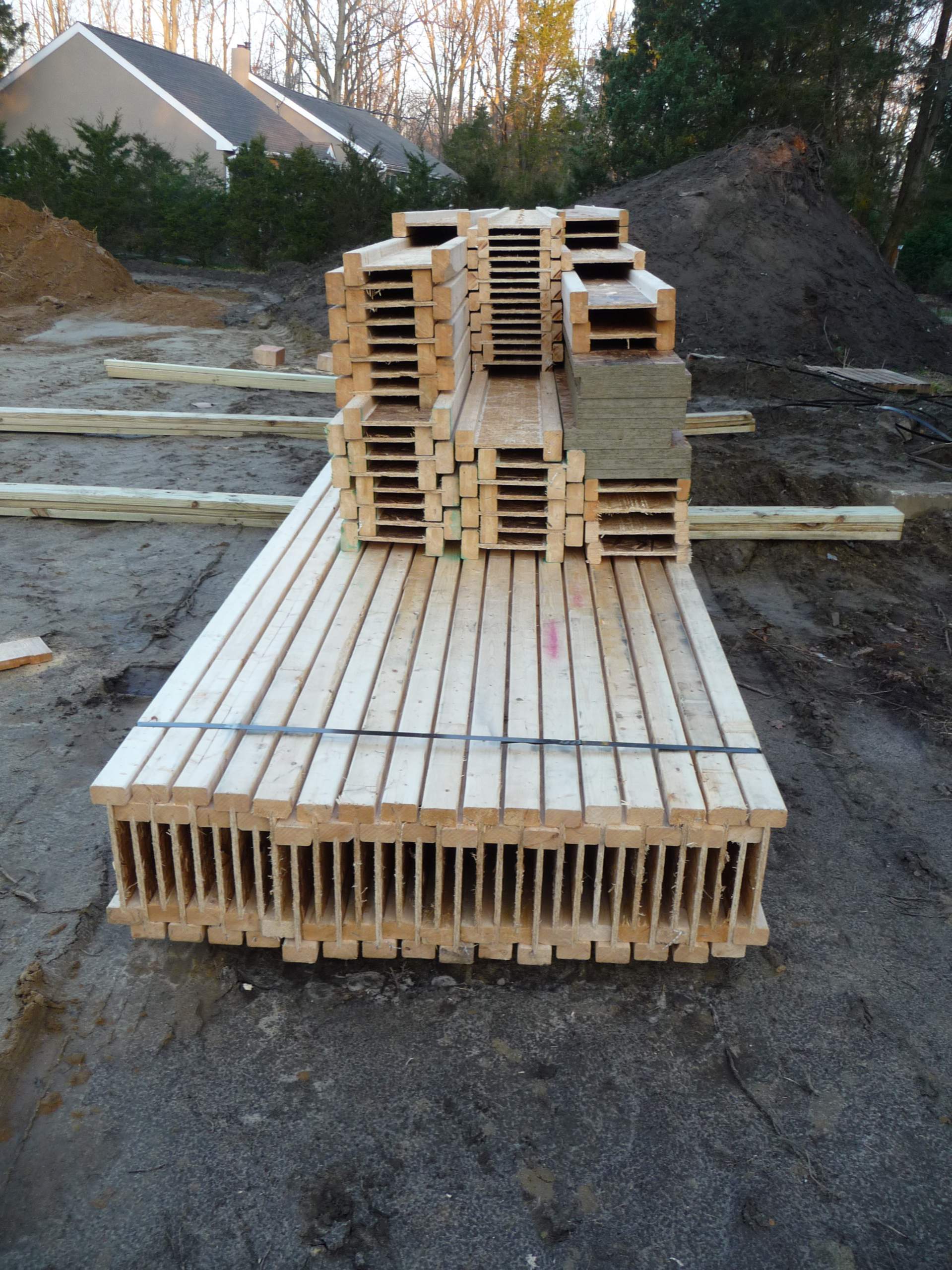

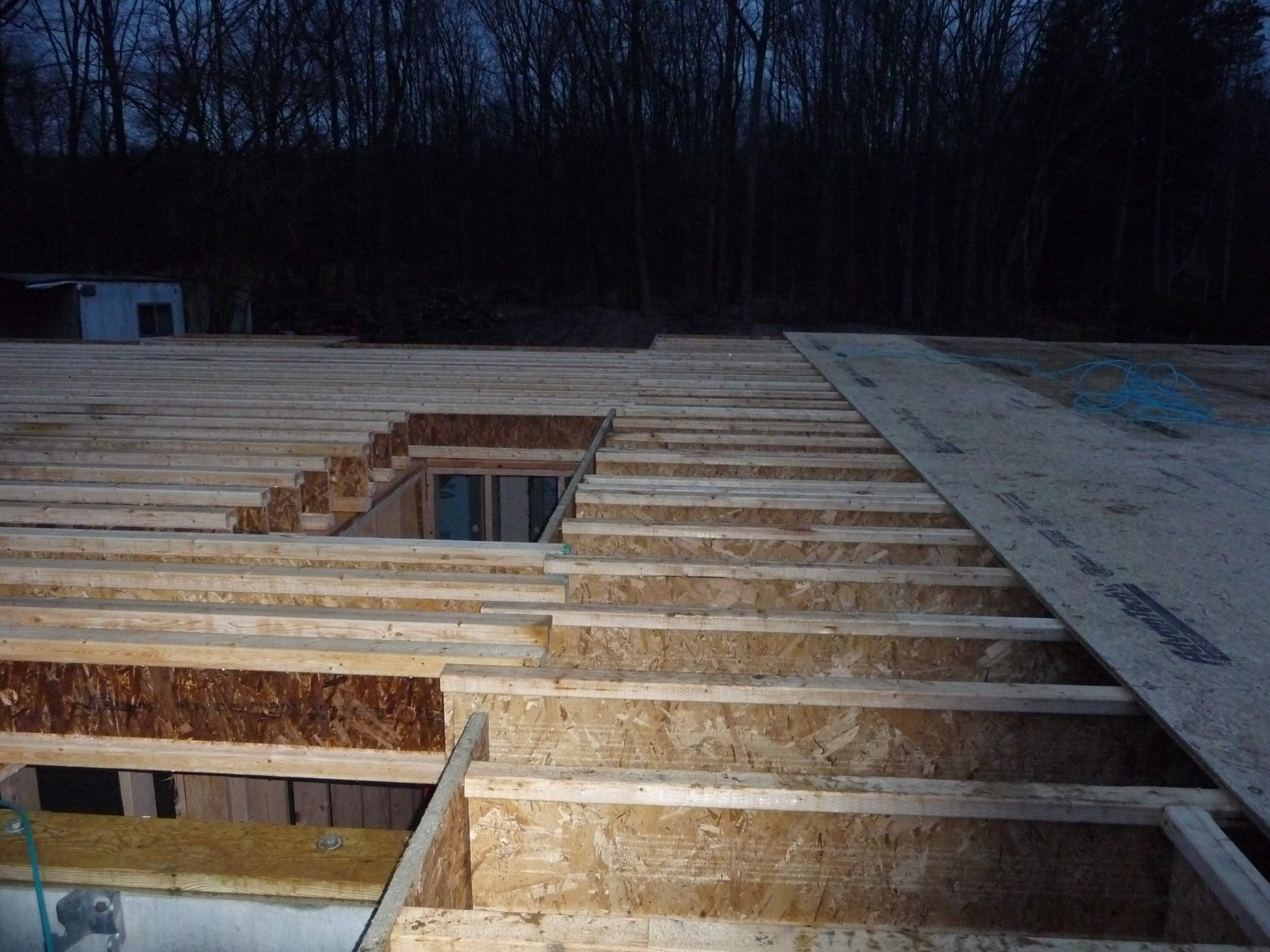

Yesterday's progress. All I-Joists are in and blocking was put in today. The subfloor will be done on Monday and walls will begin, weather permitting. We had lots of rain last night so more pumping. but not as bad as before. Backfilling begins tomorrow at least to make water shed away from the foundation.

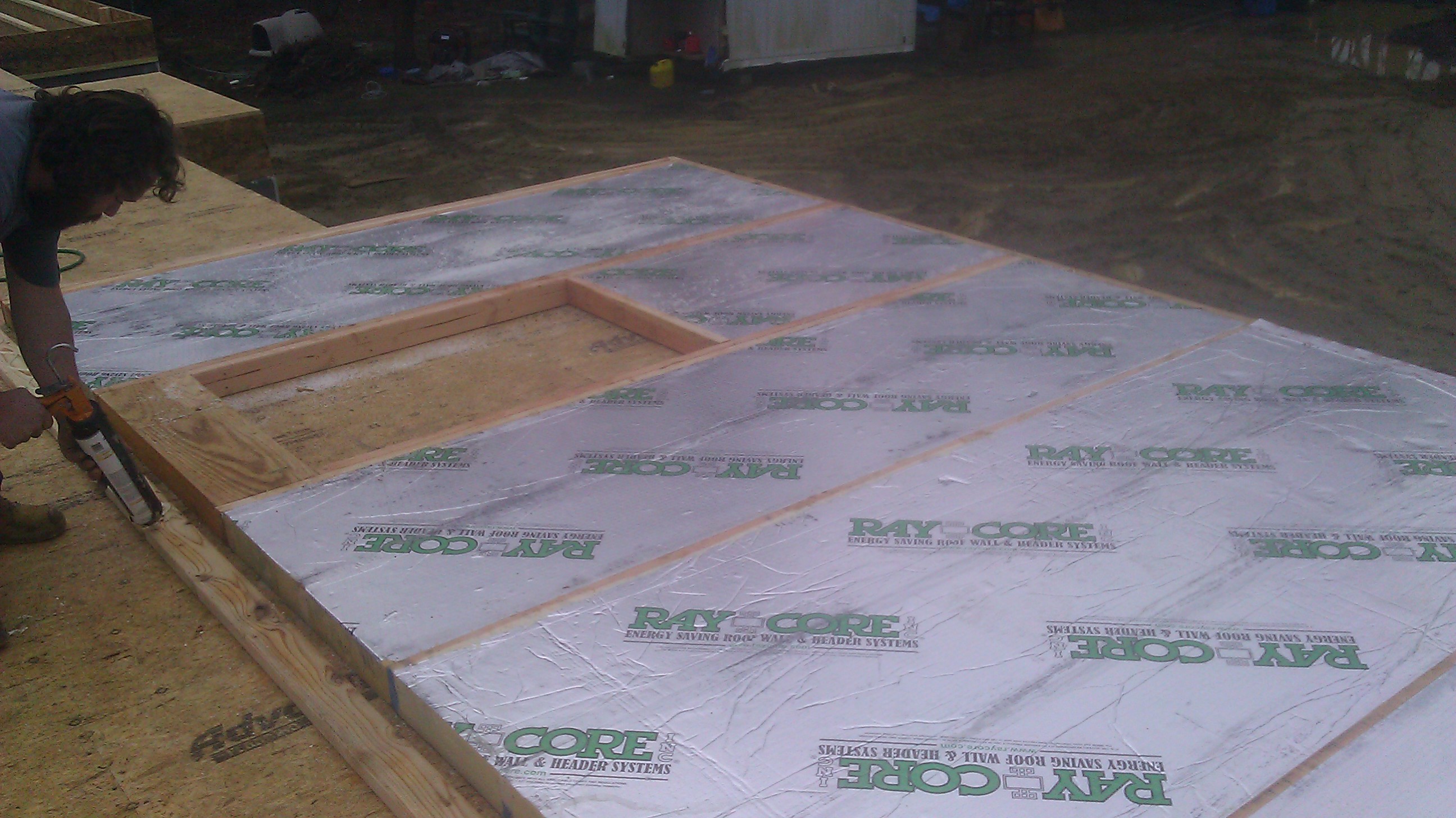

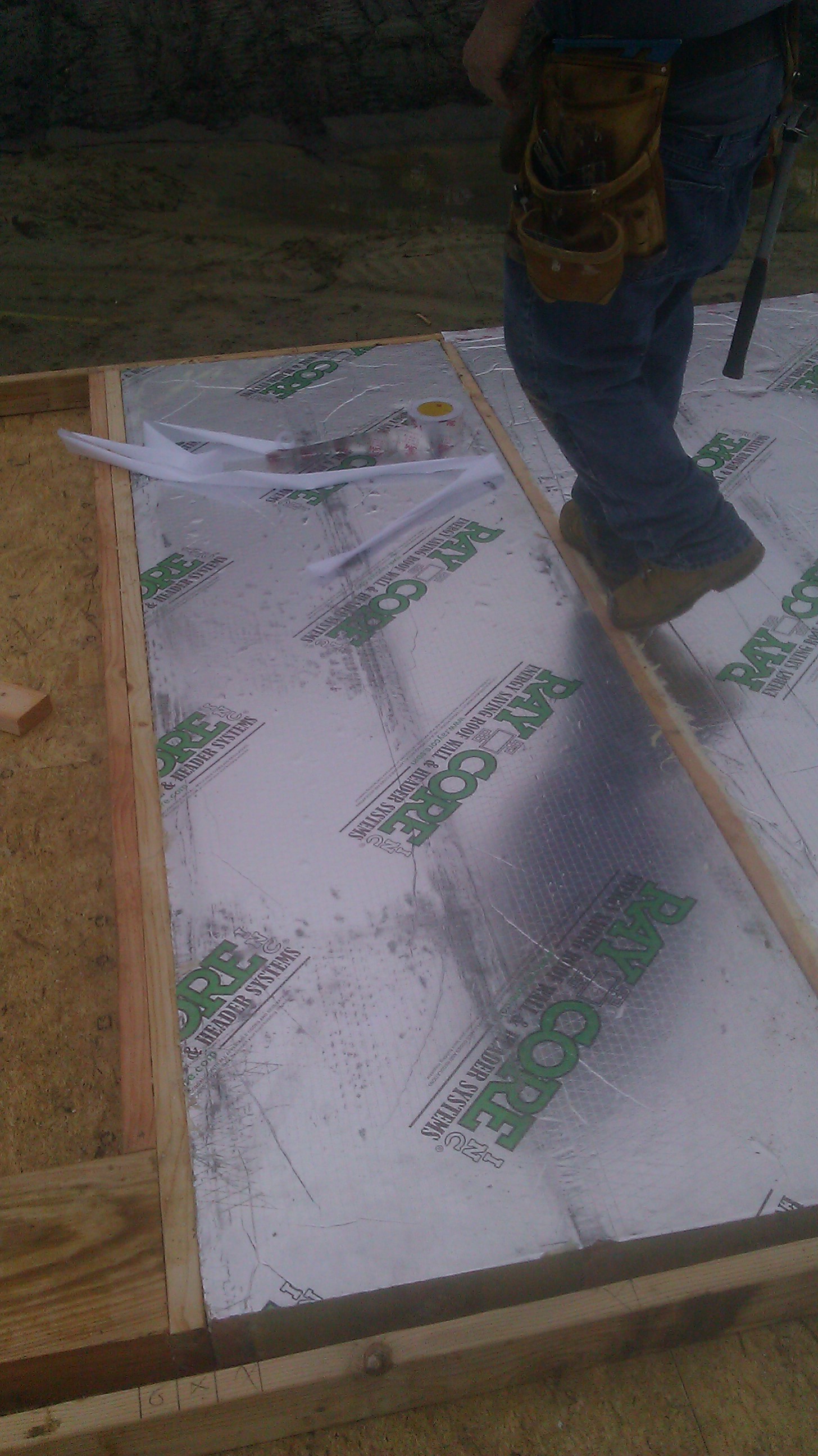

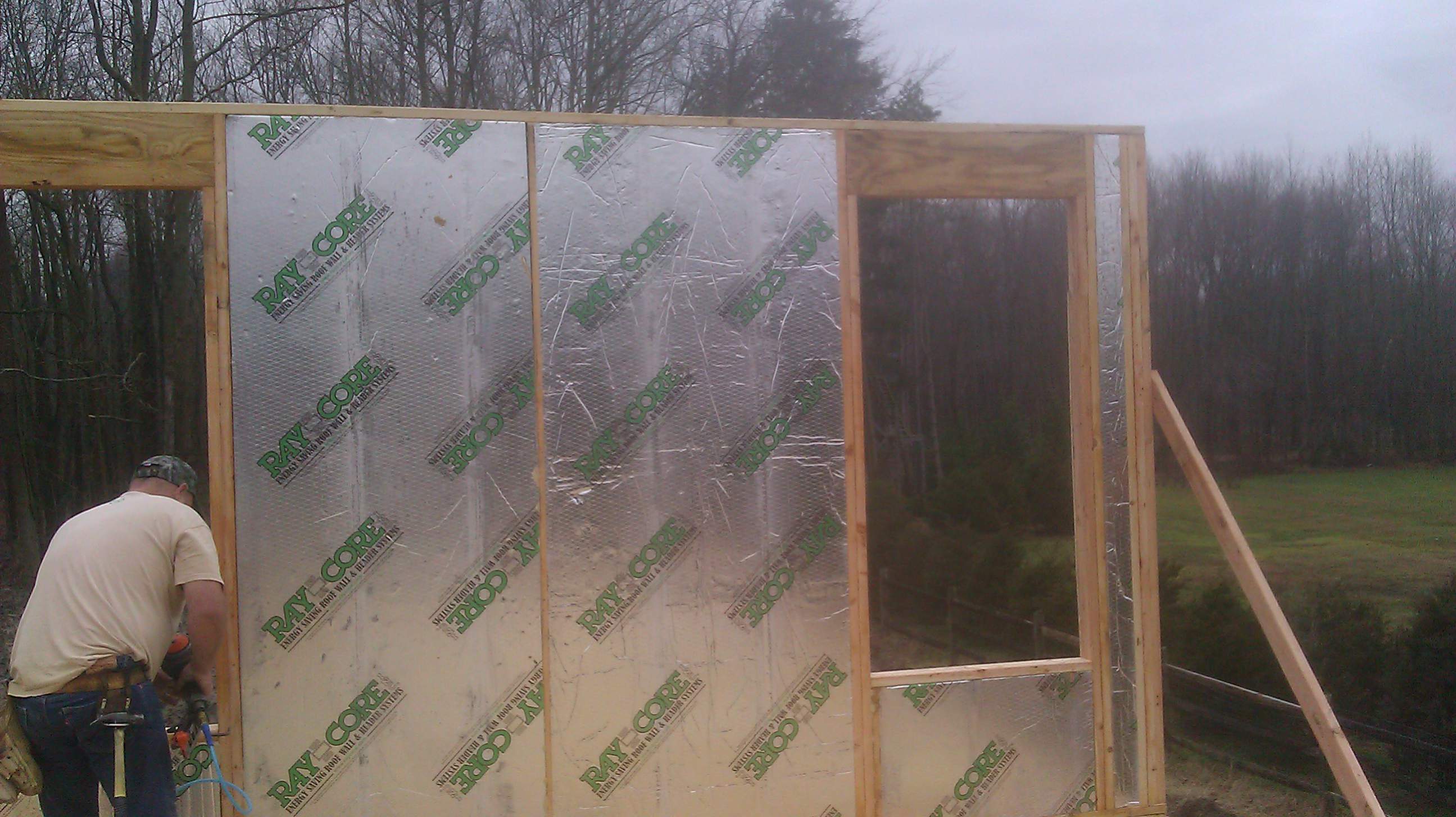

The wall panels are standard 2x4 thickness and 4' x 104 5/8" for a 9' ceiling and have an R26 insulation value. The ceiling panels for over the great room, since they will be ABOVE the 1x6 T&G, are 2x6 thickness and are 4' x 8' and have an R42 (IIRC) rating. They are secured to the 6" x 12" (true, not dimensional) rafters with 8" timberlok screws, 9 per panel.
The cost for wall panels are $4.10 /sf and the roof panels are $5.79 /sf. They run an April "discount" that brings them down to $3.49 and $4.98 respectively. The discount took a chunk out of the shipping cost from Idaho to NJ
They definitely added to the up front cost but spray foam insulation is not cheap either, so there is a cost offset also. We felt that in the long run, we will make up the difference in a few years if not 2-3 years, maybe sooner.
One thing I am a little concerned about is that the foil facing for all of my exterior walls could affect cell service and will not have a landline. I may have to add a cell phone antenna in the attic and feed the house from it.

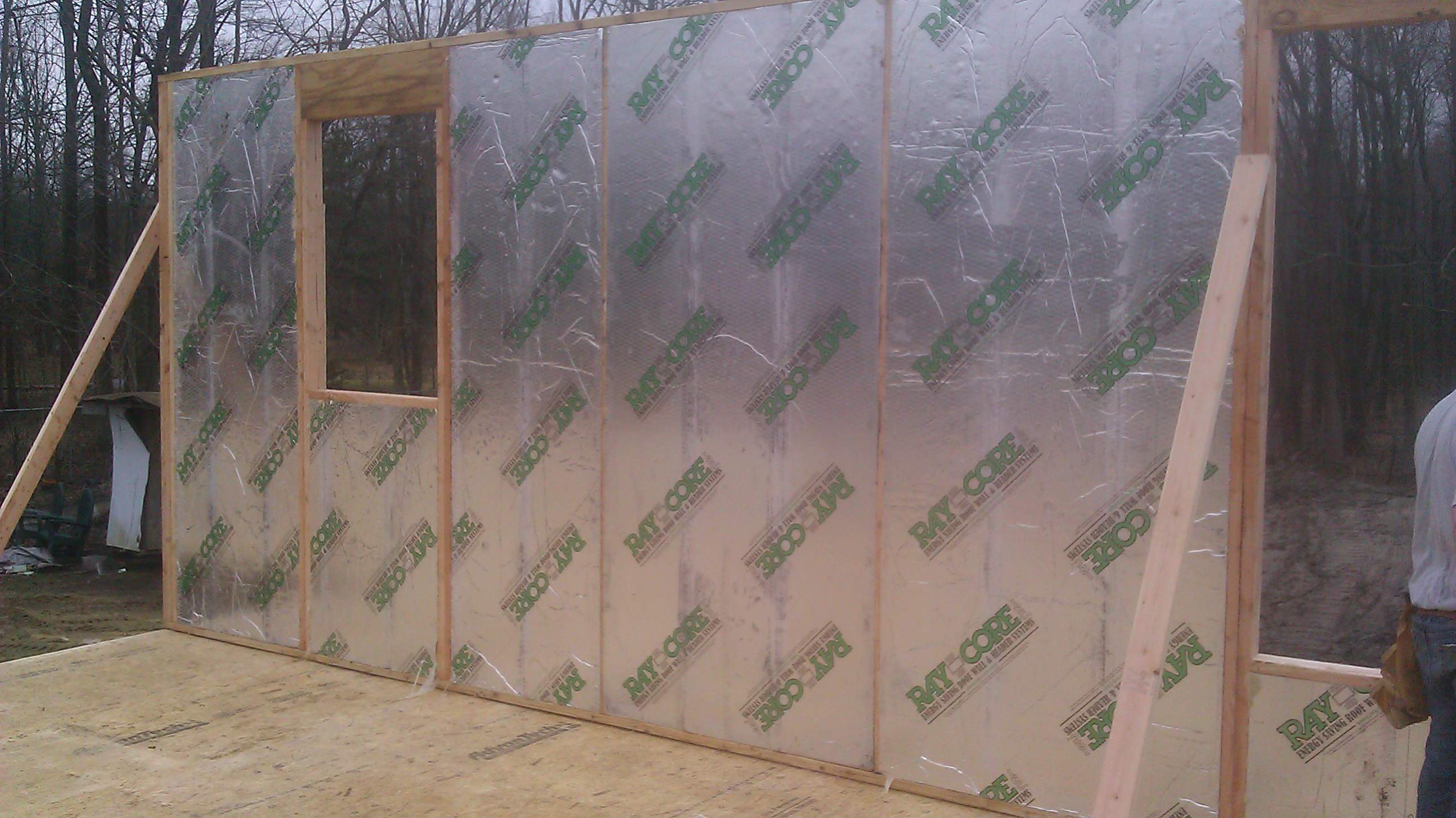

#280

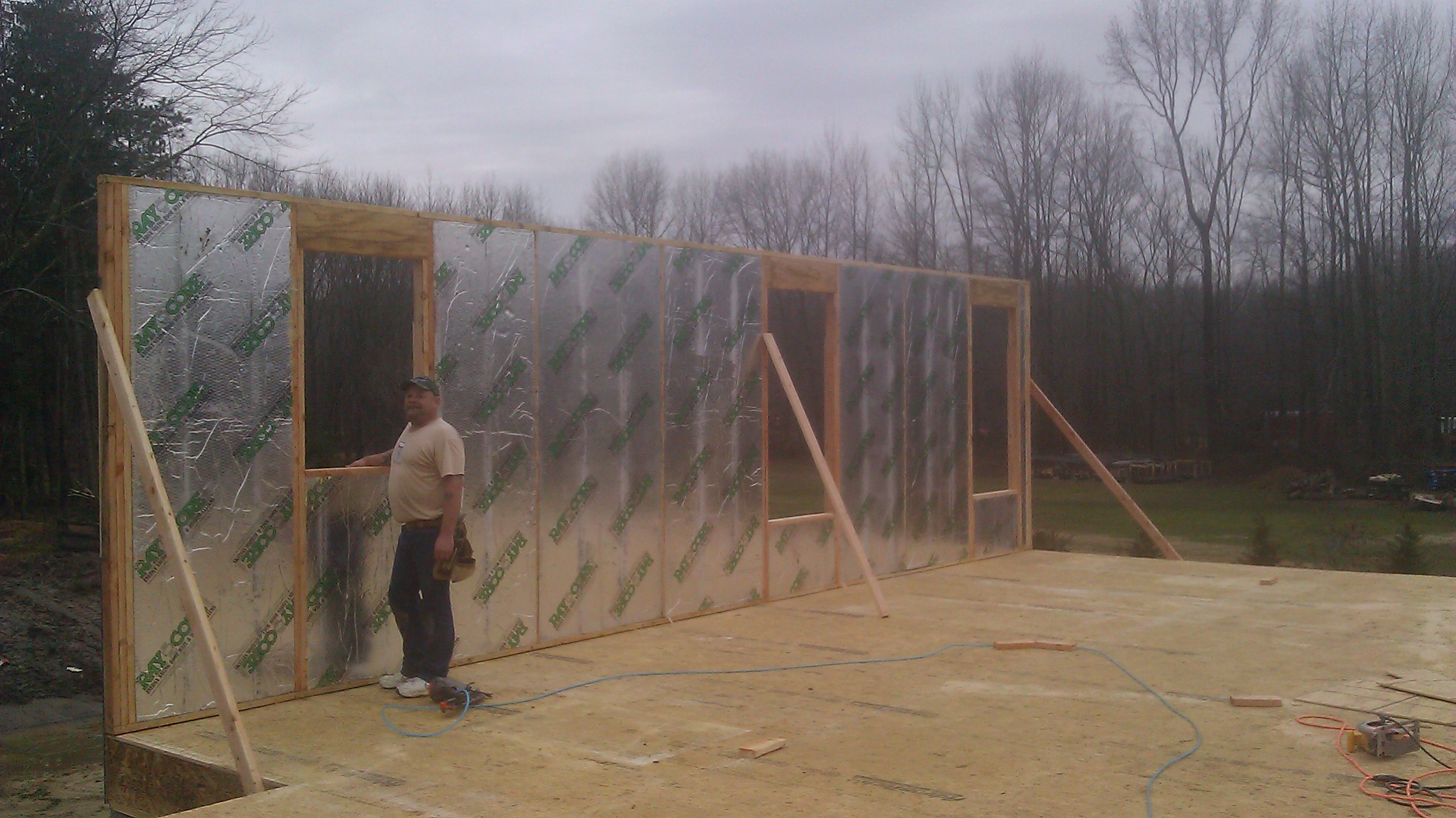

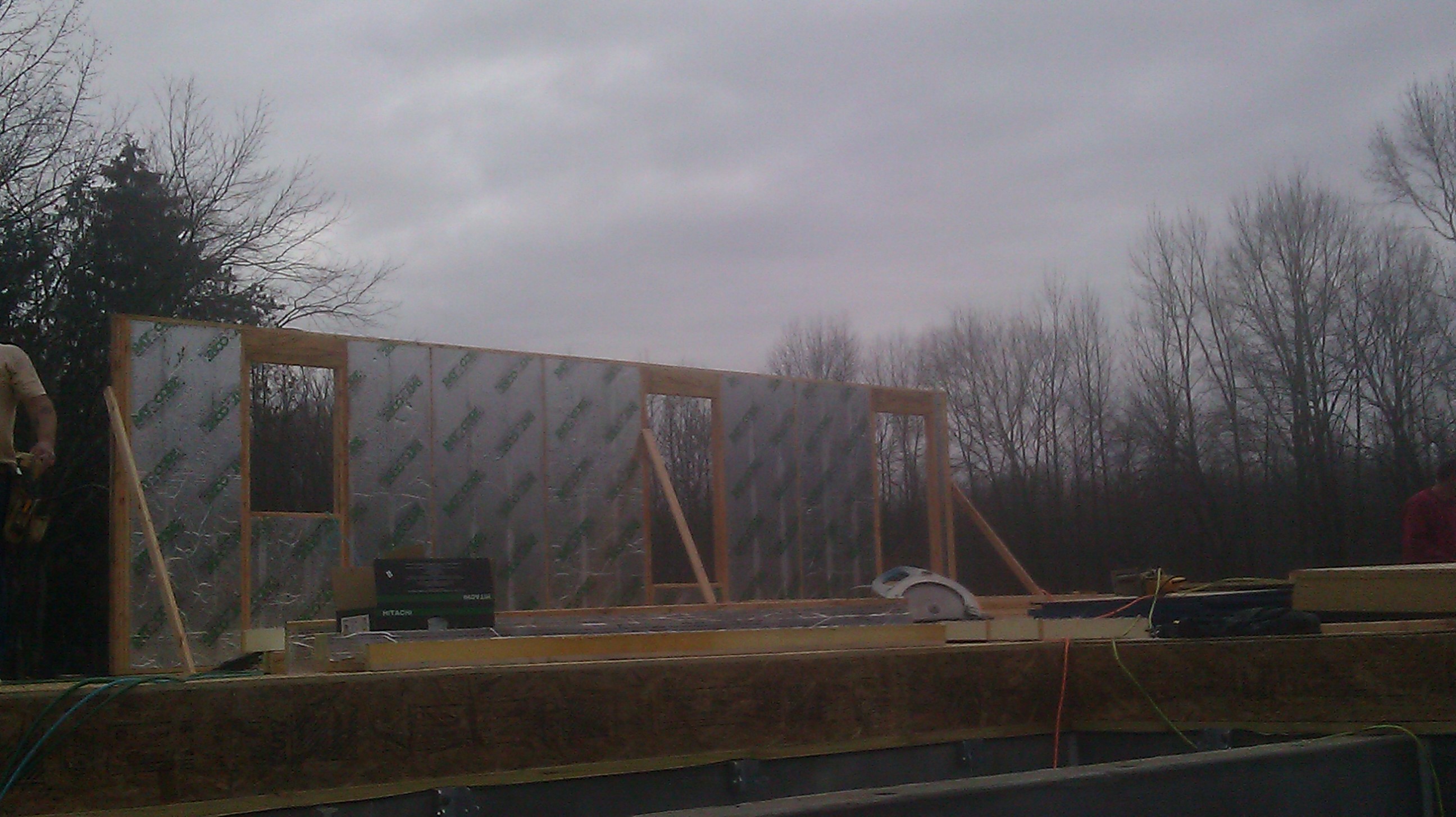

Day one of three days of rain prediction. So far, no rain. :thumbsup:

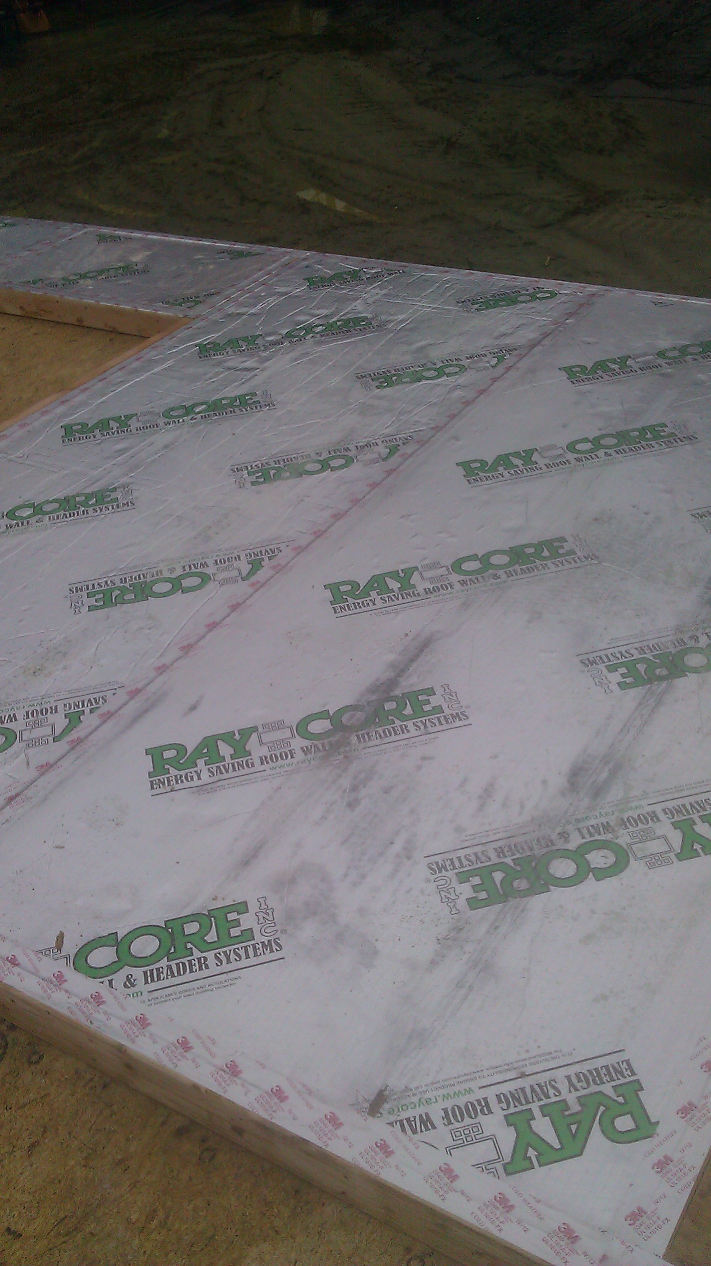

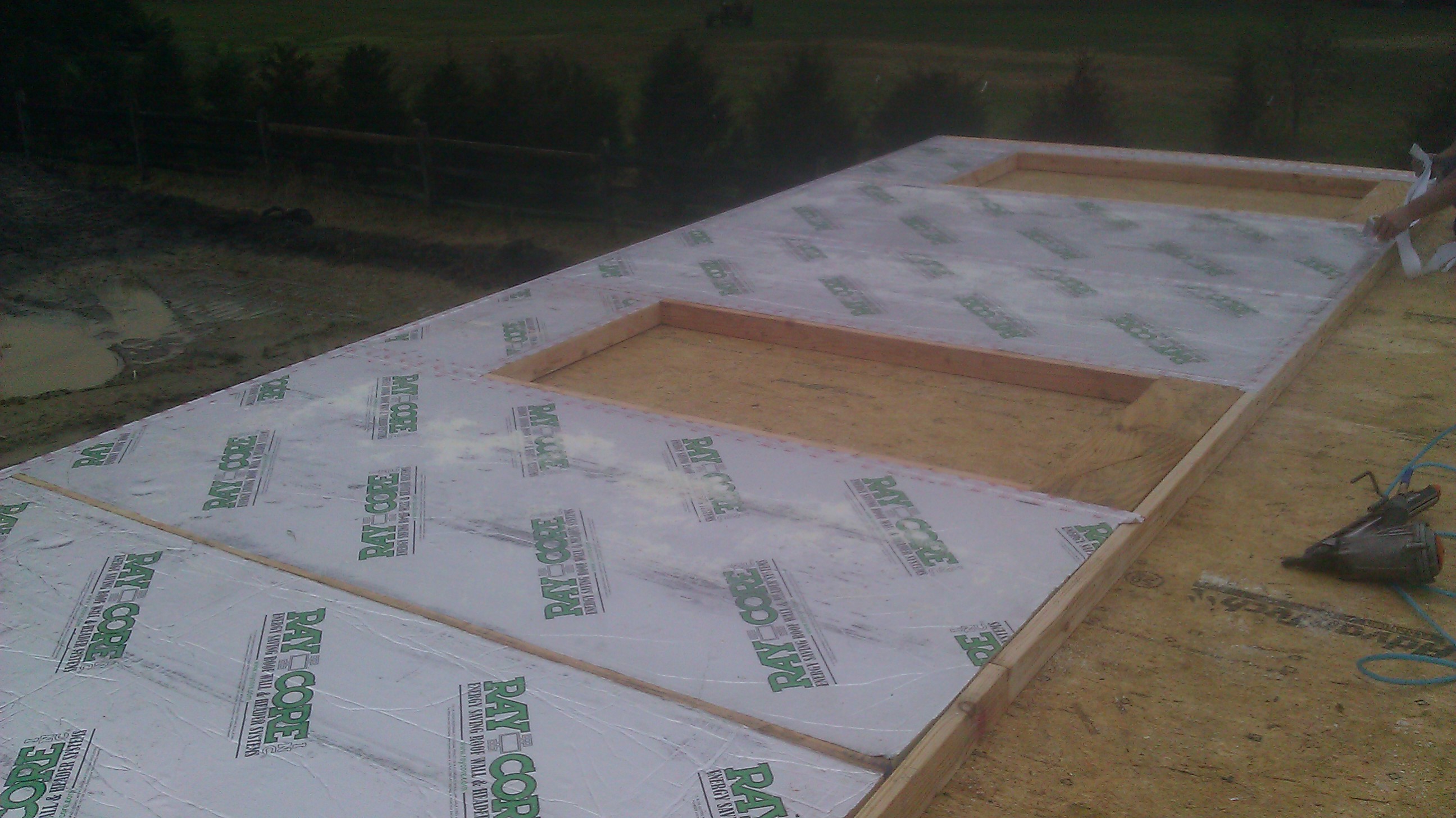

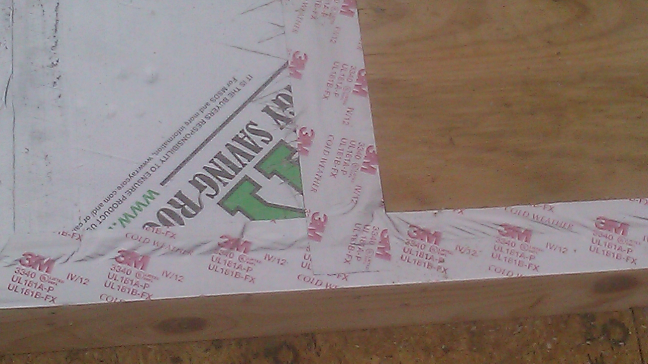

Framers are starting on the walls. While they have never worked with the panels before, they are following the instructions to the letter. The panels are glued to all traditional jacks around windows. All seams are also taped with foil tape. The first wall took a little longer but they now have a rhythm going and it will most likely be faster.
The added weight of the foam is not so great as to prevent them from lifting a 30' wall without assistance.
More pictures to come, these were low quality from my phone this morning.
