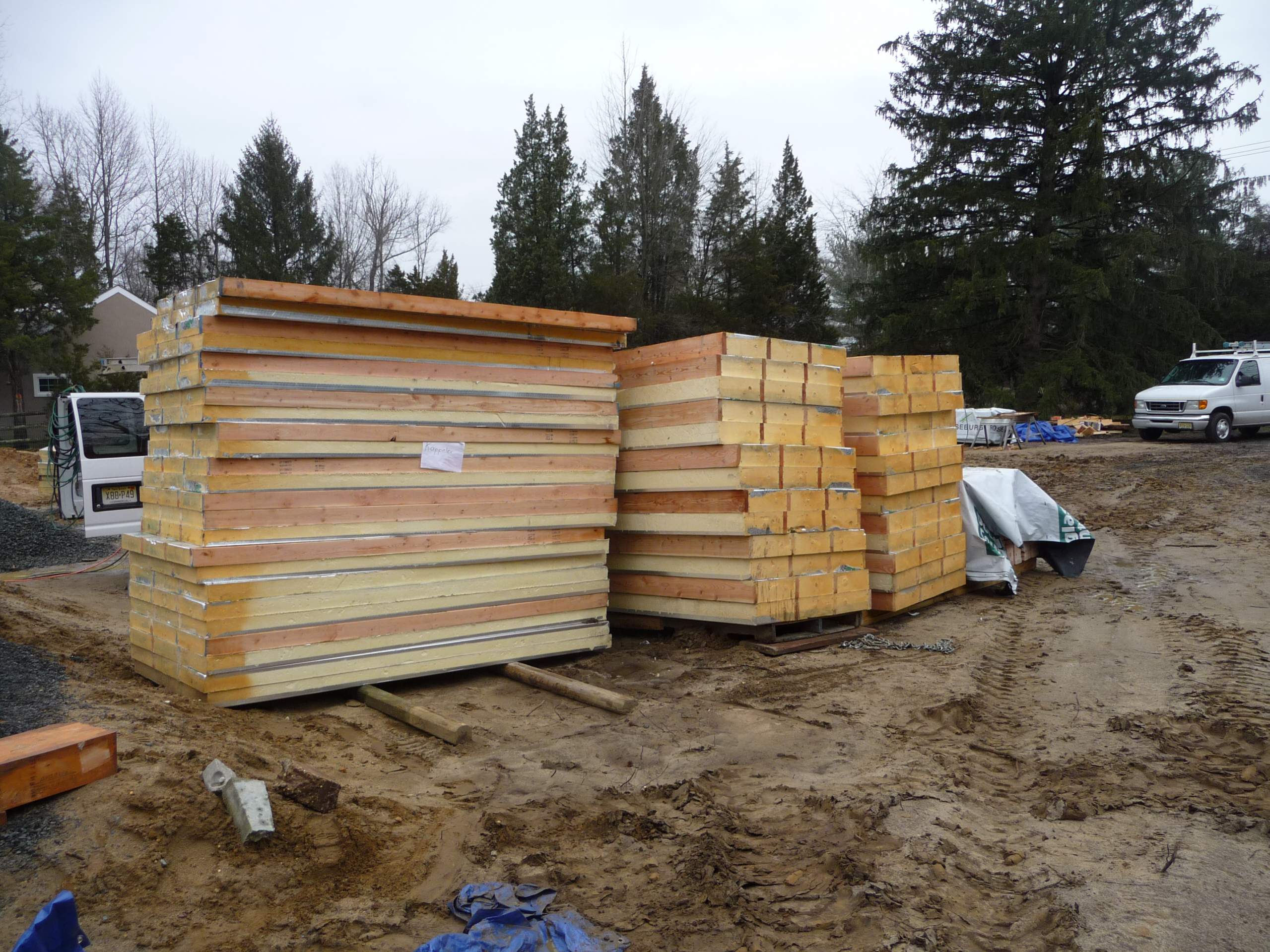

I'll be looking at the Ray-Core website. Although batt insulation is better than nothing; it is too easy to do a sloppy job installing the stuff and thereby defeat the purpose of insulation.
   / New Home Begins #293
I did a very quick calculation on the back of a napkin for a 2x6 wall with fiberglass bat (R-18) versus 2x4 Raycore panels (R-25). The 2x6 wall was a little bit less than $2 a square foot for 5.5 inches of fiberglass batt insulation (R-18). To get to about R-25 takes 2 inches of closed cell spray foam plus 3.5 inches of fiber glass batt for a little less than $4 a square foot. This puts the Raycore panels at a competitive price for the same R value of insulation.

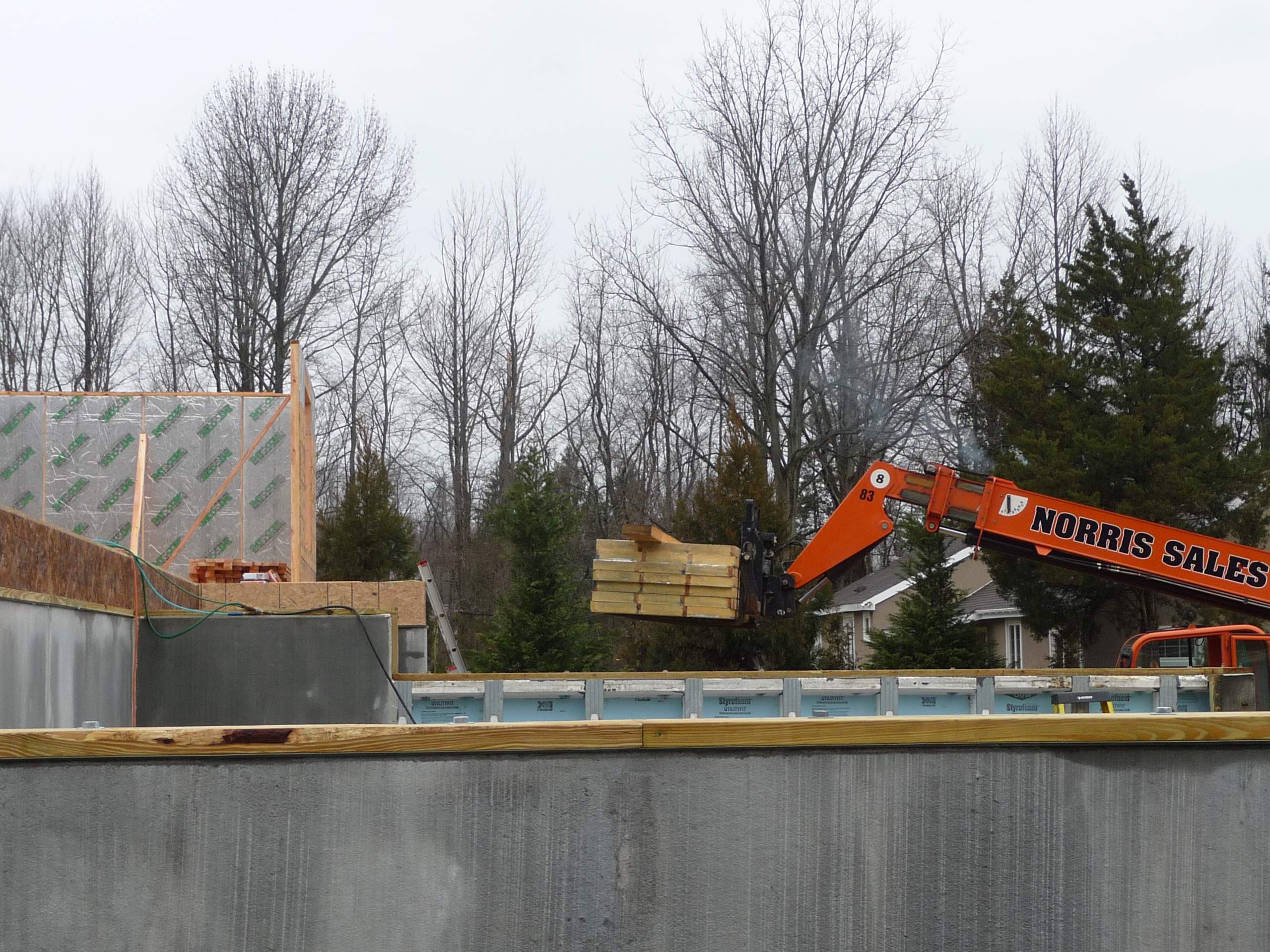

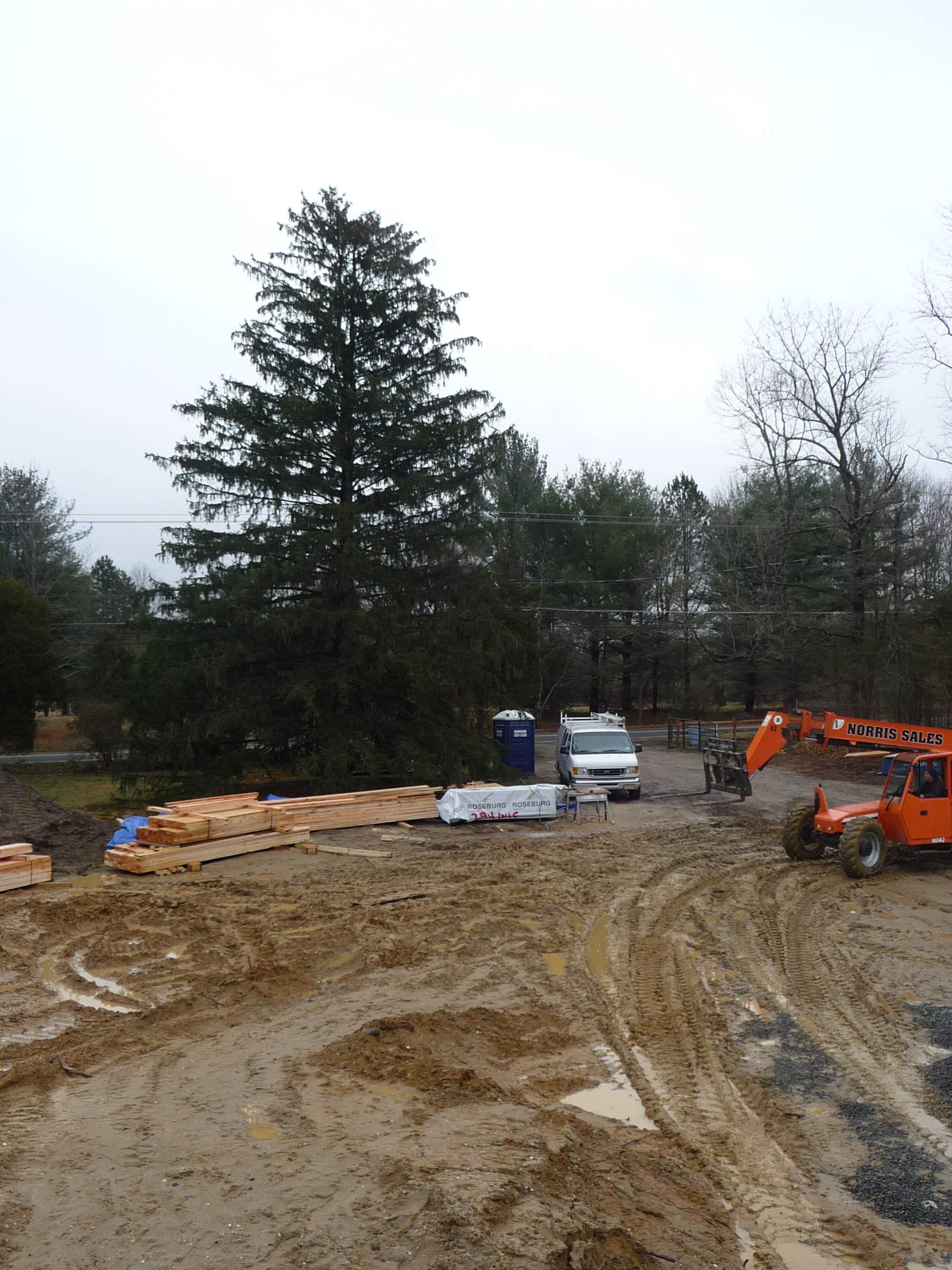

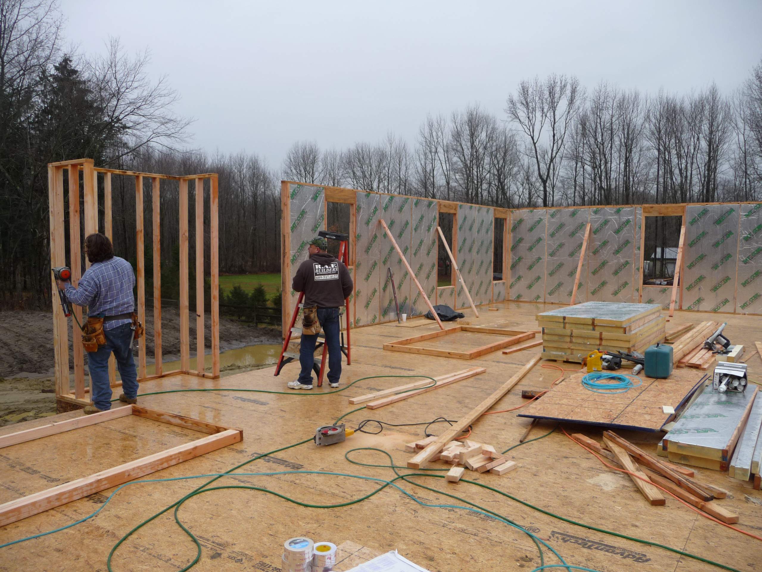

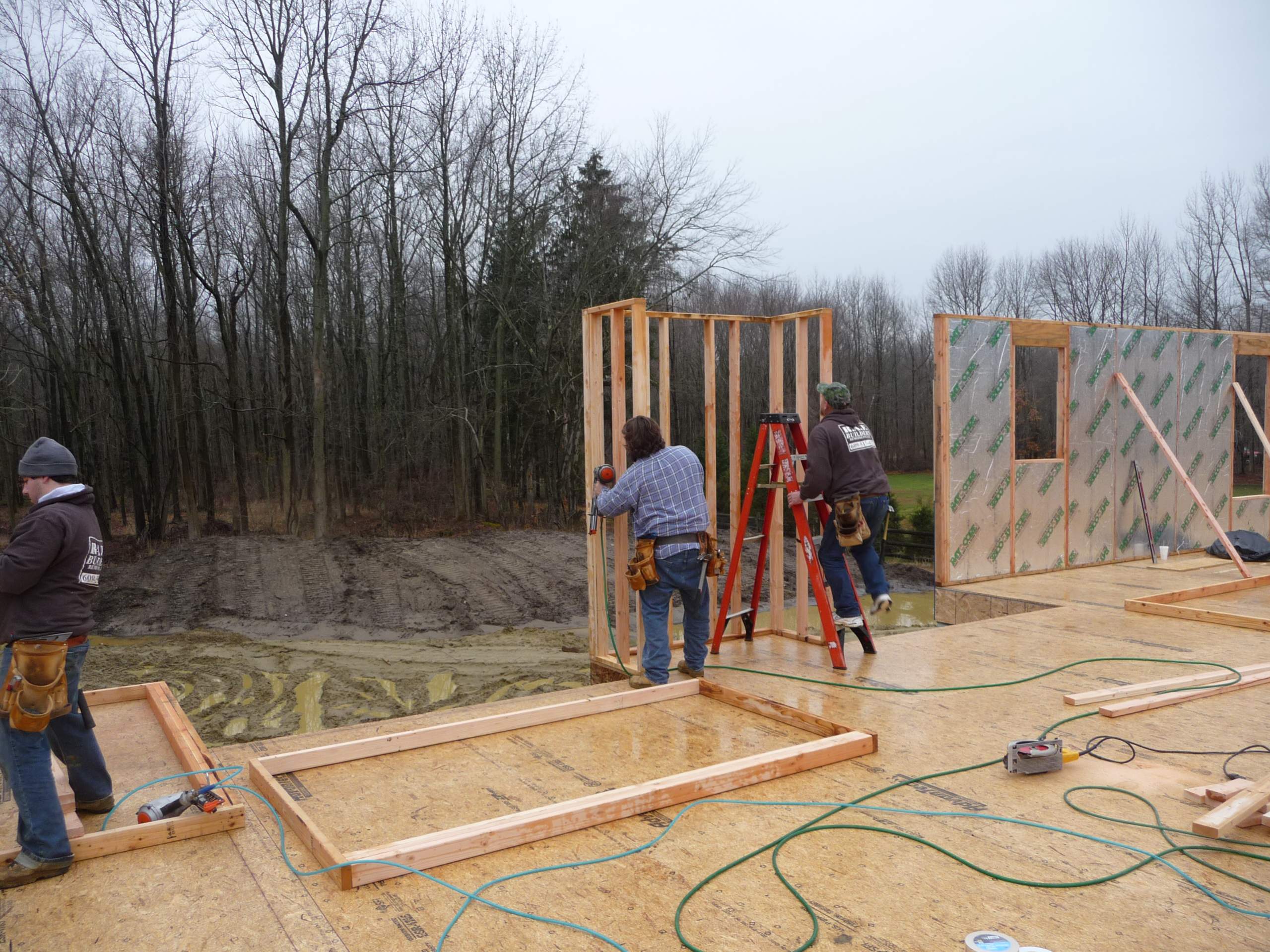

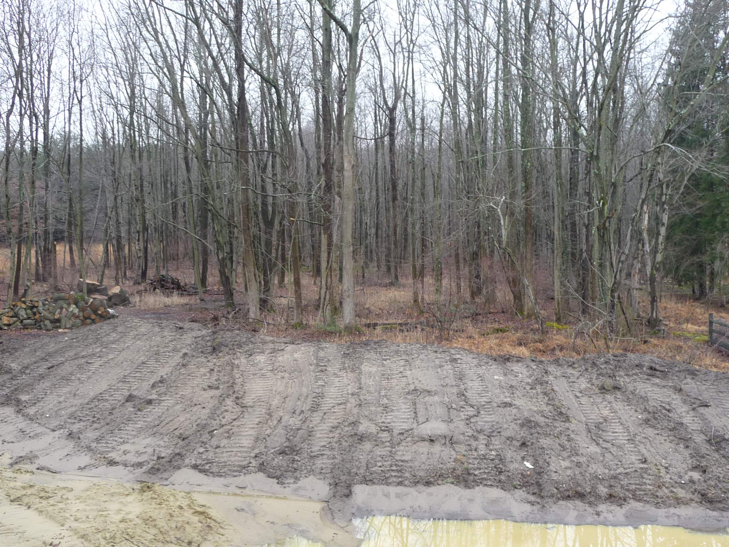

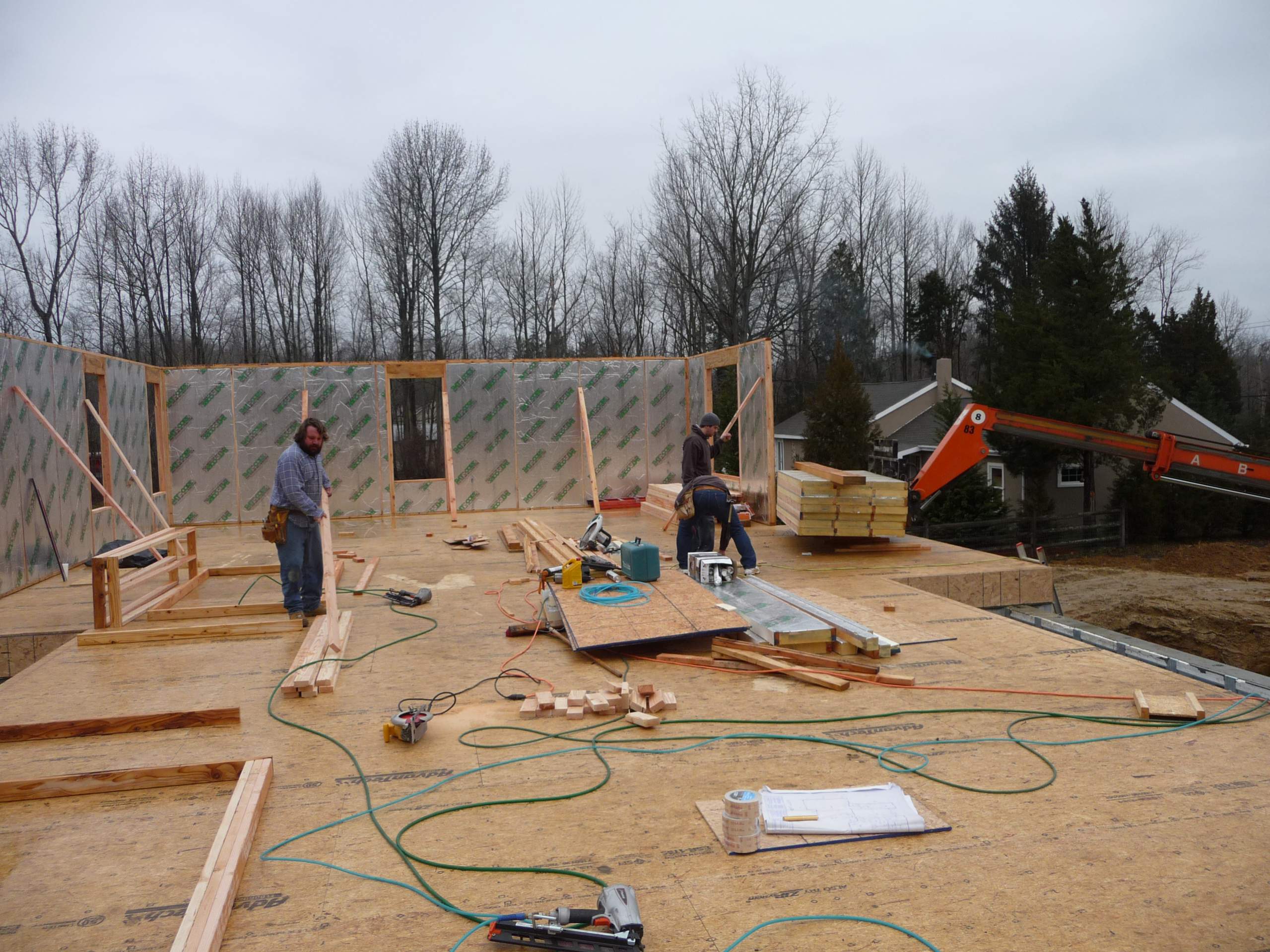

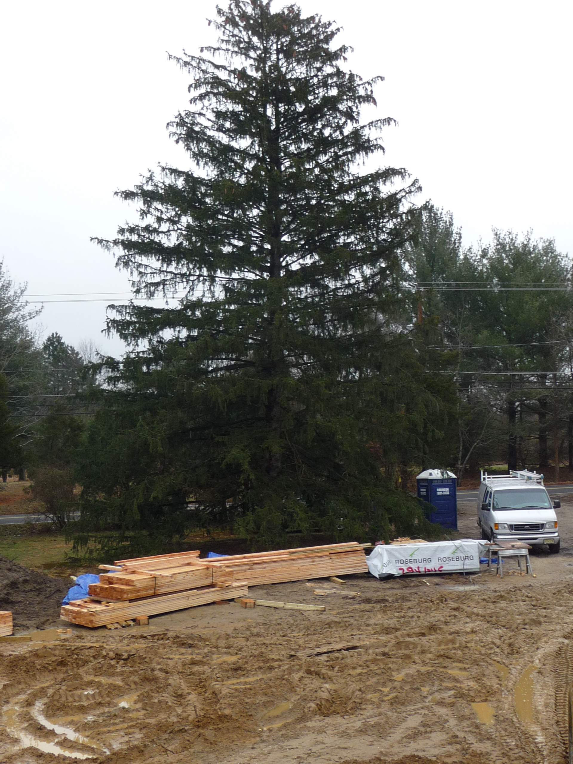

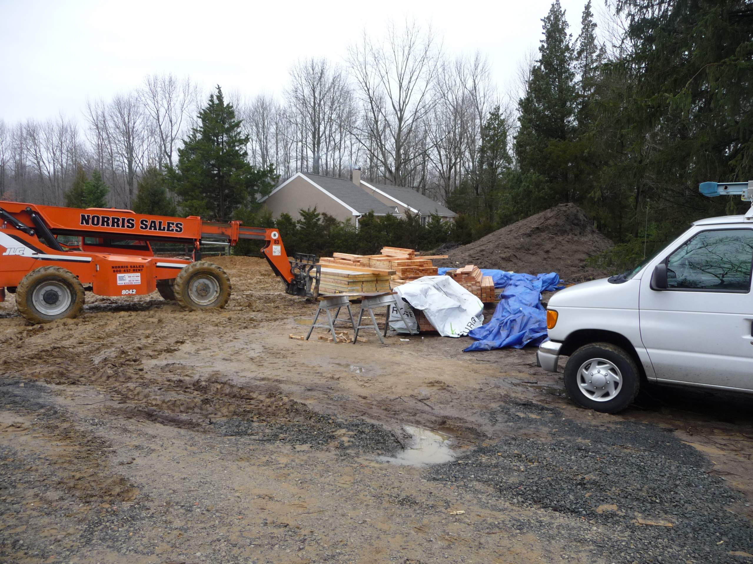

More rain last night. But we were able to move another truckload of fill around the foundation. Only the front remains a pool at the foundation. We will have to work around the rain and the framers as I do not want to get in their way. We will take down the ramp that was built for the concrete trucks that went unusable and fill around the foundation with that. Of course, we have to pump out that water first.
In the meantime, the framers were able to get three wall sections up and the rain is holding off now, so they are busy. Here are picks of the progress. The pictures out to the yard are from various bedrooms.
We are so happy that we opted for the 6' tall windows instead of the 4'9", especially with 9' wall heights.
This is where I get confused. You have walls that will have an extreme R value, but you went with bigger windows that will have an R value of around 3. At what point does is it not advantagous to spend more money on increasing the R value of a wall when you lose so much in the windows?
Air sealing is the single most important thing you can do for a wall. I'm a HUGE supporter of that. Then maxing out the insulation in the attic is where you see the biggest return for your investment and energy savings. There is only so much you can get out of a wall that has a window in it.

Eddie,
Building is always about compromises. We are being as energy efficient where we can, based on climate and expense. Some considerations, like wanting to have great views, are a higher priority than efficiency. We are still using Andersen windows with a U-factor of 0.30 and a SHGC of 0.21.
NJ adopted the IECC (International Energy Conservation Code) 2009 codes. All new homes must meet these standards. ResCheck is a free program that can demonstrate conformance to the standard. We ran it and are 18% higher than the minimum allowed by code, even with the larger windows.

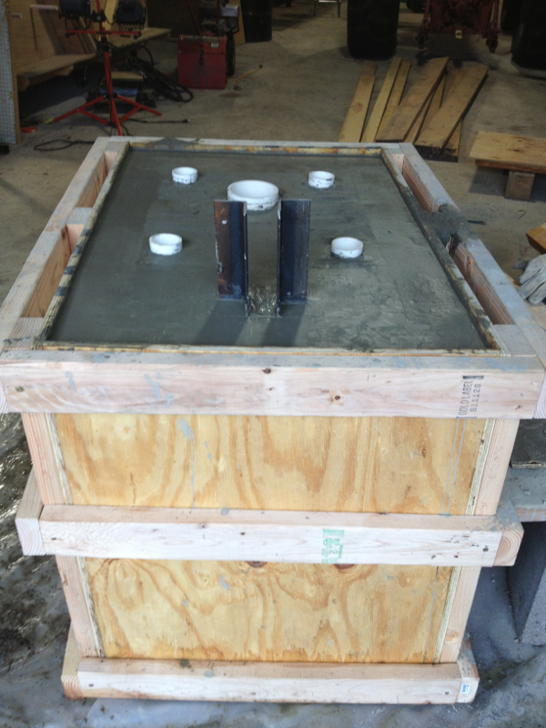

:) Aw, just joshing. I am truly interested! I have a ballast box full of curing concrete in my (currently) unheated work shop - temps stay around 40 when I don't have a fire going. Poured it last Friday.
This little side jaunt has been informative :)
