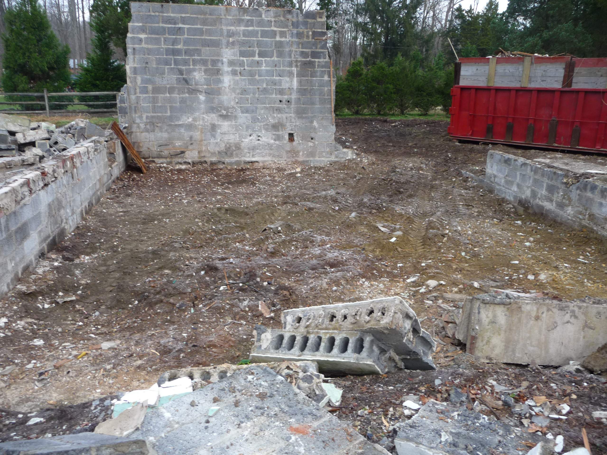

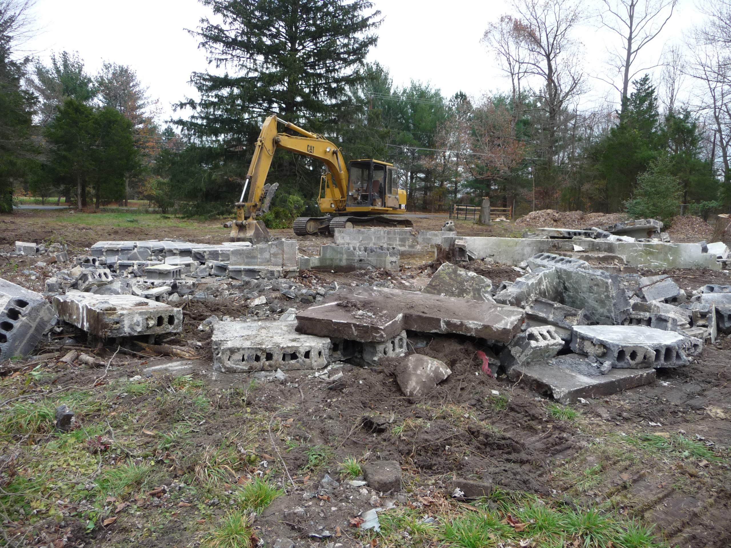

Thanks. I really appreciate it now. :thumbsup: We have moved about 5 tons of trash, 4 tons of stone/concrete/cinder block, at least 8 tons of firewood (yet to be split) and lots of moving of materials around.
If you see the floor plan, since it's a rancher, it has a large footprint. 47 square of shingles :eek:
Shame you couldn't have found a place to just bury that cinder block someplace. It wouldn't hurt nothing in a hole and saved you some money for waste removal
   / New Home Begins #42
In some areas it isn't legal to bury building debris on site.
   / New Home Begins #43
Yeah it's that way here too but I would think cinder blocks would be an exception. Broken up it could even be used on a soft or muddy roadbed with base rock placed on top.

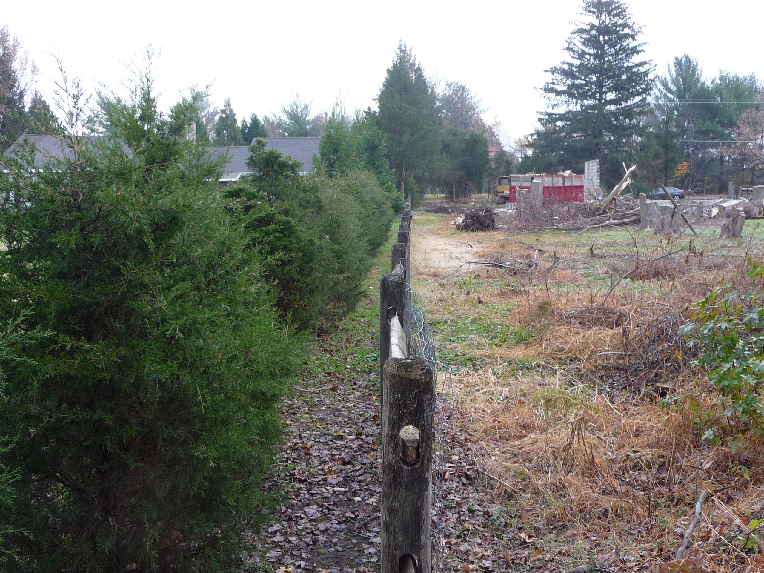

Thanks for the suggestion but I really can't move it at this point. First, the lot may be 3.5 acres, but it's like a bowling alley. 140' wide and 1/4 mile deep. I needed a variance since the zoning requires 50' on EACH side, leaving me with 34' to build in. Making the house wider is not an option. The front faces N-NE, so more windows there does not help too much there.
