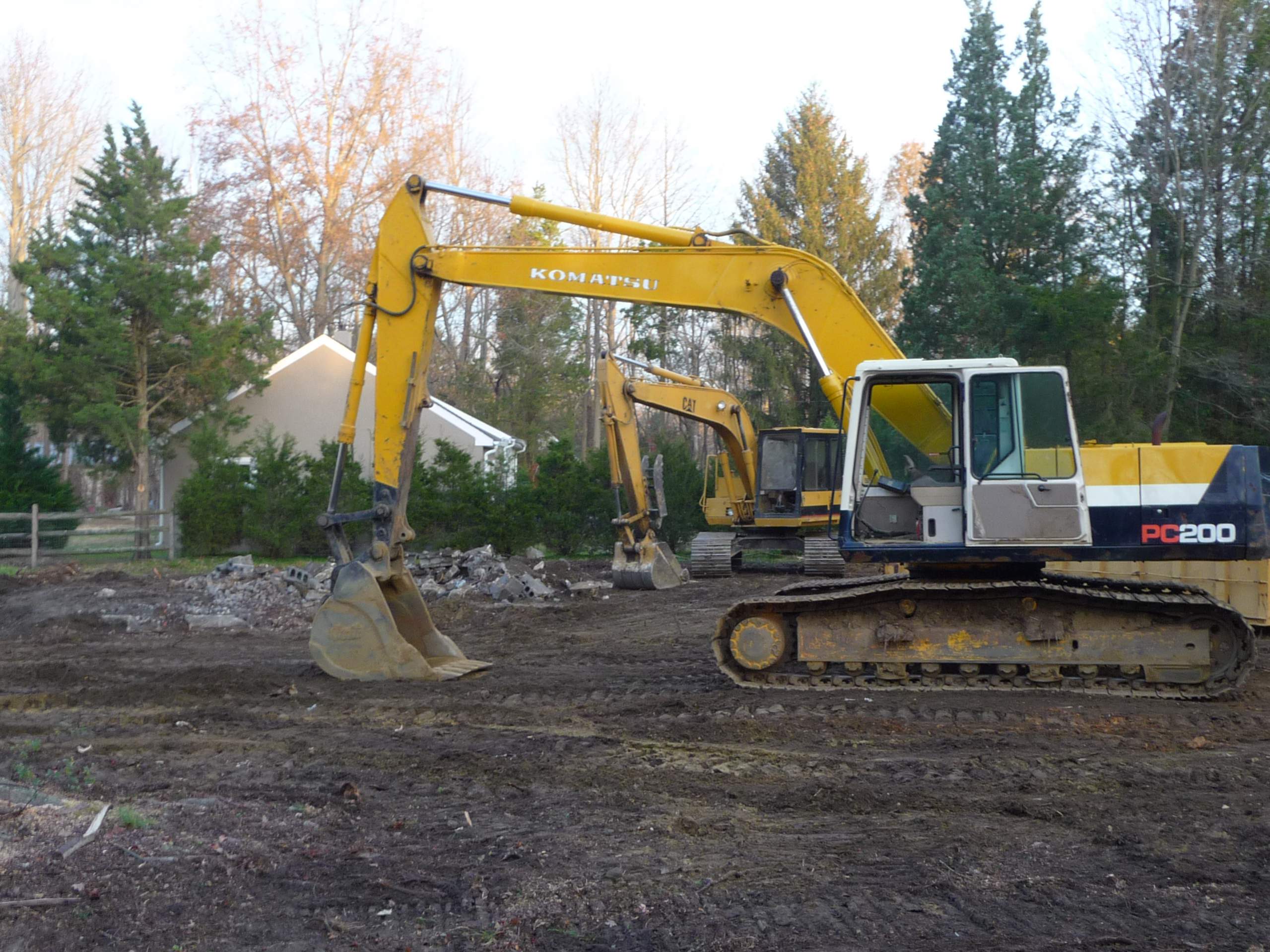

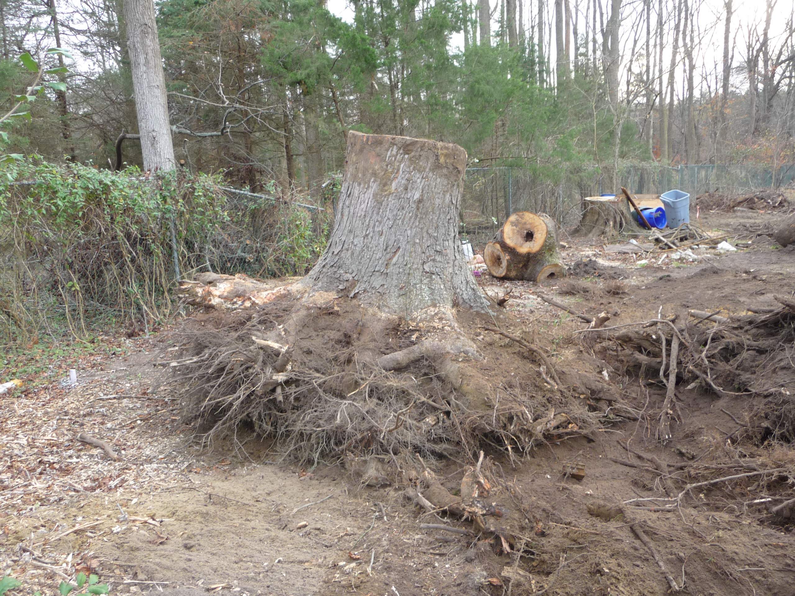

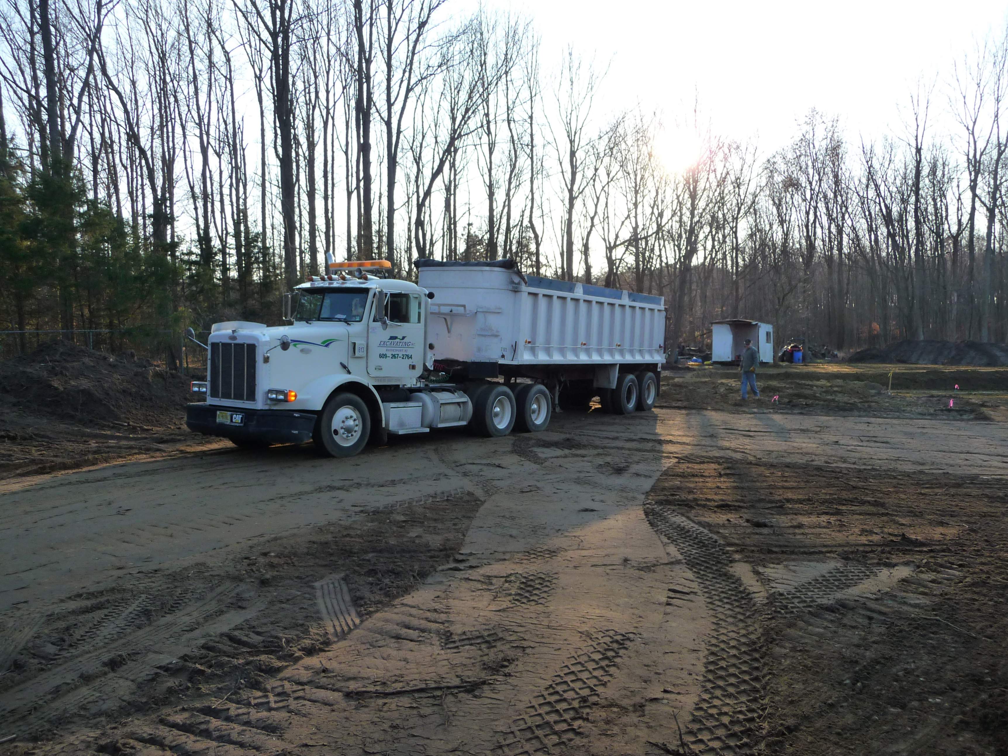

In addition, the demo of the old house, which we were originally going to have done in spring, is now scheduled for this Monday, 11/12 as the demo company feels the old home is too close to the new footprint and they want to be able to navigate all around. So the basement walls are now pushed back to 11/29.
Next photos will be the demo of the old house next week. Finally!!
