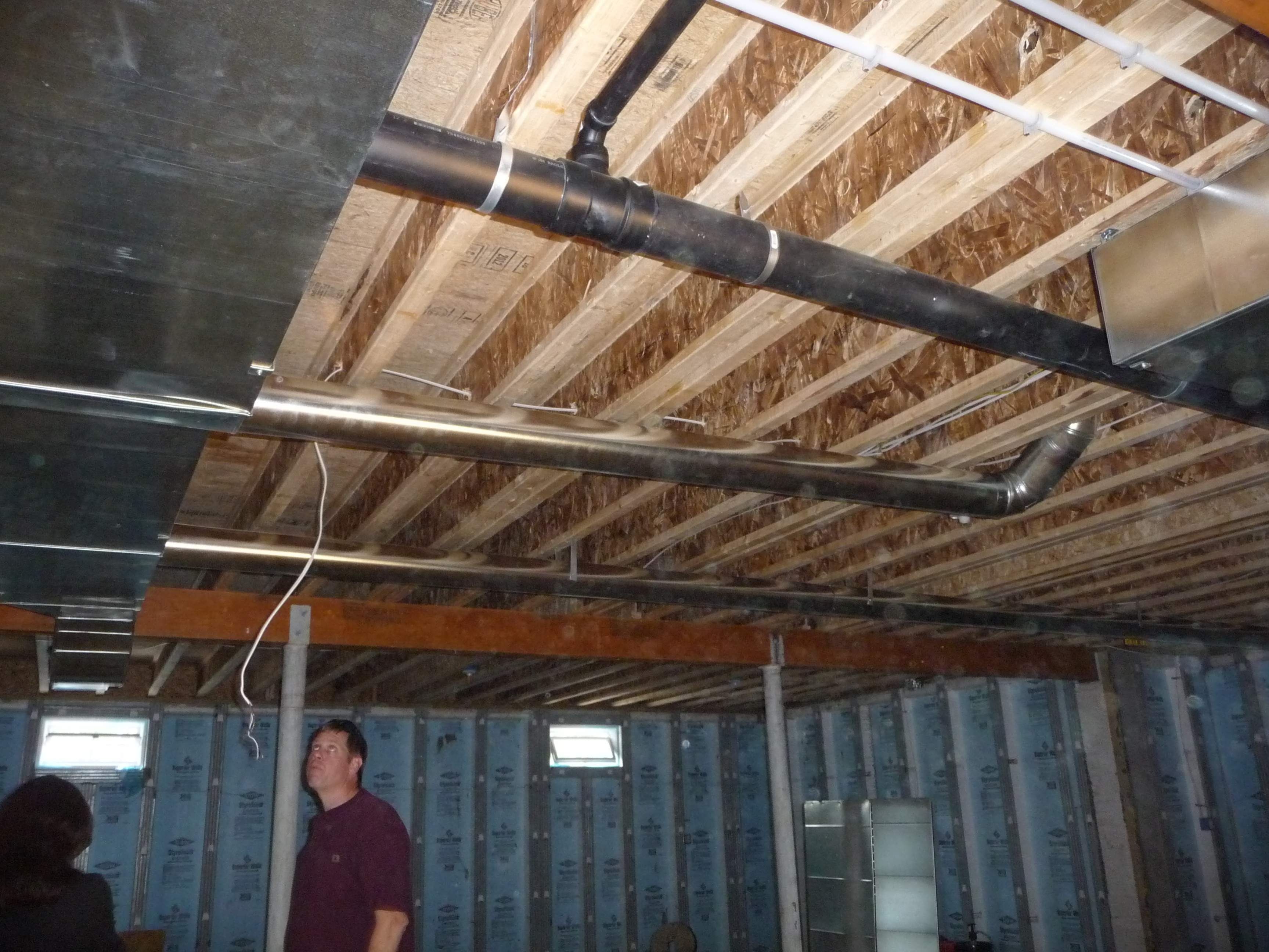

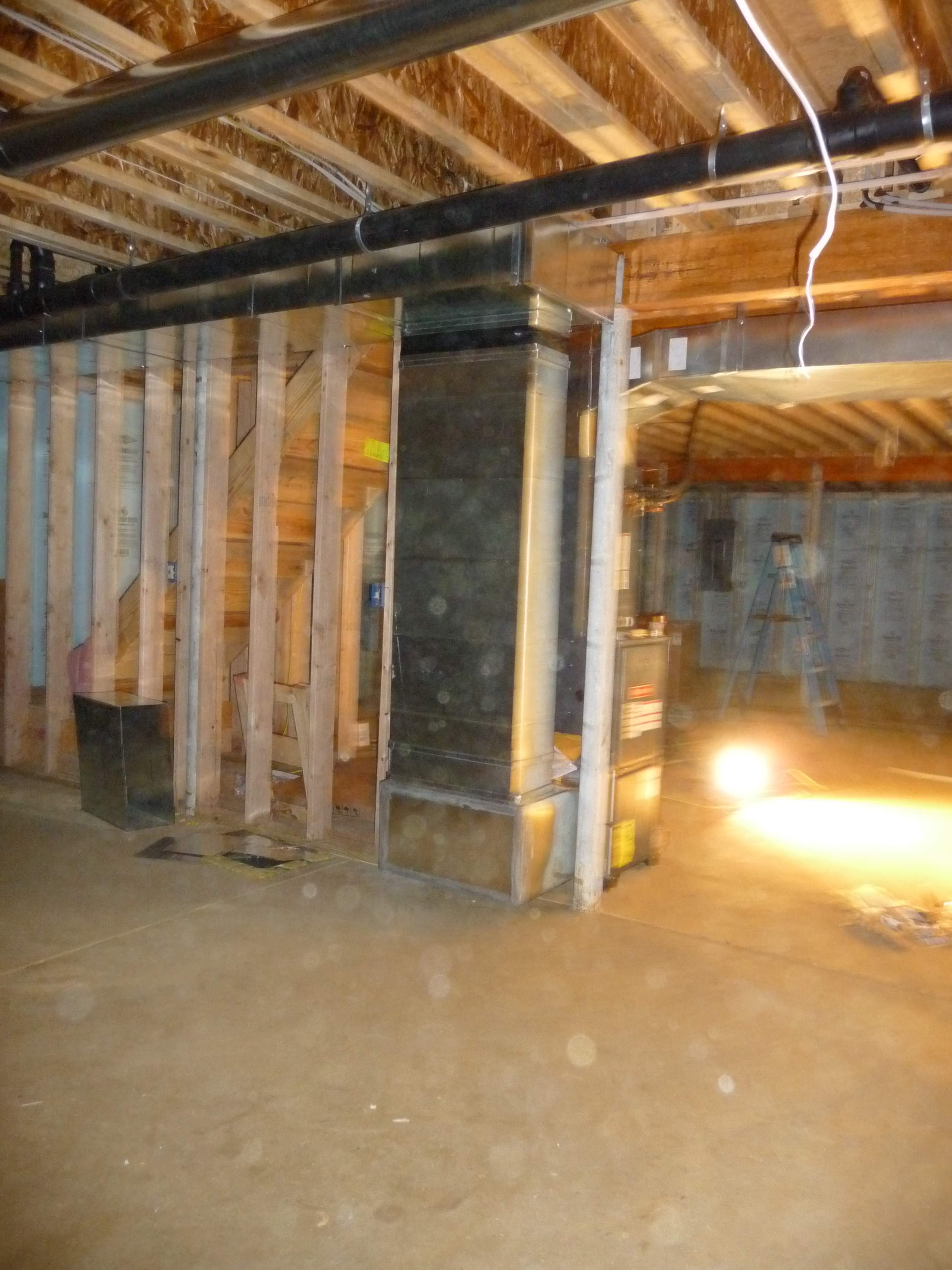

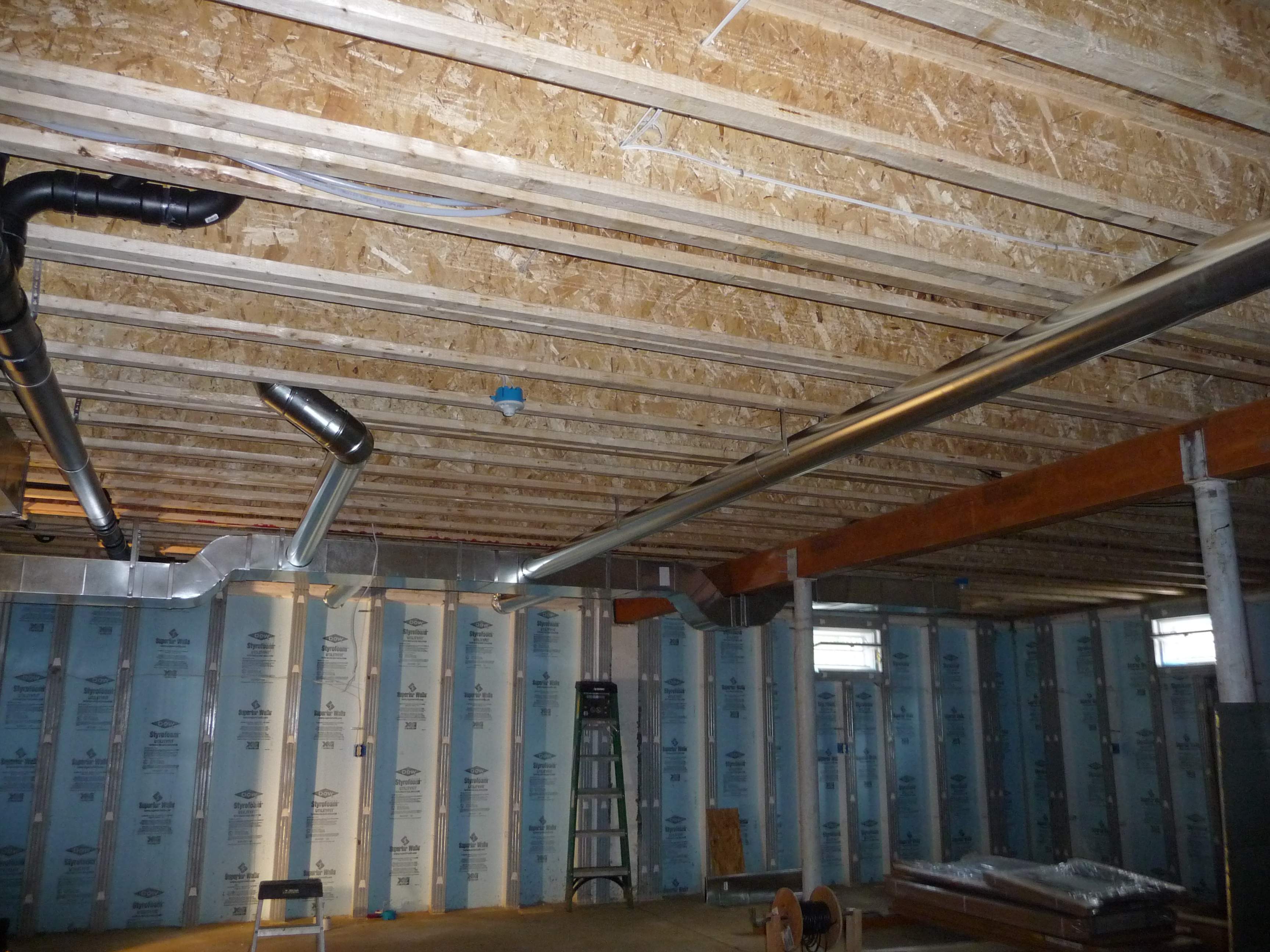

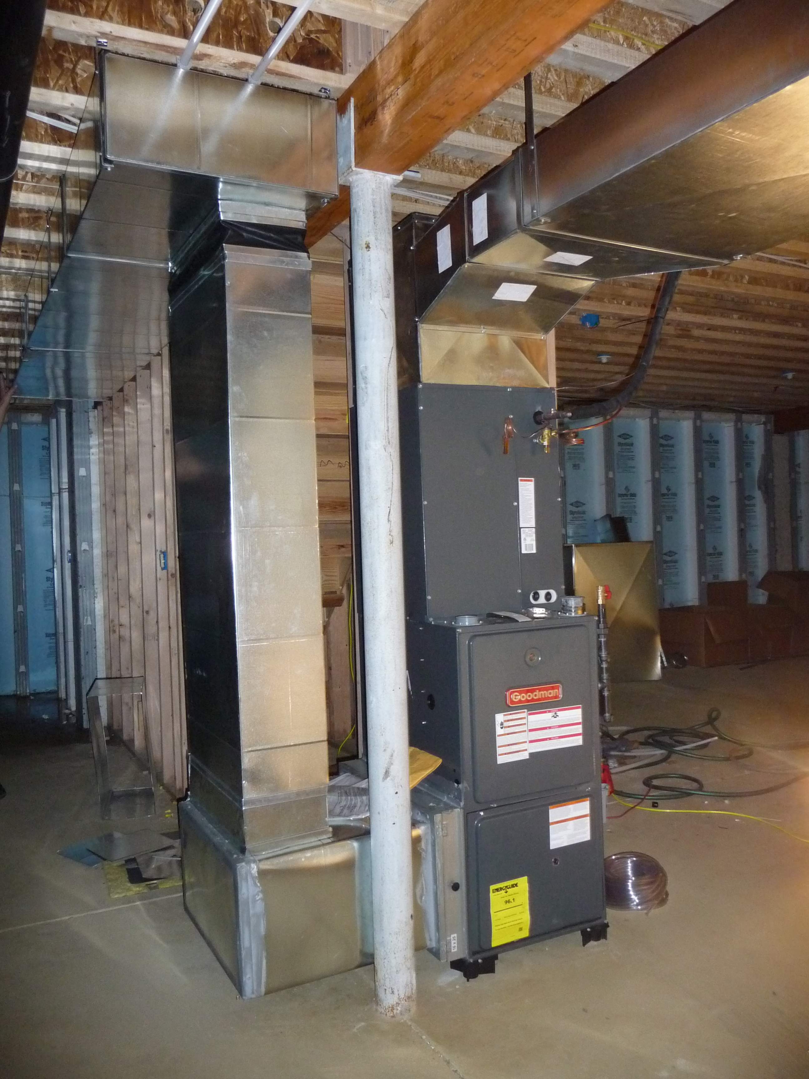

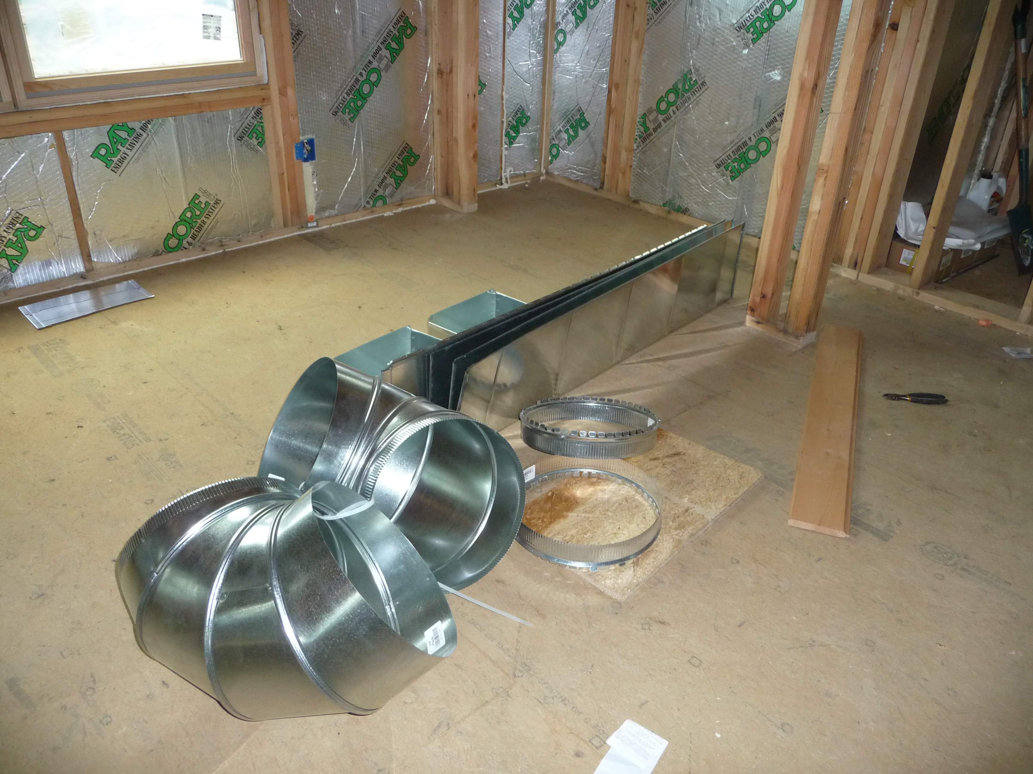

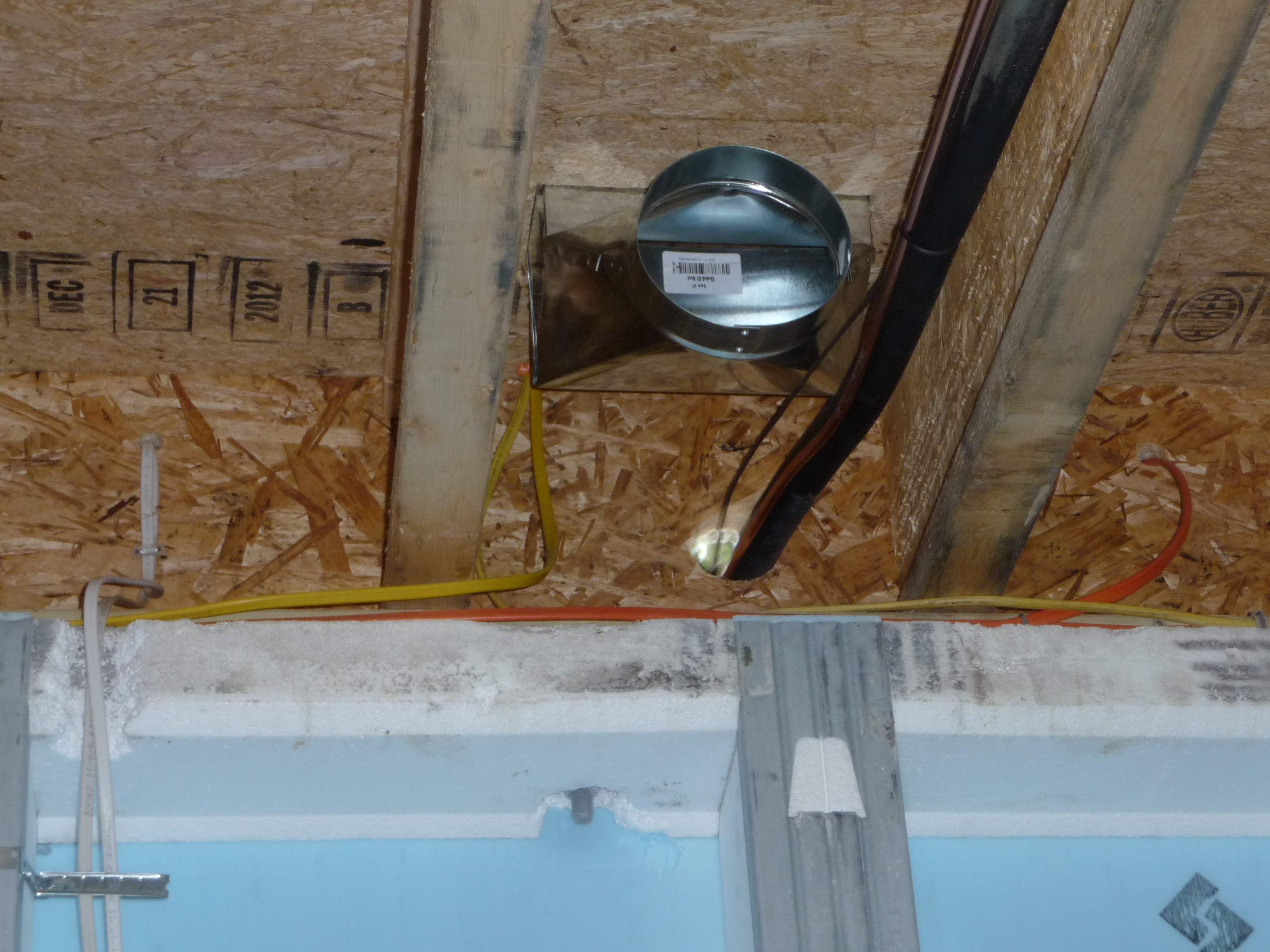

I hear you about the HVAC first. Did the electric and plumbing ourselves out of pocket so did not have to worry about bank draw schedules. We had already done a site survey with the HVAC company so we knew where the trunks were going and kept that in mind when we ran everything so those "lanes" were clear.
The one tough part is that the trunks will have to drop down UNDER the beams on either side of the great room. There is no room to run them between the ijoists as they are 12" on center (7" in between) and solid blocking all along the beams so cant run through them. It makes me especially happy to have gone with the 9' basement ceilings.

I sure wish Casa Lemon as I call our house had 9' ceilings in the basement. Good deal on coordinating with the HVAC company on routing and sizing. I've drawn up just enough HVAC ducts for commercial and industrial faculties to know all the contractor cares about is duct sizing, routing, and general location as they wing it from there.

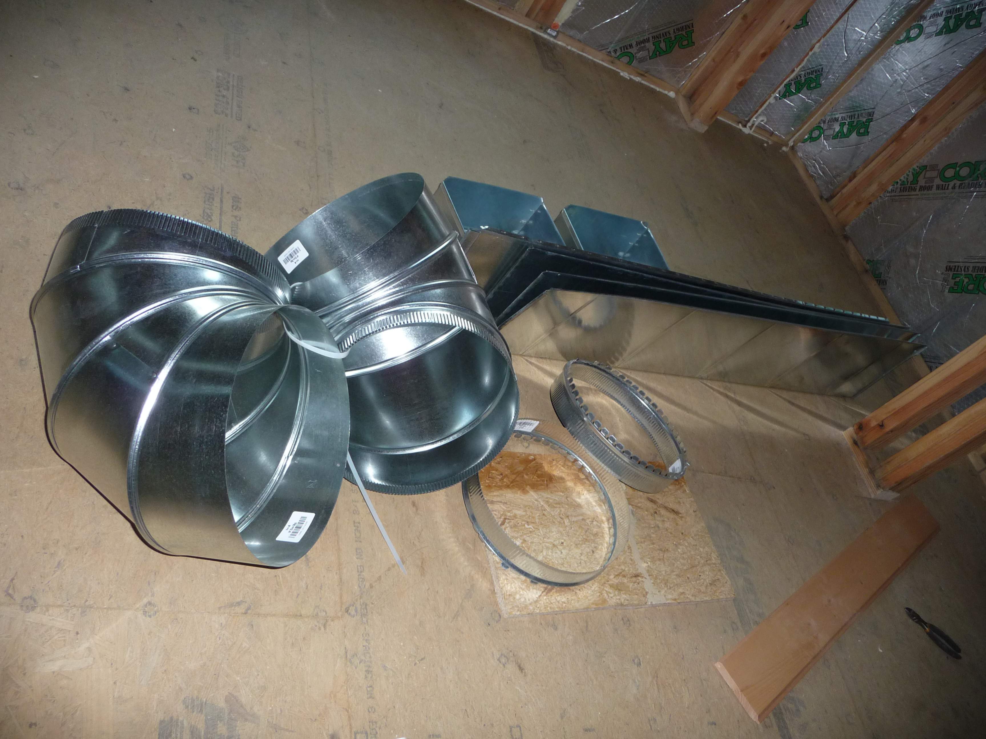

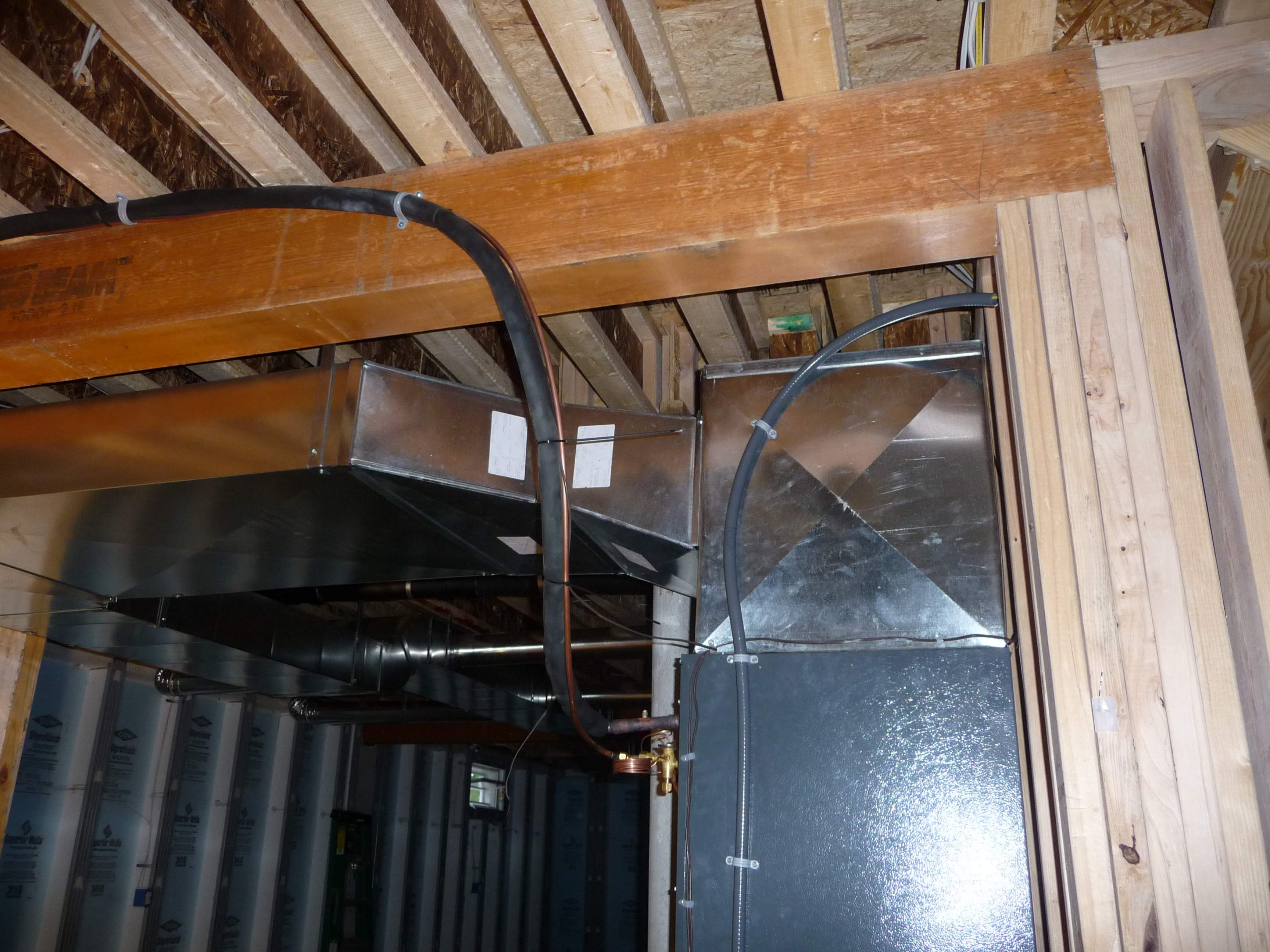

Here are some pics of the HVAC work in progress. The pics were taken yesterday, during the work, so it's a bit of a mess. I will get better pics now that it's complete.
Monday is the HVAC inspection. I will be running the gas lines tomorrow and preparing for the framing inspection next week. We could be into insulation and drywall the week after!!.
