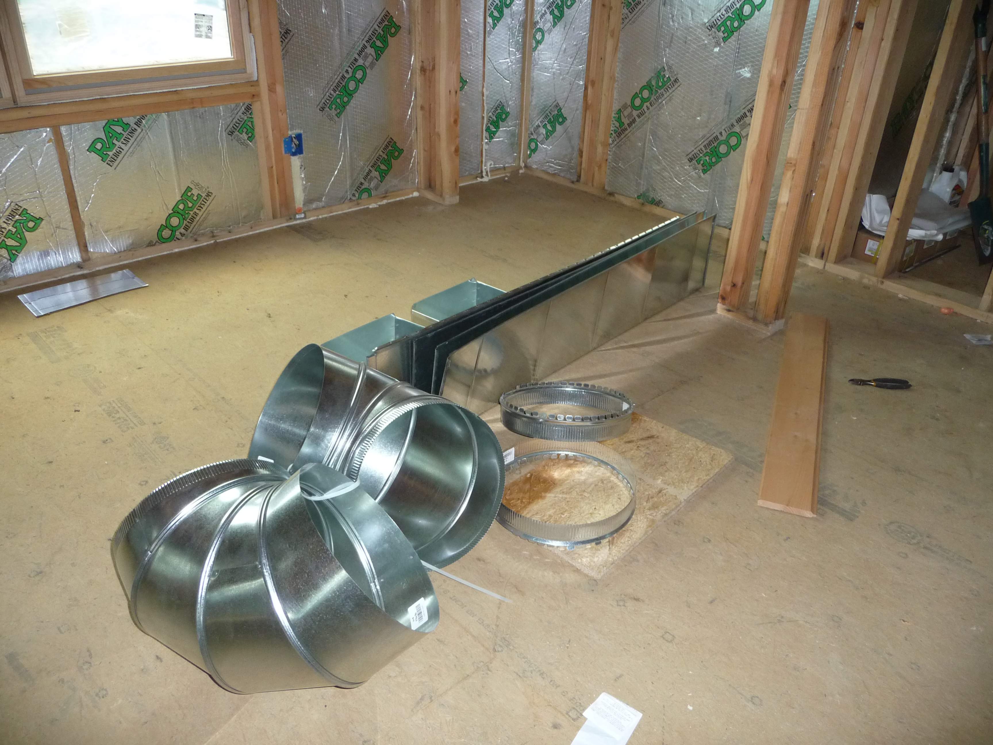

Those look to be some manly sized elbows for a residence. Where are they going to be used?
These returns come up in a closet and then split into two places. One is in the great room over the closet and the other leads to the hallway and the elbows are for that branch. Because there are only two returns and it the total CFM is 1300, some big ductwork is needed.

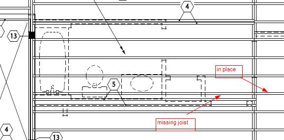

Dodged a bullet this week. Several bullets actually. We called for the HVAC inspection and the person that does that one also does the framing inspection, so he started the framing in the basement at the same time.
The good news was that other than needing a little more air sealing muck at three places, the HVAC passed.
The bad news was with the iJoists in the basement. He was reviewing the sealed engineering plan for the joists vs the actual installation and noticed that one was missing. The joists are 16" on center under the bedrooms and kitchen and larger ones 12" on center under the great room. This was all correct and to plan. In one place under a bedroom, there are two additional ones providing support under a NON-load bearing wall. The framers missed one of the 16" on center joists. Luckily the one under the wall makes the spacing to be 18" on center, not 16". As a result, he needed me to get in touch with the engineering company to see what kind of +/- on spacing is allowable. They came back and provided documentation that every third iJoist can be shifted up to 3" to allow for plumbing or other obstacles.
That letter allowed me to dodge that bullet.

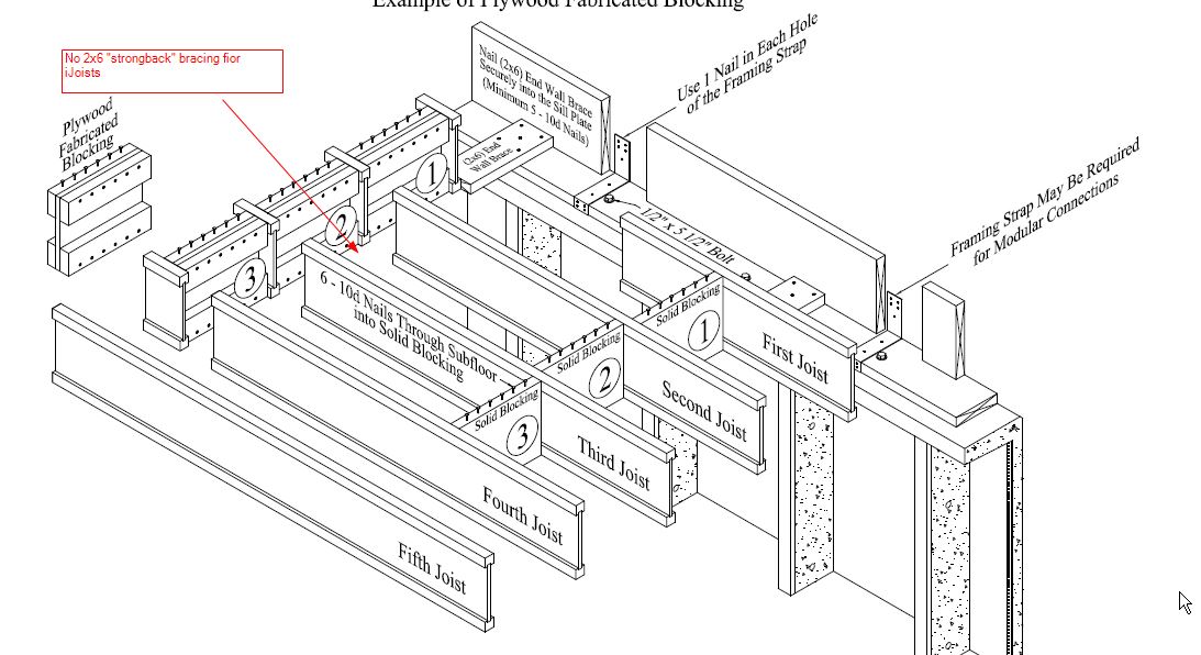

The next was related to the blocking that is required between the superior walls and the iJoists that run parallel to the basement walls. The drawing for the basement had different blocking schedule as compared to the engineering drawings for the iJoists alone. The superior drawing showed an additional 2x6 to be nailed under the normal blocking.
This would have meant adding 27 additional 2x6 bracing, including some that would have to go above the ductwork that was just put in.
I contacted Superior walls and asked about the bracing. He said that the additional bracing is only required if the joists were ordinary dimensional lumber, not iJoists. He provided me with the page/drawing in their guide book that indicates this. I forwarded this information to the inspector and he accepted it provided he gets a letter stating same from Superior, identifying our project specifically.
I received that letter yesterday and it was provided to the inspector. Second bullet dodged.

The floor joist engineer ran the load calculations with the missing joist and all is good. They redrew the plan showing 3, not 4 and it was sealed and turned into the inspector. He came out and inspected the main floor the other day. He wanted additional 2x6' to pick up the heels of the rafters comprising the crickets and he also wanted the top plate penetrations in the garage fireblocked. We did not do them because the garage was unfinished anyway. He indicated that they want the blocking in now as we can slap up drywall anytime without a permit and this way they are assured it is done.

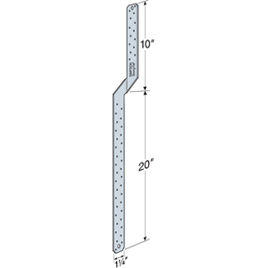

Well, I got all of the items on the list done and the gas line holding the required 10#. As of today, the framing inspection has been approved as has the gas line. I was reviewing the blueprints over the weekend and I noticed that the Simpson MTS30 twist straps connecting the rafters to the walls had the required (14) 10d 3" fasteners on the wall side and the required (14) 10d 1.5" on the rafter side per Simpson's specs. Unfortunately, the architect specified that every hole have a nail. So, yesterday, I was pounding in 21 more nails per strap. Can someone please tell me what difference having 35 nails in the strap at the top of the wall when the wall is secured to the floor with maybe 35 fasteners for the entire wall length? :confused:
I can sympathize with you but it is better for you to find you need those nail now rather then the building inspector saying you need them. I misinterpreted the repair on the trusses on my pole barn that required two rows on nails in each side of the plywood gusset. I put one row in each two by four and the inspector says that it was supposed to be two rows into each member. So now that the trusses are up I have to get at the end of each truss and add another 50 nails. It should be fun.
Your house is coming along nicely. Rick

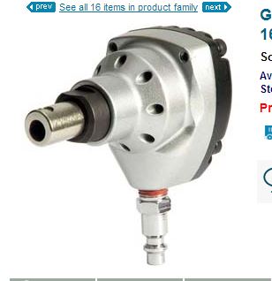

sounds like you need one of these. The framers used this and I wish I had bought one. $40.
grip rite palm nailer.jpg.
