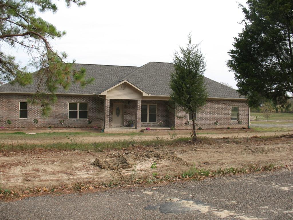

Looking north at house .JPGbreakfast area.JPGI have 9 foot ceilings and all my windows top line up with top of doors. which puts them 11 1/2" from top of marble floor to top of window sill so it would be about 12" from the slab to top of window sill.
I think they look good from inside and outside.
Note that bedroom windows are smaller than living area windows but tops still align with top of doors.

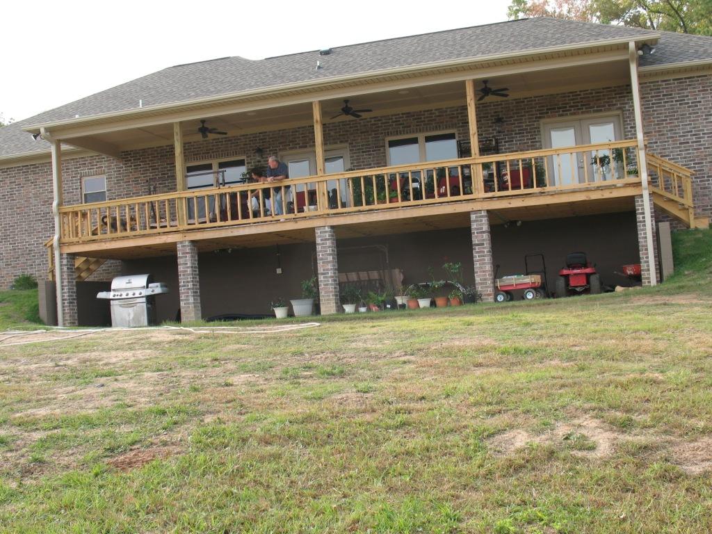

Photo of rear patio.
