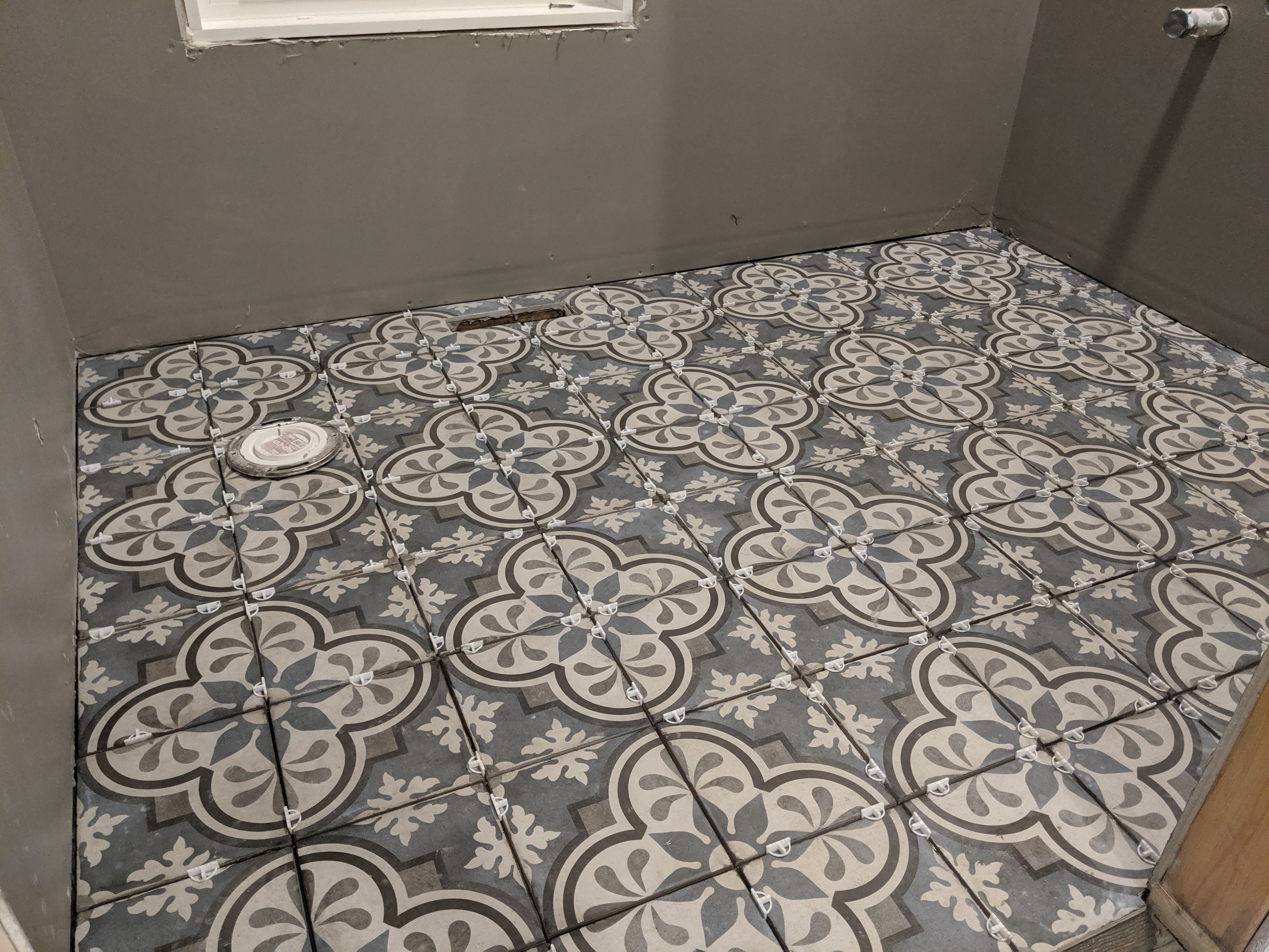

Busy stage of the build. I'm finally taking over a lot of the finish work. I'm laying tile while my wife and friends paint. I have the DITRA down in all of the rooms. Half bath is done, laundry room is next. Only shot of the half bath floor I have.
