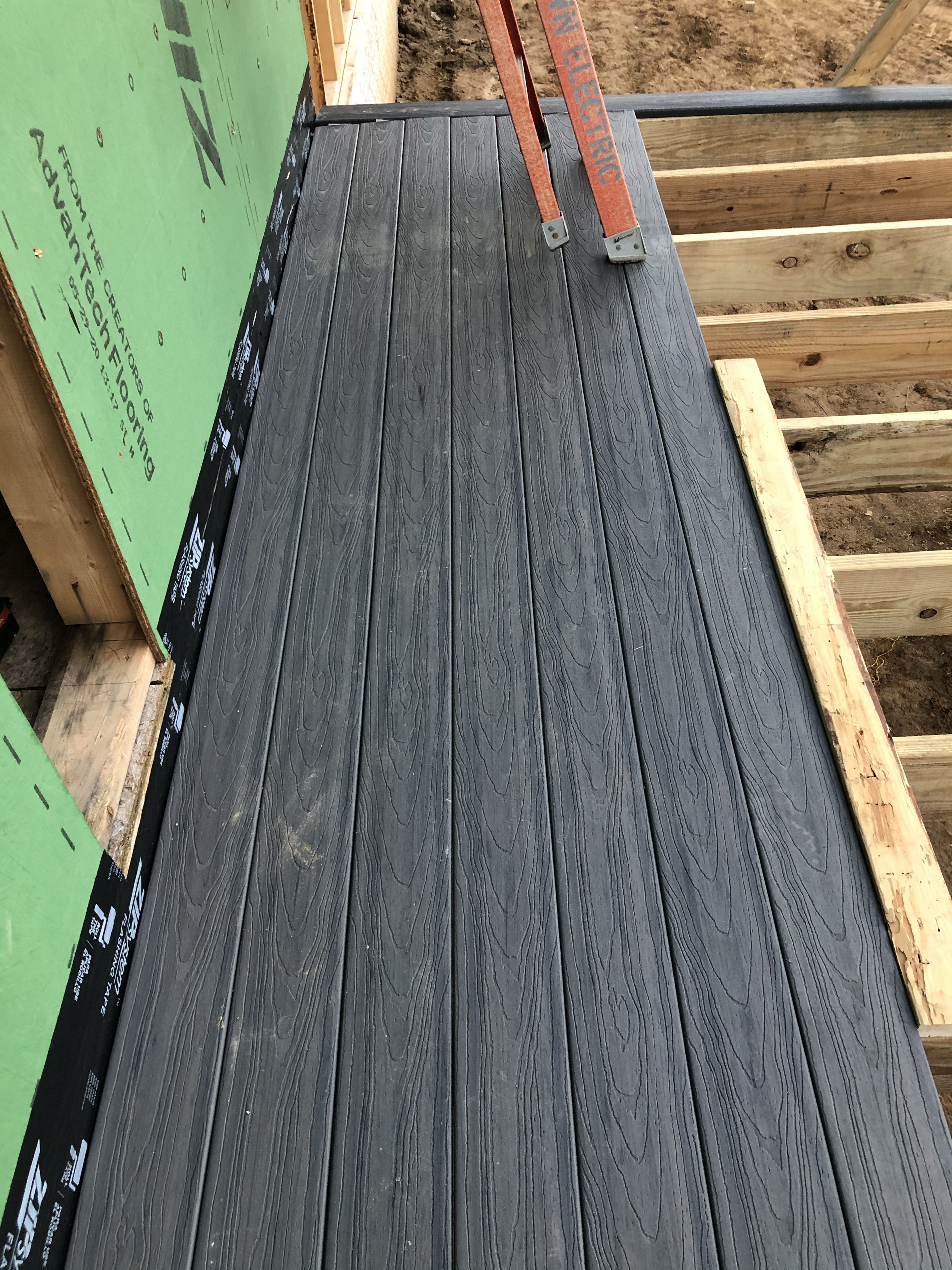

Nice job on the deck. Does it go around the porch posts, or does post sit on top?
I need to redo my decking.

That decking looks great. I've had mixed experience with the first generation products but the newer products seem pretty good. The test is how it looks 4-5 years from now! I haven't kept up with the cost -- has that stuff blown up with lumber pricing during Covid?
When I bought it, wood was at its peak. 16’ wood deck board was 28.95, and the composite was 28. Pretty much a wash after adding stain for the wood and hidden fasteners for the composite. Just figured the composite will be less maintenance long term. Not sure I’m 100% confident in the fasteners though, the screws strip easy, either the head or in the wood. I absolutely hated installing it. My knees have never hurt so bad in my life. I hope those clips surprise me on their durability.
I told my wife, knowing what I know now, I would have spent a little extra and done suspended concrete and stamped it. That said, we are really happy with how the composite turned out, especially compared to wood.

I've had some composite decking for about 15 years, much of which gets full exposure. It still looks great. I believe you will be happy in the long run. In fact, I've recently had to rebuild the wood underneath my composite decking. It was treated, but I did not stain it. This time I stained it.
Good to hear, I hope I’m saying the same in 15 years. I really wanted to paint or stain the joists, but just didn’t have the time. Hopefully I don’t regret that. Our current wood deck has a roof and is 15 years old. Joists still seem solid, so hopefully the roof helps protect it. Time will tell. I’m just glad it’s done!
I cut it around the posts, figured post sitting on top of the bottom posts and attached to the rim board using ledger locks was stronger than sitting on top of the decking. Plus easier to change out a deck board if ever needed.
That said, primary reason was that I needed to get the roof up quicker than I could get the decking down, so I didn’t really have a choice. A pain to cut around them, but not bad. Cuts aren’t perfect but I’ll be adding post wraps and top and bottom trim, so won’t see the cuts anyway.

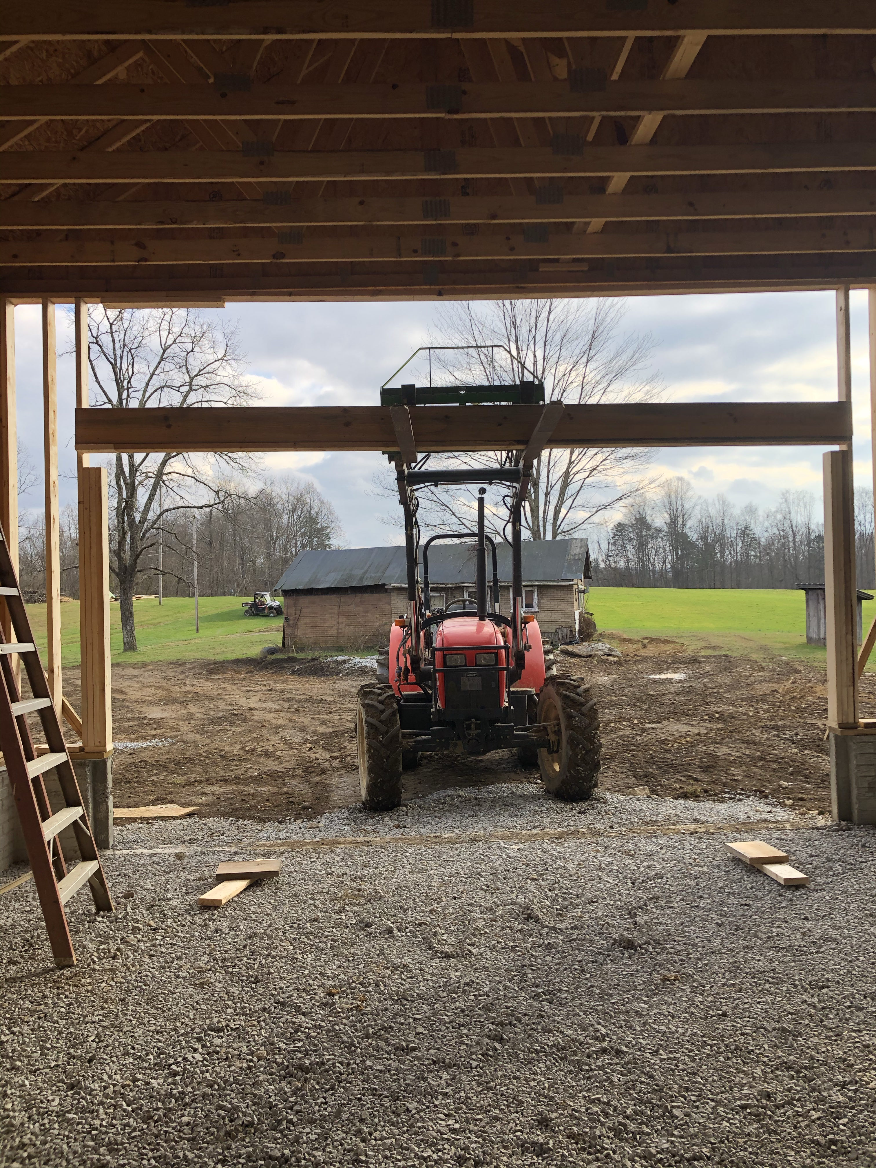

Not sure if I mentioned yet or not, but I purchased a set of forks for my tractor just before starting the build. One of the best purchases I致e made and I知 not sure how I would have done most of this without them. Here痴 a shot of the tractor helping lift the 16 garage door header in place.
How do you like the Zetor? Some would say it's an odd choice, but I came close to buying a Zetor myself about 20 years ago.
