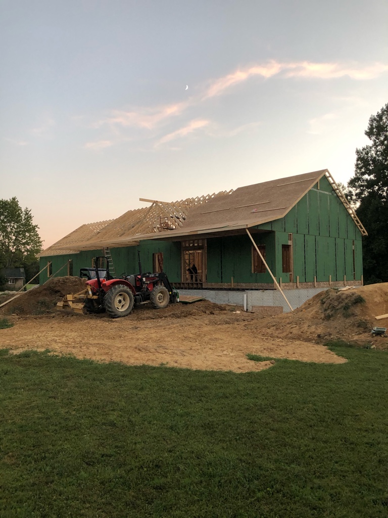

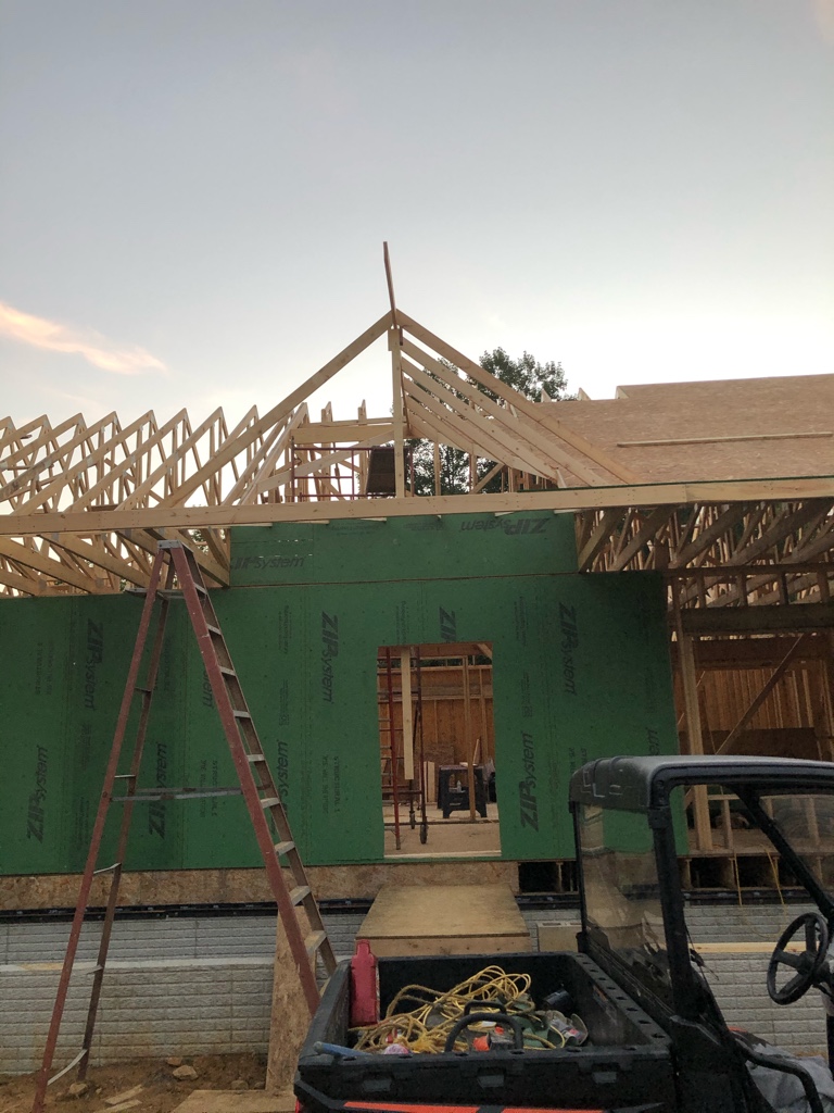

A friend who is a contractor called, said his job was delayed due to waiting on windows, asked if I wanted his guys for a few days. I took him up on the offer.
They showed up and we went to work. Got the dormer mostly built and a bunch of sheeting up. They will be back at 7 am tomorrow. May have them all week. Hopefully we will get the front done tomorrow and the back by Thursday.
After struggling over the weekend, it was nice to have some hired help. It definitely came at the perfect time.
A couple progress pictures.

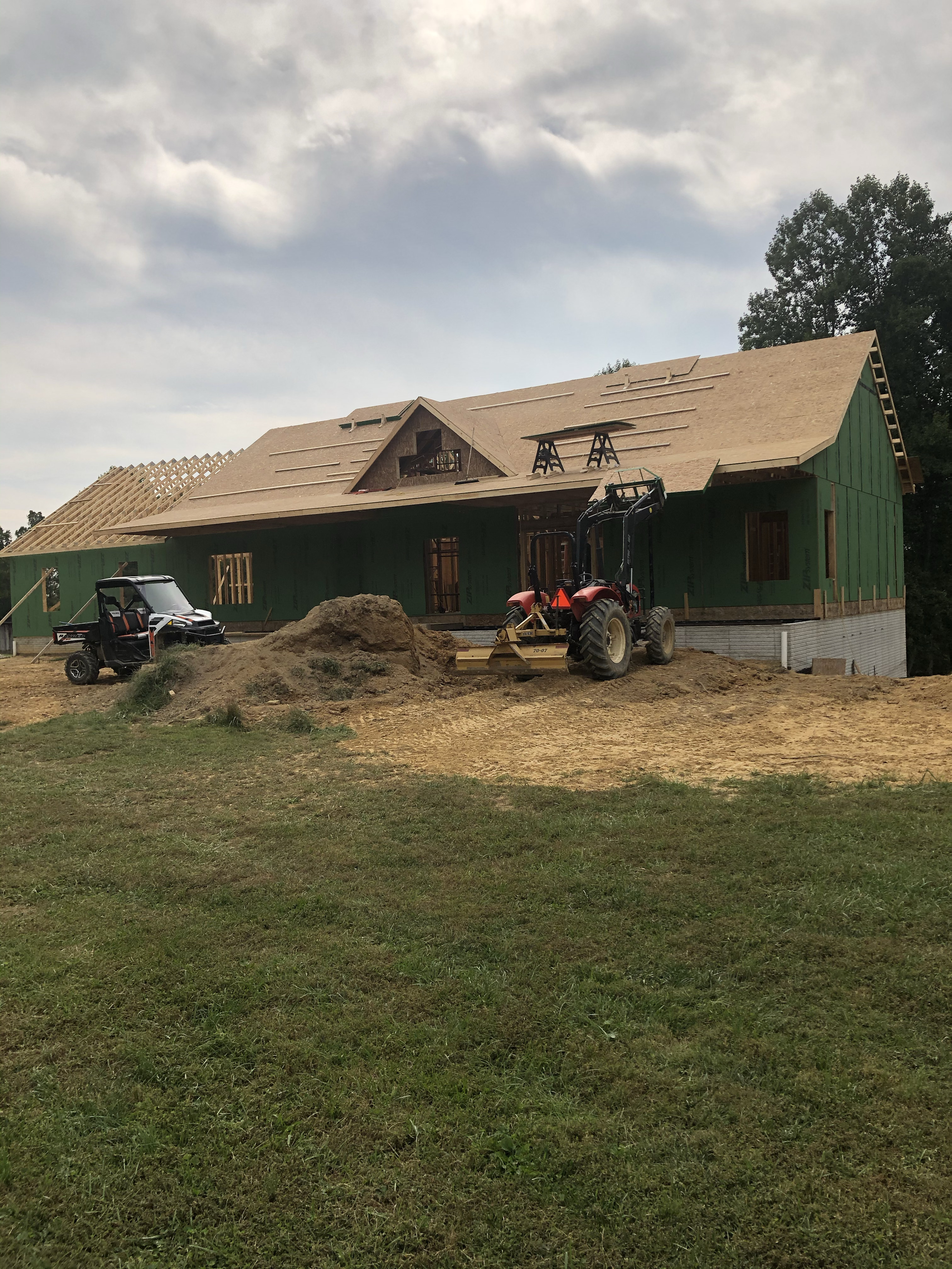

#75
Dormer and front sheeting is now done. Back side of the house is about half done. Should get most of the sheeting done tomorrow.
Going to spend the rest of the evening moving dirt and rock.

Your cheating using the tractor to do all your heavy lifting!!!! :)
Yeah, I know. I’m trying to do the whole work smarter not harder thing!
If I had about three more feet higher of reach, it would have been perfect.
Unfortunately, the back side is too high for the tractor. After some thinking, we decided to build brackets at the top and move a bunch of sheeting onto the brackets at the peak on each side. We made our marks at the bottom and then ran a 2x4 all the way across. We then tied a rope to a pair of vise grips. One guy stayed at the peak and clamped the vise grips in the middle of the ply wood, and lowered it down. Worked like a charm and we were moving on the back when it was quitting time. Should go quickly tomorrow.
