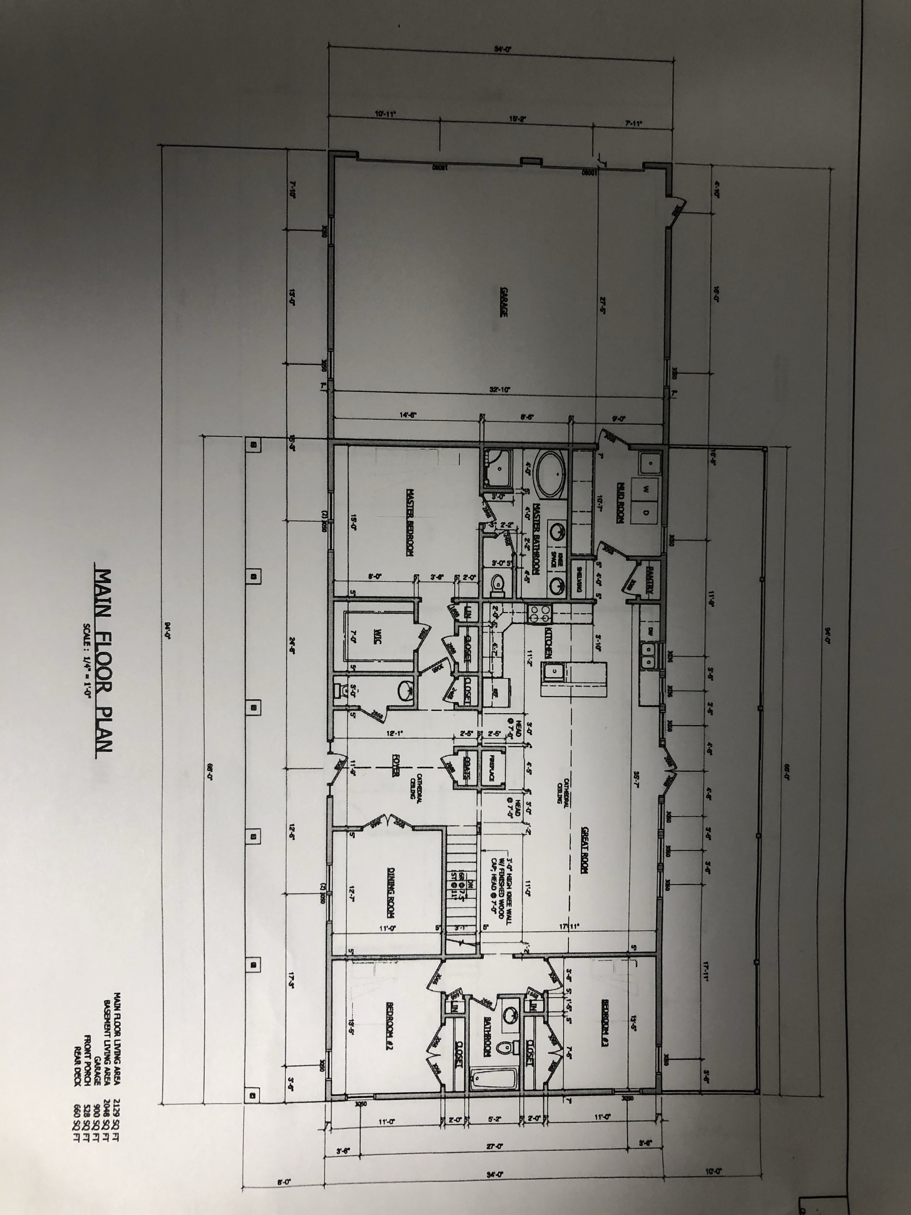

We did design the house ourselves and had a draftsman fine tune it into blueprints. We did our best to keep the design simple, with as few corners as possible, and utilize as much interior space as possible. Foyer is a bit big and could be viewed as wasted space, but it just worked out that way and it will make for a nice entry. Not sure I’ve shared the floor plan, so I will now. We have made a few minor changes as we went but nothing drastic.

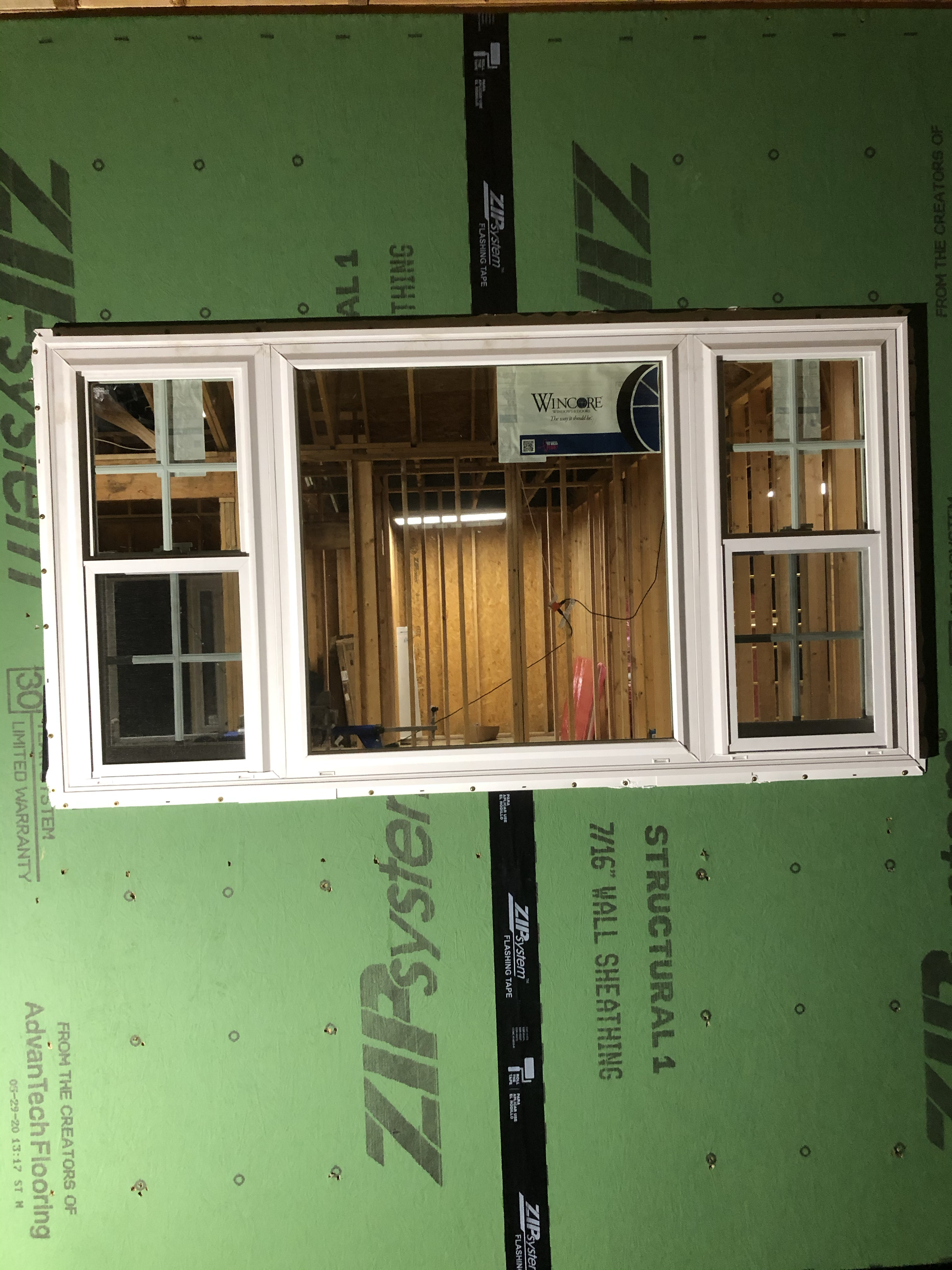

Good news today, windows will be delivered tomorrow!
That's great news!!! Be sure to tape them up so zero air can get past them. Air getting around the sides the windows is one of the biggest energy issues in most houses. I use ZIP Tape, that stuff is great.

I plan to do exactly that. I will tape the opening, caulk the flange, install with screws, then tape the flange. I agree, zip tape is awesome, I’ve used it for all sorts of stuff, and will likely always keep a roll or two around from now on.

Got 2 windows installed, here is the kitchen window. Still need to tape the outside.
Unfortunately, I found that one of the windows is missing the nail fin. That’s a bummer....

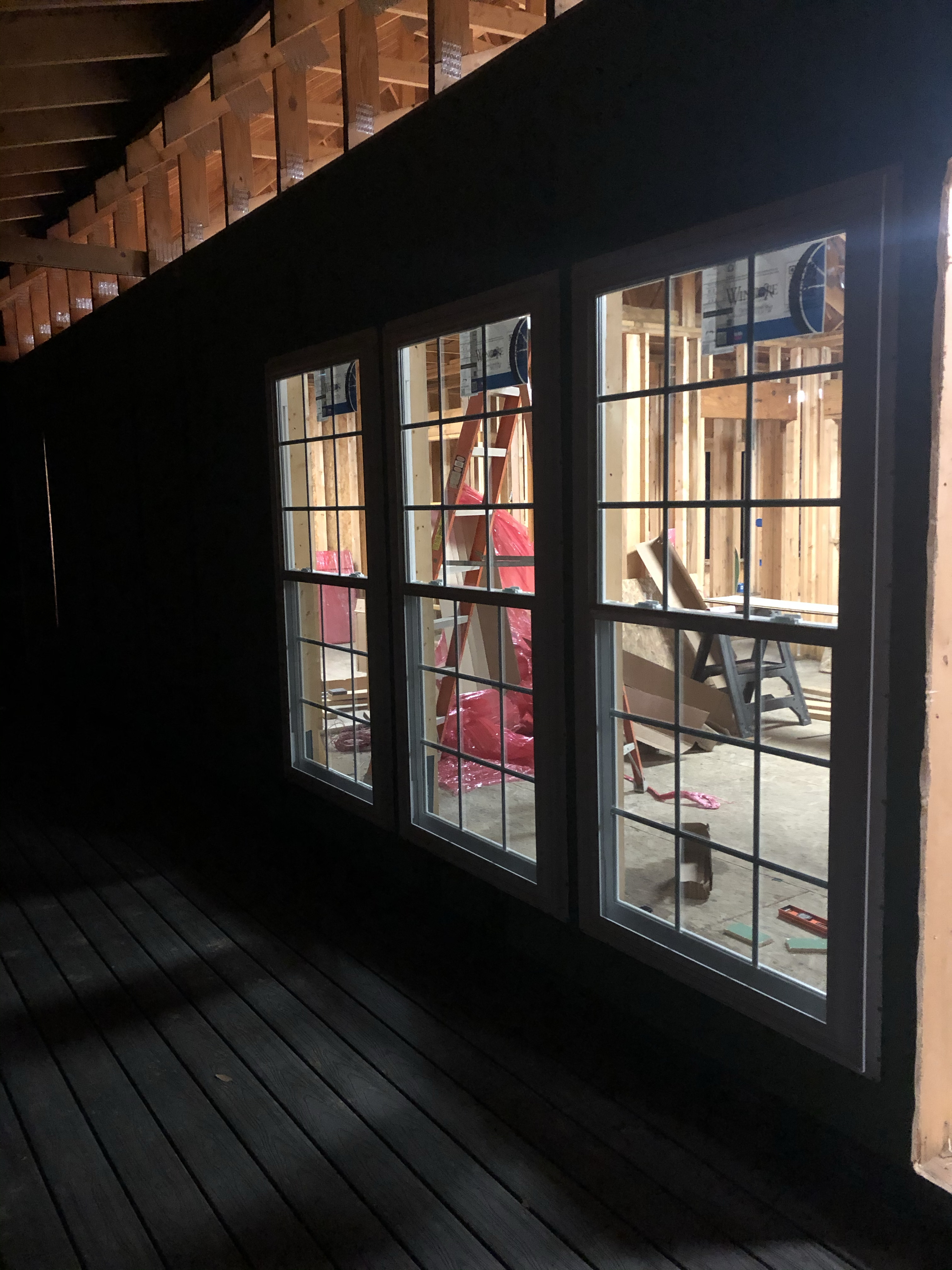

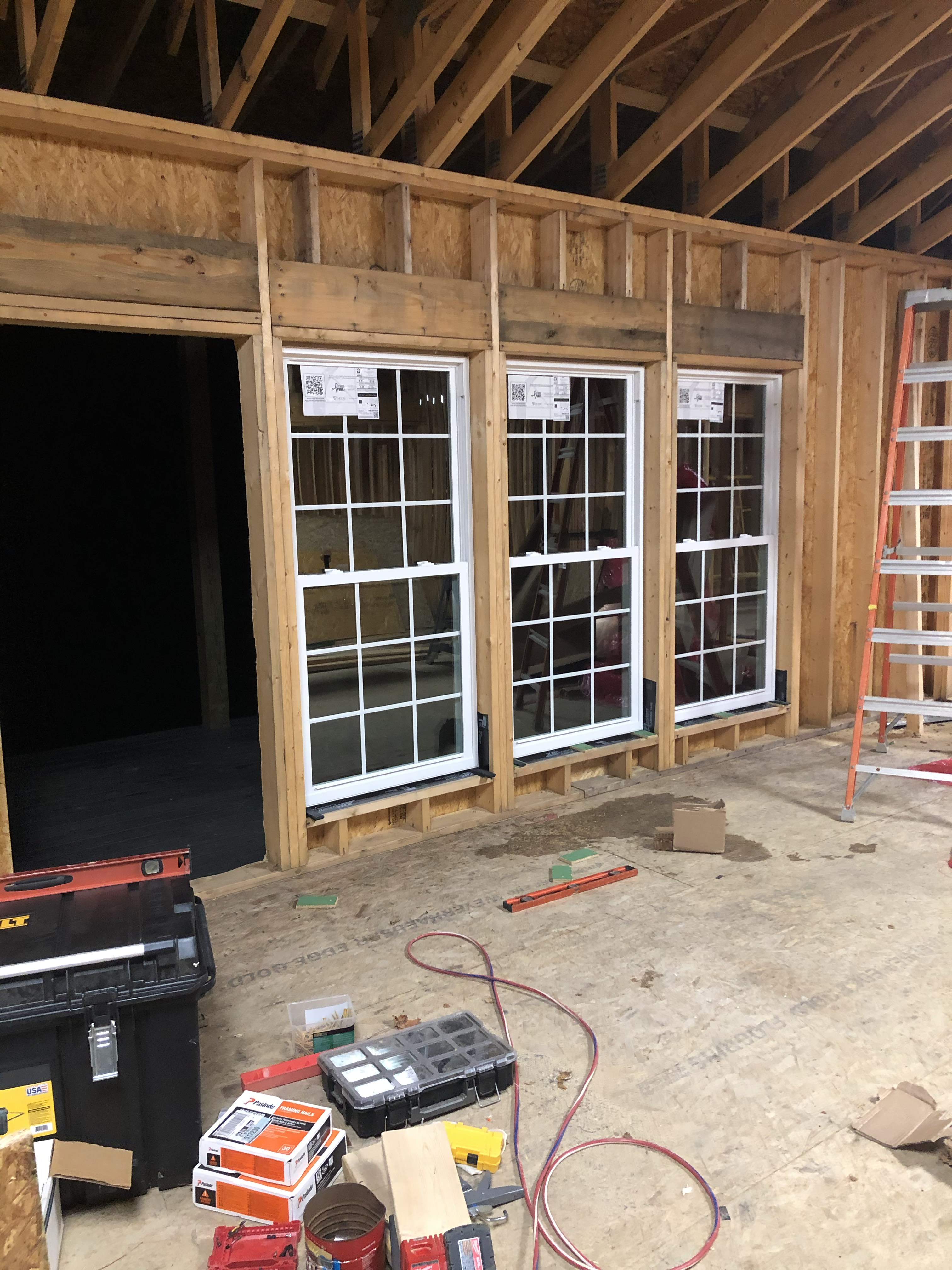

Electric service inspection passed without issue. Power company has been notified of the approval, so hopefully we will have power on in the next 2-3 weeks, depending on their back log.
Managed to install the 3 - 3’x6’ living room windows this evening after the inspection.
Meeting with a small local cabinet company tomorrow evening to discuss kitchen cabinets and get pricing. Then hope to install the 2 double windows on the front of the house.

Your windows look close to the floor, when I built my house in 2000 the windows had to be a certain distance above the floor or they had to be glazed with safety glass. I think it was around 20 inches. I would hate for you to find out after the siding is finished.
