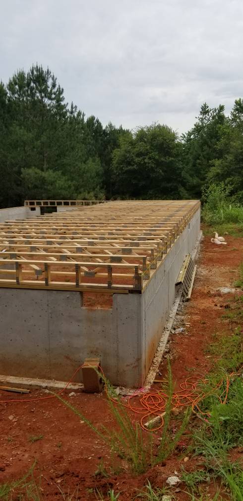

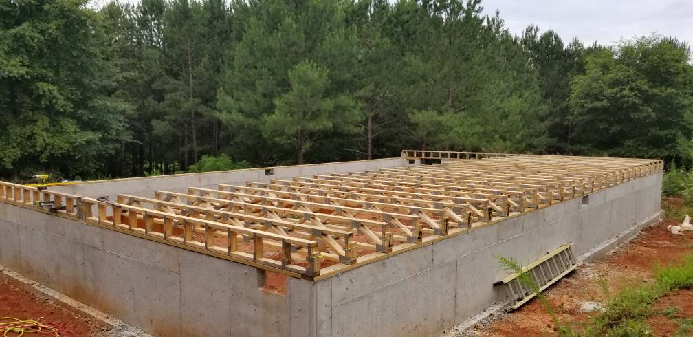

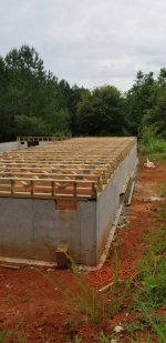

Told you it would be slow. But finally an update. A couple neighbors came over a few weeks ago and helped set the LVL floor beams. A friend came today and helped set half the floor trusses.
