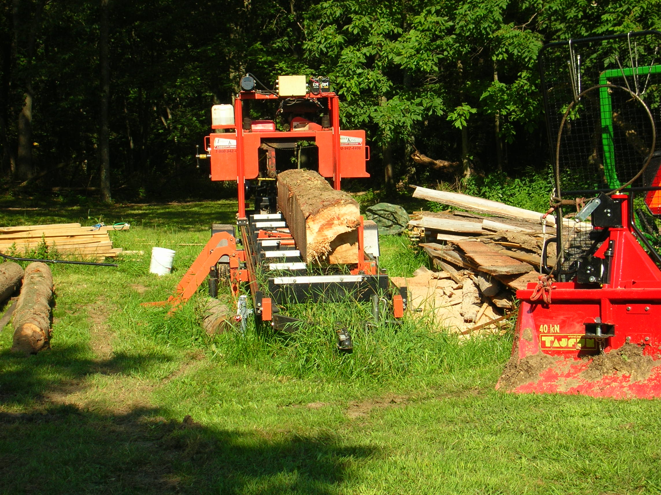

Q-Saw thanks for the comments, The sawmill was kept inside and it only has about 470 hours on it. I was planning to start on the sawmill building soon but I think I'll wait until Spring as hunting season will start soon and also I don't want it to turn into a job, It's supposed to be a hobby and I think I'll keep it that way. I do cover the mill with a tarp and maintain it well, it should still be in good shape if I get it under roof next year.
The winch does work extremly well and I think Tajfun is one of the best in the industry.

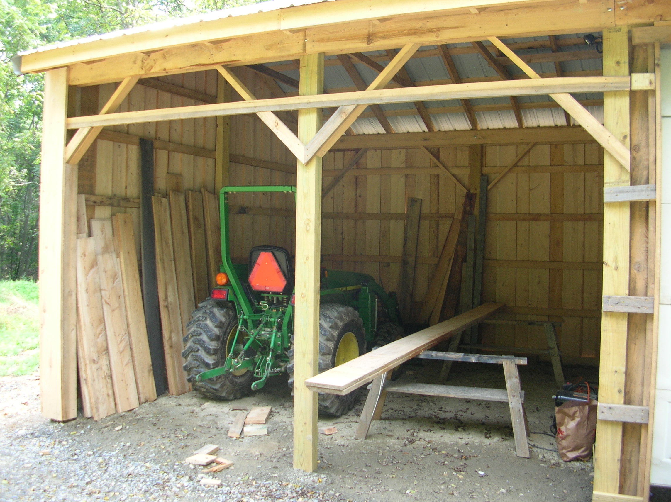

If you don't mind, I have a few quick questions. I may build something like this next year. How deep did you set the treated 4" x 6"s? Were there footings or did you auger a hole and drop them in? Were they set in concrete?
/ New Implement Shed
#24

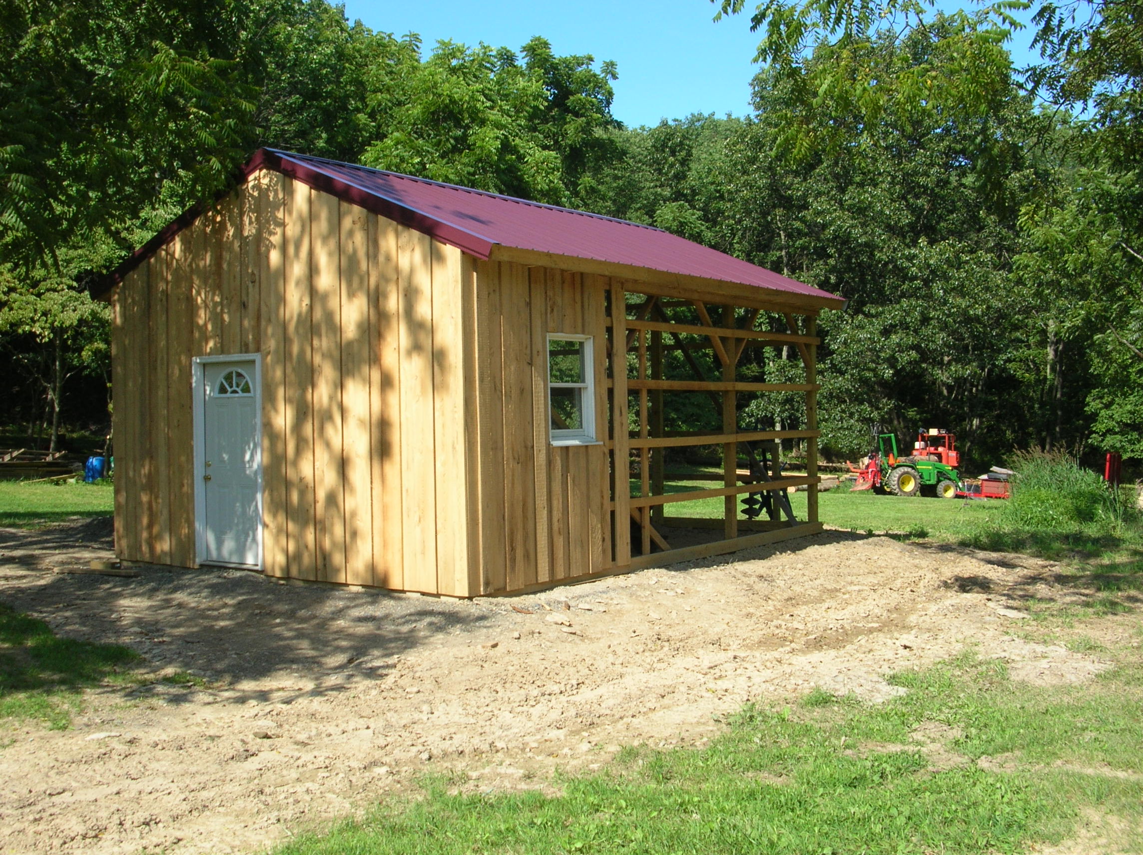

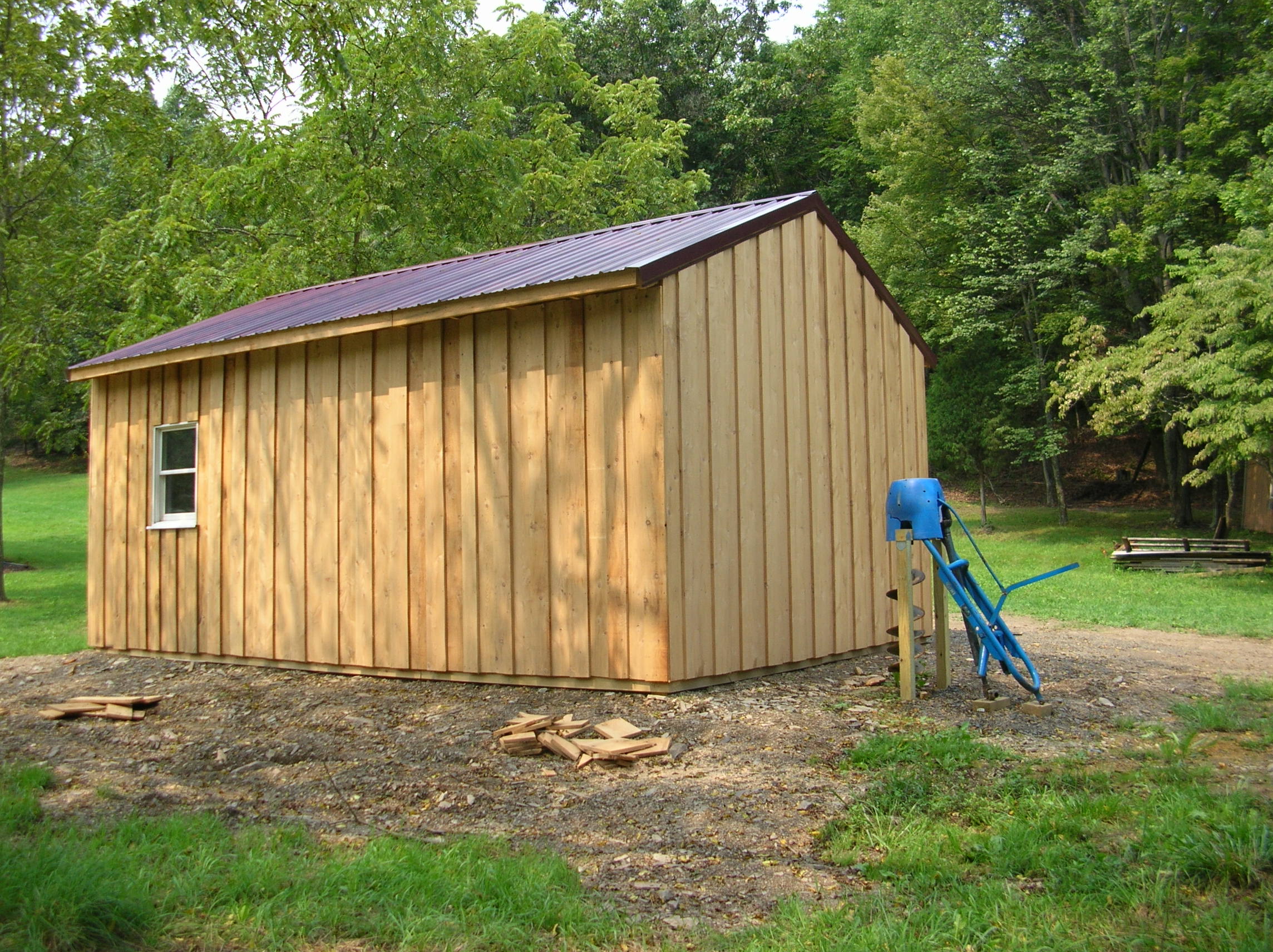

MN, the posts are set 36" in the ground on rocks with clay under that. I didn't think it was necessary for concrete under the posts because the clay is very solid. There are also alot of rocks tamped very tightly around the posts when we backfilled the holes.

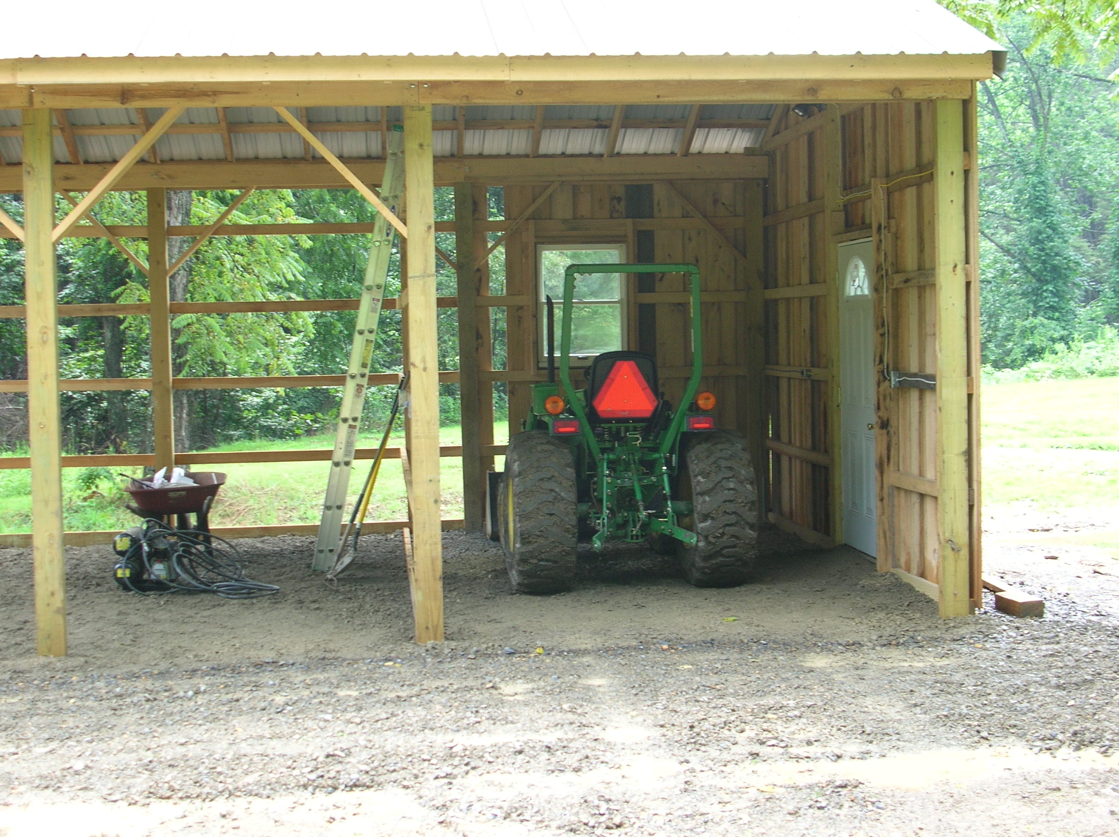

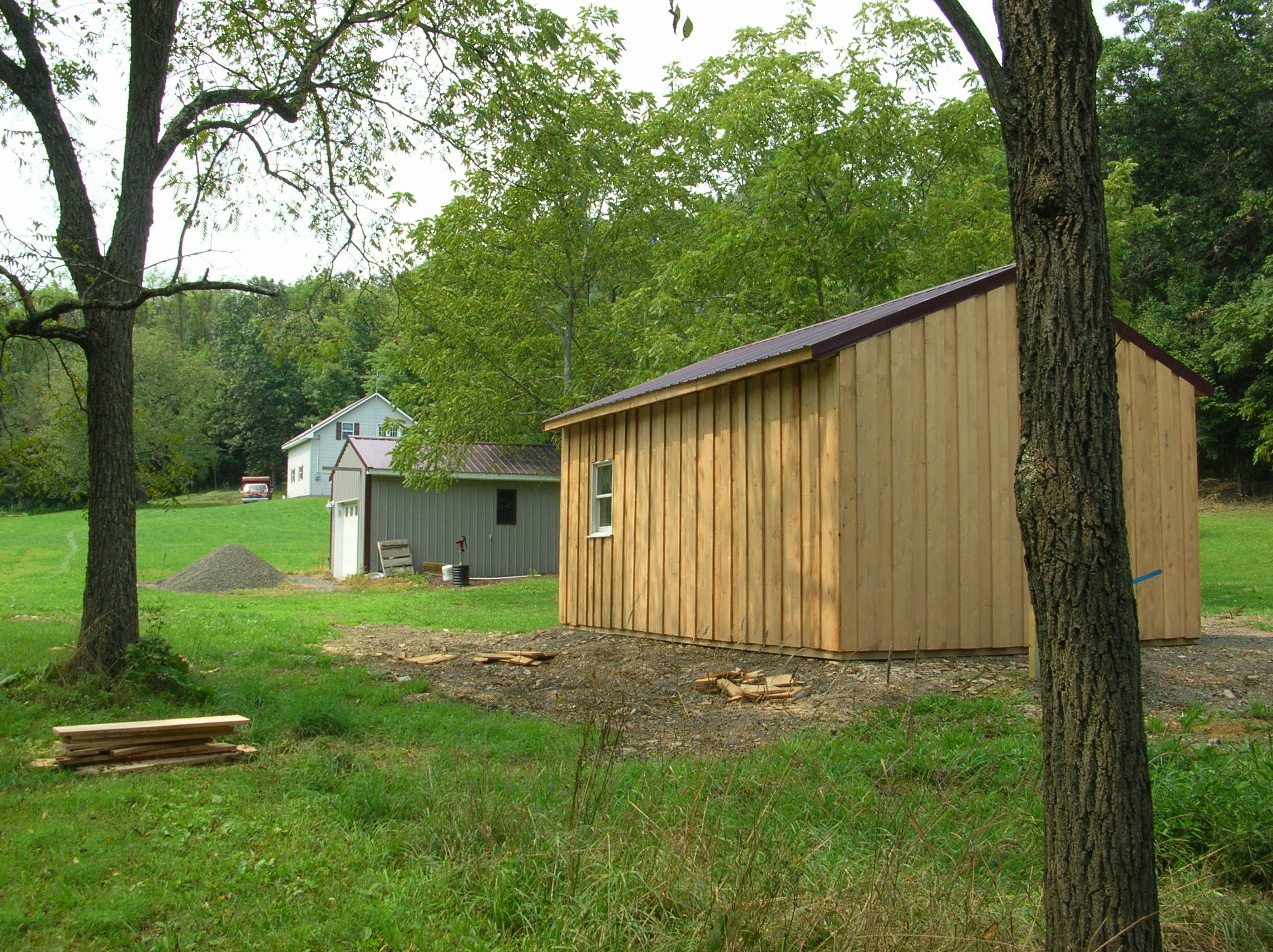

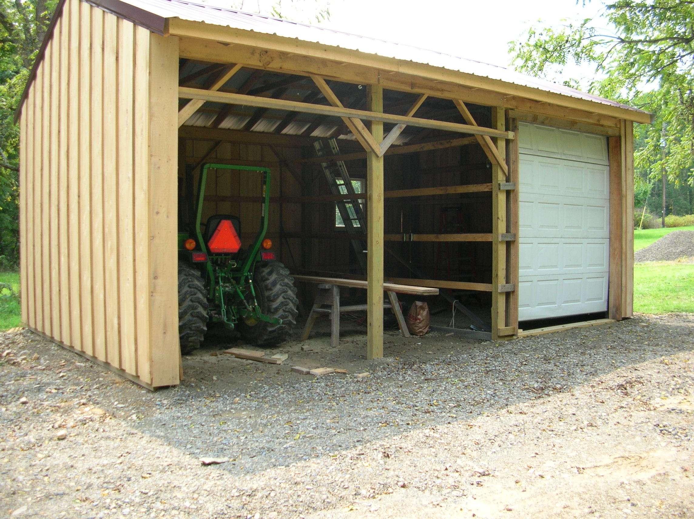

Last weekend my brother in law and I finished hanging the siding on the back of the shed and on the back gable end. I didn't get any pictures at the time but I got some this weekend, it almost looks finished when looking at the back of the shed.
This weekend a friend that I used to work with helped me frame out the garage door opening and hang the garage door. I need to get a new spring for the garage door as I bought it is used and only 1 spring was included with it. The springs that the hardware stores stock are for 7' doors and I need to get one for a 9' door. That is why the tractor is not in the tractor bay yet.
I need to finish the siding on the front of the shed and do some final grading and then I'll be finished just in time for bow hunting season.
DaMartin, did your spring come with the door? Just so you know a lot of doors that size and weight only come with one spring if it's a torsion spring set up. A good rule of thumb for a torsion system is to put 1 turn of the spring for every foot of dppr height. Red color spring is for left side mount and black is for right side mount. Tension applies as you lift up on the wind bars.

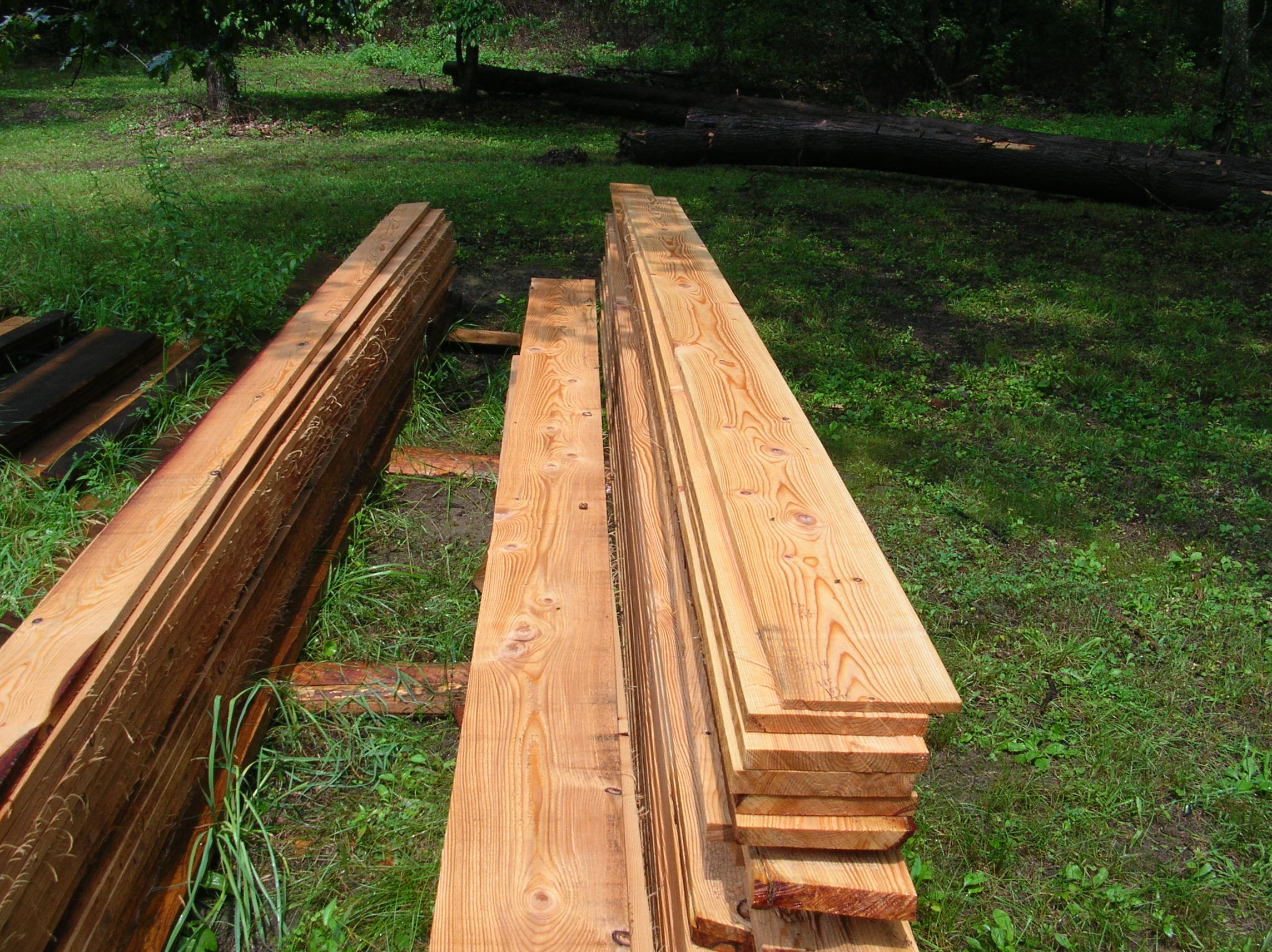

Nice job on that shed. I'm sure you will be glad that you did the boards the way you did them in about 2-3 years. Alot of the old timers built sheds like that around here, and they are still standing 40 or more years later. Like you have said, the old timers up here said not to let the siding touch the ground. They say it draws the moisture up into the board rotting the bottoms out first.
Builder told you right, I wouldn't seal those boards till the moisture comes out some. The old timers tell me that when they did houses and garages they would mill it and let it sit for about 2-3 years before using. That is the air dry method and will still leave lots of moisture in the wood, but who has that kinda time anymore? The wood will be exposed outside and will receive new moisture from various sources. I Think you will be fine if you wait to seal it next summer (probably july when its nice and hot and dry). September in PA is the foggiest month, and attempts to seal it now may prove fruitless (especially with it still being green).
How did you lay your boards? Crown out or in? Wood moves alot and can easily bend #10 screws. I'm curious, because there is a lot of discussion in my neck of the woods about the right way to lay vertical boards. Some say the crown doesn't matter, some say it matters if the boards were flatsawn or quartersawn, etc etc. Problem never solved, but lots of beer has been drank discussing it. On second thought, don't solve the problem:D
/ New Implement Shed #28
I'd rather have my boards crowned up. I prefer a hump to a cup, especially on a deck or probably on barn siding. Your 1x2 batts will also not be driven off your pole barn framing if they're humped. Cupping will drive the batts off.
1/4 sawn is more expensive/board foot, but won't shrink or cup, twist as much.
We use a lot of eastern pine and spruce. Cypress is the upgrade for barn lumber around here.

The springs are extension springs so I will need 2 of them, I'm still looking for a place to buy them. One place that has them will only sell them if they install them and the other place wants $45.00 each and the place I found online wants a check mailed before shipping them, no credit cards. I am going to check at another place tomorrow that I think will have them for a reasonable price.
Builder, I buried some rebar welded to a peice of C channel under the middle bay joist that I can fasten some chain with hooks on in order to skin deer using a chain hoist fastened to the joist above it. I hope that I get to use it soon. By the way I enjoyed reading your thread on the garage that you built with the covered walkway, I would love to have that garage at home.
I always lay the crown of the board up when building a deck but didn't even think about it for the vertical siding. I just put the side with the nicest grain out.
Maybe I'll get some bowing both ways. I know that there are alot of barns near my home (Lancaster County) with Hemlock siding and the the boards are not bowed much at all. I could be wrong but I thought that hanging vertically, the boards would stay relatively straight.

I think you'll be fine. I'm overly picky and I get paid to think about stuff like that. You're right, in the vertical position, it's not as critical. I just worry about the wetting/drying cycles. Don't second guess yourself-when installing vertical siding, facing the "show side" out is actually the best way.

cupping with your boards can be minimized in several ways. avoid wide boards. flitch boards should be used for bats, go with a thicker board. use long ring shank nails and be generous during the installation. after installation,spray with a blend of primer or sealer to slow down the drying process. rapid drying and uneven cure can make the boards cup.
