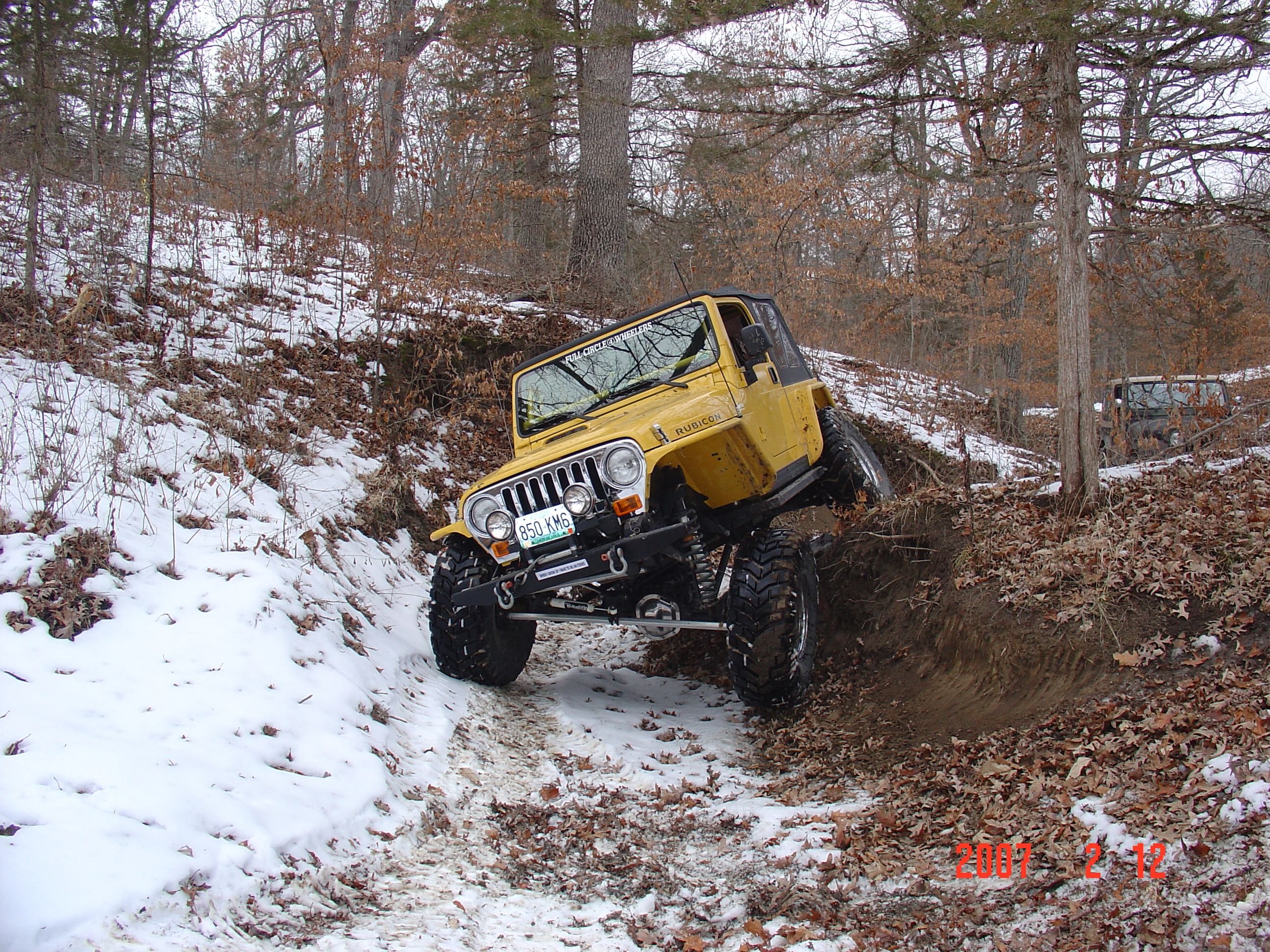

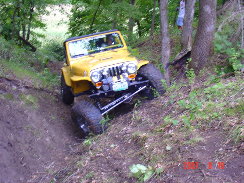

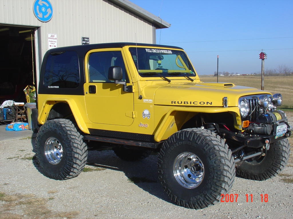

Thats gorgeous! What engine is in that? Id love a jk.

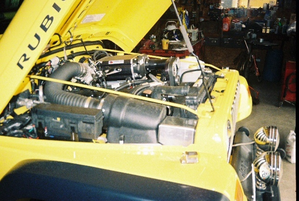

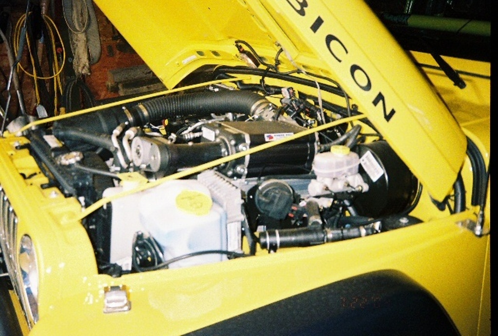

Missouri has Inspection Laws. Number one rule is the engine has to be offered in the vehicle. I wanted to do a V8 swap but couldn't. So I added a Kenne Bell Supercharger to the I-6 4.0L.
Good farmer friend of mine just bought a JK 4 dr. He wants me to help him decide modifications. Lots of fun spending someone else's money. :)

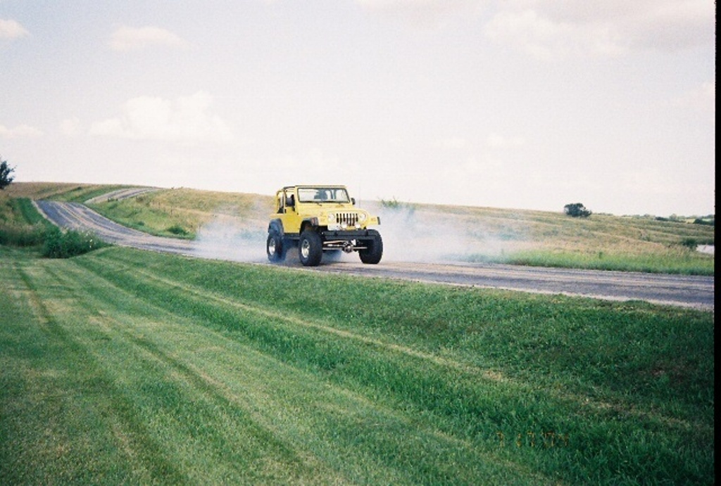

Yep, Kenne Bell. It was the first unit they sold for the I6 4.0L. Didn't have any problems with belt stability. Had a couple issues with the PCM programming. But they were great to work with. I had to send the PCM to them. They paid shipping. First problem was it lacked power in mid range such as cruise control set going down Interstate at 70mph. Second problem was high elevation, it gave it too much fuel. I'm at 1000ft. It ran like crap at 9000ft and up. They got both issues programmed out of it and I loved it. It would white smoke those 37" tires with only problem being keeping it out of the rev limiter.

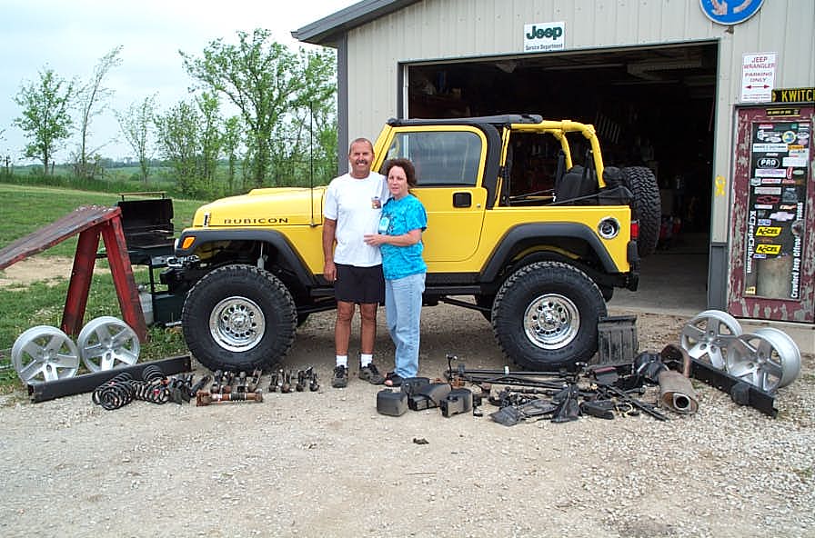

I bought that Jeep while I was in Iraq. My Son hauled it to my shop. When I got home six months later it was sitting there with all the stupid stickers and plastic still on it. When it had 79 miles on the odometer I set it up on jackstands and cut all the suspension out from under it and installed a Tera Flex long arm kit.
Including the SC I had $20K of modifications added to it. When it burned it had 18K miles on it. I sure had fun with it but don't think I'd go that route again.
Here's a pic of the factory parts we swapped out. That was before we swapped the fenders.
