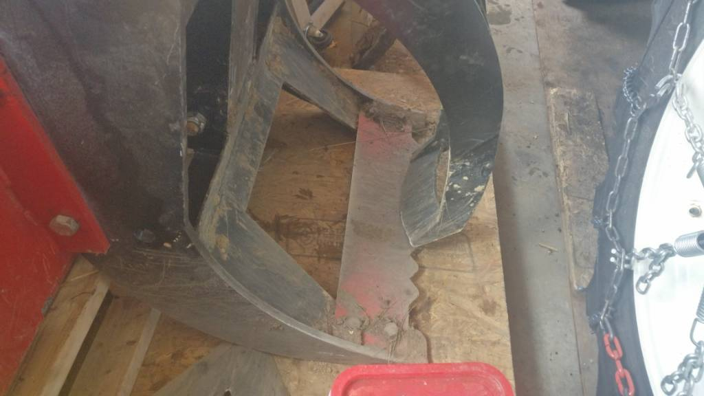

I'm now looking at bobcat CT4045 with Ag tires. 3,745 pounds which would be more once I add fluid to tires and a box blade. 44.9HP. You guys think this would be reasonable for my property? These things wouldn't be one time, I will also come up with new ideas to do.
I really like that frostbite grapple. I could concentrate on just 2 tines going into ground then a bunch more that wouldn't be needed. Issues I could see is if the rock was too small to fit between both while popping it out. If I used one side could I warp my loader arms or warp the frost bite grapple, taking into consideration I take my time and not ramming it? Assuming it's still great for moving brush piles.
The frostbite style grapples have an easily removed plate that spans the two lower tines (see picture). That allows you to pinch, and pick up rocks the size of softballs (depending on operator skill ). In the picture, the top clamshell is contacting the lower plate in it's current orientation. A camera mounted to the grapple makes it much easier to see what you are doing.
Or it can be removed to make the tines dig in easier. I leave my plate on pretty much all of the time as I've had no problem getting under rocks and popping them out with it on, and it makes it easy to get the smaller ones out.
I have a similar sized tractor (LS XR4145) with a loader with max lift capacity of 2,700 lbs at full height. With the grapple I've never been worried about twisting the loader. The tines are spaced close enough it's almost a non-issue (I imagine if you tried to pick up a massive rock so it's cantilevered out on one end, you could run into problems).

Sounds like a good plan to me. Could always add a backhoe later if the grapple doesn’t work out.
