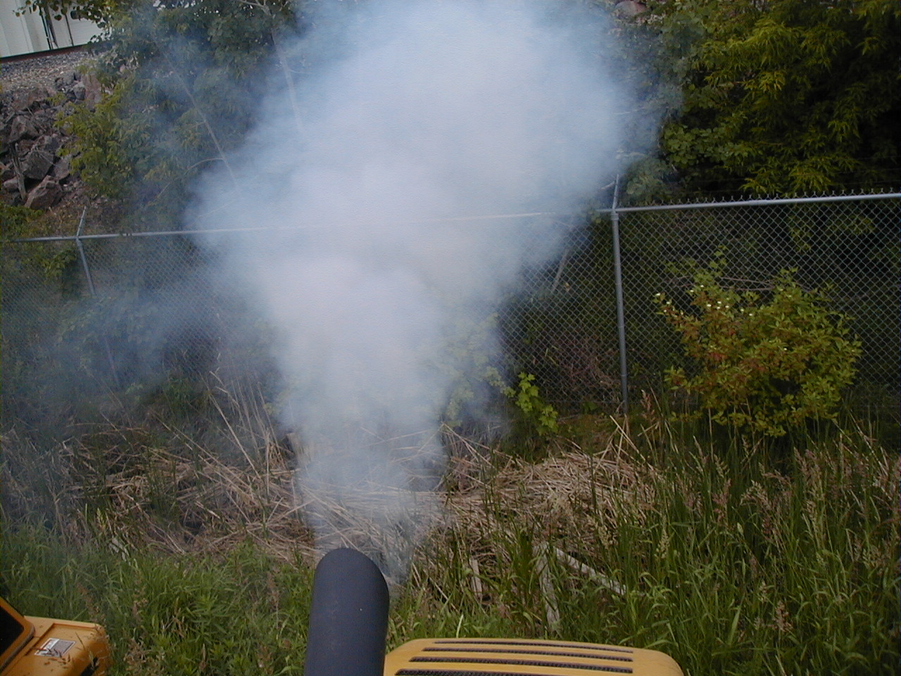

Almost forgot, if you are interested in what the white smoke from a blown head gasket looks like, this is an engine running at low idle 2 minutes after start. It is a larger engine, a 4.4 liter 130 HP mechanical fuel injection engine.
