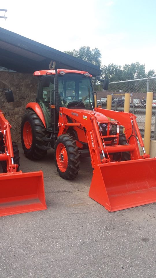

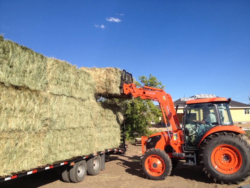

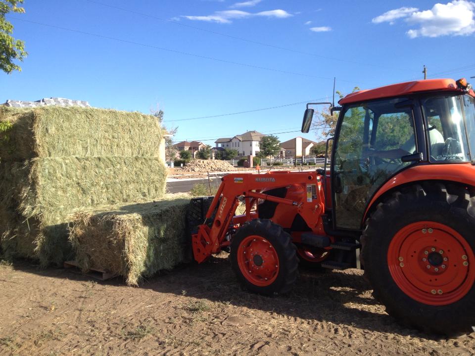

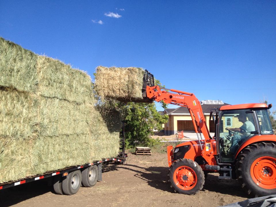

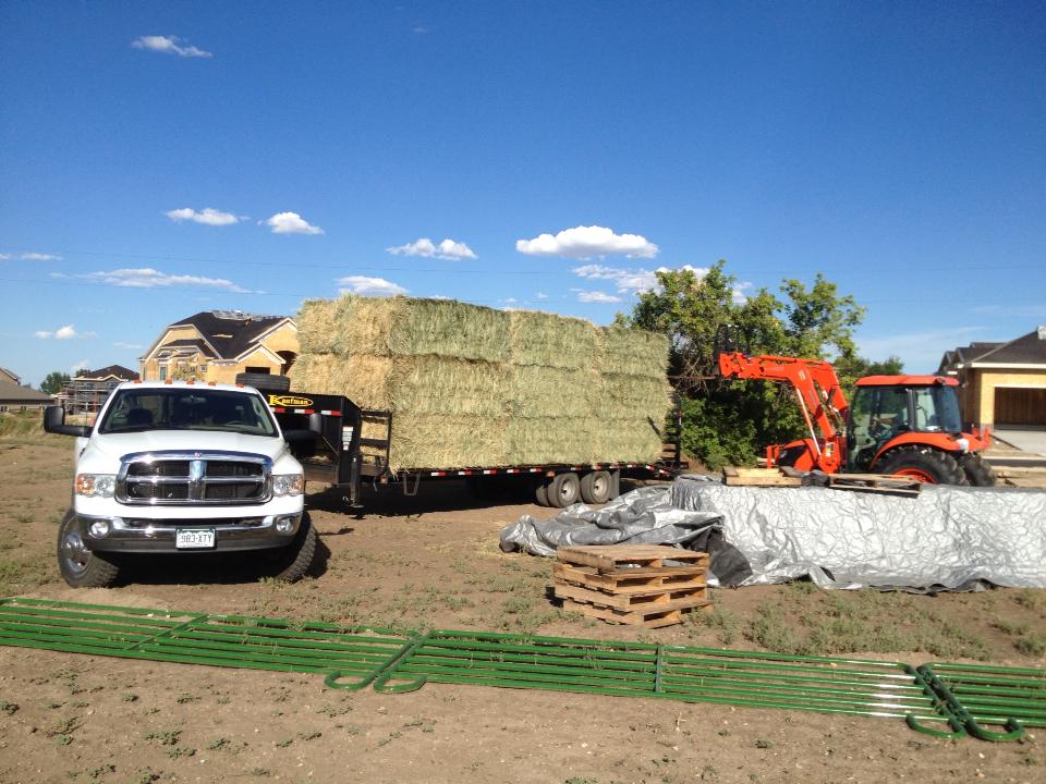

Well brought her home yesterday and put it to its first test load today. 3x4's 900# one at a time, no ballast. Rear was a little light (less traction) when changing directions but didn't feel unsafe. I'll surely need ballast for 1600+ lbs but overall very happy with the tractor. Only issues I've noticed are that the "Quick attach" jams up with the stock bucket and random pallet forks. Real PITA and the shifting from high/low range is very stiff. Not sure if this is normal. I need to push so hard on the lever I feel like I'm going to break something. (Will prob post about this in another thread).
Paid $43k. 7040,hydro,cab, LA1153, air ride seat, 3rd function, single rear scv, rear wiper, cast iron wheels.
912143_10152492896001758_1522132232_n.jpg1208478_10152492895966758_297842585_n.jpg1232654_10152492895981758_1914136213_n.jpg1237779_10152492896266758_1543340177_n.jpg
Over all, I'm extremely pleased with the tractor so far. Perfect little tractor for unloading squares. Will do some dirt moving tomorrow. Took these 3x4's off basically at idle. Hydraulics had plenty. Tried lifting trailer but the rear started coming up haha.
Thanks everyone for the help. Certainly pointed me in the right direction and took some of the stress out of the purchase!
