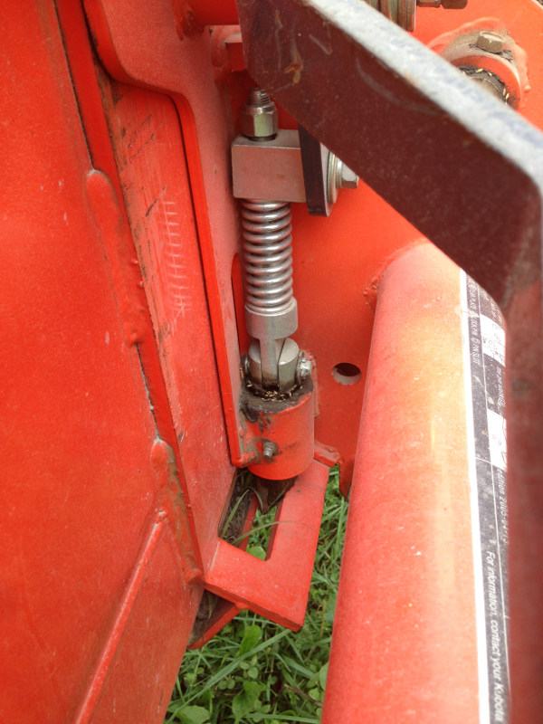

No pushing to either side just back and forward, sometimes if you just move it back and forth a few times it will go in. You will get the feel for it after a while.
It can take a lot of force for the SSQA levers. Make sure the quick attach pins are well greased. The only time I have really had trouble is when they needed grease. Attachments from different manufacturers may fit a little differently. My Kubota bucket is harder to get on than the CID bale spear.
Nice tractor. I'm really wanting a cab now!

The 7040 shifts fine, just a bit of a clunk to it.
Are the skid steer levers supposed to be really stiff and such a pita? I was jumping on the bucket, kicking the **** levers etc.. I've only used the power quick tach but that dont seem normal.
Hi-lo gearshift is easily accessible and merely is designed to just move it back-n-forth. Have you greased the skid steer attachment linkages?

I also noticed there seems to be a gap between the bucket and the SSQA plate. It doesn't sit flush like the one in your picture B hoofed, despite jumping on the bucket but looks as though it should accept the pins even with the gap. I was in a rush yesterday but I think its the pins binding, hopefully the grease helps. Thanks

Was the bucket on the ground? It helps to lift the bucket and curl back to seat the plates before engaging the pins.
