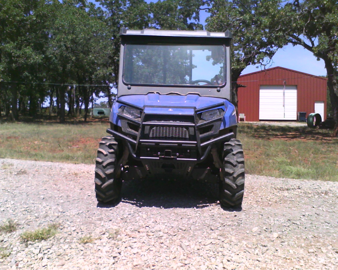

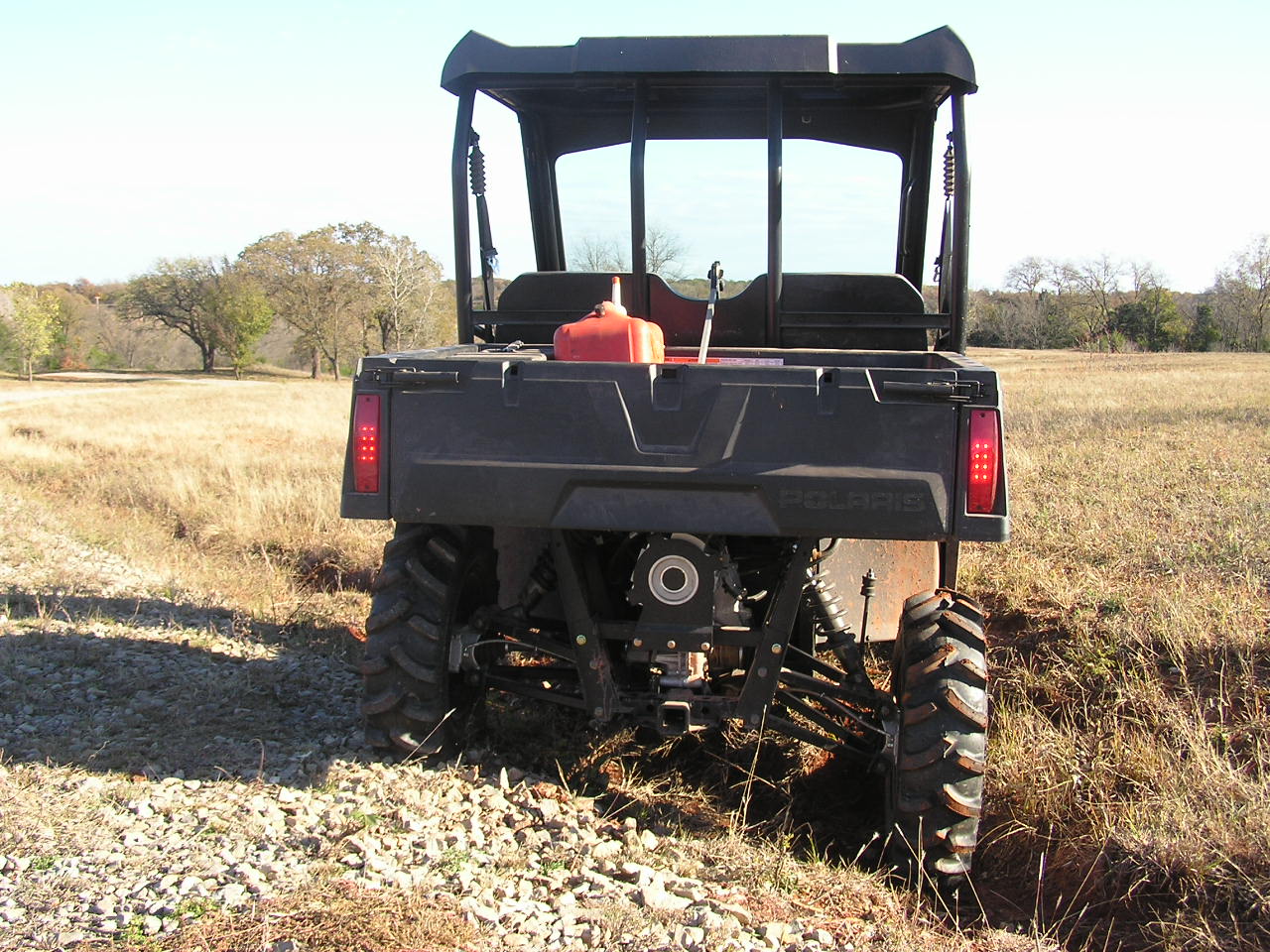

I also prefer R1 tires, even put them on our UTV. :D
