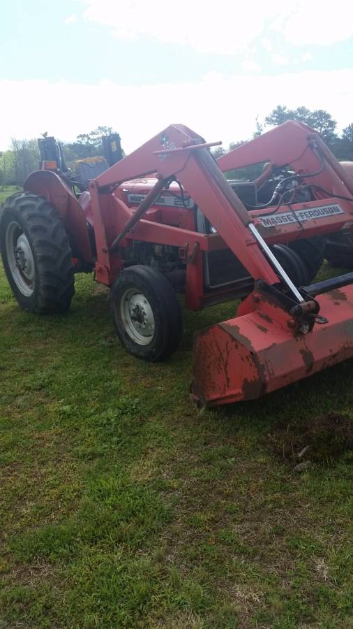

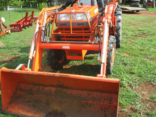

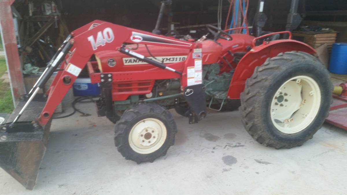

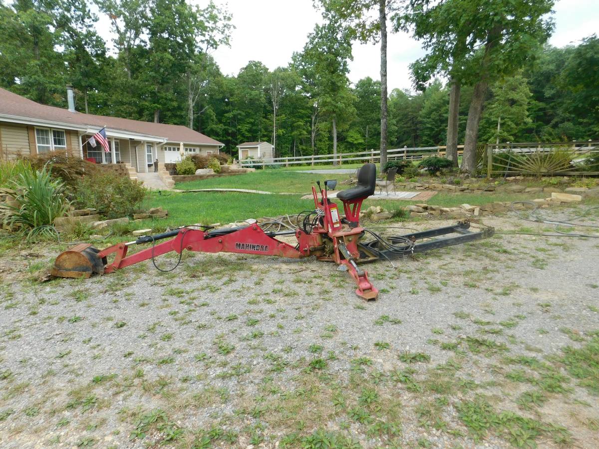

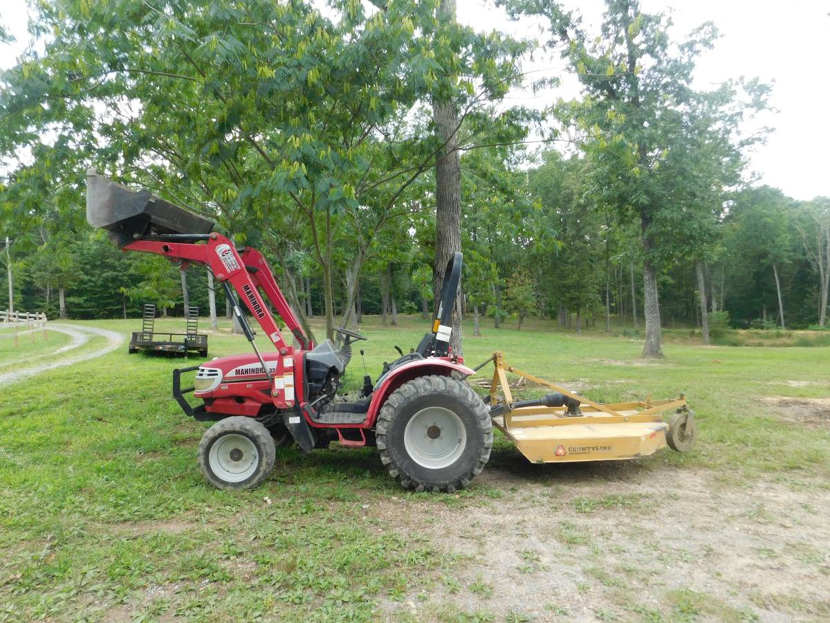

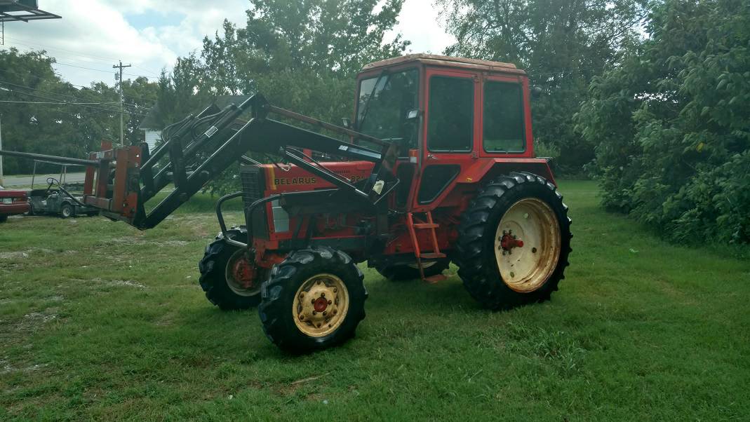

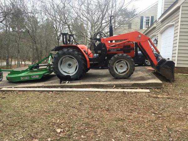

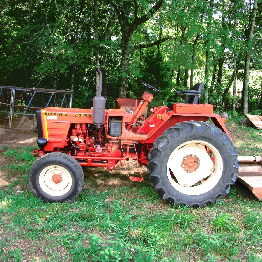

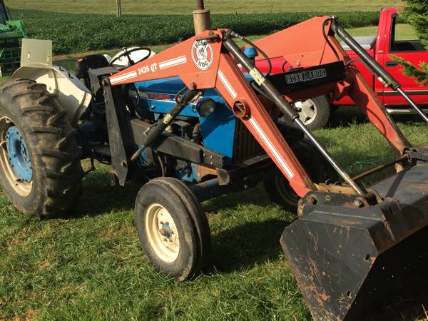

Here's some pictures: 1. Agco Allis 5650 48hp 4x4 w/loader Agco Allis 5650 4x4 48hp loader bushhog.jpg , 2. Belarus 825 100hp 4x4 loader Belarus 825 4x4 100 hp.jpg , 3. Yanmar YM3110 loader 2x4 40hp 80's model Yanmar YM3110 4x4 loader 37hp.jpg , 4. 2010 Mahindra 3316 4x4 hydrostatic loader & backhoe attachment Mahindra 3316 4x4 with backhoe & loader.jpg Mahindra 3316 Backhoe Attachment.jpg , 5. Belarus 250AS 2x4 bushhog Belarus 250AS with bushhog 2x4.jpg , 6. 1996 Massey 253 loader 2x4 1996 Massey 253 loader 2x4.jpg , 7. Kubota L3000 4x4 loader 35hp 185hrs Kubota L3000 4x4 loader 32hp.jpg , 8. Ford 4000 2x4 loader Ford 4000 loader 2x4.jpg .
These are some I've found within driving distance that I am considering. But again, I am open to suggestions based on lower COG, wheel width, HP, 4x4, loader, etc... i'm not opposed to looking at newer used tractors but have looked & all I see is subcompact (1,000-2,500 lbs.) and I, knowing nothing about them would think they would be more likely to tip/flip than a heavier tractor but maybe I'm just use to driving an old Ford 4000 that weighs a ton!
What tractor manufacturer & model offers the lowest COG & widest stance in 4x4 that allow for widening the wheels (aftermarket spacers or hubs/rims that are adjustable)?

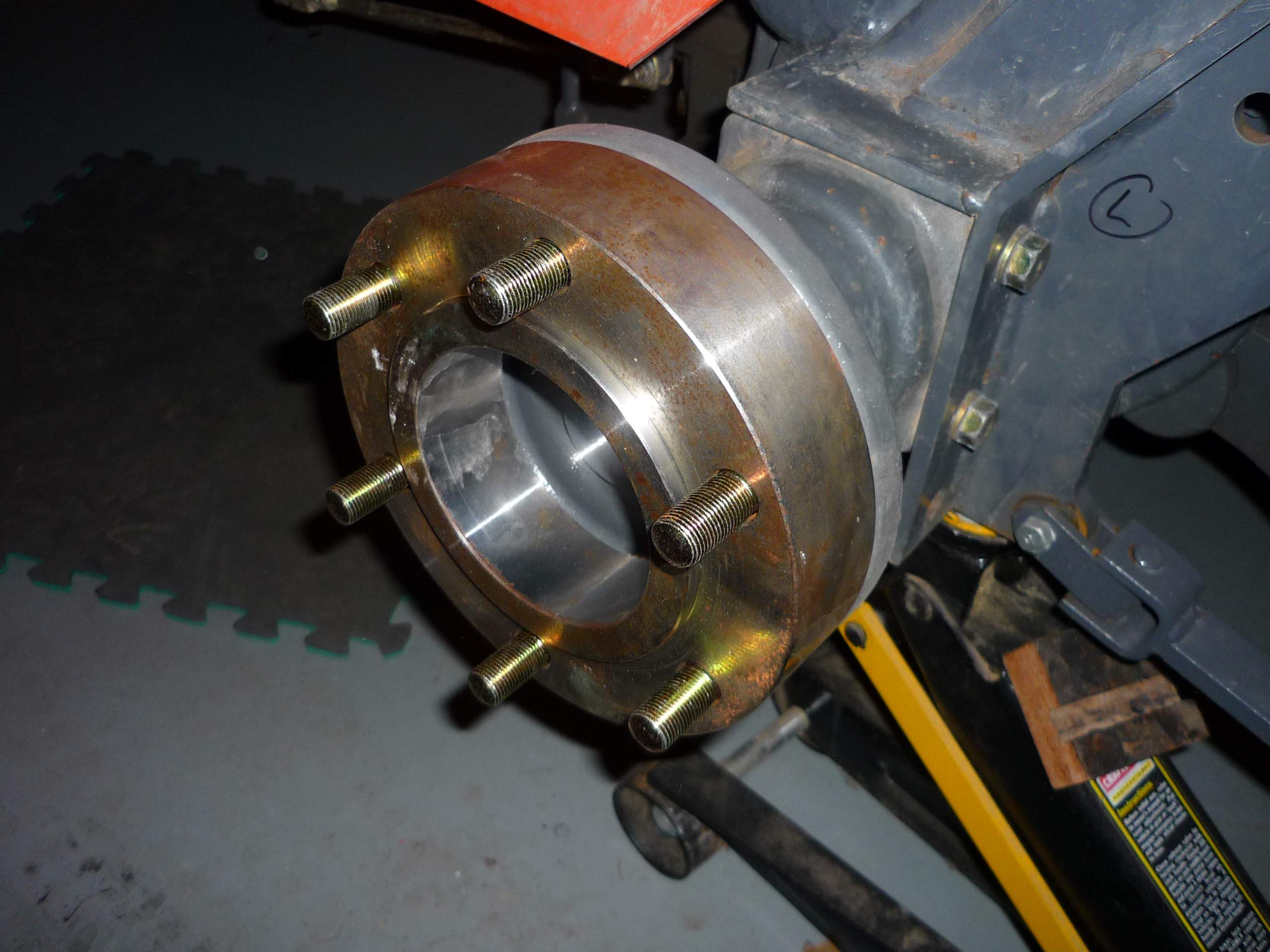

For stability, for a given tractor, nothing beats a wide stance. Many rear wheels are reversible, or if not, spacers could be available. For example, the rears on my L3400 Kubota are not reversible, but with 1.75" spacers, things are greatly improved. P1010765.jpg That, and keeping any loader weight LOW when traveling.

The reason you haven't gotten many specific replies is that most CUTs of a given size are pretty equivalent with regard to COG and wheel distance. Wheel spacers are probably more easily obtained for JD and Kubota based on volume but you'll find that other brands often use Kubota or JD standards on wheels anyways.
Most of us wouldn't buy a compact utility tractor based on COG as the major determinant. Get a good tractor and set it up with appropriate ballast and maybe spacers. Then do your work up and down the hilly bits instead of across the slope.
