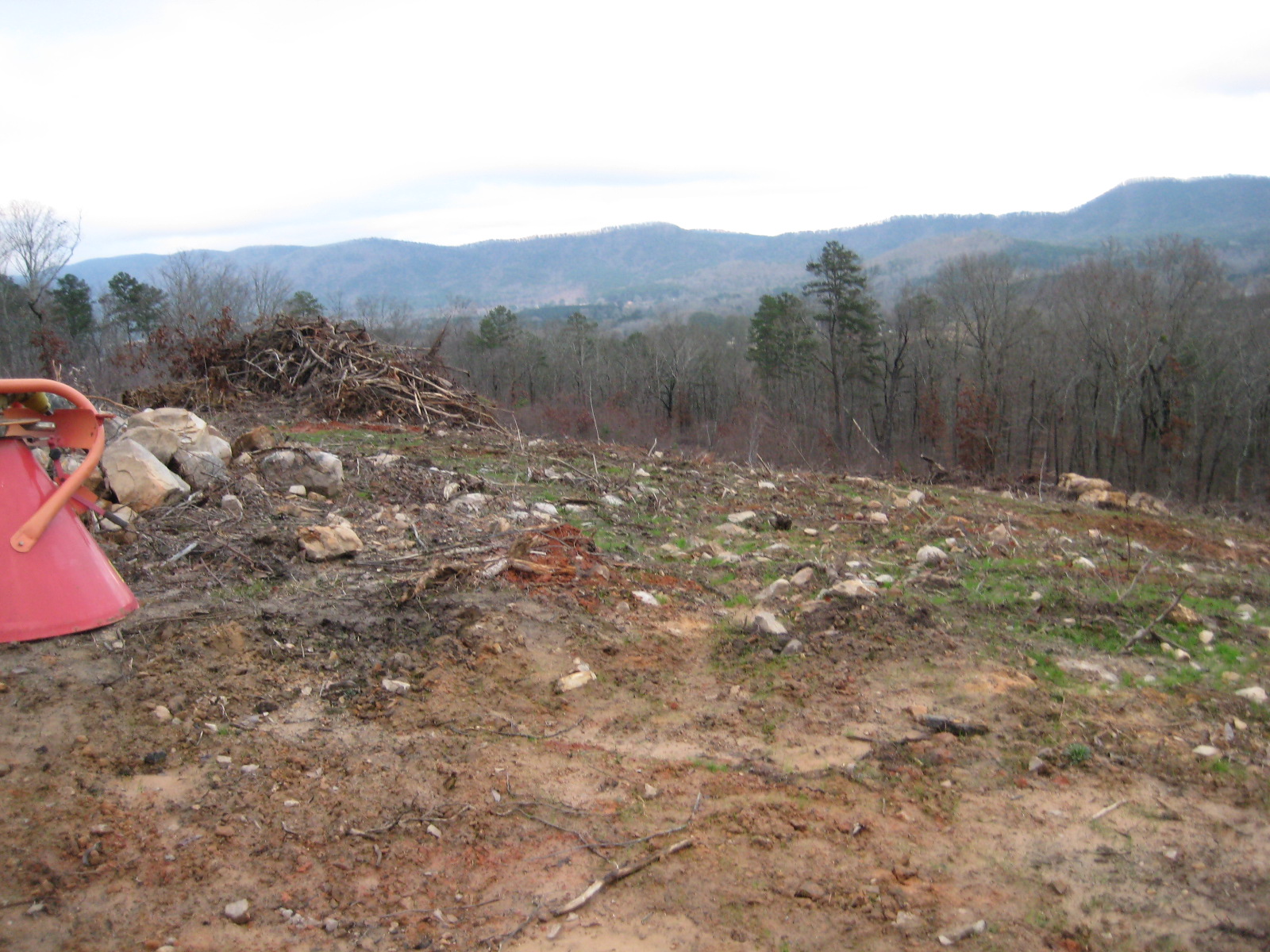

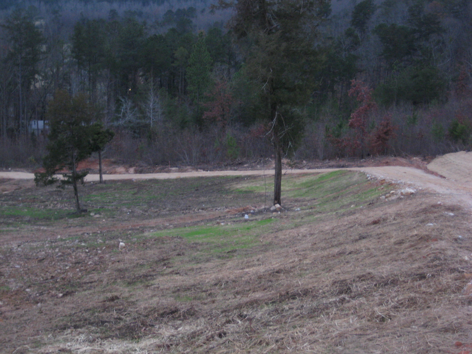

I have read ALOT of threads & posts but with so many opinions & particular type of land it is hard to get the right info. I need before purchasing a tractor. I recently purchased 18 acres that is basically a mtn. in NE Alabama (in AL it is considered a mtn. to others it might be referred to as a hill). I had the top (50 yds. wide) & the front side dozed with four horizontal terraces cut in about 100 yards apart & now I need a tractor that I can spread seed with as well as bush hog once grass grows & dig the dirt out of the terrace grooves from the rain pushing it down. My question is since the steeper areas are +/-25 degrees I need to know what "tractor" (not interested in the front end mower on steroids) is best for me. I have read posts that describe: 1. the heavier the better, 2. the lower profile the better, 3. 4x4 better than 2x4, 4. liquid filled rear tires, 5. Rear tire axles that allow to move tires in & out & can add spacers, 6. dually rear tires, etc... I have looked at numerous tractors but having problems deciding which would be the safest, less likely to tip, etc... I have found: 1. 2000 year Agco Allis 5650, 4x4 that has a bucket (800 hrs), 4500 lbs., 50 hp, AG tires; 2. 2010 Mahindra 3316 HST 4x4 with a bucket & 16" backhoe attachment, 2,566 lbs., 30 hp, AG tires; 3. as well as numerous 4x4 compact or subcompact that weigh less the the previous two. Therefore, I need to know what are the most important things I need to be focusing on (weight, height, 4x4, whether the rear axles will allow tires to move, rear axles accept dual tires, etc...) I have attached several pics of the land from the bottom looking up to towards the top & vice-versa. IMG_3535.JPGIMG_2945.JPGIMG_2947.JPGClearing.JPGIMG_3539.JPG

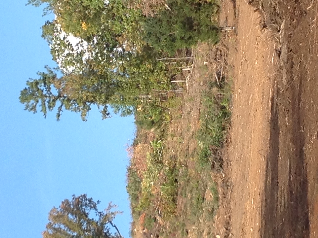

Pictures are so deceiving. To reflect the steepness of a grade, stand at one end of the opening about halfway up the grade and shoot horizontally across the face. Try to get a tree in the pic and turn the camera until the tree is vertical in the view finder.
25 degrees is pretty steep. I'm in steep timber land a LOT with my tractors. Don't have an angle finder onboard so can't confirm any of my slopes.

I honestly don't see any 25 degree slopes in the photos. Looks pretty much like the hill I mow which I measure as about 12-13 degrees with an inclinometer. That said, my sphincter meter goes off at about 10 degrees on a slope with hard to see holes and bumps. I simply mow up and down which simplifies matters greatly and allows faster and safer speeds.
If I really needed to mow 25 degree slopes, I'd get an articulated tractor rather than a big CUT. Having said that, I wouldn't hesitate to mow the land in your photos with my Kioti DK40se which is just a bit bigger than the Mahindra you listed and smaller than the Allis.
You do have a lot of rocks! Must be in the northeast if I remember my geography. Those pictures could pass for New Hampshire or Massachusetts given all the rocks.

Perhaps you meant 25%? That's 1 in 4 or about 14deg. MUCH more manageable with a big CUT.
25deg is closer to 1:2. That's a one foot rise for every 2 horizontal feet.
25% still feels pretty steep especially on a tractor...
