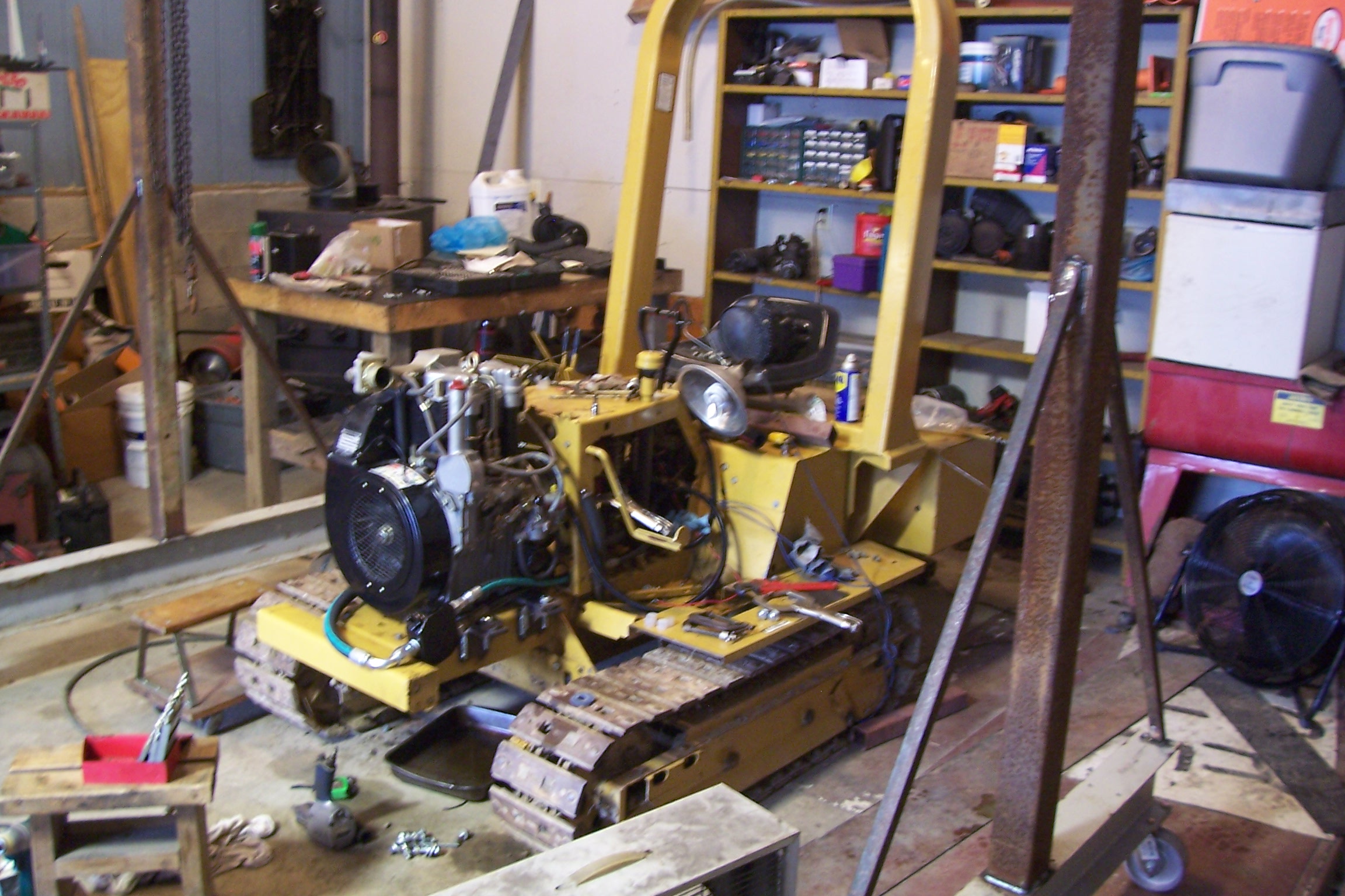

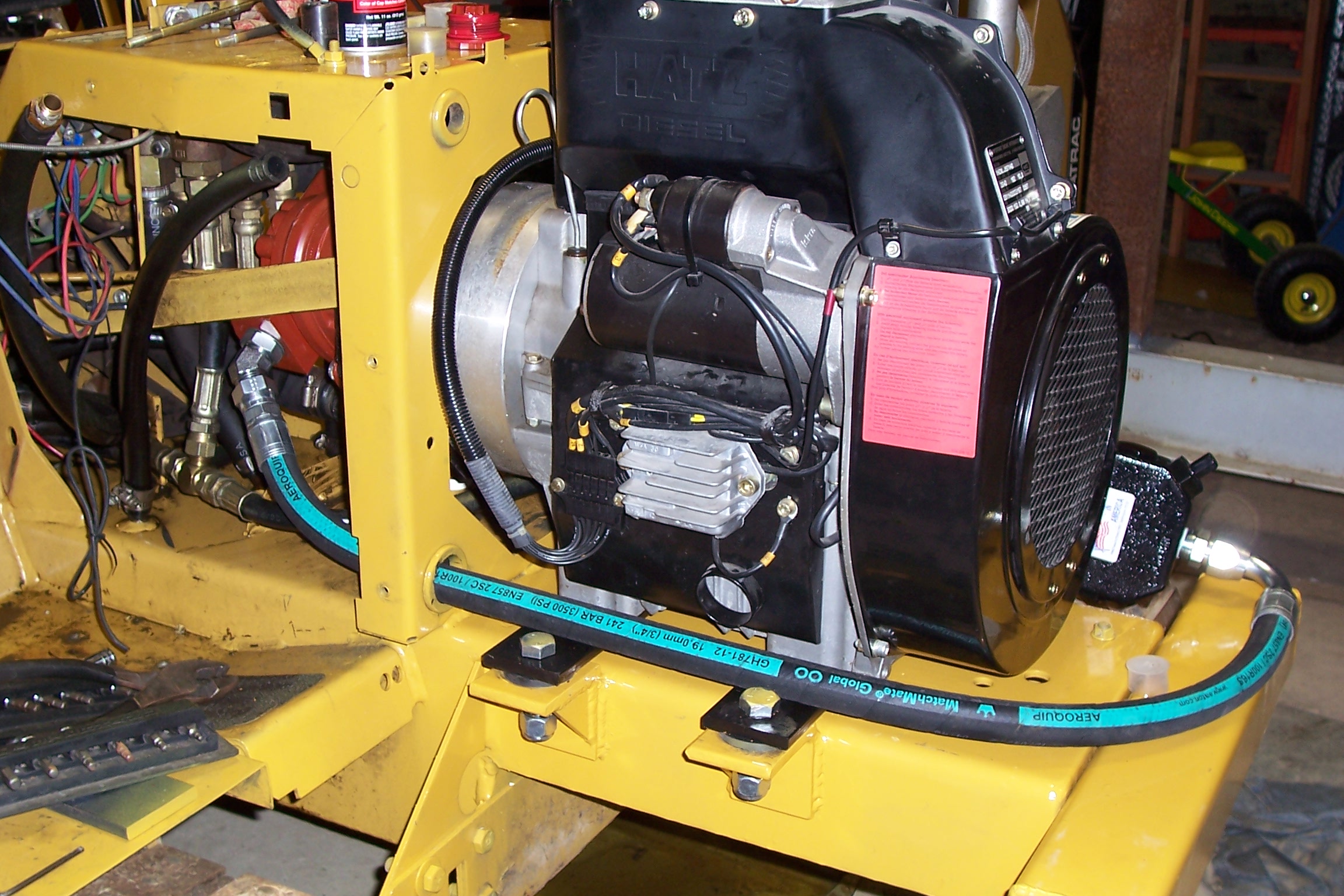

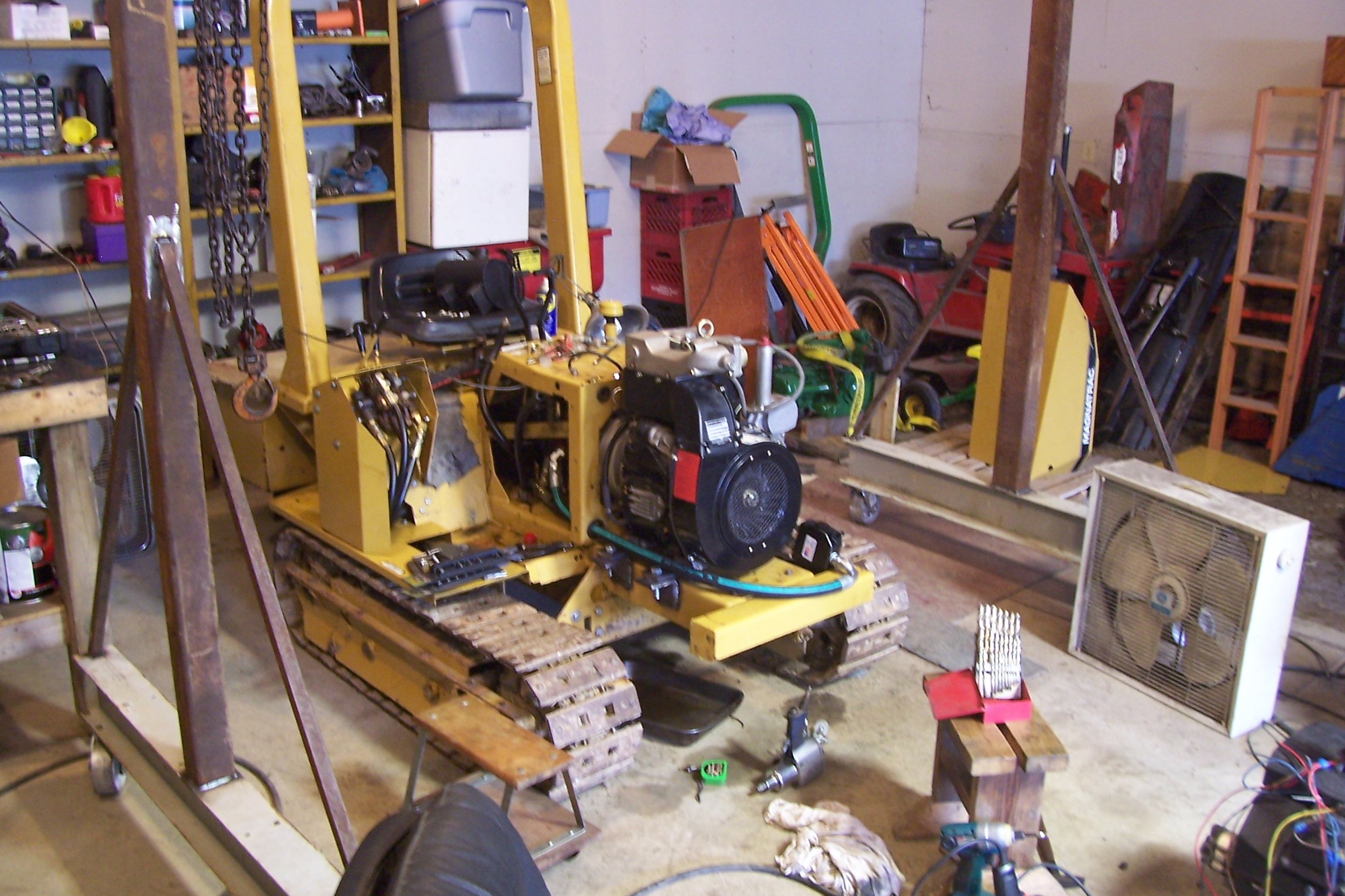

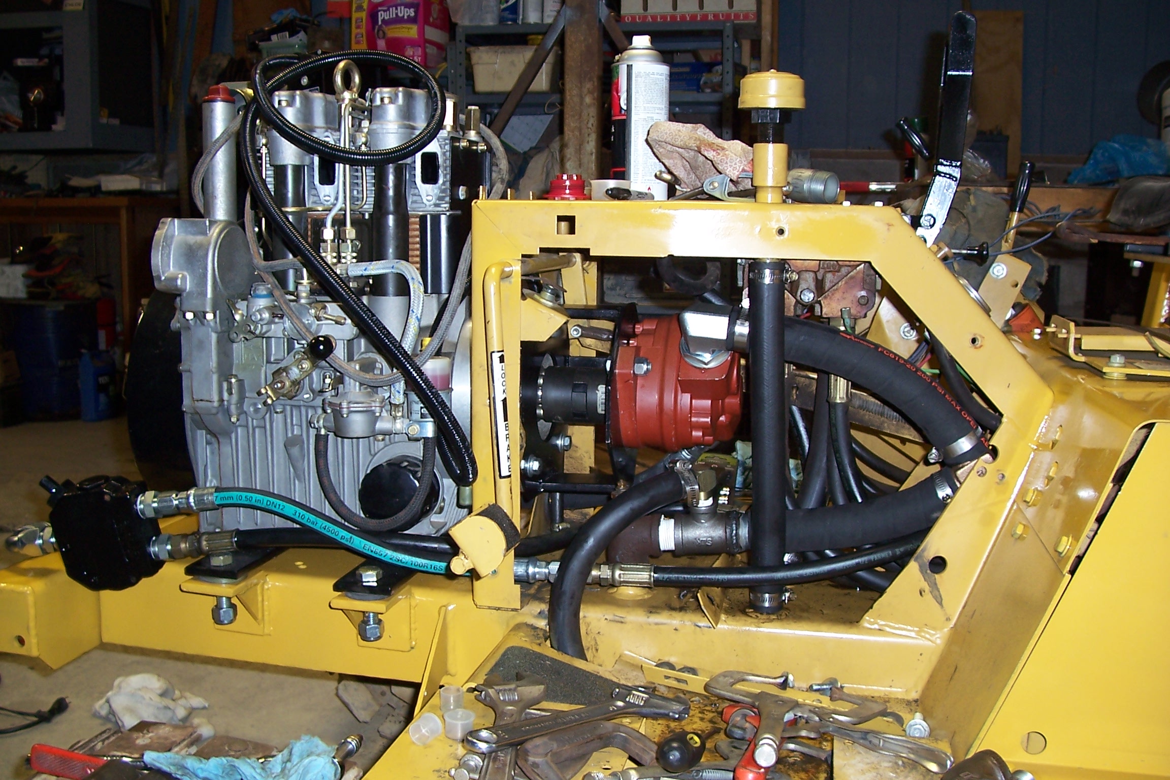

J_J, Im not sure how much flow is coming out of the flow divider as it is infinitely variable flow between 2 and 12 gpm. The Hatz is the 2G40 diesel engine. rated at 23 hp at 3000 rpm. I thought by using the flow divider that it would split the 21 gpm pump out put in to 14 and 7 gpm. So when im using the track drive at 14gpm it would have enough power. The hose on the left of the top valve is coming from the adjustable flow divider. The blue hose coming out of the right side of the top valve, is feeding the lower auxiliary valve. I have the Brand power beyond plug, it is not currently hooked up. Anyway The machine doesn't do too bad with this pump, its the loader function that is giving me the fit.
   / New loader valve not working properly
#25
Farmerford: I went with a single pump system as I changed from the factory Kohler gas with two pump system to a Hatz diesel. The diesel is a larger engine and I didnt have a way or the space to power two pumps like the factory setup. So the solution to me was a larger single pump and the use of a flow divider. So far its working good, the track drive works well and the up and down function of the loader works well. I replaced seals on the one bucket cylinder and Had problems with the seals causing friction on the cylinder. I think that this is my cause of strain on the system. The 4800 Magnatrac model utilized a single pump system to run everything like im doing here. It only had a 12 gpm pump and resulted in very slow machine travel speed. However im sure that all 12 gpm was not being fed to the attachment valve. Is a flow divider a proper thing to use in this type of application?

The 7 gpm is used to run the loader and attachments. The 14 gpm is used to run two gerotor motors that use a tandem chain reduction box. The motors are factory. Only the loader and stack valves are set at 2000 psi. I believe the drive motor circuit is set at 3000 psi. The (SA circuit) on the stack valve is used to rout implement hydraulic flow to the drive motor valve to act as an overdrive. It basically diverts all pump flow to the drive system. I am going to reinstall the power beyond equipment to system. I was only experamenting running without the PB plug and hose.

JD4310man:
That's nice looking work you are doing on the Struck. Looks very clean and well laid out; mine often looks like a bed of snakes somehow connected with a variety of fittings and adapters I happened to find in the corner.
I would have done the new engine exactly like you did, given that the original tandem pumps could not be used. I have two Prince flow dividers on projects I have made. The only difference is that on one of them I used what is sometimes called a hydraulic motor speed control because the flow adjustment bolt is replaced by a short lever that can be moved by hand; it does the same thing as the priority flow valve because the flow is pressure compensated; when pressure increases in the priority flow circuit the spool shifts to further restrict the passage for excess flow and thereby equalize pressure in both circuits. With the lever I can adjust the priority on the go without wrenches.
You have encountered and handled properly in my opinion the main drawback to a fixed displacement pump and the open circuit valves that it necessitates; to divide the flow you have to put both streams under the same pressure. But in most cases the greatly reduced cost of a gear or vane type fixed displacement pump compared to a variable displacement pump and the associated automated displacement control hardware (and now software) is worth the disadvantage of the inefficient way you have to split the flow.
The mechanical flow divider uses two or more gear pumps/motors mechanically connected through their shafts and does not require pressurization of the other flow. If the motors have the same displacement, then when the single input stream from the pump reaches the "Y" at the motors , one half must flow through each motor because the mechanical connection of the motor shafts forces them to turn at the same speed. But these types of mechanical flow dividers are several times the cost of the spool type, substantially more bulky, and have the disadvantage that the pressure in one out circuit can be twice that in the pump circuit because of the mechanically connected motors, so relief valves are required in each out port.
Spool type directional control valves in an open center system, when the spool is only partially shifted or "feathered", are dividing the pump flow into two parts; the part doing work is directed to the hydraulic cylinder via the work ports and the part of the pump flow not directed to the cylinder flows through the valve body to the tank. But inside the valve body the part passing to the tank is under the same pressure as the part going to the cylinder; the tank flow undergoes the same kind of pressure drop in the valve as the excess flow experiences in the priority flow valve.
Please send us pictures of the whole machine.
