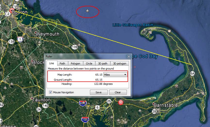

65 miles east of Boston.. is the middle of. The Atlantic Ocean...hope your BX has a snorkel kit.
Well, he didn't say exactly due east. Looks more ESE. I am curious about the airport that seems to be about 25 miles offshore though.
