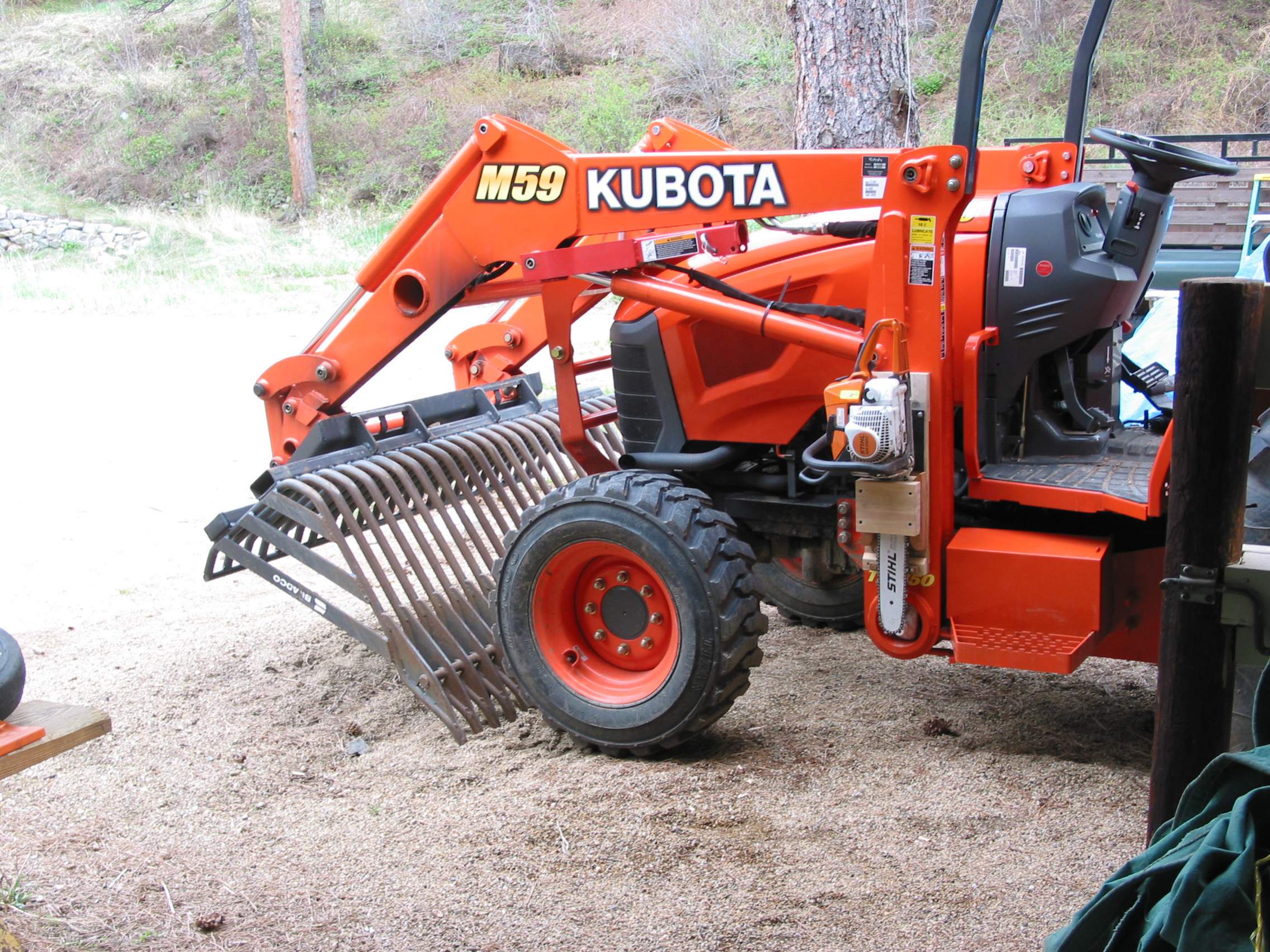

Yes, it may be that you will want to add tire weight or width eventually. But I wanted to reassure you that the M59 will do some serious work with traction and stability just as it comes stock. Enough so that if I was hauling it I agree that I wouldn't bother with more weight at this point.
Best mods after the thumb was raising the seat a few inches. After that some handy things have been finding a used Bradco QA rock bucket. Nothing sorts rocks from dirt faster than a rock bucket. Also it was good to weld some real hooks on the bucket, and one small but important thing was to make a holster for the chain saw. Mounted like it is in the picture gives just enough room in the loader frame for a bit of spare oil, gas, chain, and tools all held in place by the chainsaw bar. You can see it in the picture.
Good Luck,

I'll be adding the hooks to the bucket shortly, they are sitting on the desk in my office now. Maybe a couple to the backhoe bucket too. Next up for me will be a hydraulic auger, probably the McMillen 3k2 (two speed), which I need to build my pole barn as well as for later projects. I will put it on the front initially, but I put quick attaches on the thumb hydraulics so I can put it on the hoe later if need be like I see some other folks have (Kubota sells a standard QA ear base which would be good for this). I like your chain saw holster setup - pretty slick! I have a couple Stihl saws myself, my place needs a ton of work on the forest, plus I have had an ongoing battle with Ponderosa pine bark beetles, have cut down 50 or so trees so far, but that is another story. I'm not really sure yet what to do about a rock bucket or grapple. Our volcanic ground is full of rocks for sure, one cannot drive a rod into the ground anywhere without hitting a rock. I am worried about trying to auger holes, but the M59 with hydraulic auger should be able to do it, much like a skid steer auger. If not the backhoe certainly can get it done. I'll post something later once I get back up there and get going on all this.

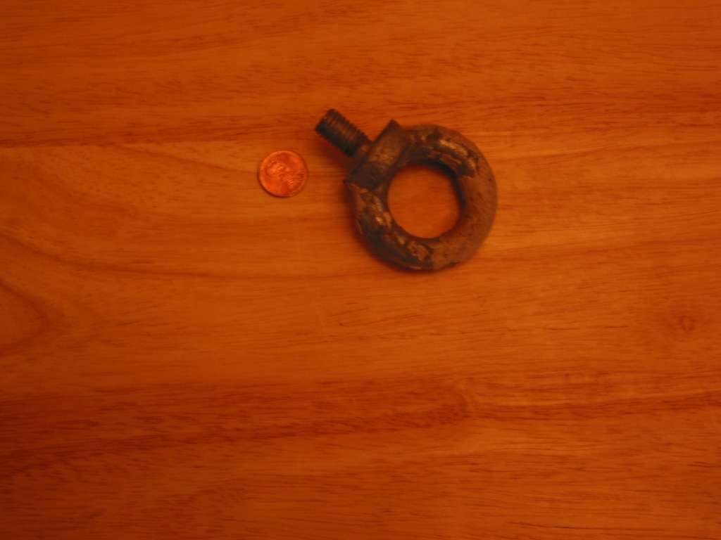

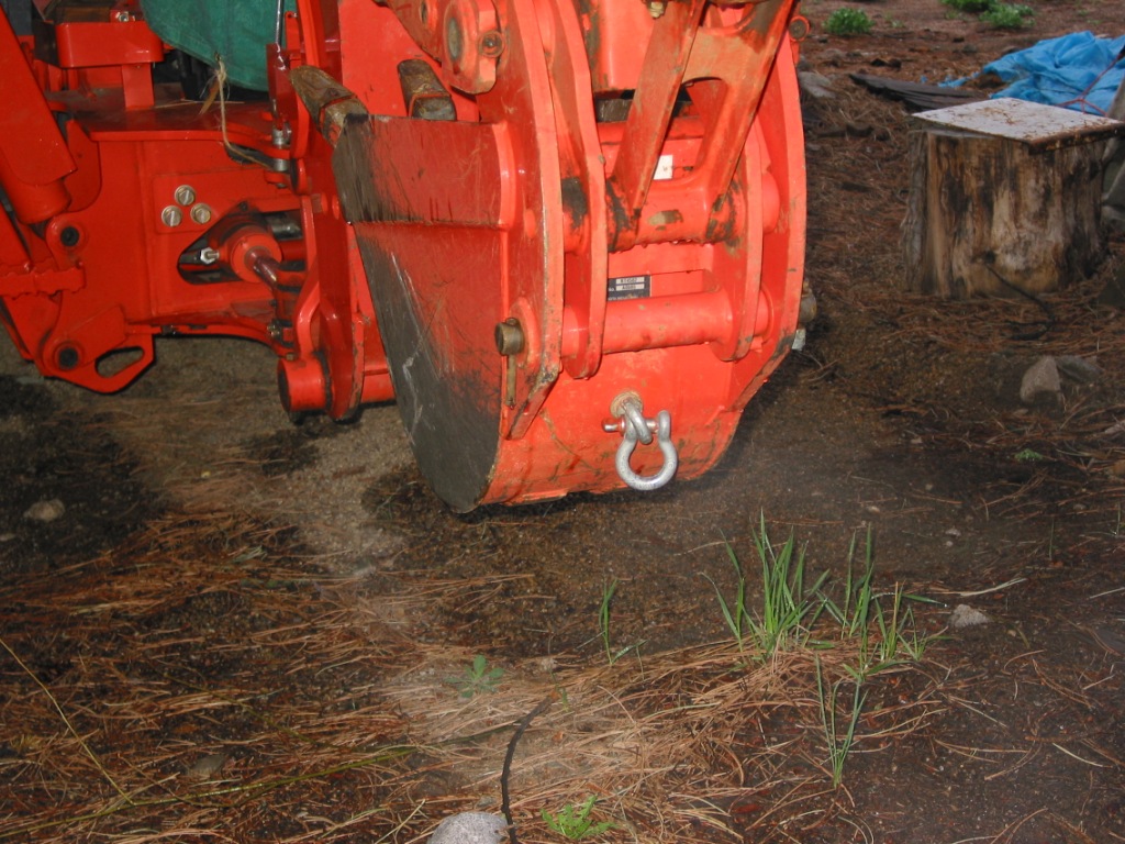

Wrapping chains around the bucket never worked all that good for me. Here is a picture showing what I did. The eye is 1/2" steel with a 1 1/4" diam. eye. all cast. This one got used because it was handy, but wish I'd had a slightly larger one so that the grab hook on my favorite utility chain would pass through it. You can see that the location is protected from digging. Inside the bucket is just a washer and nut loosely attached with the bolt end peened over so that the eye will swivel.
Agree on the 12" bucket being more useful in the mountains where lots of the work is with roots and rocks. Mine came with a 20" bucket that seems enormous. I've never used it.
As for the rental implements, it's nice to have the ability...but using a rental implement means mixing the hydraulic fluids and that has made me a bit gun shy on doing it with mine.

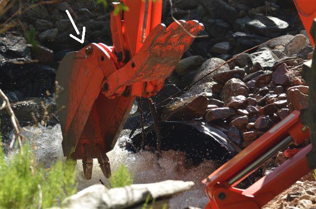

BTW, here is a picture with an arrow showing the spring pin that was original equipment on my BH bucket mount. If yours is like that, be sure to replace the spring pin with a double-nutted bolt. Otherwise something expensive can get bent when the spring pin falls out and that big pivot pin moves sideways. Easy to do when digging and really hard to spot in time. A real brain lapse by Kubota.

The eye bolt does look like it is probably the simplest solution, and easier than welding on a grab hook and having to prep and later touch up the paint. Kubota did address the issue with the lynch pin on the bucket QA, and now supply a bolt plus nylock nut option.
