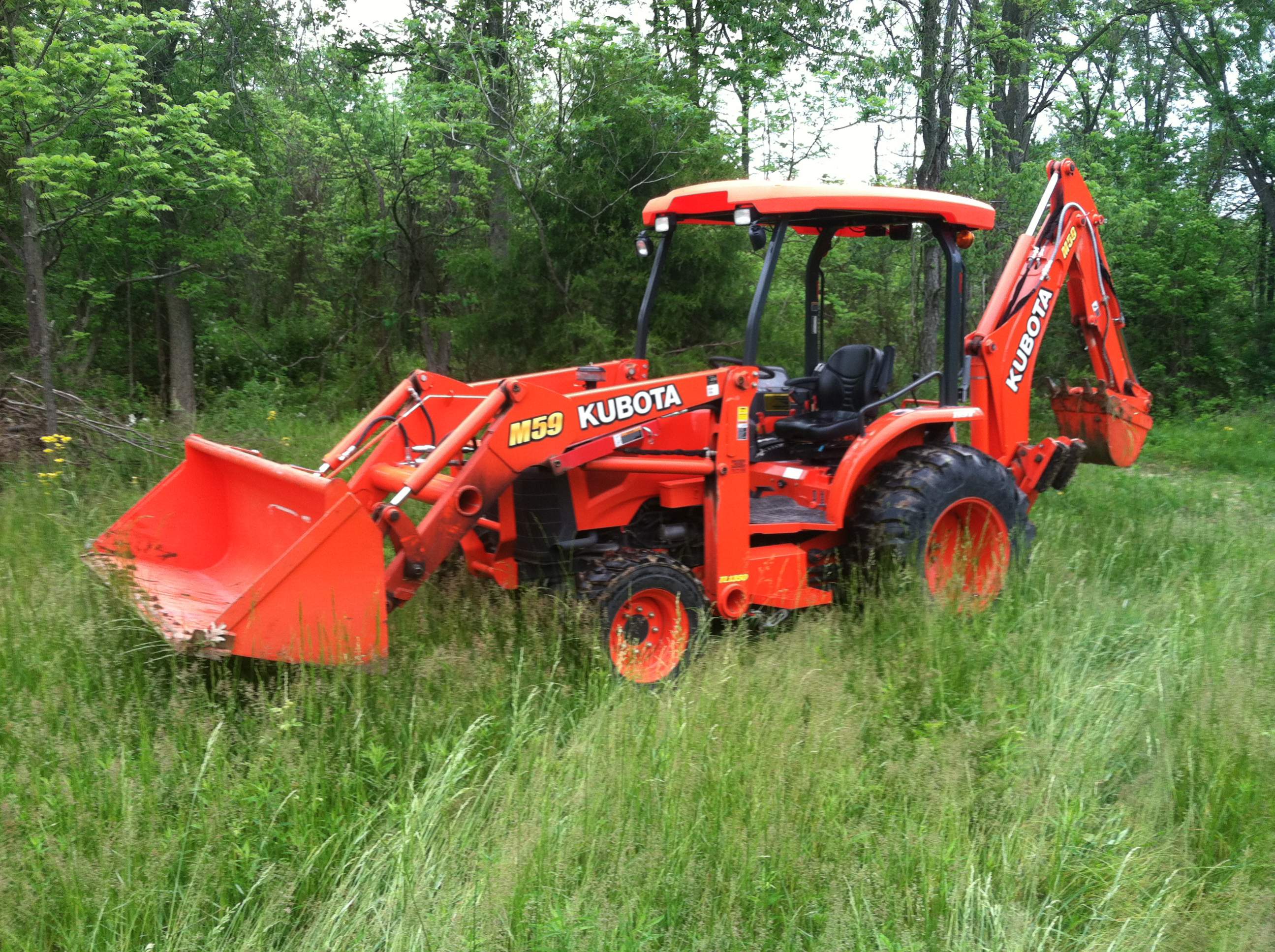

Well, I think I'm due to finally post a picture of my M59.
Here it is looking a bit out of place in the tall grass. I've been digging out stumps and digging some drainage.
This weekend I will remove the BH and install the 3 pt hitch so I can do some bush hogging.

It sure looks nice in all that green grass. Always nice to see pictures of another machine. There are so few M59s out there that we need to hang together. Every day I'm glad my wife talked me into getting it.
Let us know how the 3pt hitch exchange goes. I've never unmounted the BH from mine. There was some talk of that in the "M59 Discussion Thread". All I remember was that it was easier to do the second time, and not hard the first... Be interesting to hear how yours goes. Does the 3pt raise and lower smoothly?

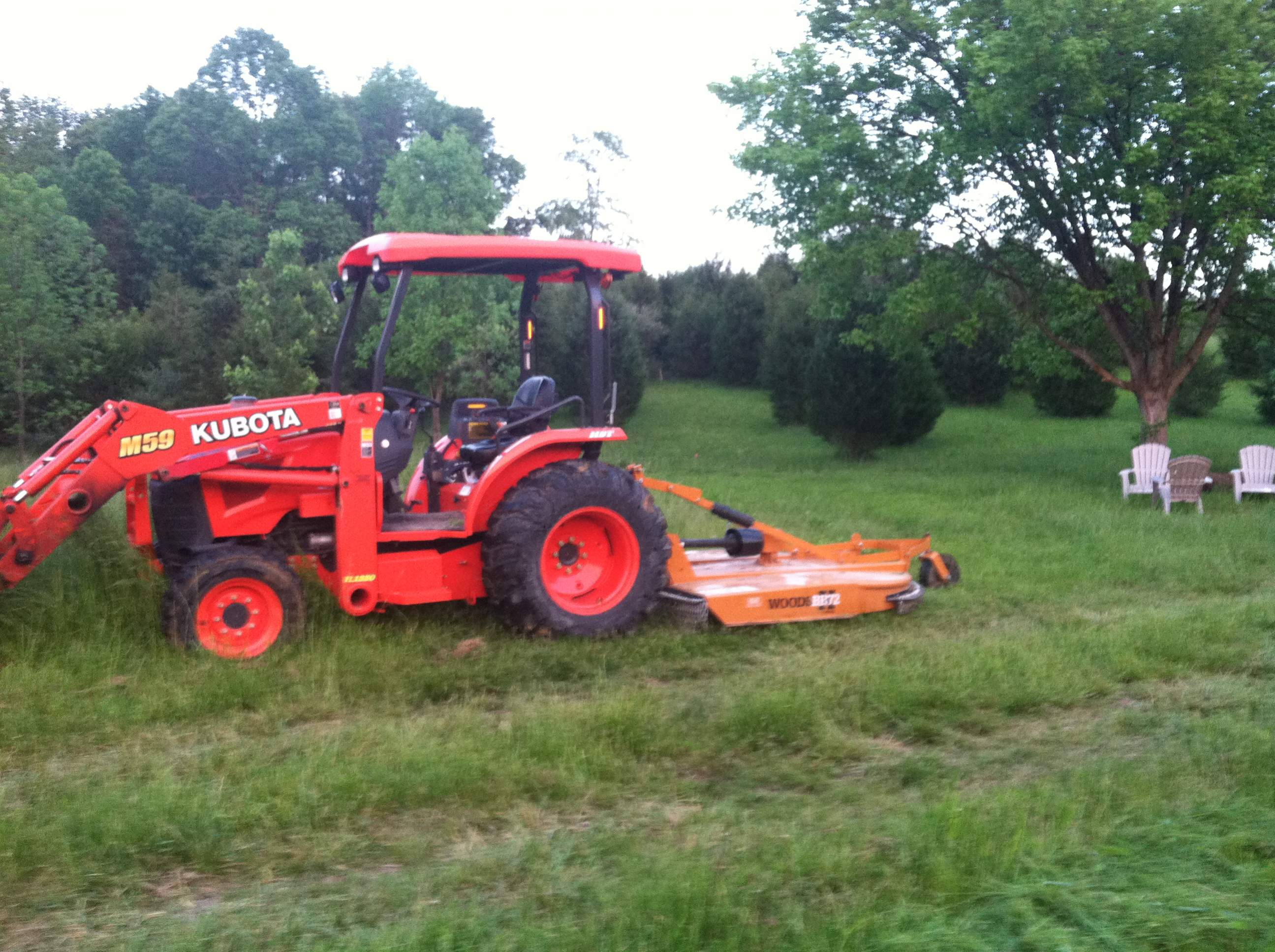

Well, removing the BH took about an hour. The next time it will take 10 min. The instructions said to raise the wheels slightly using the boom.....then remove the pins. WHen you do this it binds the pins completely. It should read. raise the rear wheels slightly , then slowly lower the wheels until the pin is unloaded/loose.....then the push right out with 1 finger:thumbsup:
Started to mow the grass but I did not have much light. I should be able to finish it tomorrow. Mowing was a breeze with the M59 hydro.
I have to say that the M59 3pt linkage is not all that great. The issue is with the check chain turn buckle. It is difficult to use. I really wanted my next tractor to have extendable lower arms but I will compromise on the point. The M59 is a beast and should serve my needs well.
Hmmm when I pull the hoe of mine, it worked just as written.... Tho I have noticed level ground makes a big difference. Also a light coat of WD40 on the pins makes it easier to insert/remove the pins.
What size mower, and how did it handle it? I'm thinking about a mower for keeping up the property trails, and a bit of brush clearing and am curious what folks have been successful using.
I got a quickhitch for my 3-pt. I can get the linkage setup snug and level with minimum load on the hitch, all the attachments are setup with QH bushings so swapping things out is very easy.

I'm using a woods BB72. I bought it for the my previous tractor. The M59 can handle a much bigger unit. I wish I had a 8ft dual blade mower. The woods will do for now. Mowing today was a breeze. The tractor was very maneuverable. THe only issue I noticed was the ROPS being higher and thus I was hitting branches that I normally clear. IT looks like I will need to do some more triming. I also notice greatly enhanced stability which is really nice on the hills.
