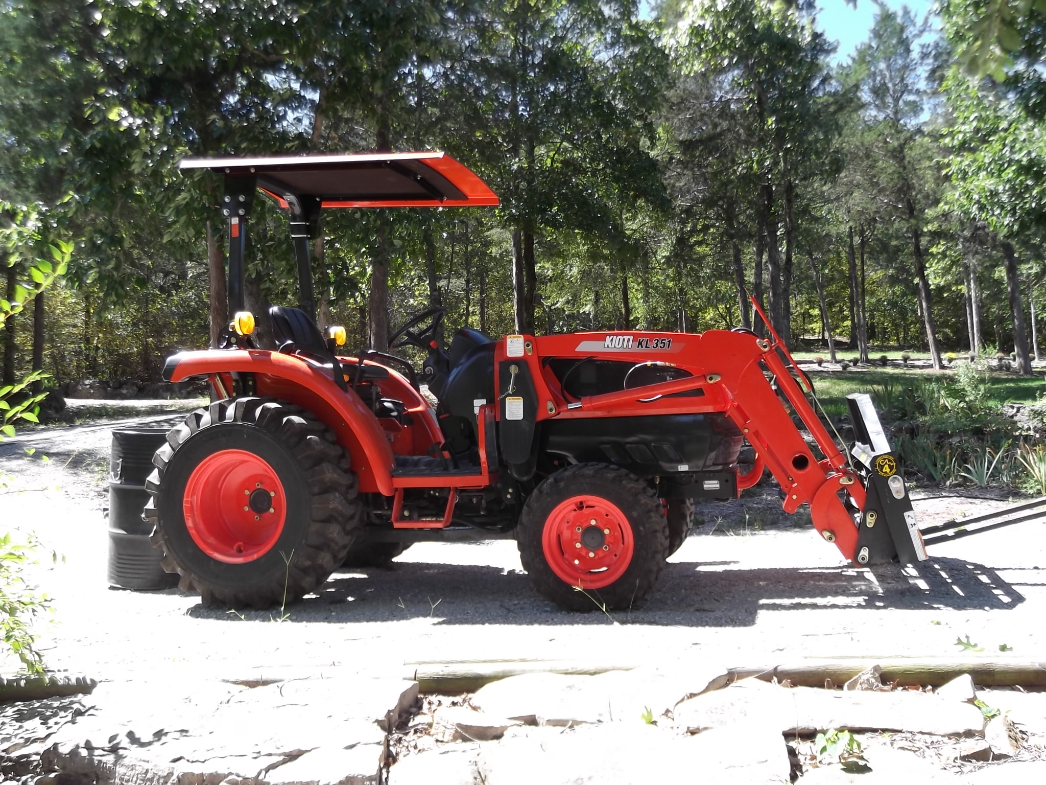

I will try and respond later but am tied up most of today. As a reference point, look at a Kioti CK27 tractor. A lot of folks on TBN have one. You will also need a box blade, with the heavier the better. But it depends upon your soil type, how much weight it will need. A landscape rake is also very handy. With these two attachment items you should be able to do the work you do not have planned to hire out. I have a good 45 HP tractor with fluid filled tires for added weight and first class implements and I am still hiring out some work to get tree stumps dug up by a mini excavator. It is all a balance about what you are willing to invest and bang-for-the-buck.

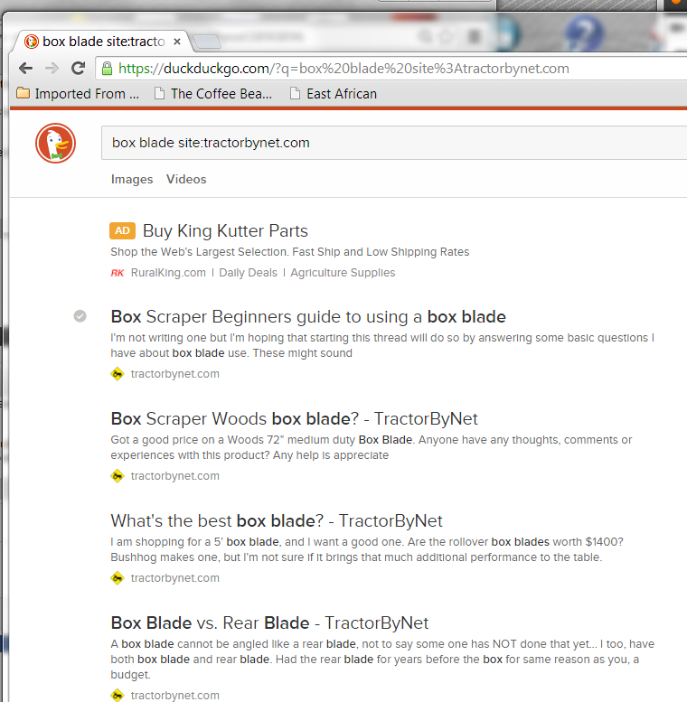

Do a lot of searches on TBN for box blades, landscape rakes, etc. Most forum searches are difficult to use. So use the following format from your INTERNET search engine (IE, Google Chrome, Firefox, etc.). As an example, say you are looking for articles on box blades. Use the following format to search: box blade site:tractorbynet.com This is a screen shot of the results:
On TBN you can find quite a few posts about folks not having enough tractor for their stated purpose. I started my search expecting to purchase a 35 HP 3000 pound tractor and ended up (with a lot of TBN guidance) with my 45 HP 5000 pound tractor. Plus 1000 pounds for fluid filled rear tires, and the 710 pound rollover box blade and 525 pounds for the rock grapple bucket, my running weight is ~ 7200 pounds. But this is NOT something to use in ones yard as the weight will make tire depressions. So it is all a balance. And it may better to go one step higher in tractor than what you think you will need.
Just do a lot of TBN searches using the method above. I spent many hundreds of hours searching and posting to get where I was comfortable with what to purchase. And I ended up with NO buyers regret.

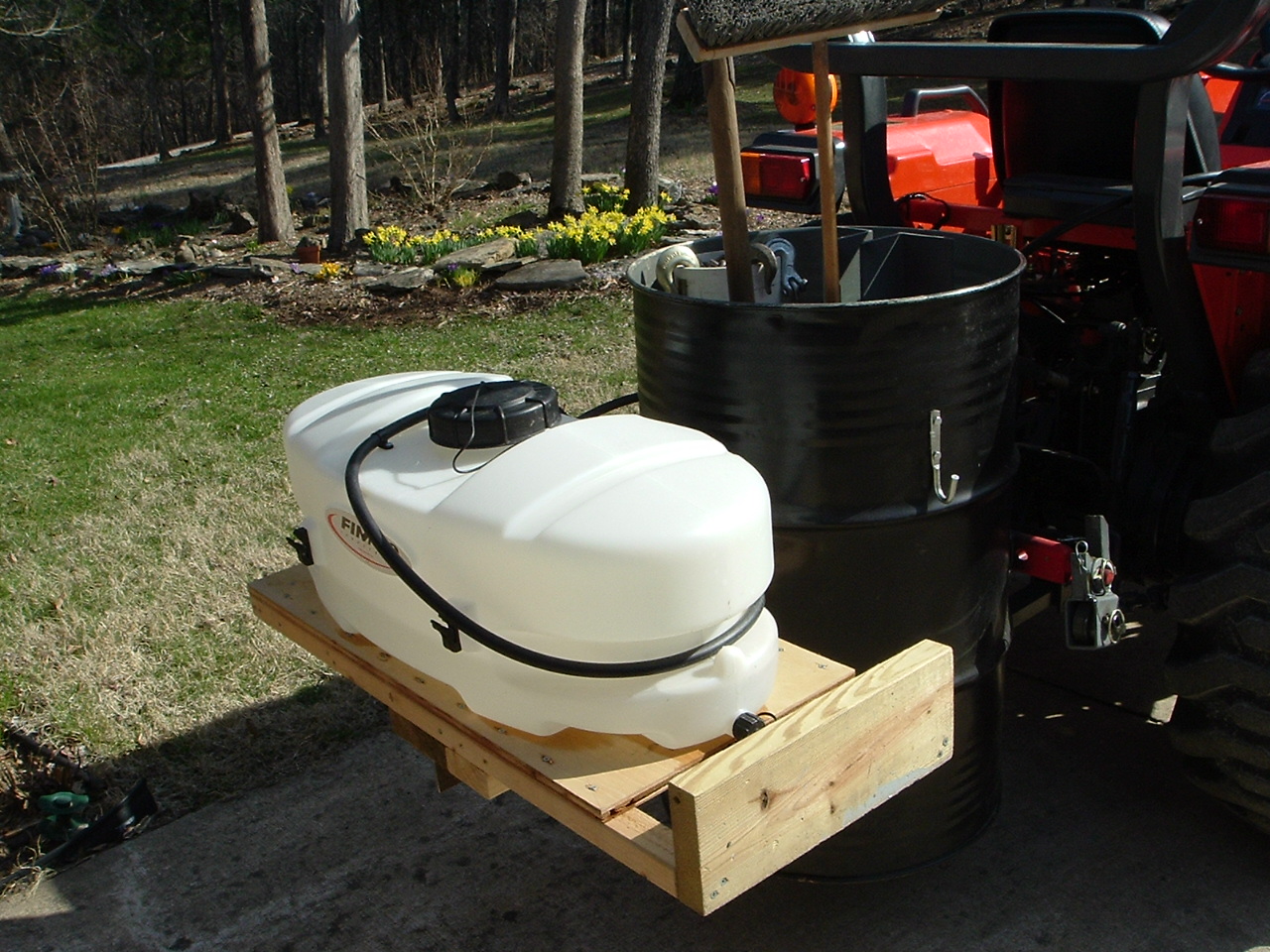

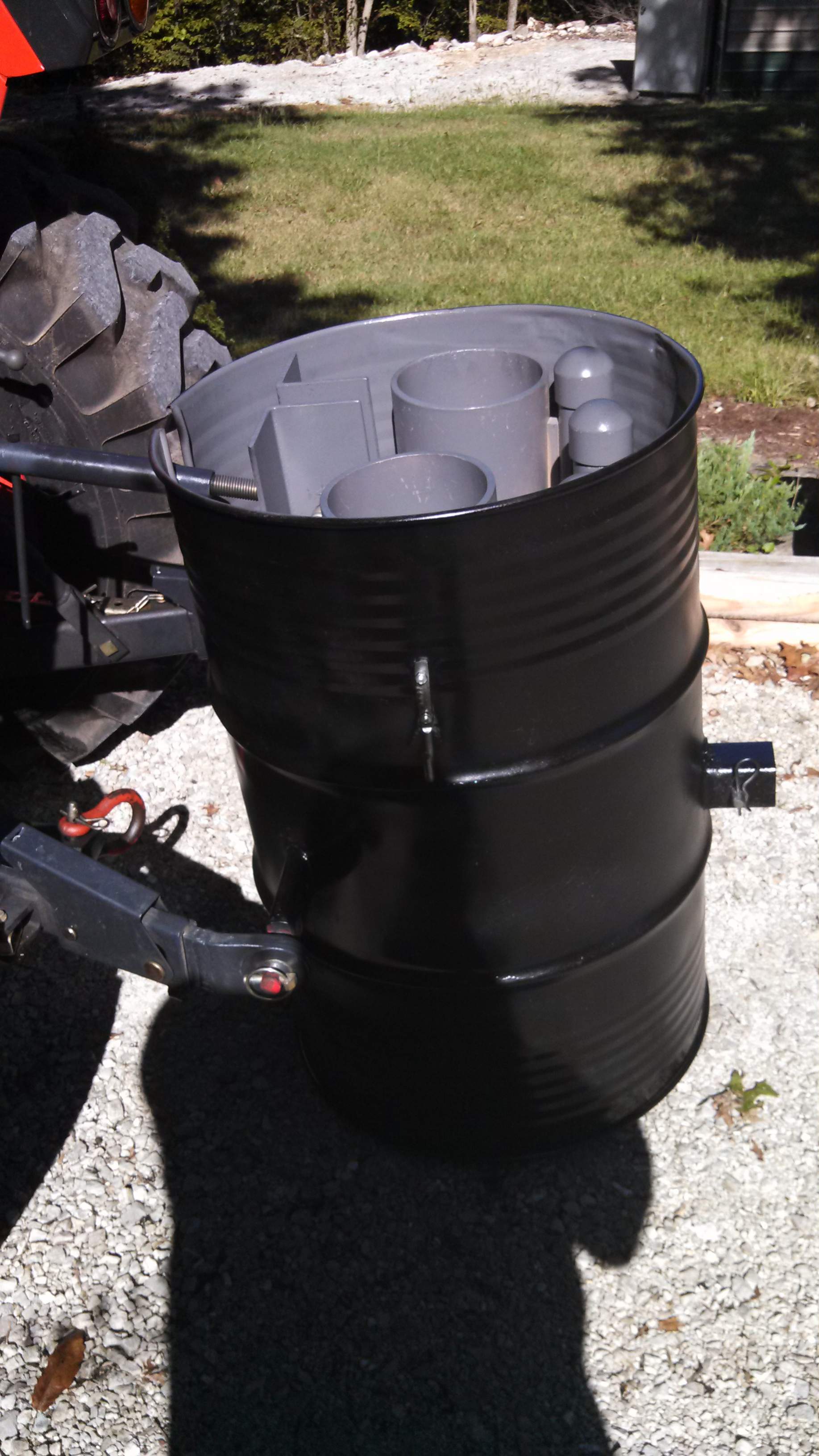

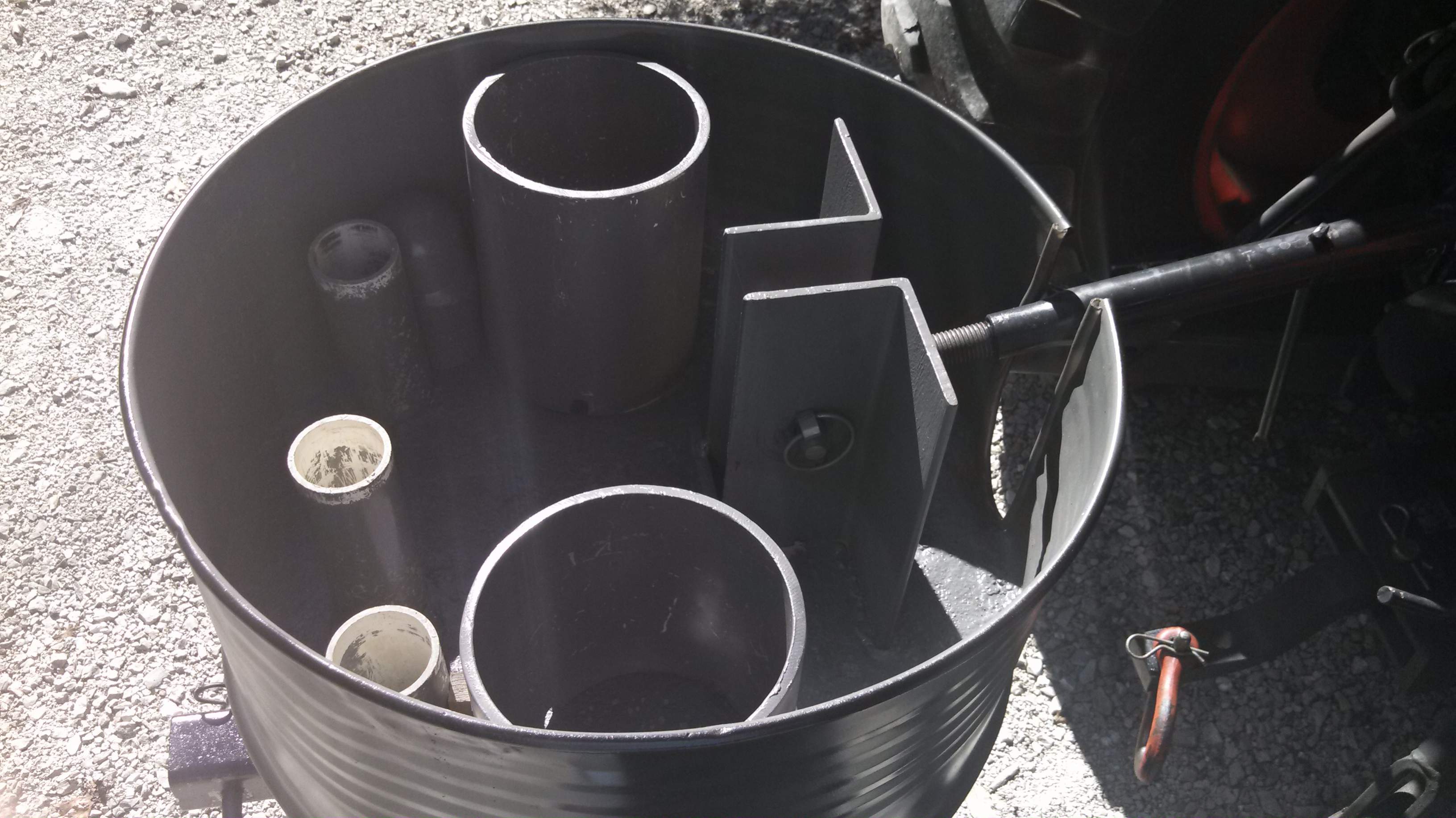

   / New member needing advice #16

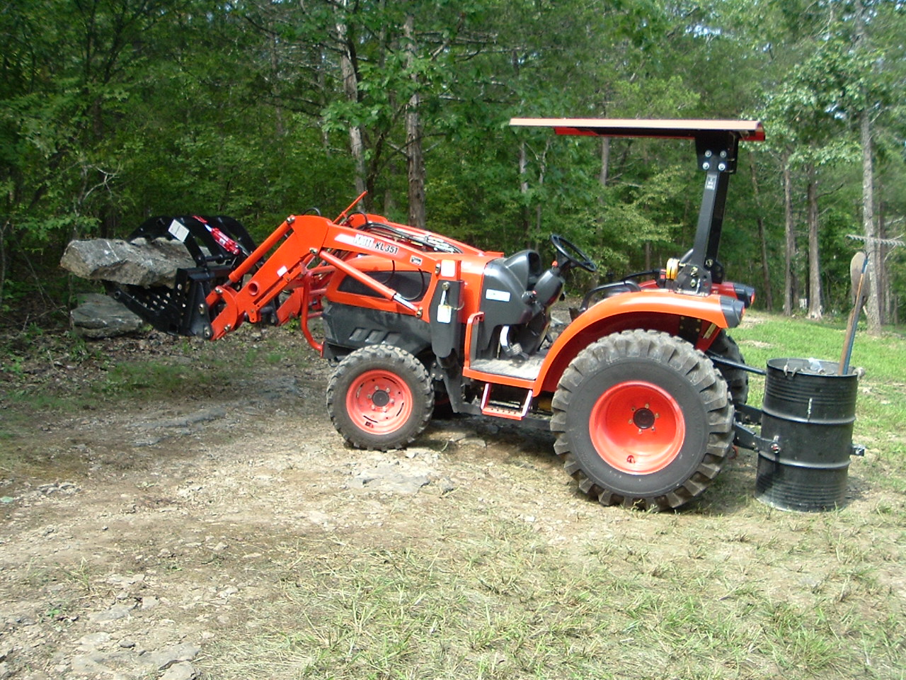

We highly recommend and I use a weight box. Mine is homemade, and it stays on a lot of time. It helps counterbalance the loads in the FEL and keeps your rear tires planted on the ground. Thats a good thing. Many users do not have one, and rely on a good heavy box blade as their counterbalance. This can work too, if you work in more open areas where the swing of the box blade sticking out further is not a problem. I work in the woods a lot and it is an issue for me. But for open areas, it can work well, plus you have an actual useful implement on the back that you may need at the same time. Here are some photo's of my home made barrel showing my built in tool storage.
IMG_20130922_150228_440.jpgIMG_20130922_150347_801.jpgDSCF0555.JPG090812 006.jpgDSCF0422.JPG
   / New member needing advice #17
Really nice works as always, James K. Rolling that slotted edge up front for the top link access is a first class touch. OP: I am one of the folks who use a heavy implement- 710# rollover box blade (ROBB) and a 100# tool box. And at times it is just BARELY enough counterweight, along with the 1000# weight in my rear tires. But I need the ROBB for what I am doing so it is a compromise. Examples others have seen on TBN:
   / New member needing advice #18
I was thinking that edge guard on the top link access slot might save some bloodletting in the future, and so far I have been right!:)
