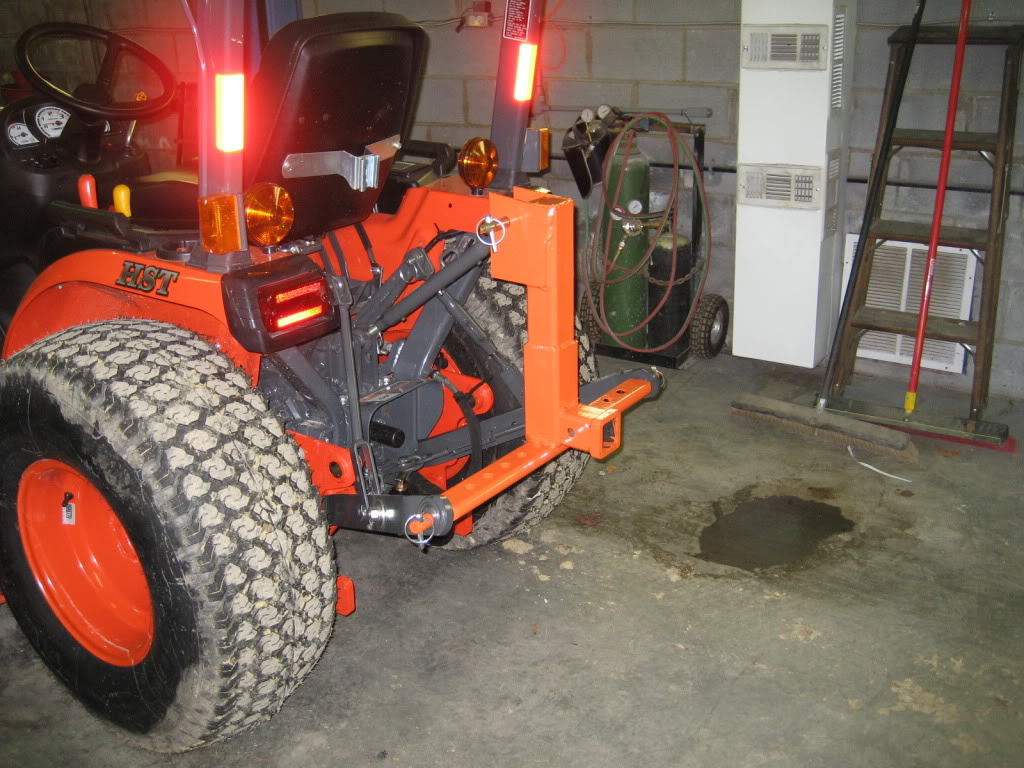

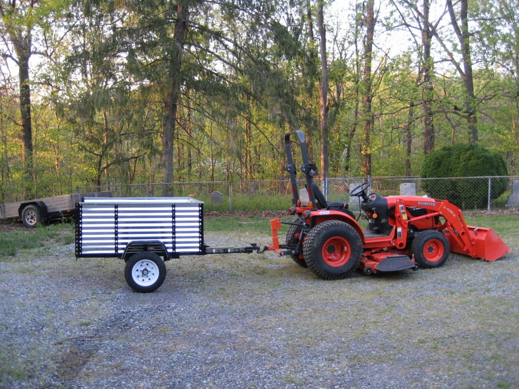

I wanted to introduce myself because this is my first post. I currently have a 2012 B2620 tlb with around 50 hours. I upgraded this spring from a bx2200 that I had added a b601 to by building custom mounts and it turned out very nice. I am a mechanic for a major utility company for 13 years. I have added a tow hook to the b2620 and some led lights and currently I am adding a push blade. I am a member of a couple of other fourms but every time I do a search for different topics I always get hits from this web site so I figured I would join and see if I may be able to contrubite.
Here are a few pictures of my past projects.

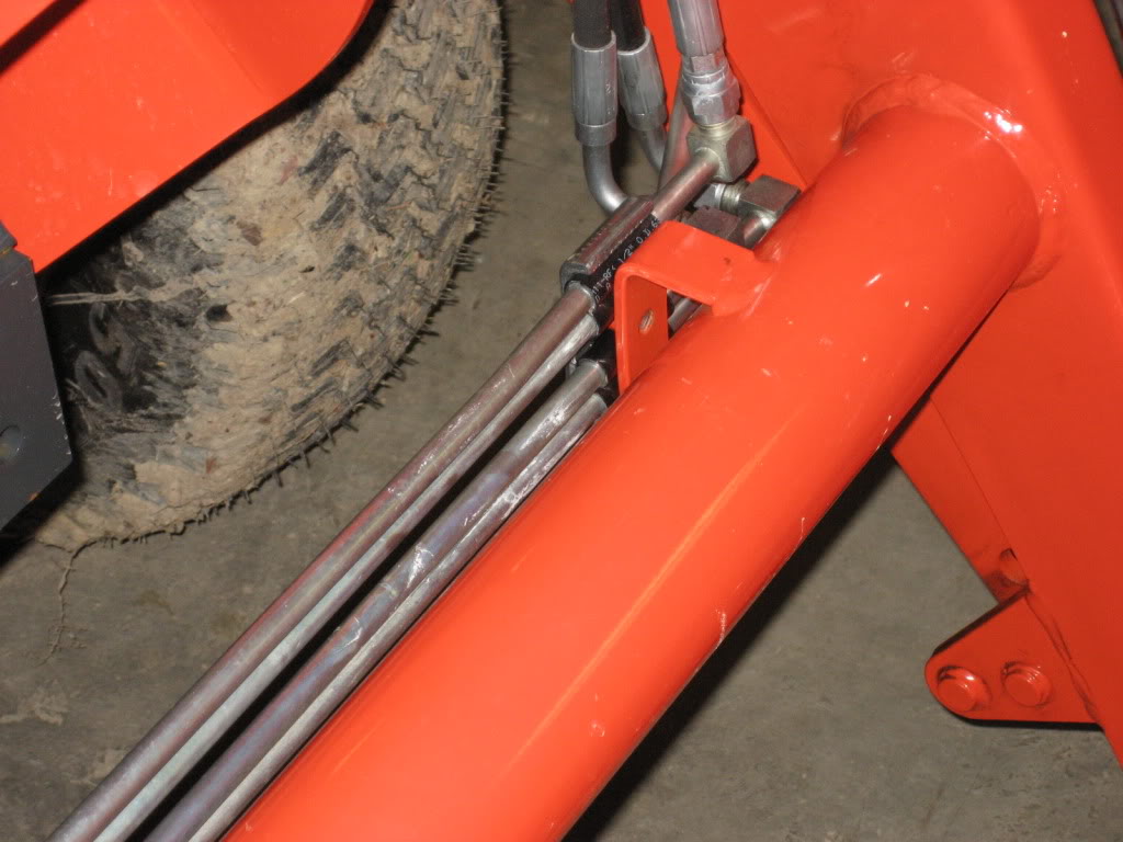

One thing I did do to the new one that is worth shareing is added some plastic inserts to the metal lines on the loader. I was going over it and seen where the lines were a little loose inside the brackets and added some split air brake hoses and made them where they would never rub a hole in them.
