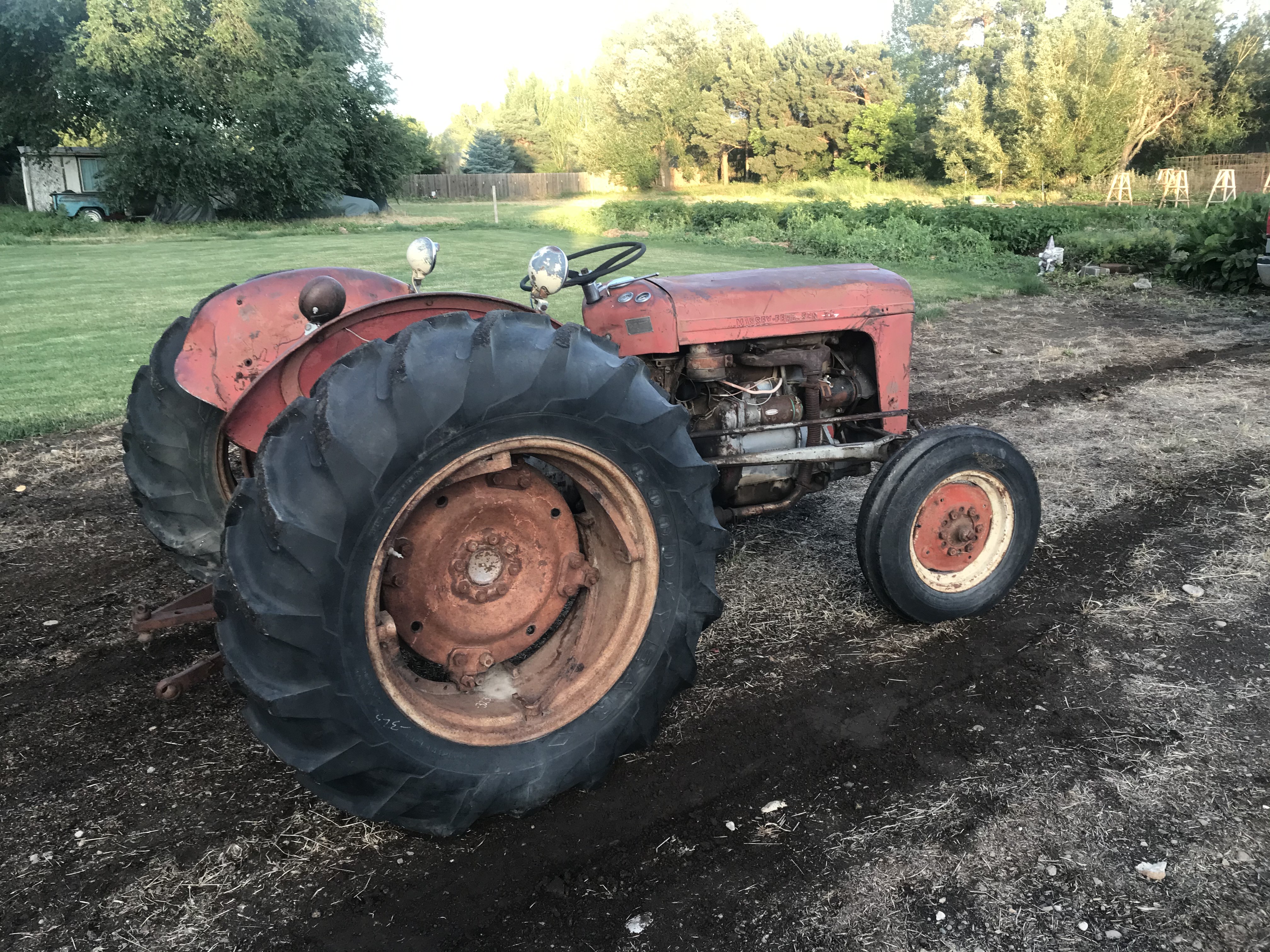

OK, everyone. I have an update. I towed the tractor in 3rd gear at around 12mph. Had good oil pressure the whole time. The tractor sounded good but would not fire on its own.
Massie Ferguson 35 Diesel Pull Start
   / New MF TO35 with Standard Diesel
#28
I put new injector nozzles on each cylinder. New fuel with half a bottle of seafoam to help clean and condition. Plenty of pressure coming out of the tailpipe, so I know I'm getting compression.
Now what?
I think it is time to take a look at the wiring. Since it is a diesel, what wiring would you consider first? Starter works. I can put a voltmeter on the alternator to test it. What else do you need for a diesel to fire?

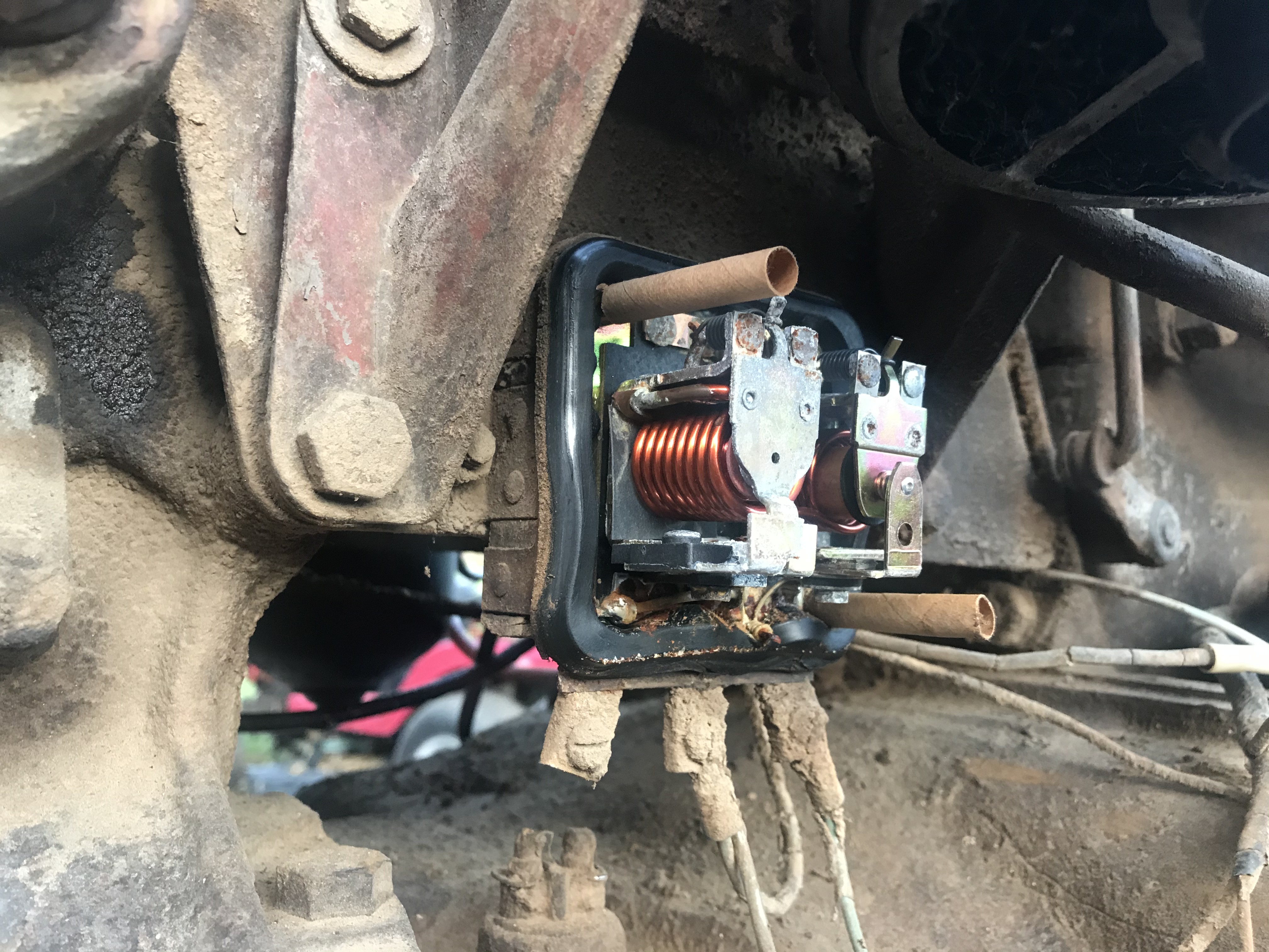

I followed some of the wires from under the dashboard and found that one of them led to this. It doesn't look great with all that corrosion. I don't know what this is. Can one of you tell me?
