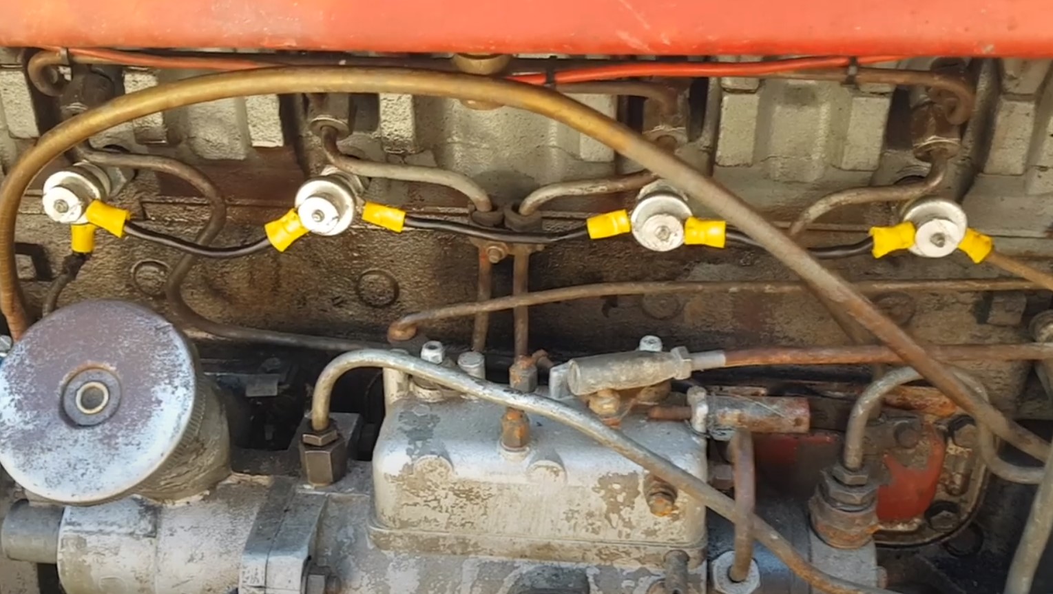

Can you tell me where the glow plugs are located on my tractor? Here is an image of a 23c with glow plugs. I pulled this from a screenshot of a YouTube video. To be clear, this is not my tractor.

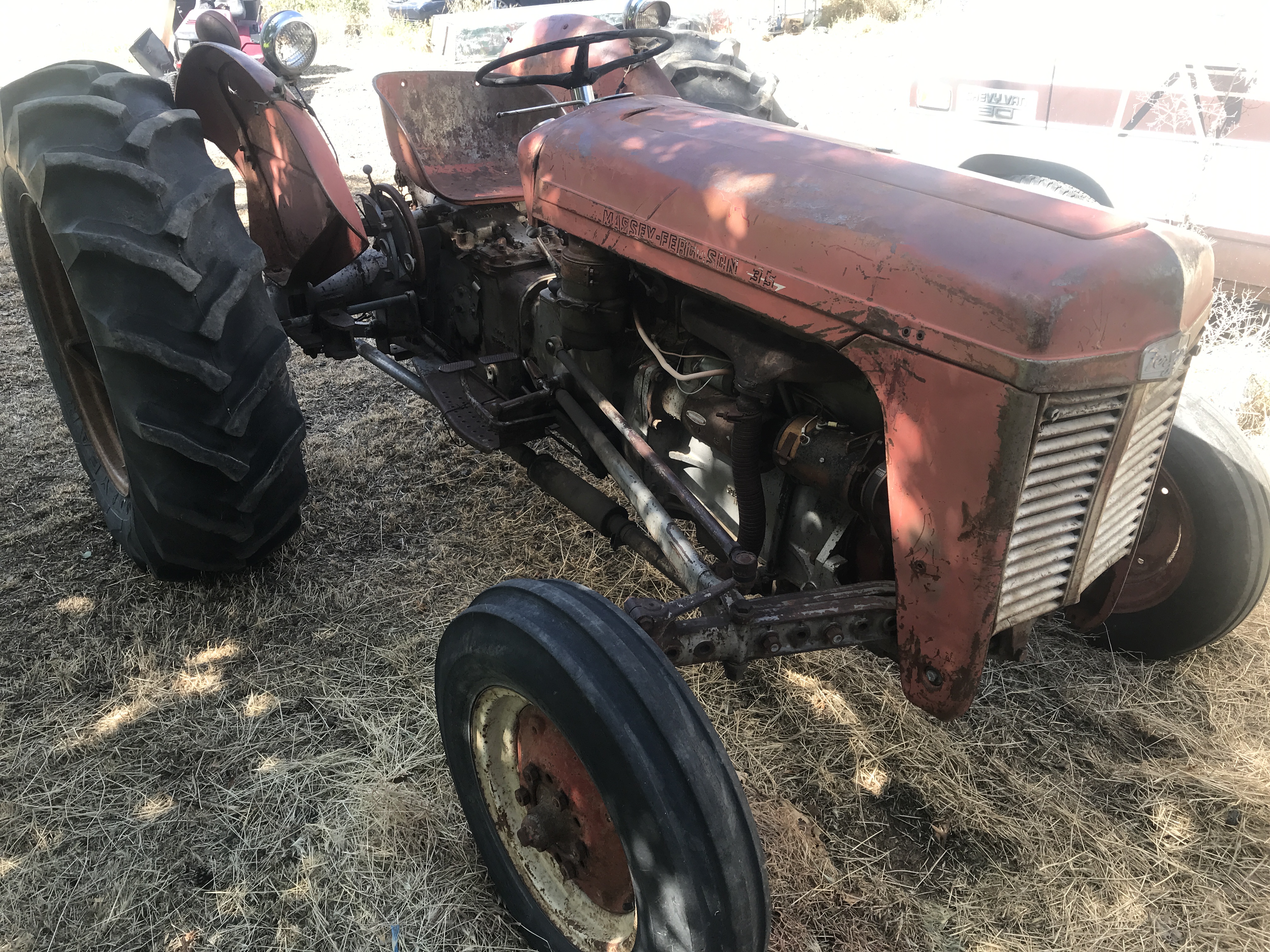

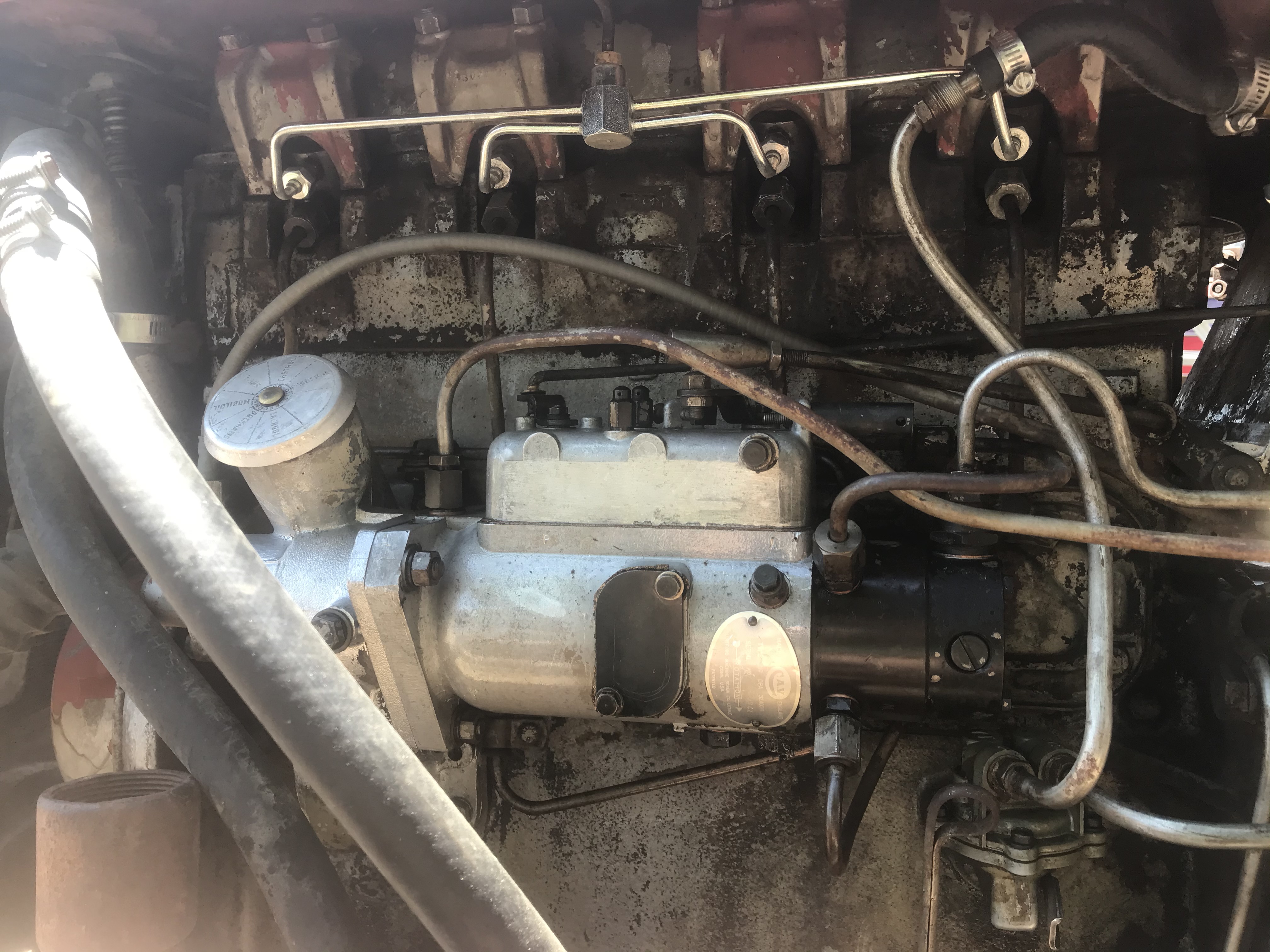

Now, here is an image of my tractor. They certainly don't seem to be any glow plugs. Are you sure our tractors are identical? Where should I be looking?

Not all had glow plugs, I do believe they came on the later revisions of the engine to address this engines poor starting in cold climate. They are very sensitive for wear on the camshaft chain and drive wheels that alters the injection timing.

You are right IdahoMan! The glow plugs in the top picture are those things with the black wires and yellow terminals. And I don't see any, or a place for any on yours. My tractor is like the top picture. I didn't know they made any without glow plugs! I do know mine would never start cold using the starter motor, even in the summertime, without them. It would start by towing it though without the glow plugs. I'd suggest you give Darel a call and get his take on what to do.

Looking at idahomans photo he has the fuel shutoff in the correct position. On
