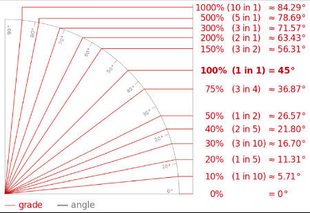

There is always confusion as to the exact degree of slope being discussed by members.
/ New MX4800 owner #6
I think a reasonable person would assume he meant 1:3 without needing clarification.

15% is only 8.5 degrees. If you stand 8' away from a wall, 8.5 degrees will only take you up around 14". That is a very shallow angle. You should always use caution, but 8.5 degrees is a pretty low angle.

A 3:1 slope is 71 degrees. It is a completely reasonable assumption by everyone on this forum but you that the OP does not mow a 71 degree slope. If he does, then you are correct and we all are wrong and you'll have our heartfelt apologies. Until that happens, I suggest you let it go. Thanks. :cool:

Moss,
Attempted issue summation in post 4, Tractor Girl offered assistance in post 5.
Perhaps you would consider your 8 ft distance analogy as a "sticky" posted at top of general forum, owner operating, as clarification for members, Tractor Girl chart also helpful.
