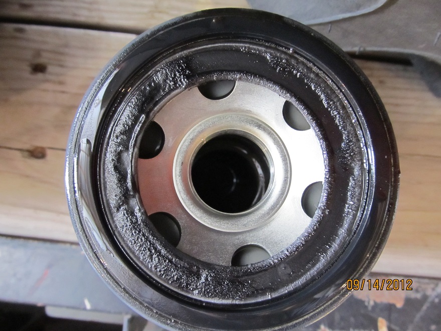

#28
Hit 47 hours so changed the oil and filter and changed the hyd trans filter (only) as instructed. Here's a photo of the hyd filter with the typical Kubota metal "dust" and no machining curls. Used 15w40 Mobil and Kubota filters. At 100 hours or so I'll change the engine oil again with synthetic oil and dump the hyd oil and change the filter again. Still love the tractor and impressed at the power it has and the heft of the front axle. With a 1200 lb Brillion seeder on the back it barely budges yet my L4300 used to bob and weave up and down. I dare say again, the MX5100 is the best compact tractor I have ever owned. Oh, I really like the transmission speeds as well as the F-R synchro lever on the left. It makes it easy for my purposes.
