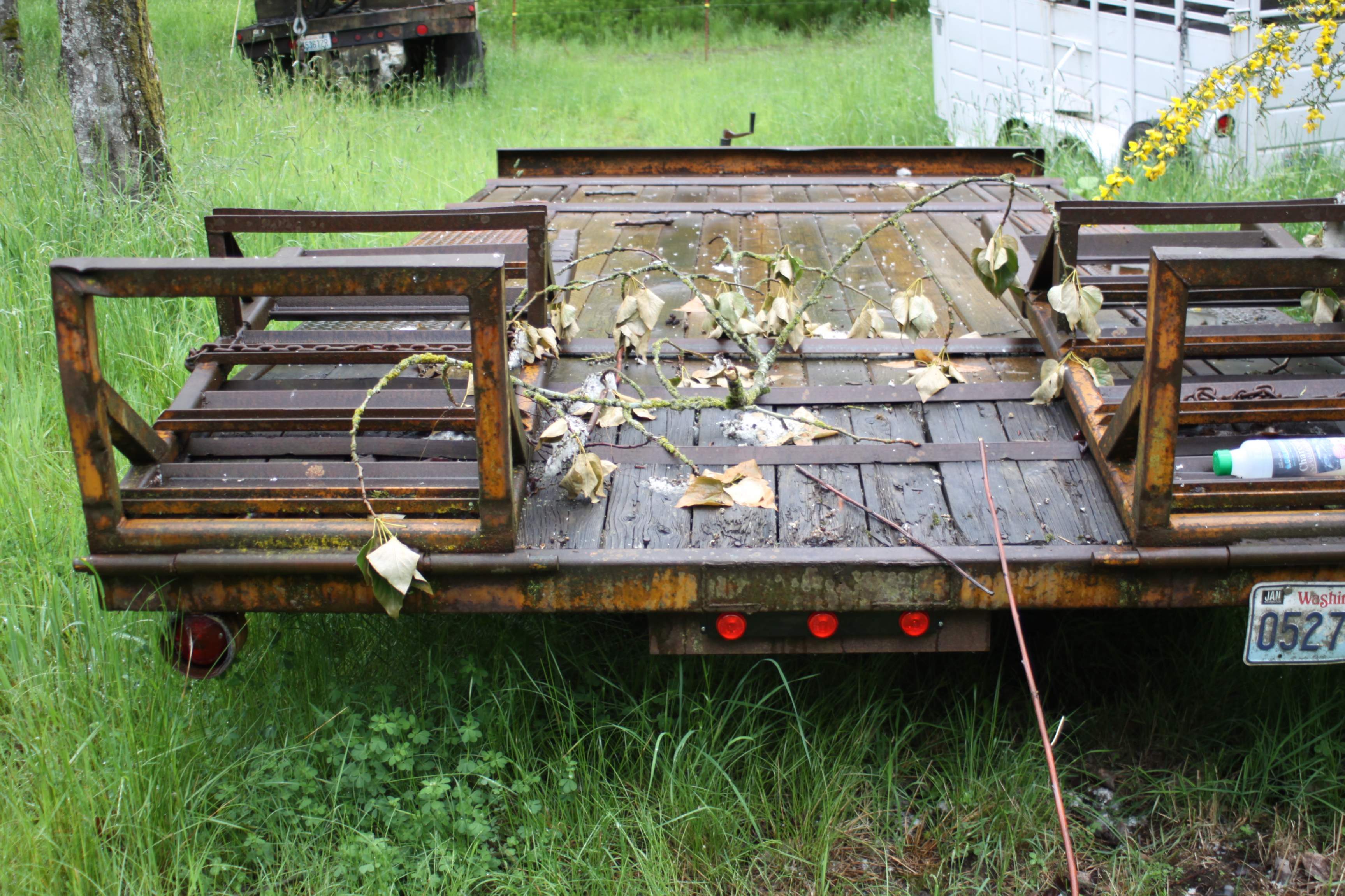

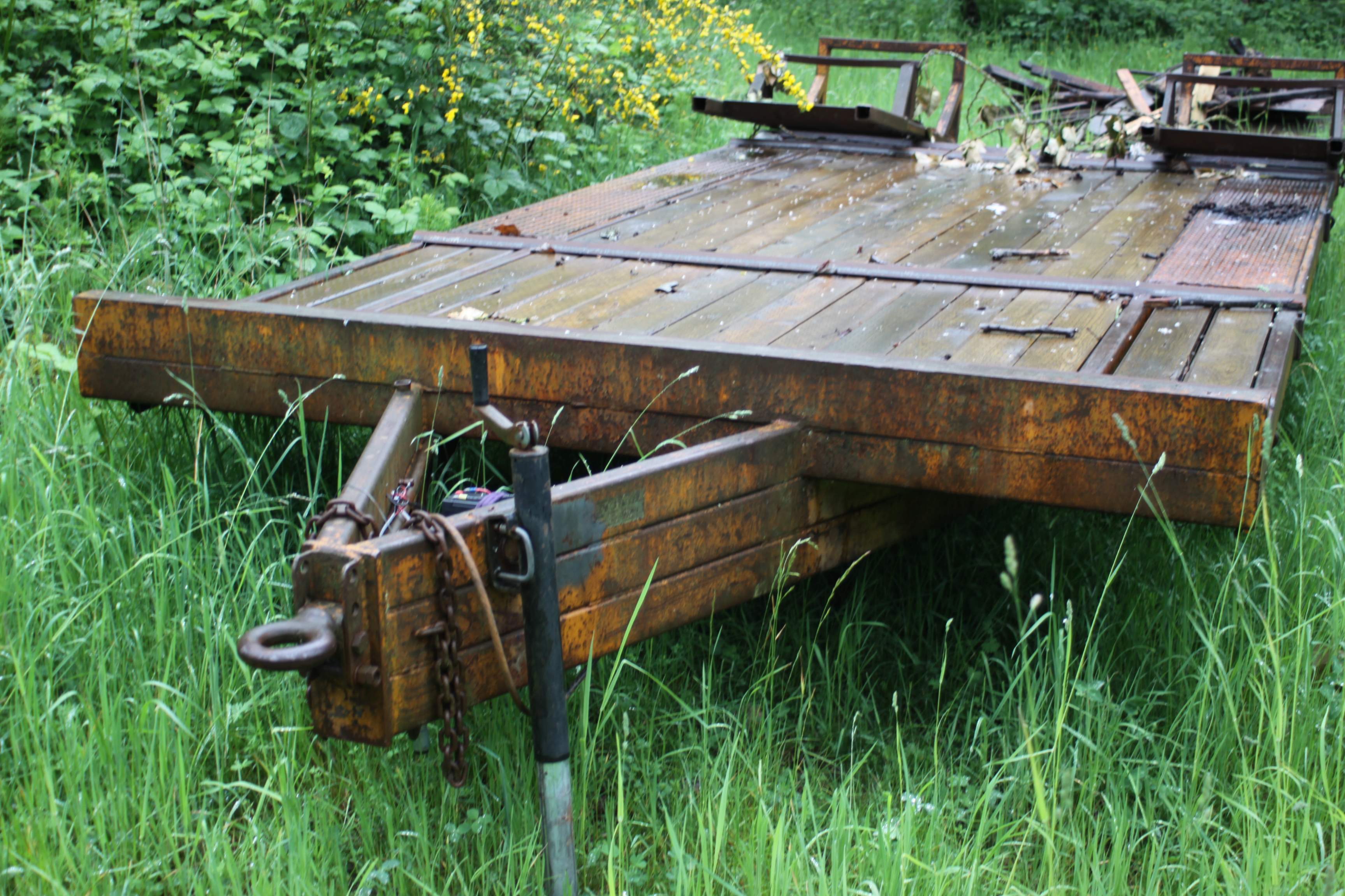

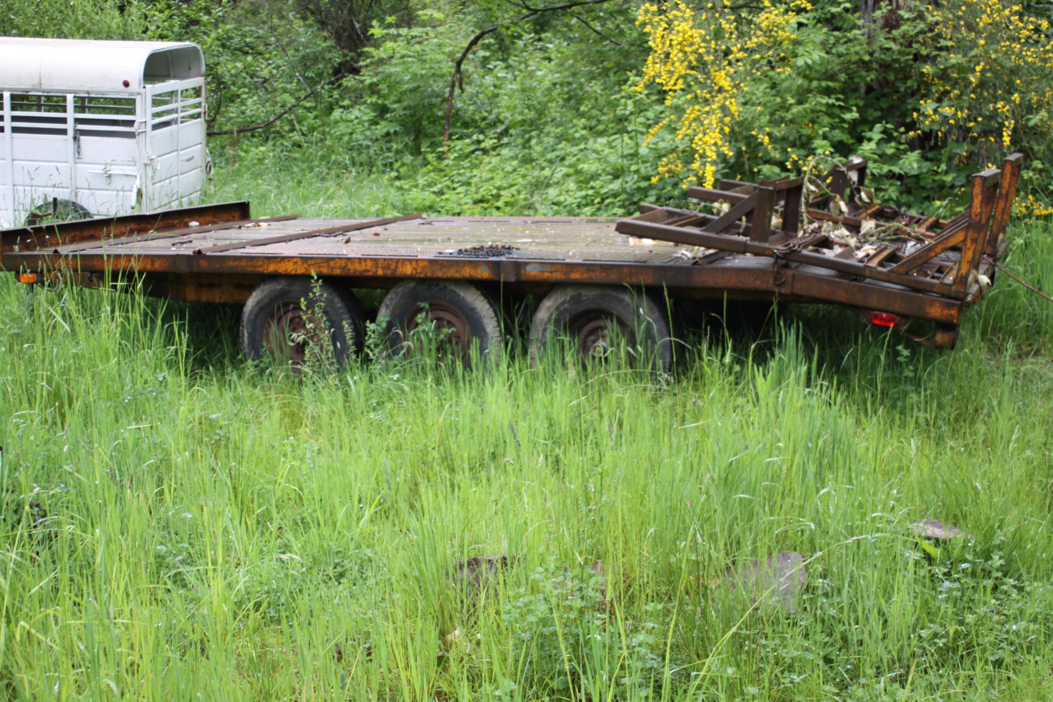

Got to use the trailer last weekend for a short haul (less then 10 miles round trip). Buddy wanted to borrow my 2030 JD & 3pt hitch backhoe. We pulled it behind his 92 7.3L IDI w/ an ATS turbo. Tractor didn't even squat the truck, granted most of the weight was on the axles.
Good news, lights work good. They were 'kind' to get the marker lights all working and well as the tail/brake lights. Bad thing is, the brakes are MIA.... granted, it could have been the adapter I was using (7 way RV flat to 6 wire round small) or it could have been his truck (controller didn't light up????). Yes, yes, I know, I know.... playing w/ fire not having a proper braking system. This is ag country.... you should see what is going around w/out any brakes here. I'll have to get my truck and test the brakes (I have that plug wired)... granted, it's only a 1/2 ton.
My planned tow rig is a 1999 E350 Extended van w/ a 7.3L PowerStroke. If needed, I can change the pental hitch on it to a 2 5/16" coupler to use a weight distributing hitch. I plan to just use it w/ in a 15 mile radius, but may use it for the occasional long haul to pick things up.
