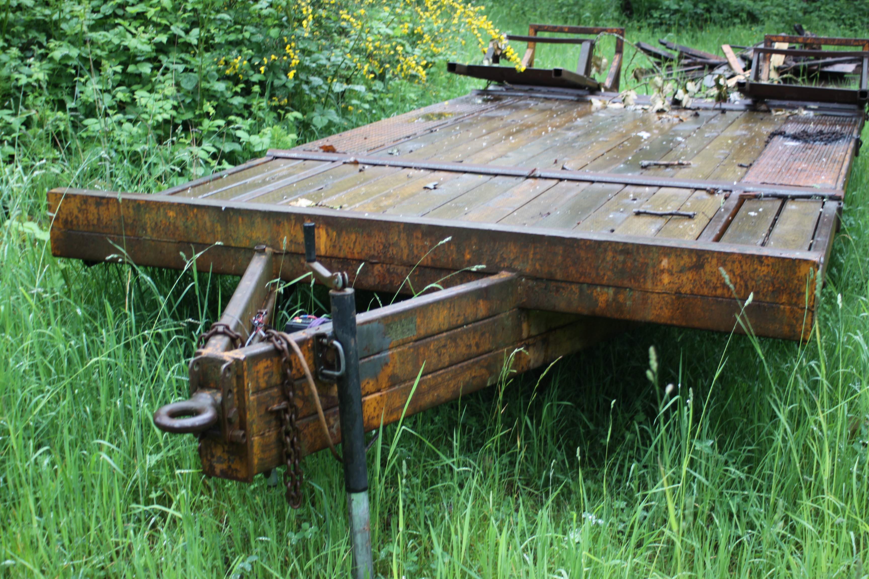

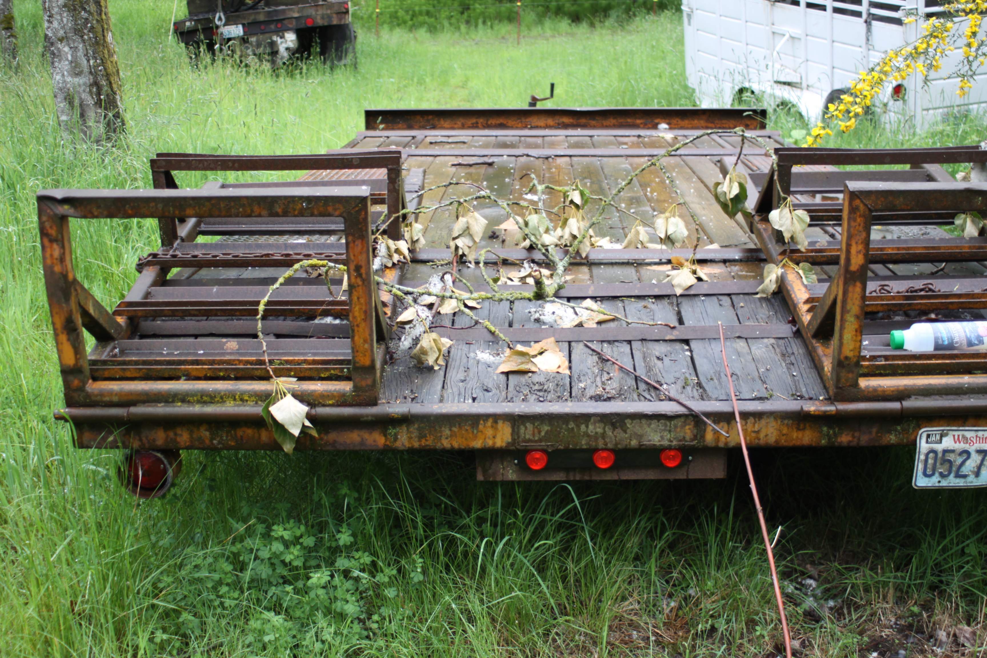

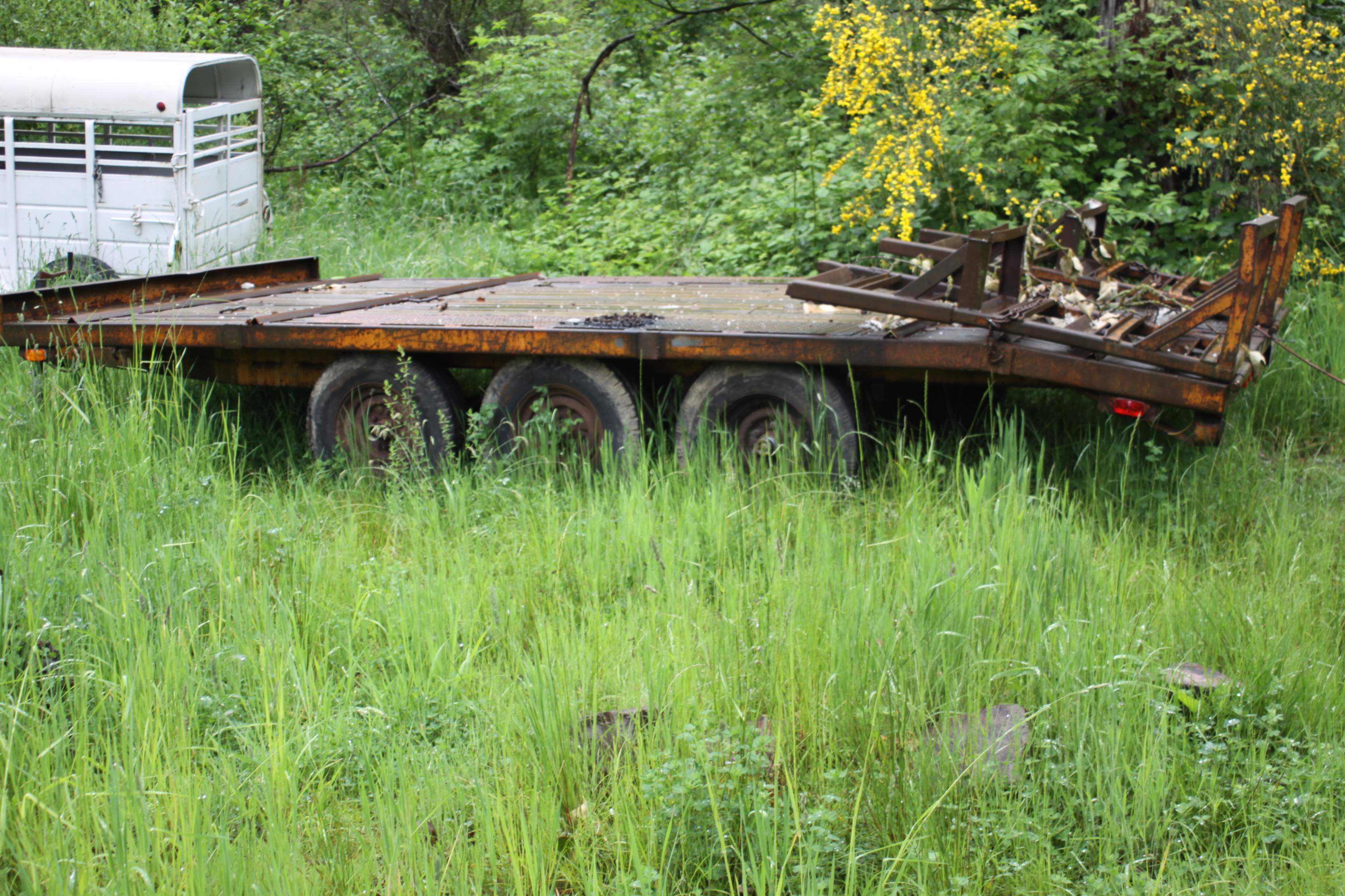

Sounds a lot like my trailer, but mine uses three rows of 2x4 square tubing rather than I-beam. Just redecked mine last fall.
Here are a couple of pix of mine.
Large Equipment trailer_001.jpg Large Equipment trailer_002.jpg Large Equipment trailer_003.jpg
   / New "old" trailer- tri axle #45
   / New "old" trailer- tri axle #46
When you said 3 rows of 2x4s I was a little unsure of what you were talking about. That picture makes it clear as day. Is it a homemade? What did you use for decking? Mine has all but rotted away. I was thinking of replacing it with rough cut white oak or something but it's not at the top of the list of todo items.
No not homemade. It's a commercially sold trailer for moving medium sized bulldozers. It doesn't squat even under a 12K load.
As for the decking, I had a bunch of 2x6 tounge&grouve pressure treated car decking sitting around that I had no other use for.
The trailer actually belongs to my old boss. It was used for transporting their Case 589 backhoe from job to job. With the newer DOT regs they can't use it anymore due to length (too short to chain down both buckets) so it just sits at my place. I rebuilt the deck and rewired it so that I could use it to bring my tractor home.
