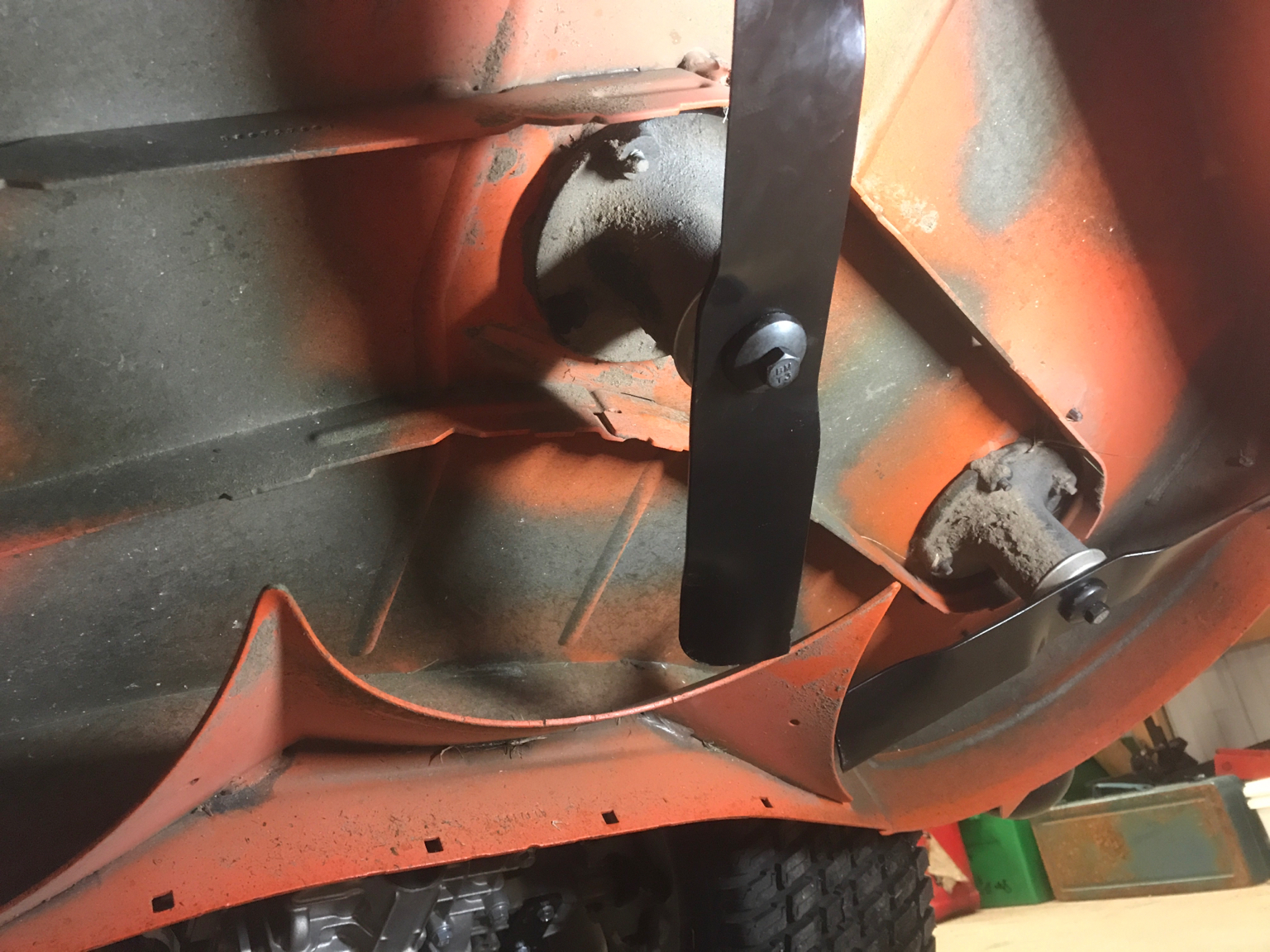

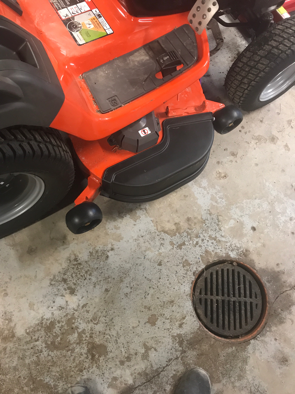

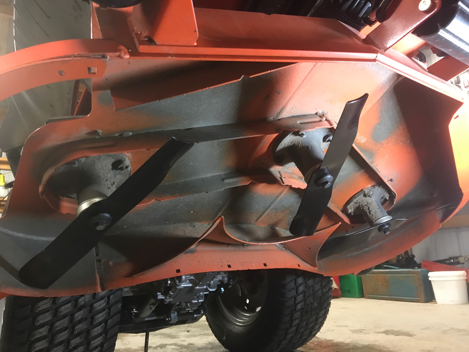

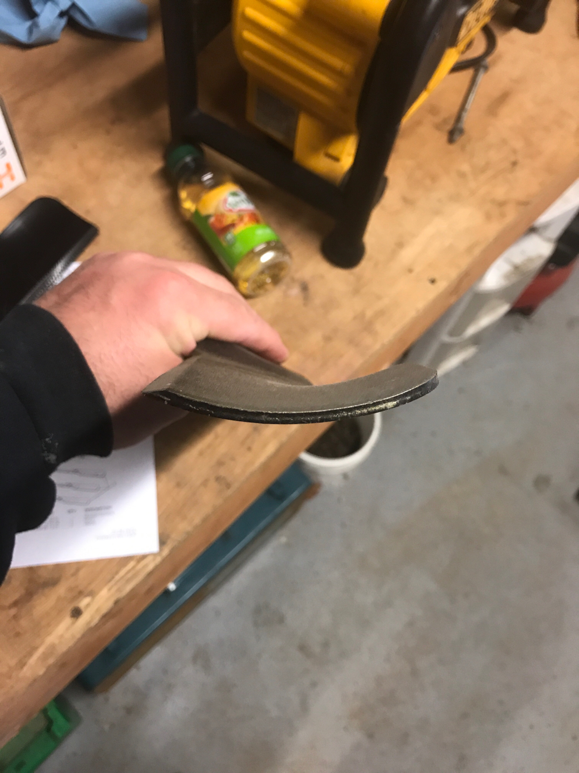

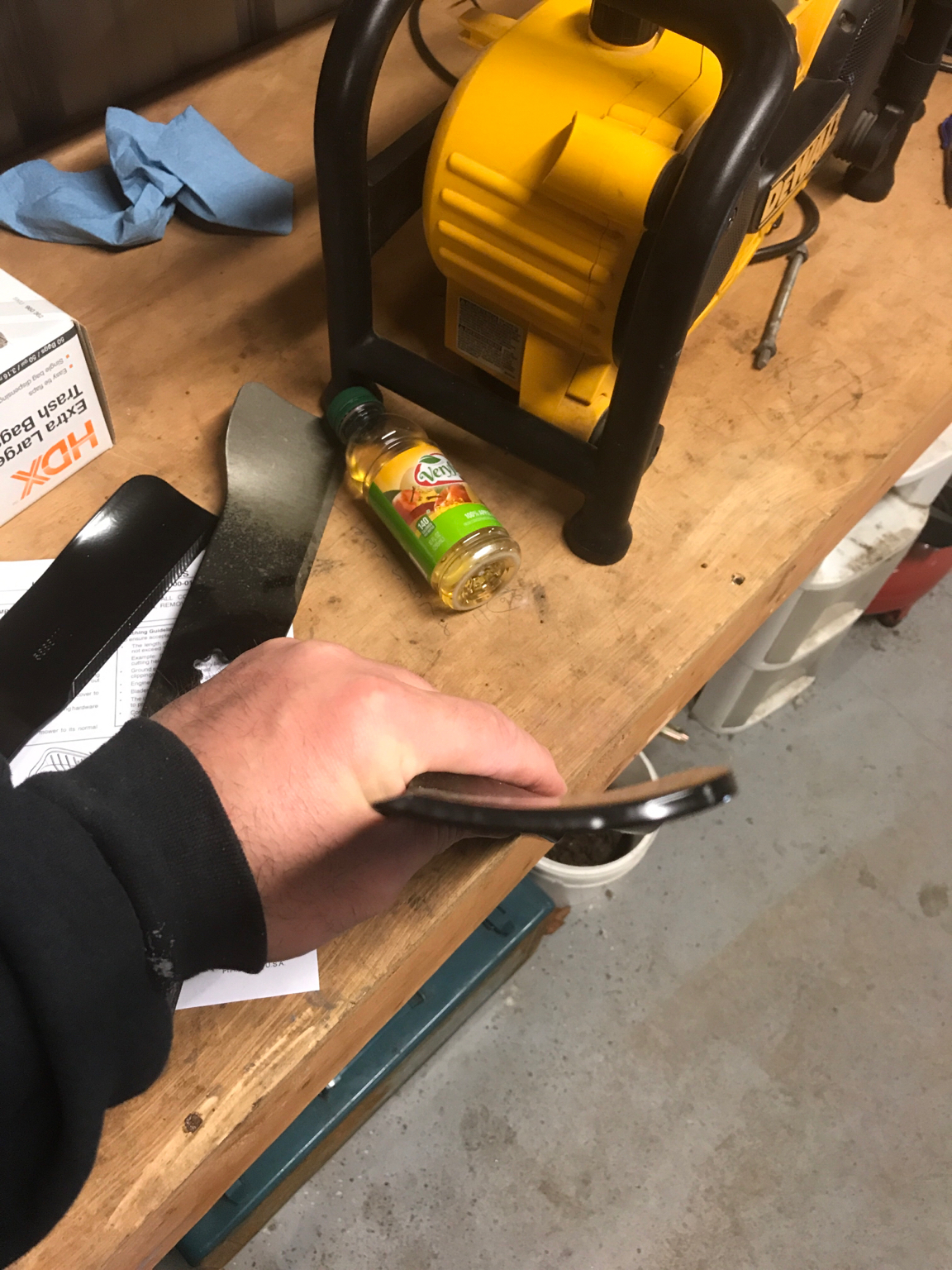

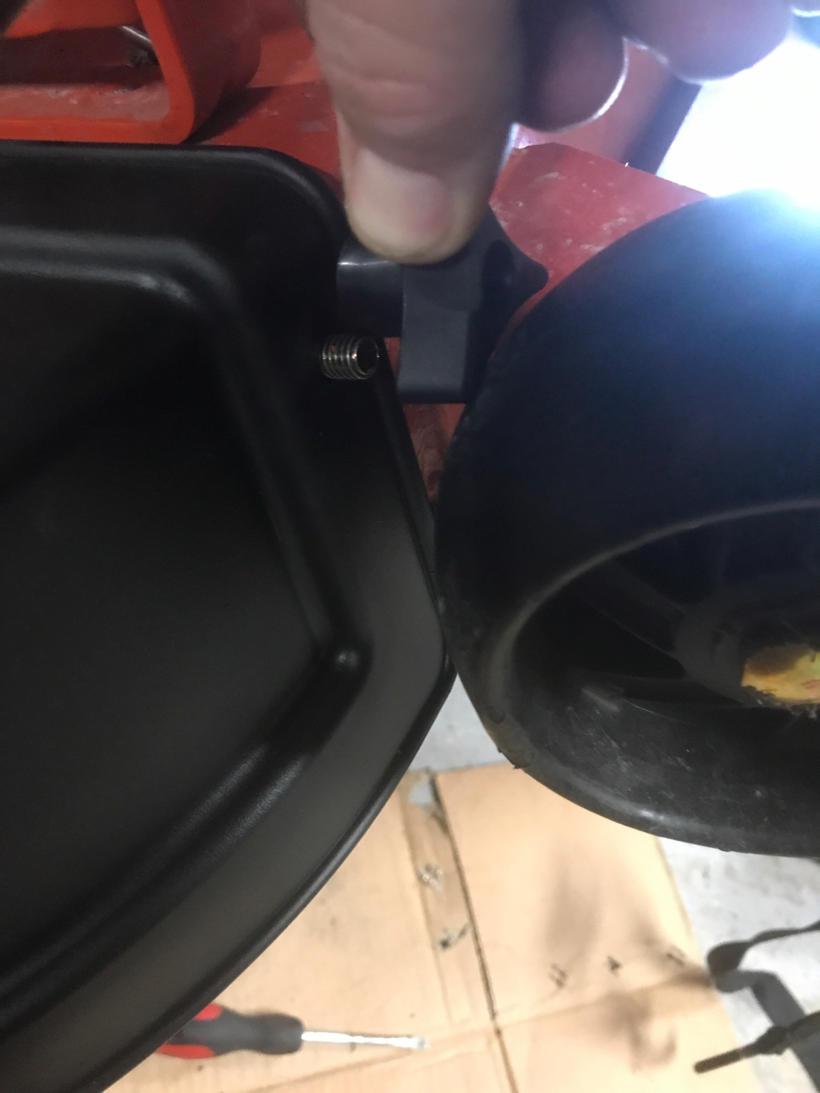

I installed my mulch kit today. Here are a few pics. The stock blades must be a real high lift blade? There is quite the angle on the end. The plug on the deck is attached with 2 bolts. The rearward bolt would require to take of the anti scalp wheel in order to get the nut that came with it on. Instead I just put a washer then lock washer and a normal nut on. I can't remove it by hand now but that's fine. IMG_7791.JPGIMG_7793.JPGIMG_7794.JPGIMG_7800.JPGIMG_7795.JPGIMG_7796.JPGIMG_7802.JPG
