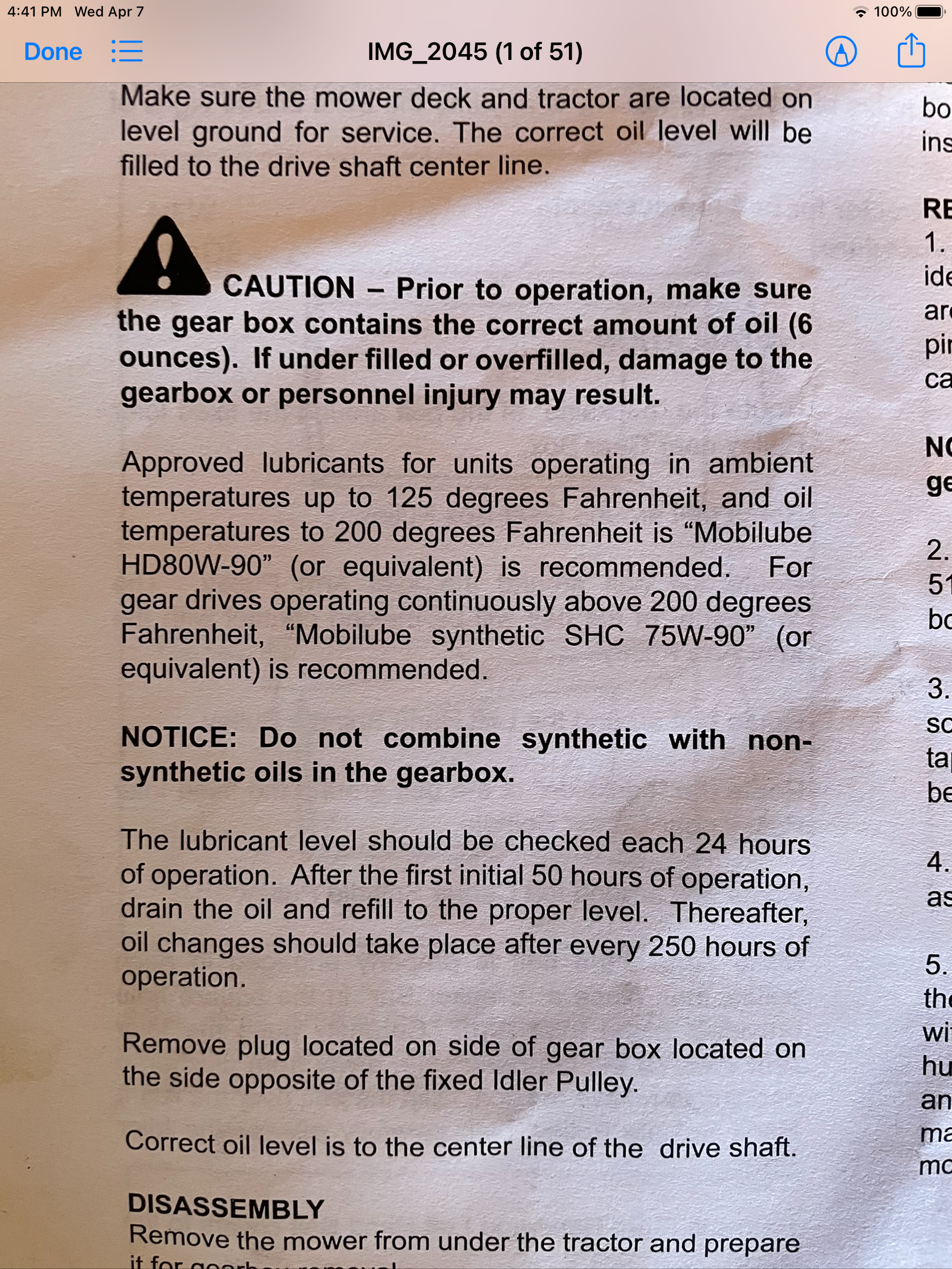

More questions... I don't have an owners manual yet, it probably doesn't show it anyway knowing how the other was.
Where is the hydraulic main relief valve? Not the loader but the first relief valve before the loader and backhoe?
What is the psi specification?
  • Max 26XL Wiring Diagram Extracts.pdf
  • MM60.pdf
   / New Owner: Max 26xl TLB Questions #18
manual at link below, too large for site attachment.
relief should be under the brake levers under floor board maybe a foot back from the fuel filter, has a large nut on top silver, i believe, pressure are in the owner manual
