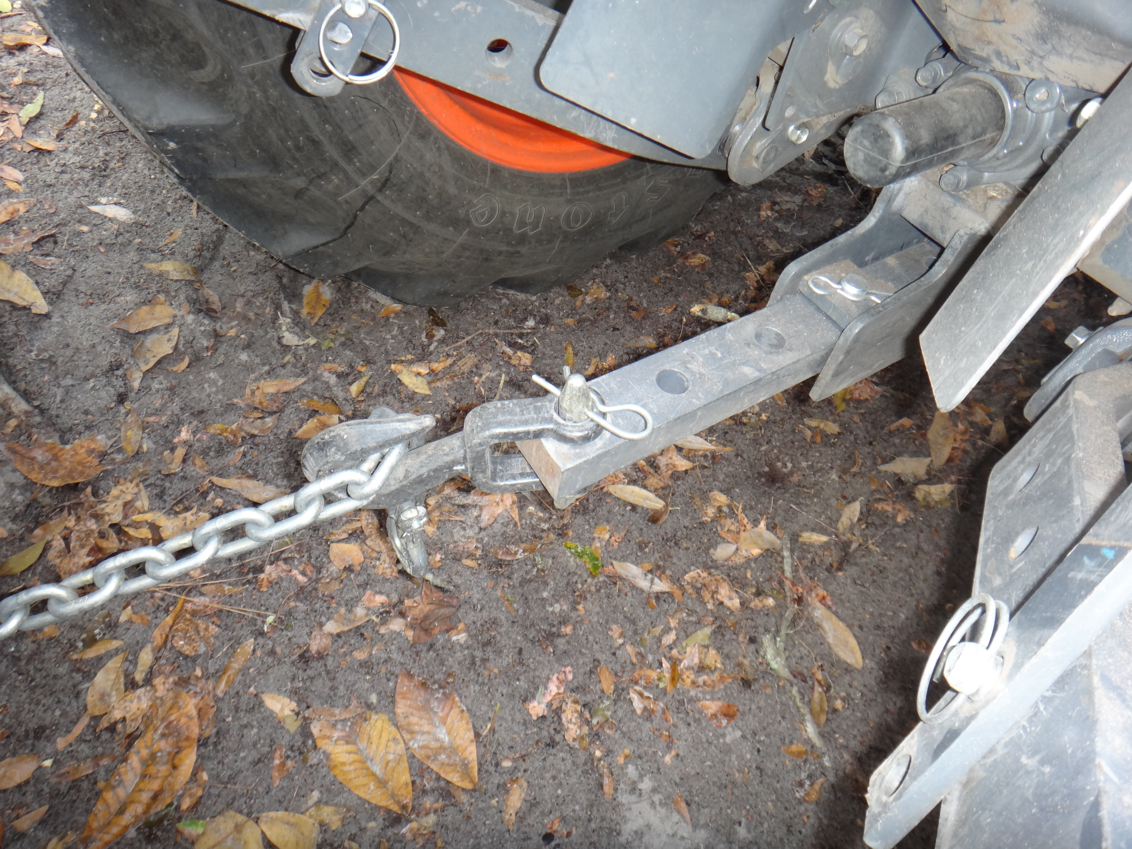

Consider towing the heavier tree trunks with the rear/center drawbar and 5/16" or 3/8" Grade 70 chain. I believe 10' sections of mature Fir and Alder will weigh more than a ton. Attach tow chain to a branch stub so chain does not abrade pulling over hard surface roads. Not safe to transport heavy loads with the FEL on slopes.
