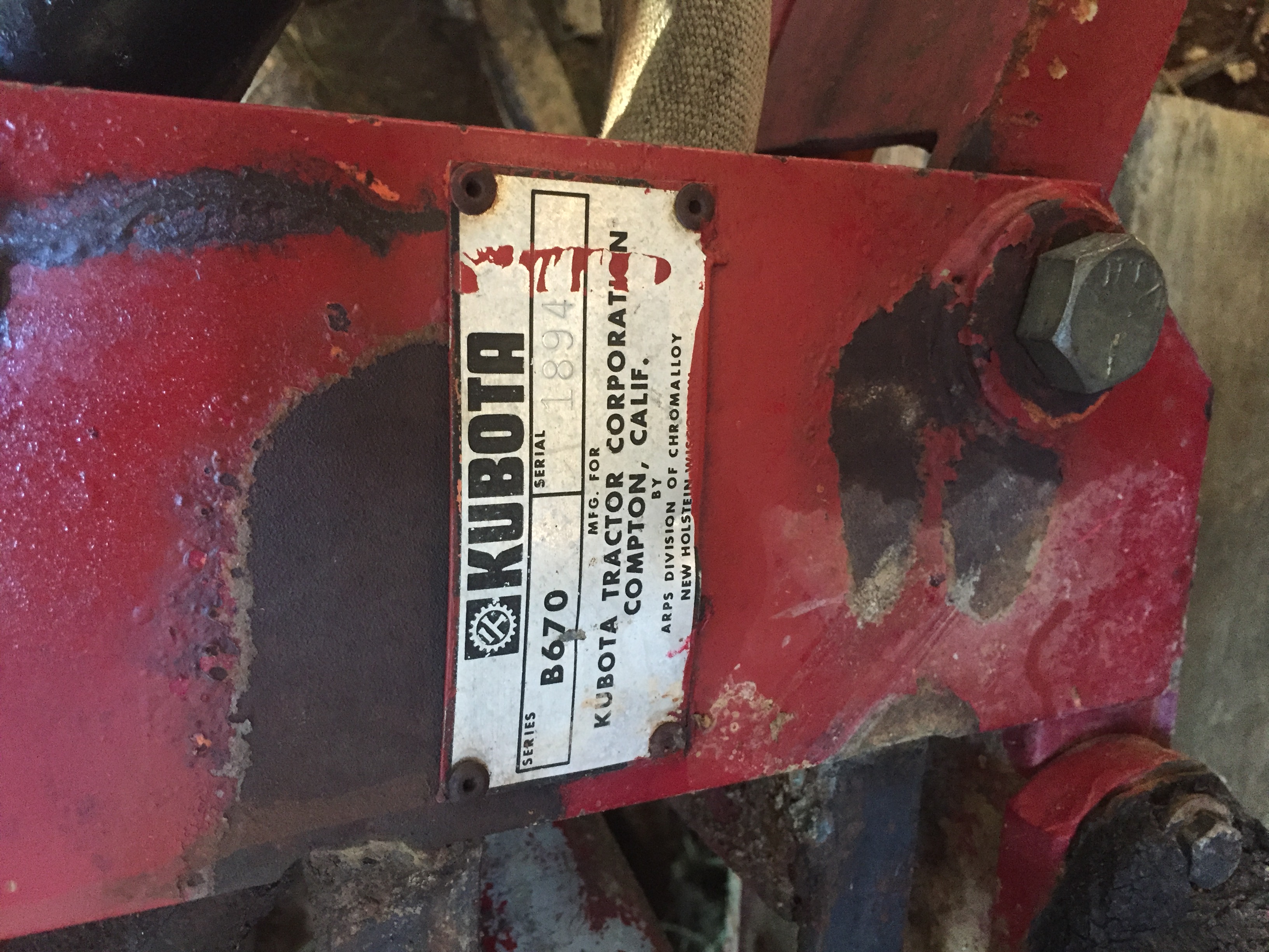

Just as I was walking around the tractor, I noticed a badge on the backhoe. I had previously missed this. It’s a model B670 Kubota backhoe.
   / New Owner of a YM165 #85
Just as I was walking around the tractor, I noticed a badge on the backhoe. I had previously missed this. It's a model B670 Kubota backhoe.
Thank you !!! :thumbsup:
Others have suggested that my similar backhoe was made by Arps but I've never seen proof of that before, or found Arps. You just solved a mystery! Given that information I did some searching that you might be interested in:
Your tag:
Kubota Series B670
Mfd for Kubota
by
ARPS Division of Chromalloy
New Holstein, Wisconsin
Here's the builder's tag on my similar K650.
'K650' was also labelled as 'MFD for Yanmar' with green paint, and sold by Yanmar dealers, I think labelled Y600.
80297d1183336070-harbor-freights-little-towable-backhoe-p1110947rbh2detail-jpg
...and I see the reason there isn't much known about Arps is because that name was abandoned in the mid 80's. Here's a 2001 post describing Arp's history back then. This more recent Amerequip history hints that Arp was building Deere's OEM backhoes at the time your backhoe and mine were made. That likely explains why, when I looked for a replacement backhoe bucket tooth, the tooth's manufacturer told me the only application for that tooth was an obsolete Deere part number.
