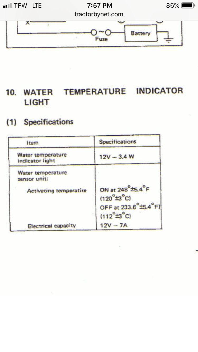

Anything over 190* is "hot". A temp light would have come on at 230*. I would "back-flush" the cooling system, or even do as Winston suggested, repair and re-install the original radiator.
According to what I have seen/read, the temp warning light for a thermosiphon cooling system like this would come on at 248 and go off at 233.

OK. But first on the running temperature. You are right, warning comes on 248 & goes off at 233 deg. F. But just because it can run hot doesn't mean it should. Probably the most valuable thing that such an extended high temp. range really gives us is a sound argument for pumping water around a cooling loop rather than counting on the magic of thermosiphon circulation.
But what we're stuck with here is a thermosiphon system. So we make it as good as we can. And it would be nice if we could induce the cooling system to get down around 215 to 225 F. Things like gaskets work better at that temp, and even engine oil is in a more range where it was designed to work best.
So double check that your 70/30 water antifreeze mix is mostly water and less antifreeze, right? Not vice-versa. Reason is that anti-freeze has a poor coefficient of heat transfer.
And then make sure that fan is working to pull the air through the radiator fins rather than around the outside or in from the sides. Tractors don't have vehicle velocity to help force air through the radiator, they do it all with the fan.
We force the air path to go the right way in two simple ways: First is to make sure air is not being pulled uselessly through the gap between the copper radiator and the steel radiator mount. If there is a gap, get some dry foam rope window caulking - nothing sticky or in a can....we're using the flexible polyurethane rope used to seal around windows and doors. At Home Depot four bucks buys a lifetime supply. Or maybe you've got some laying around. It's the kind of material a tractor guy is likely to have in the attic or barn, no? You can force it into the gap with the flat end of a carpenter's pencil.
Now back in message #66 look at the picture and thatside screen part 20. Does your tractor have that screen? I sure hope so, those side screens are shaped that way on purpose. They help direct airflow a lot. The thermosiphon needs them for the side resistance, rather than for the screen. You can try covering part of the screen with masking tape and see it that helps the fan pull more air through the radiator. Any change should be obvious on the temperature gauge in a few minutes.

Yes, coolant mixture is primarily water. I actually put a mixture of something like 85% water/15% coolant in it the other day. While moving dirt with it today I did notice something odd. Temperature got up to maybe 240 or something like that and I decided to shut the tractor off as I needed to pick up a few things anyways. I held my ear to the radiator hose and did not hear a “gurgling” noise as I had heard in the past (indicating the coolant was circulating). The tractor did cool off, but not as fast as I think it should have. Possible air bubble in the cooling system? Or should I put in a higher concentration of water/coolant mixture? Or is this normal for moving dirt? Just thought it was odd I didn’t hear the gurgling as I did before.
EDIT TO ADD - Yes I do have the side screens on the tractor/radiator. As well as the fan guard. I did have to modify the fan guard to fit the new radiator.
I am pretty sure 190 or 200F is perfectly normal and inside the normal range on a thermosiphon yanmar run in the summer. If it was too hot at the temps the light would come on at what ever the too hot temp is.
