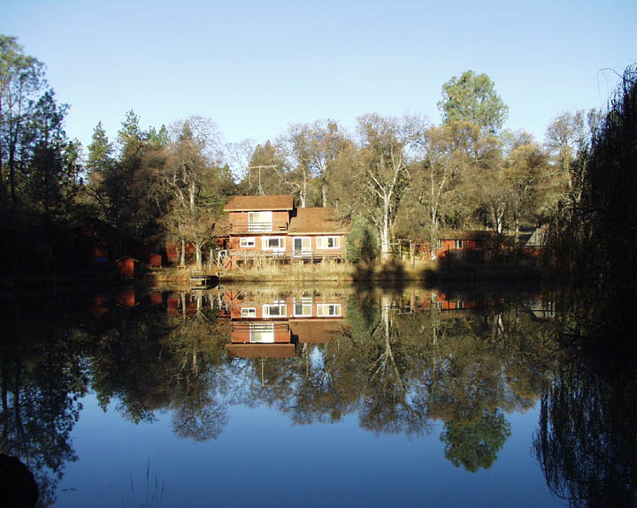

Harv,
What a nice pond you have! Looks like you have your own State Park!

<font color=blue>What a nice pond you have!</font color=blue>
Thanks, Buck. Attached is my current favorite picture of the place. One of those early morning take-your-breath-away scenes.
And thanks for that link, too. I'm compiling a bunch of information about how to get the most out of my pond, and that one helps a lot.
