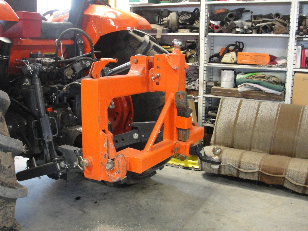

Okay stuff layed out
My "print" thanks to a member here
Mark and cut upper link for
Marking side for drawbar cut outs
Test fit and tacking of inner skeleton and upper link mount
Inside shot (missing one last tie bar, to maintain 2 gap at upper hole)
Heading to town for concrete, and then get mixer and figure out how to mix and pour straight into barrel?lso have to tape/plug holes that may leak

How do you pour concrete into a 55 gallon barrel?
not by dang hand...so I grabbed ole ford and mixer, that is when the light bulb came on...went off; and came back on
so it actually went fairly good, my pants are not soaked with concrete and as far as I know...no Kittahs or puppies were harmed filling Ballast box
9 bags in and the barrel was very heavy so about 850 pounds as it sits
next project today....a rake....this may take a while...it's getting late and I do not have a torch or plasma cutter...

Looking good. Your patience are much better than mine to cutoff wheel those teeth.
As for the counterweight. Only thing I'd have done different would be to put the 3pt arms link lower. I'd only have wanted a couple inches of drop left on my 3pt when hitching up to the barrel. This gives you maximum lift height. Isn't an issue until you get on uneven terrain. Then you may drag your butt a lot. :)

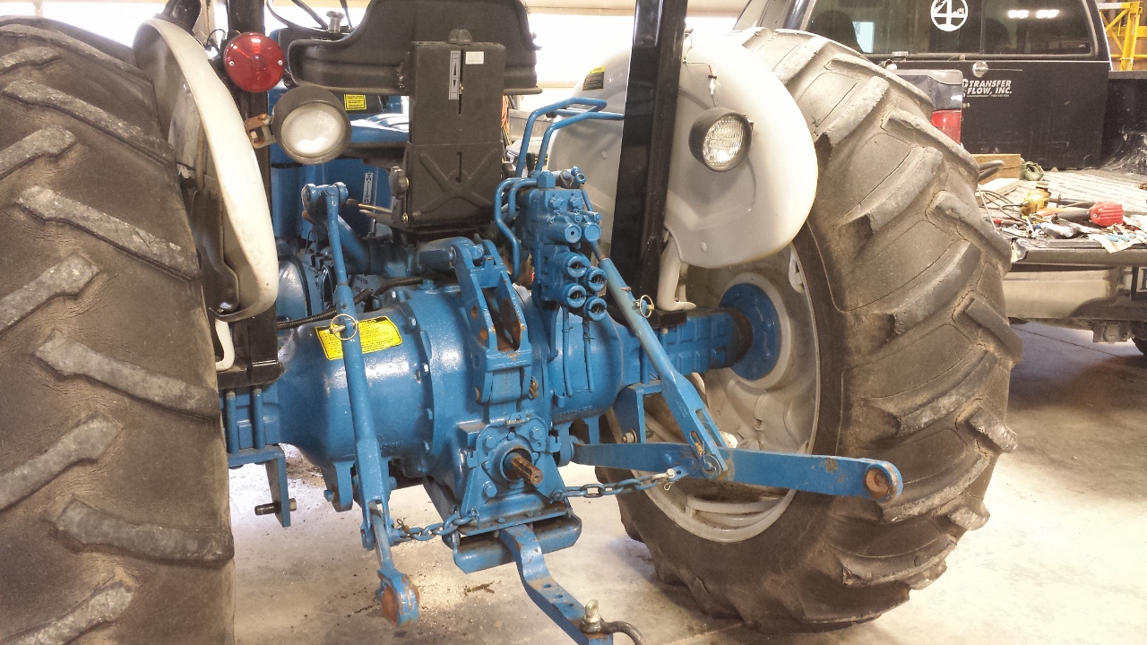

Re: New project 1975 Ford 5000
Here's the best I've got now of the top link area. I think you are missing a critical part there.
