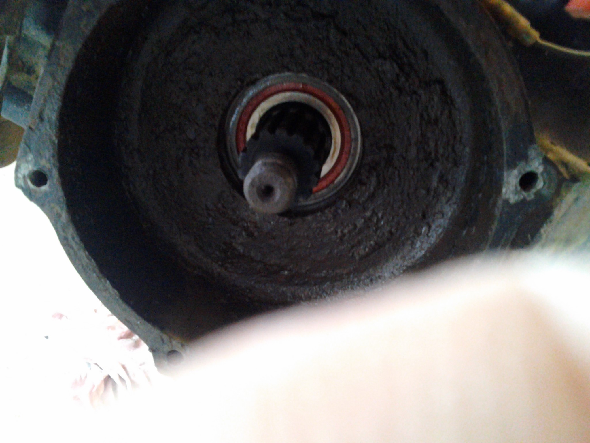

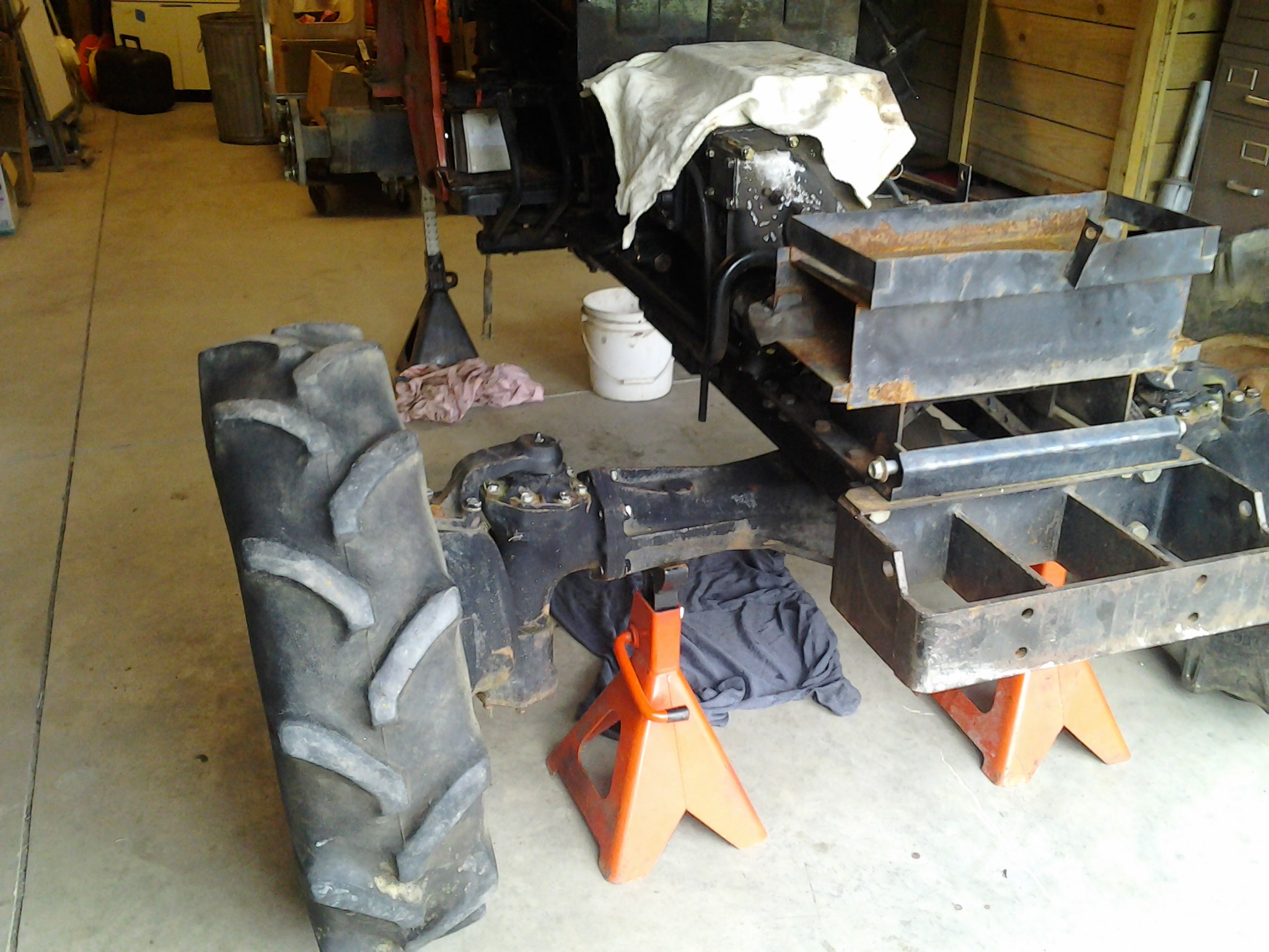

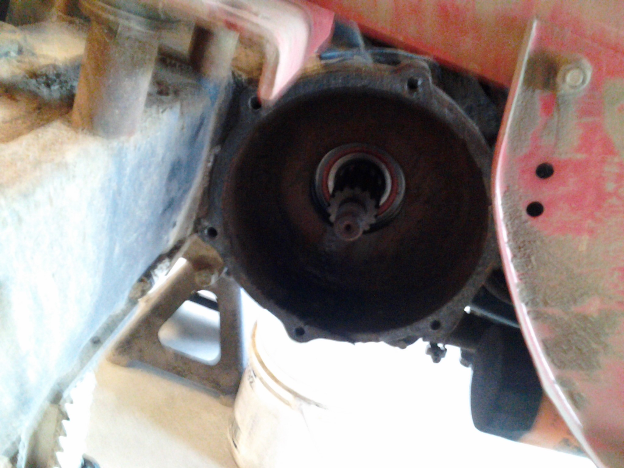

That was a little over my head to. I got a some more done on the tractor today. Checked the brake seal collars out and one was bad but the other one would most likely be usable. If it don't clean up nice I'll replace it also. 002.jpg003.jpg003.jpg004.jpg

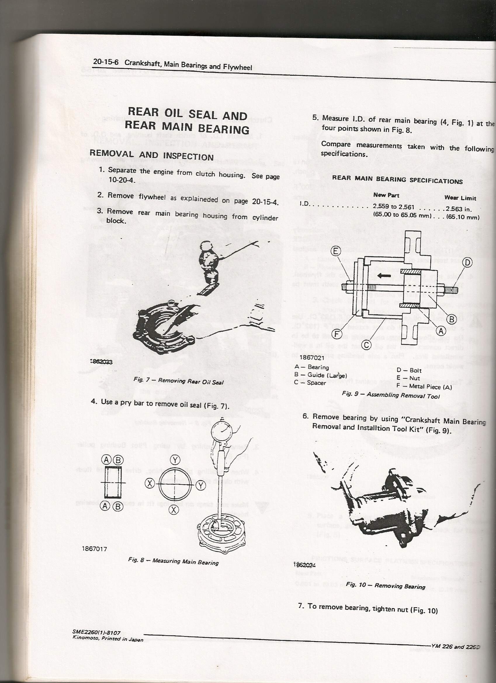

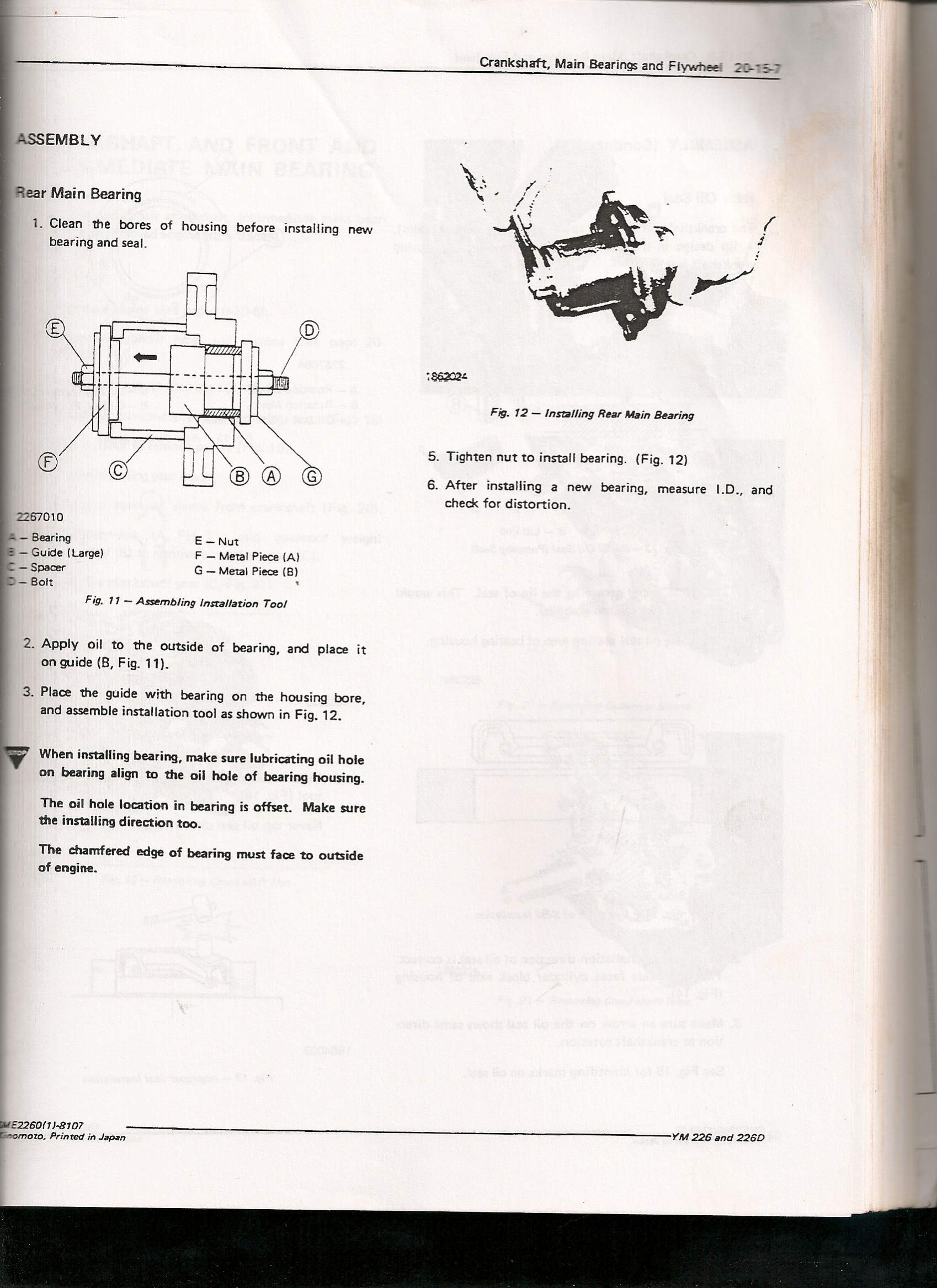

I have not heard of this either, and I have rebuilt many engines, including three 3-cyl Yanmars.
I have not had to press-fit any crank bearings, either. Anything special required there? I know the
bearings are soft....do they use anything other than a conventional hyd press? Special die or
tool, maybe?
   / NEW PROJECT #49
Yanmar does have specail tools for removing and installing the one piece main bearings. Here are examples from a 220/226 repair manual.
   / NEW PROJECT #50
Interesting. It seems that a hydraulic press would work fine.
