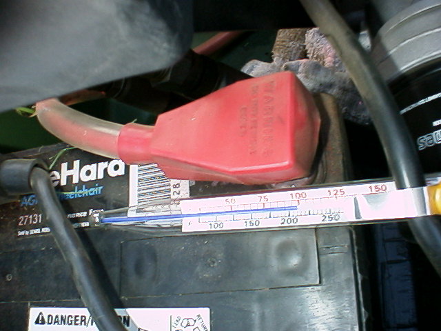

OK. The verdict is in. I finally had a chance to mow today and the temperature around the battery hit almost 225 degrees after one hour! And that’s with an ambient air temp of about 75 degrees. By the time I grabbed my camera, the temp had already dropped to about 212 degrees on the thermometer. The thermometer, as you can see in the attached pic, basically measures the air temperature around the battery, and therefore falls fast when the engine is idling. I have no idea what the actual battery temperature was but can guess it will get really high if bathed in 225 degree air for several hours.
I leave this thermometer in all the time now and will continue to measure as the summer gets hot. One thing’s for sure…I think 225 degrees is too hot for a battery.

I'm not doubting you that it is HOT in there, however, isn't that type of thermometer supposed to be vertical only? I used a metal cased meat thermometer in mine, and as I reported earlier, it didn't hit anything near that in about the same air temperature.
You definately have a heating problem there. Water boils at 212, and I don't know how potent your acid is, but I'll bet you were right in your thinking that the sucker just boiled to death after several hours of cooking back there.
I'd call Power Trac and ask them for help. That is too hot!

Marrt: For some years, Chevy trucks had starter problems because of heat radiated from the exhaust. They cured it with a with a simple shield, which also became available after market. It was two thin metal sheets with asbestos or other fabric sandwiched. It eliminated the radiant heat completely. I recall seeing pads to protect counter tops in kitchens for cheap that would probably work great. They still around?
   / New PT, New Problems #54
I agree a radiant barrier could prevent a lot of energy from heating your battery, especially since batteries are usually black, black being very absorbent of radiant energy. I think this is your biggest source of heat transfer to your battery. Your thermometer may have been heated mostly by the radiant energy from the muffler rather than the air. I say this because air has very little mass to transfer energy, compared to your massive battery. A simple experiment would be to put a sheet of shinny metal (aluminum, Stainless Steel) or just wrap aluminum foil around the battery area with the thermometer behind the foil. The reflector should not touch any heat source (muffler, engine, etc) otherwise conduction will rapidly heat your reflector and then it will begin radiating heat.

MR, regarding the question of the thermometer needing to be vertical…I don’t think that’s required. I think this thermometer works by having a sealed enclosure under a known pressure. As the temperature increases, the liquid (used to be mercury…think it’s alcohol these days) expands at a know rate based on the initial internal pressure. If true, I think it may even work upside-down.
Schultz, I agree that a big component of the heat problem is radiant heat. I think I may be able to solve both the air and radiant issues with some type of shield. I sure wish I knew how to use a smoke wrench as this would be a perfect project. I’ll have to think about what I can come up with to address the problem.

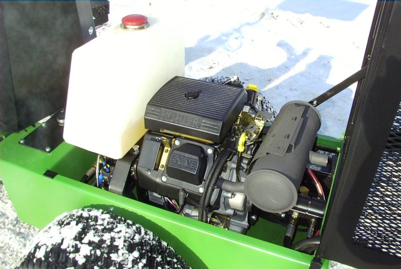

Before going through modifications, what did Power Trac say about the heat problem? I'd ask them if maybe there is a real problem with this muffler design and see if they can repair it or give you a different style muffler.
Anyway, if you look at my muffler, there is a heat shield on the back of it to protect the engine from heat. I've attached a picture, in case you're interested. It might give you some ideas towards modifying yours.

   / New PT, New Problems #59
And here's another picture, from the other side(the side with the battery). Hope they help.
