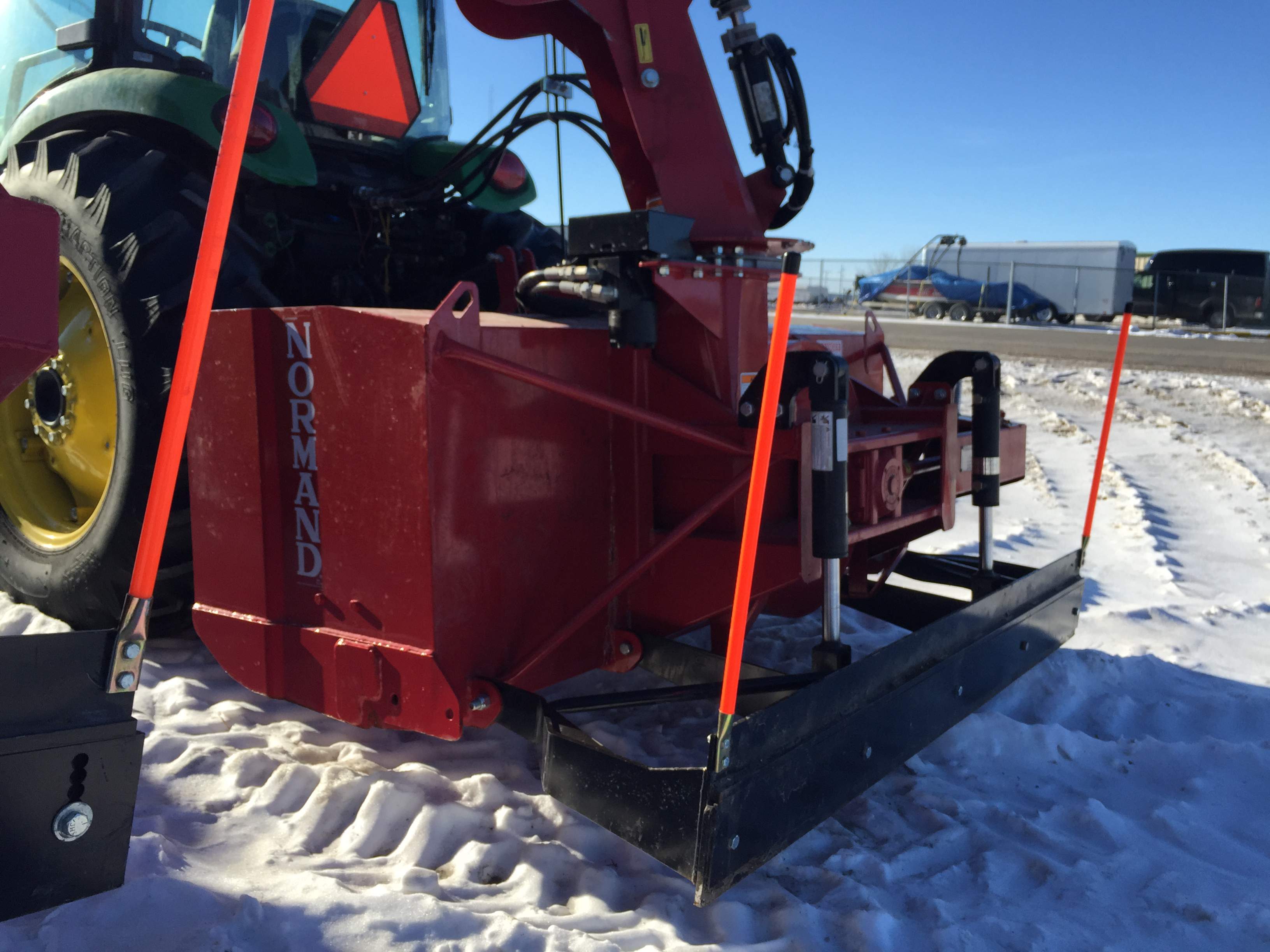

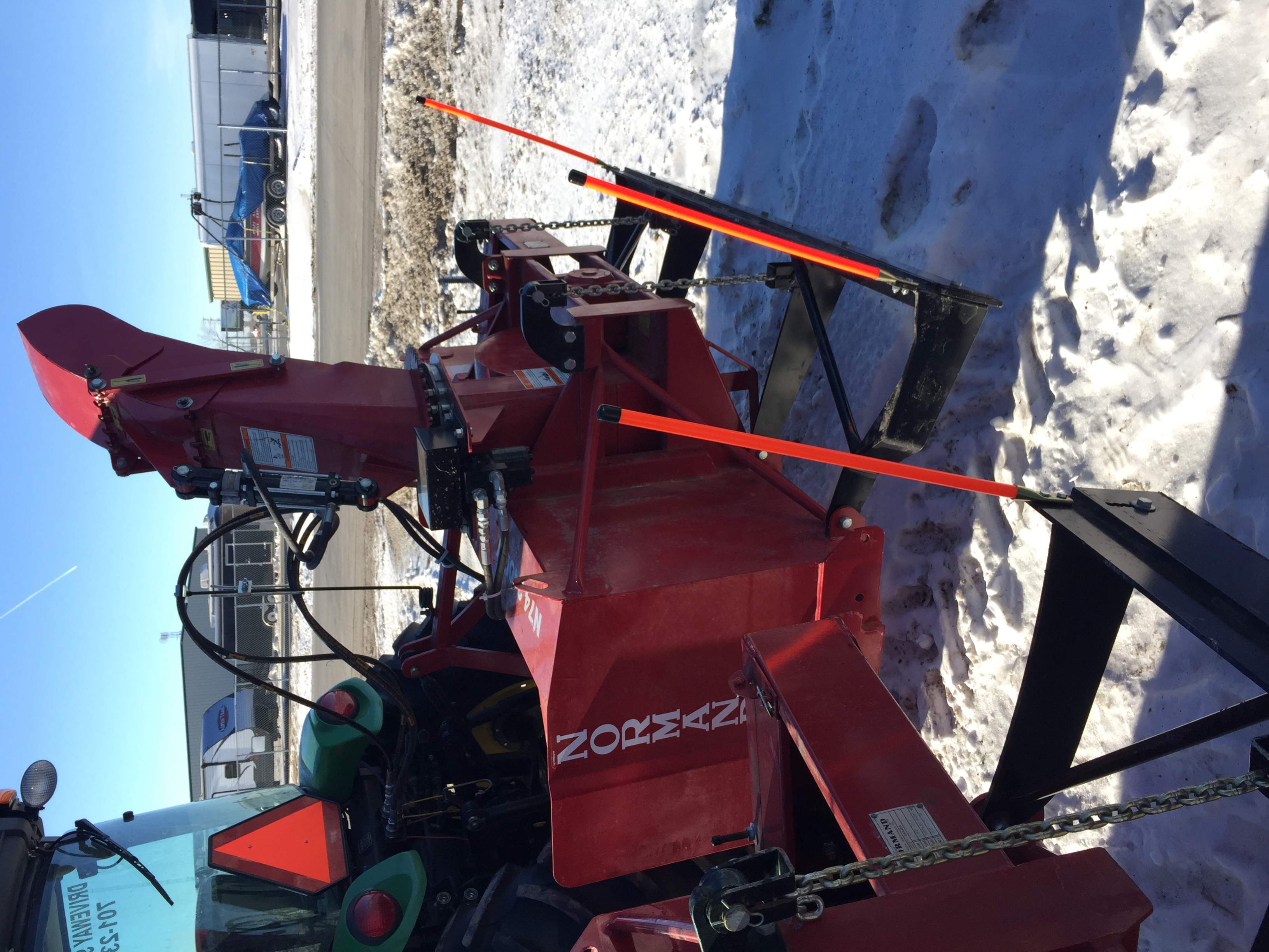

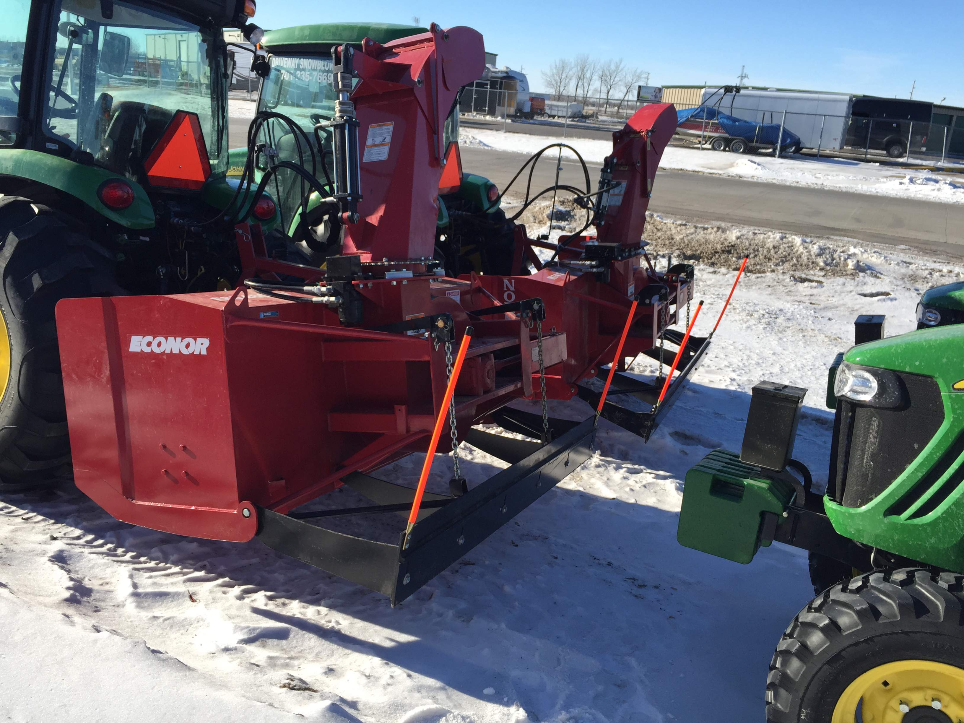

Hey guys, I went outside and took some pictures of the rear blades on our Normands just for you :)
We run the rear blades because they let us get that much closer to the garage doors when we service customers. I always suggest that anyone getting a pull style snow blower for commercial use get the rear blade. But if you're only buying the blower for your personal property, then the extra expense of the rear blade might not be worth it.
The pictures below show them both ways, hanging from a chain, or on cylinders. Notice that the one with cylinders doesn't have any hoses hooked up. I actually have vented plugs where a hose would hook up, so it's basically working like a chain, they just float along the ground. If the hoses were hooked up then the entire weight of the blower could be put on the rear blade, really scraping up hardpack well. If you guys have any questions about blowers I'd be happy to help, we use them a lot. Just shoot me a PM, or even an email if you want. steve @ fargosnow DOT com (hope that keeps the spammers away!)

I noticed the middle pic, the cylinders have no hoses going to them, how do they function?
/ New pull type blower #69
He said that he had a breather in the cyl. and they don't function, just gravity like the chain.:thumbsup:
