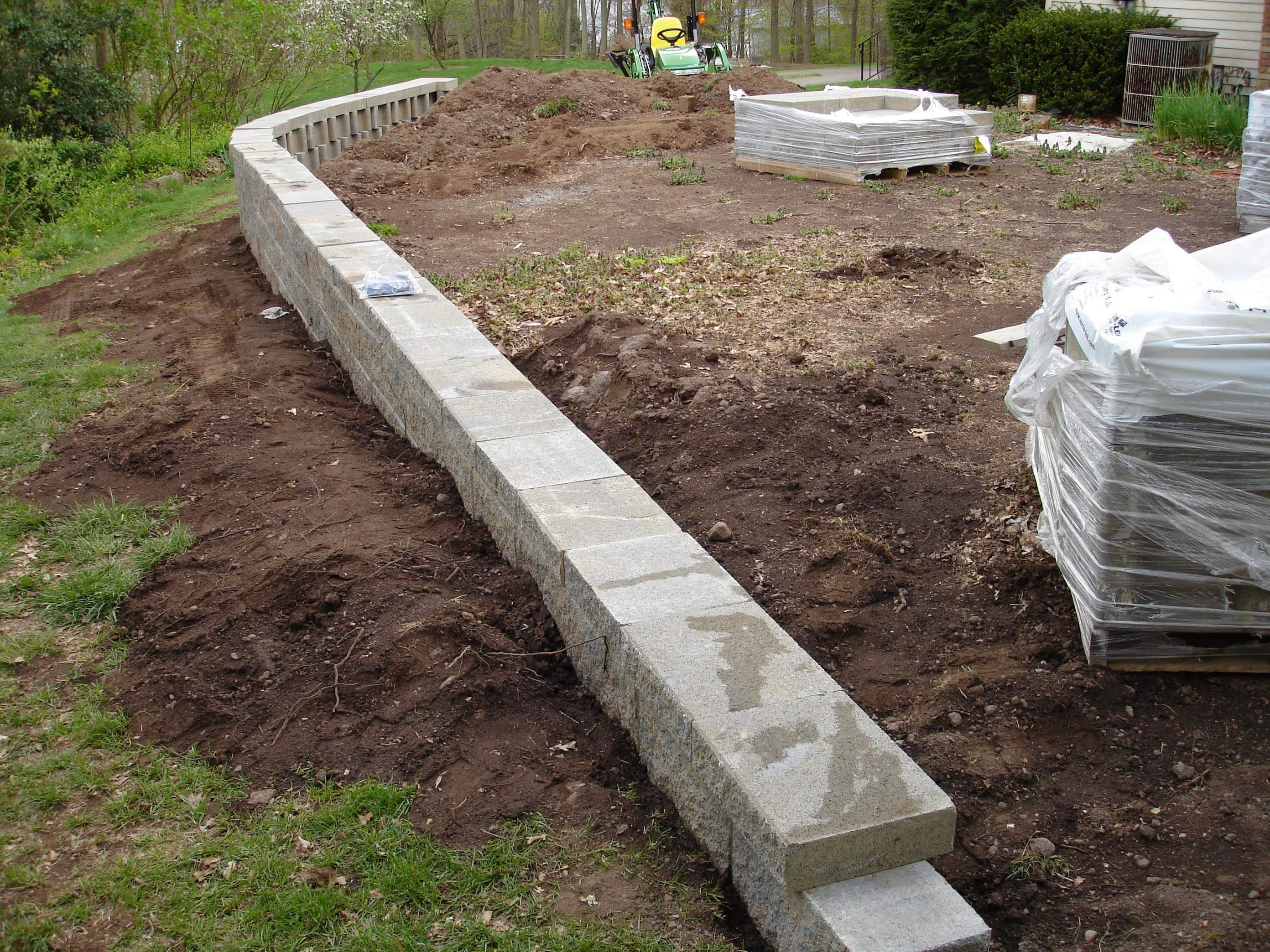

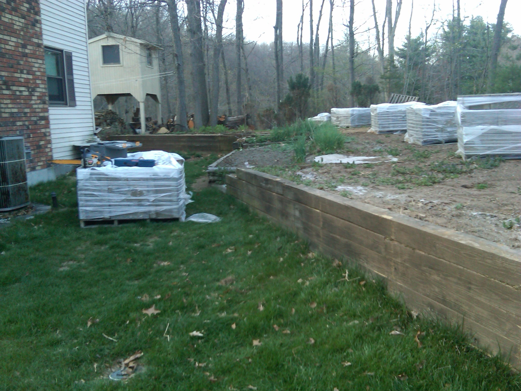

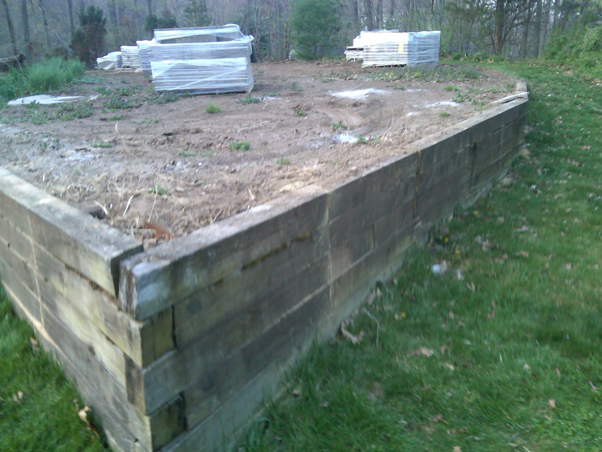

Well we started the destruction...I mean...construction last night. Below are 'Before' pictures. The only thing we did prior to when the pictures were taken was that we cut the #3 rebar that was inserted in the top of the wall every 8' that held up metal garden fencing. I dont know if you can tell but my father precut the wall with a circular saw every 4' (Picture 3). Even though the saw only got about halfway through the wall when the guy delivered the block with the piggyback forklift the weight of the machine near the edge of the inside of the garden wall was causing it to flex worrying my father of a possible premature failure.
When I arrived at the house I took a sawzall and prededed to make the cuts approximately 2/3 of the way through the wall at the narrow point of the wall (foreground in pictures). Since we still felt this wasnt enough my father fired up the chainsaw and preceeded to cut nearly all the way through the wall until the chain was dull (approximately 3 cuts) because we somehow found 2 spikes and a bit of dirt.
I then proceded to fire up the 2305 and head over to the point of the wall. Our plan is to remove the wall as neatly as possible then using the FEL scoop the dirt up and dump it further inside the garden to remove that fairly unusable part of the garden. Backing up I grabbed the point of the wall with the BH and began tugging. That little BH has some serious power for such a small machine! While tugging I was moving a good 12-15 feet of wall on either side of where I was working! Later I was able to carry a 16' 6x6 using the FEL like it was a large cigar by hooking the end of the timber under the top lip of the bucket. The wall, however, did fight back and progress was slower than i expected but we were able to remove 8 feet of the wall facing the house (left side of the point) and 12 feet of wall to the right side of the point by the time we quit at 8:15. It would have progressed faster if we spent more prep time cutting the timber. It was just too dark to work or take any pictures when we quit (sorry). Maybe I'll get some shots before starting work again.
Just before we quit for the evening the left joystick on the BH controls began to stick in all directions and would not return to the neutral position making it very dangerous for my father to be standing close to the rear of the 2305 to give me directions on how to grab the timber. Anyone have any ideas as what was causing this?
More details and pictures to follow!

try a little dry lube spray on the linkage there are a lot of moving parts in there. Make sure its a dry lube, you don't want to attract dirt. Mark
   / New Retaining Wall utilizing new JD 2305 TLB #3
Unless, there is already stone in there, if you want your new wall to work correctly, then you need to fill in behind it with stone over a drain pipe. To do this, you are either going to have to come out a foot or so, or cut the bank back. Your wall isn't too high, but it will fail much sooner if you don't do this critical step.
Also, you are going to make it hard to set the stone if you don't have some cutback behind the wall while you are building it. It will be very aggrevating, if you don't. Most retaining wall block have a built-in backslope to them. This will fight against your forward-leaning bank too. You gotta break some eggs to make an omelet. No easy way around that fact.

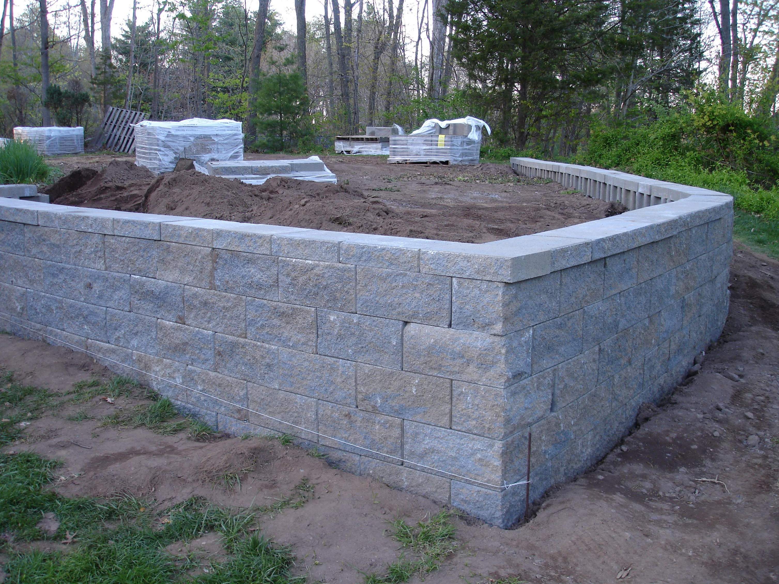

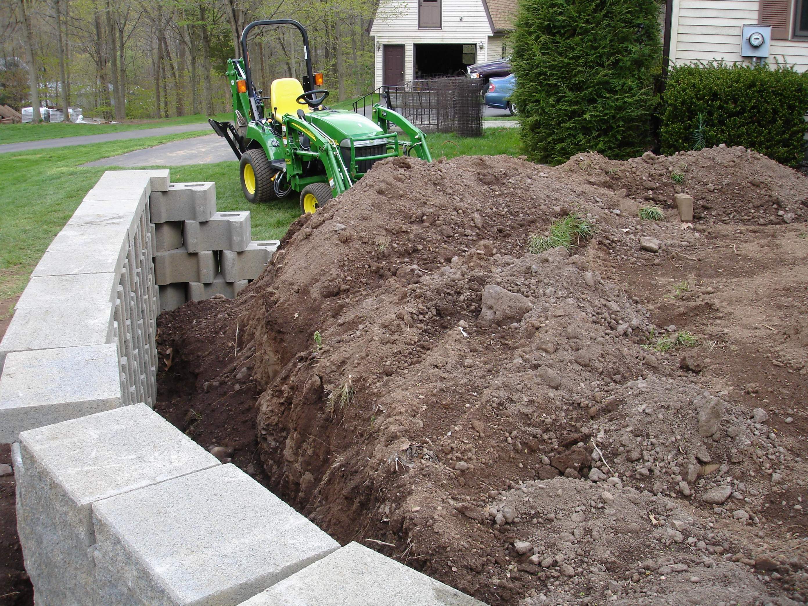

Gittyup: The wall at the highest part will be approximately 4 feet tall. Supposedly anything over 3 feet has to be "engineered" by a professional. Pfff! We have built many retaining walls before and none of them have moved or failed. This is most likely due to the fact that they are all pinned together. We would never dream of building one that retained that much dirt without some form of system to keep the wall together. This wall does not step back at all and is held together with nylon pins and concrete adhesive on the corner blocks and cap. We did cut the dirt back at the corner because the path around the side of the garden is only about 5 feet wide. Since we have the new tractor we wanted the ability to get a 62" MMM around the garden if we were to get one. We did not put any drainage pipe or gravel behind the wall because it is the highest part of the yard and the previous retaining wall had no water related issues. We havent backfilled yet so there is still time to do it if we decide that we need to do something about it. I did give my father what was left of my roll of filter fabric from when I built my retaining wall last year. (See attached photo from when my wall was nearly complete last fall)
I havent had a chance to take pictures from the progress we have made so far, but I plan on going down there tomorrow afternoon to help my father so hopefully I will be able to get some pictures then. So far we have installed about 25-30 LF of wall and have made 1-90 degree corner and 1 slight-angled turn.

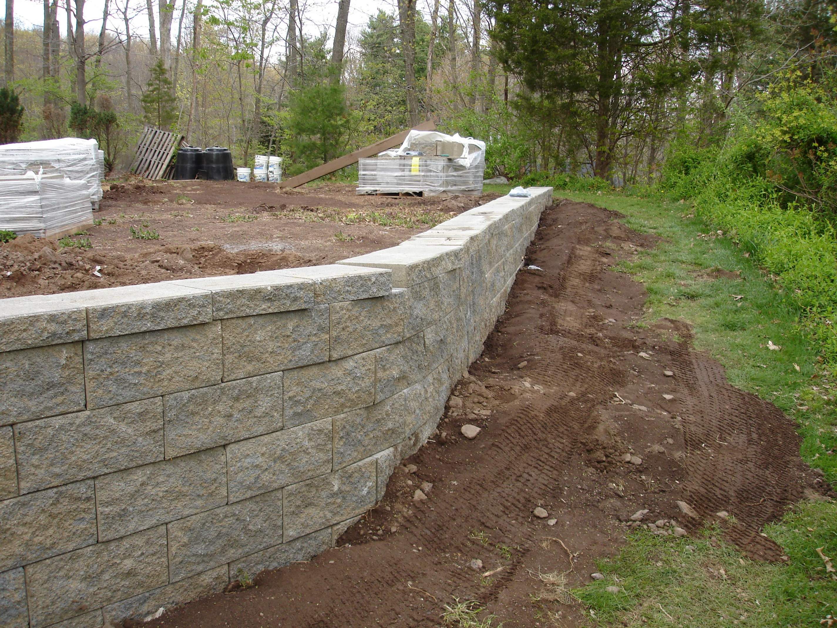

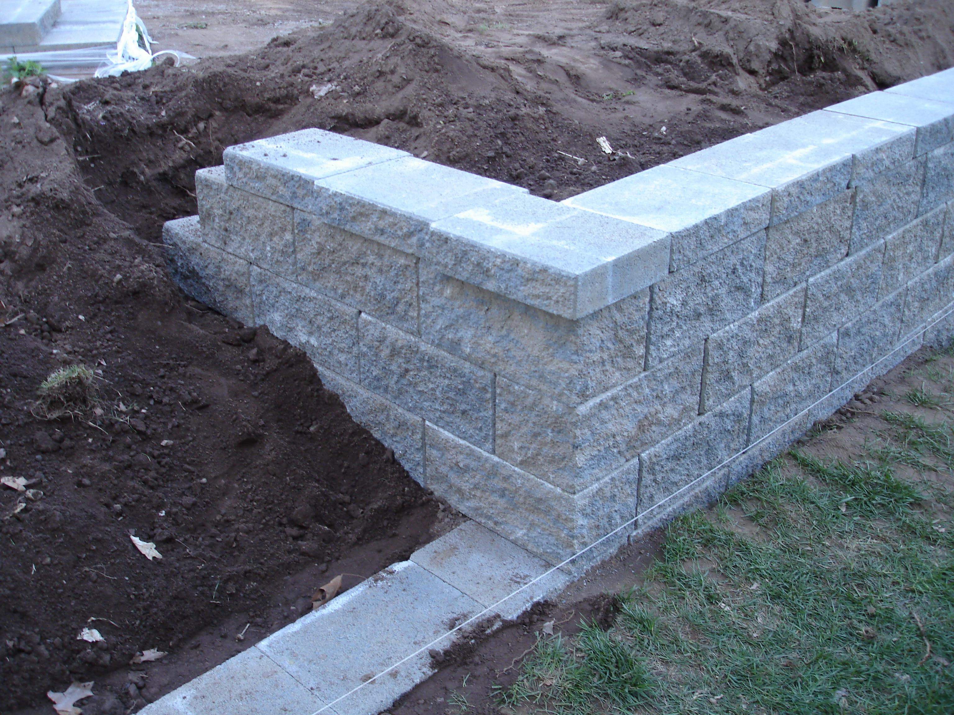

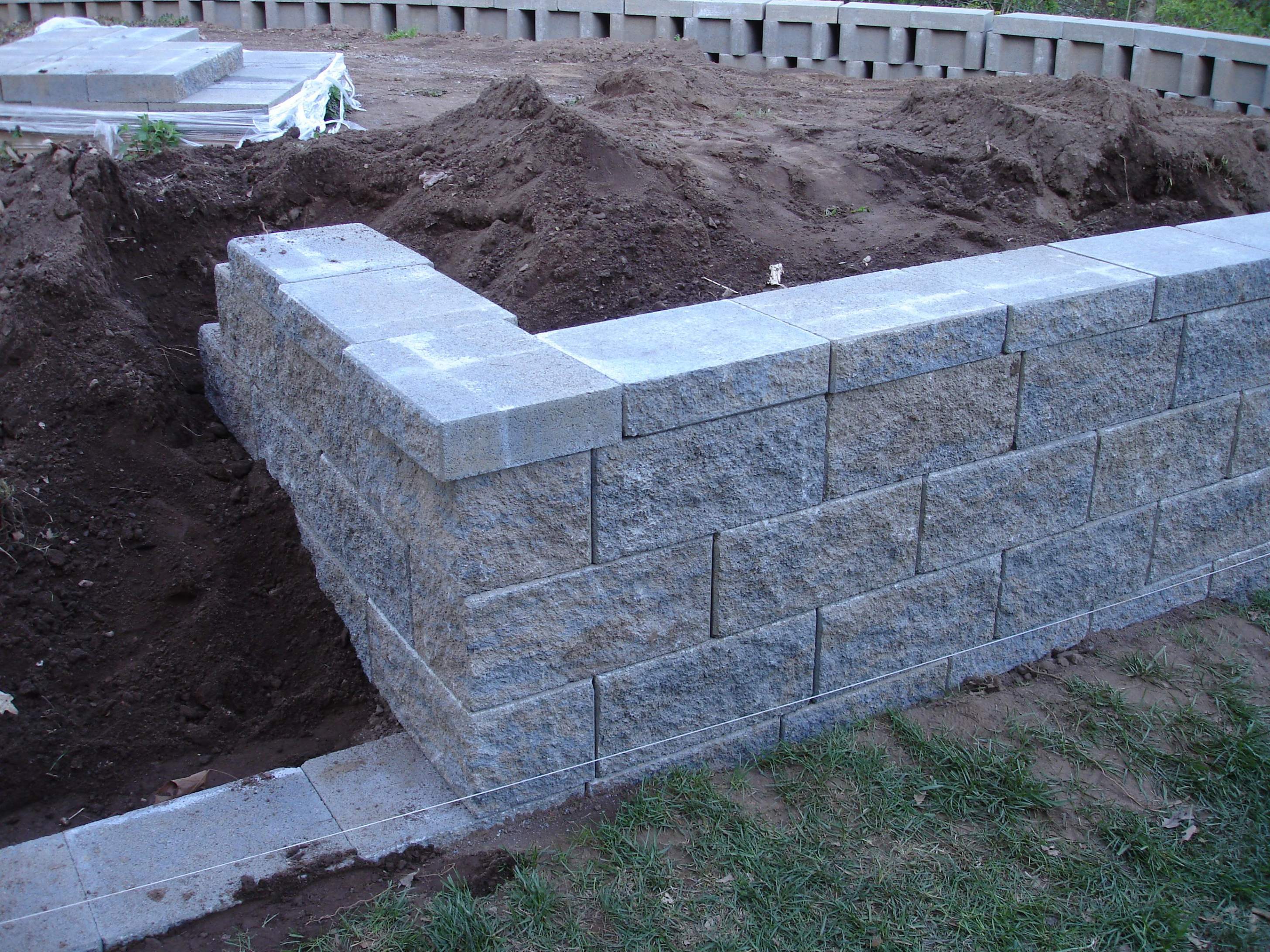

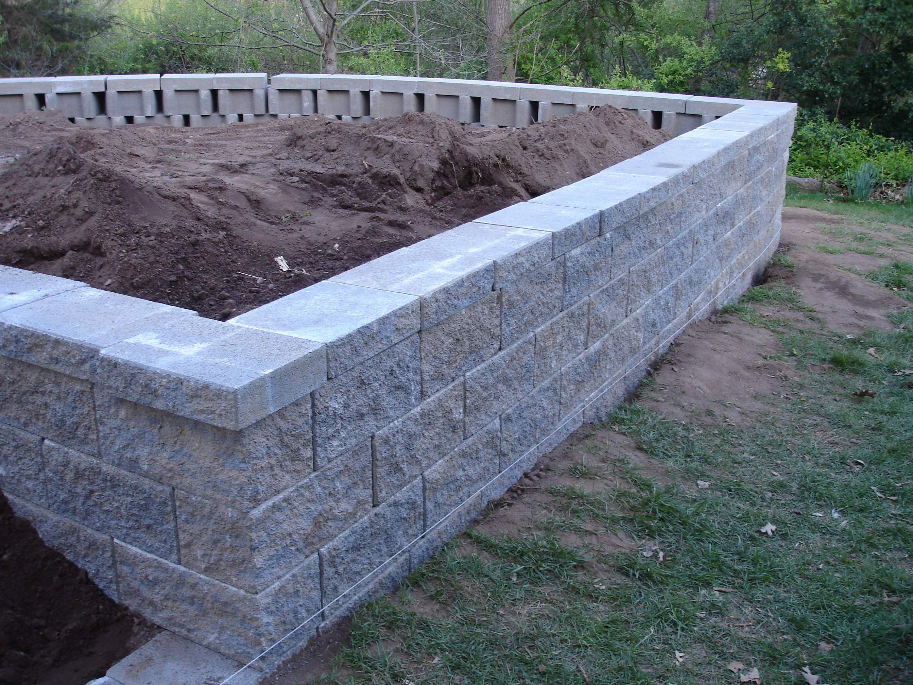

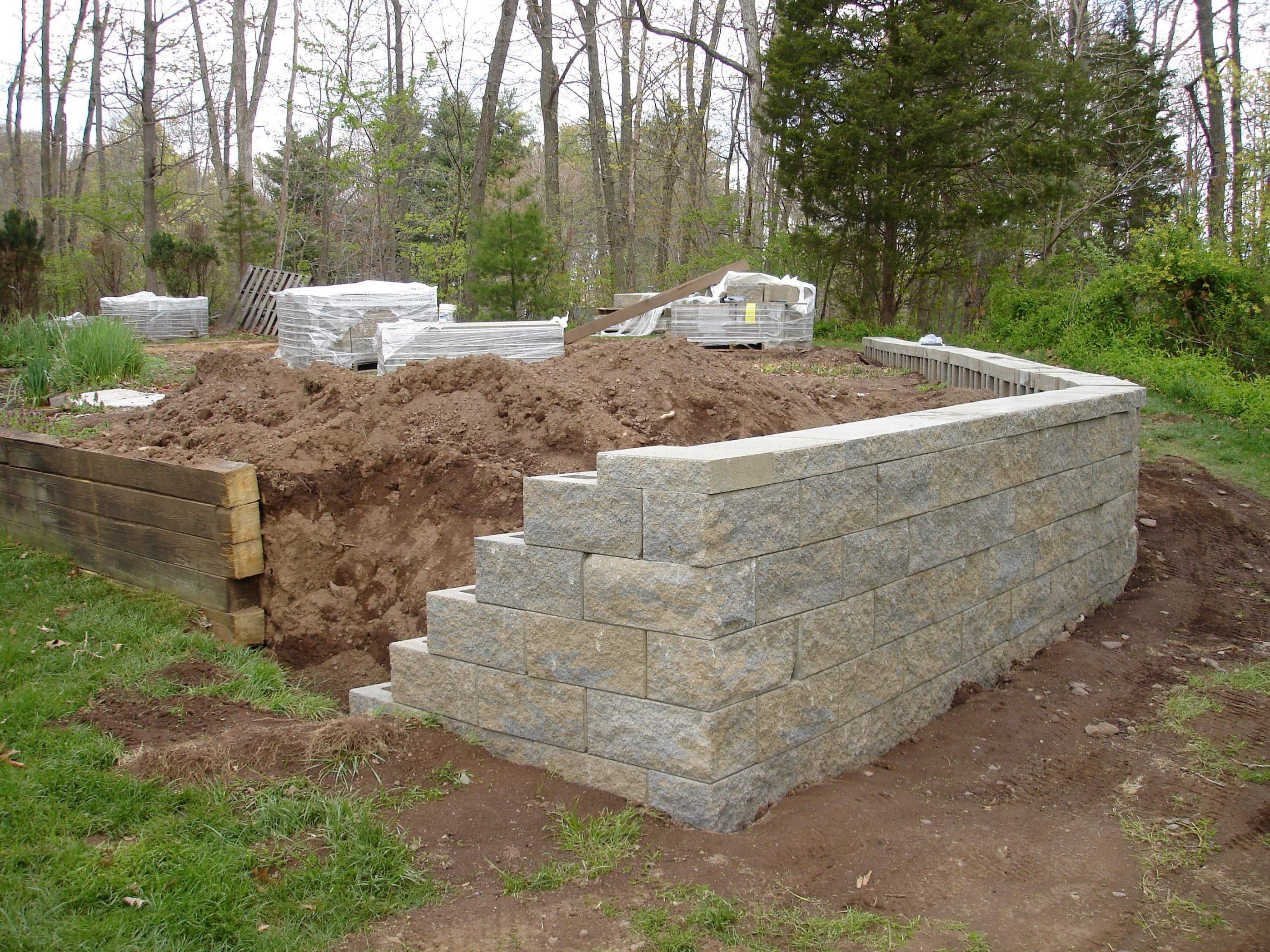

Day 11: The first 5 pictures below were taken at the end of the day Sunday. As you can see approximately 25% of the high wall has been completed. We have not attached the cap block yet so dont send me messages saying that the top is all messed up. we just placed them up there to get an idea as to how many we needed and to get an idea as to how high the wall is going to be. :thumbsup:

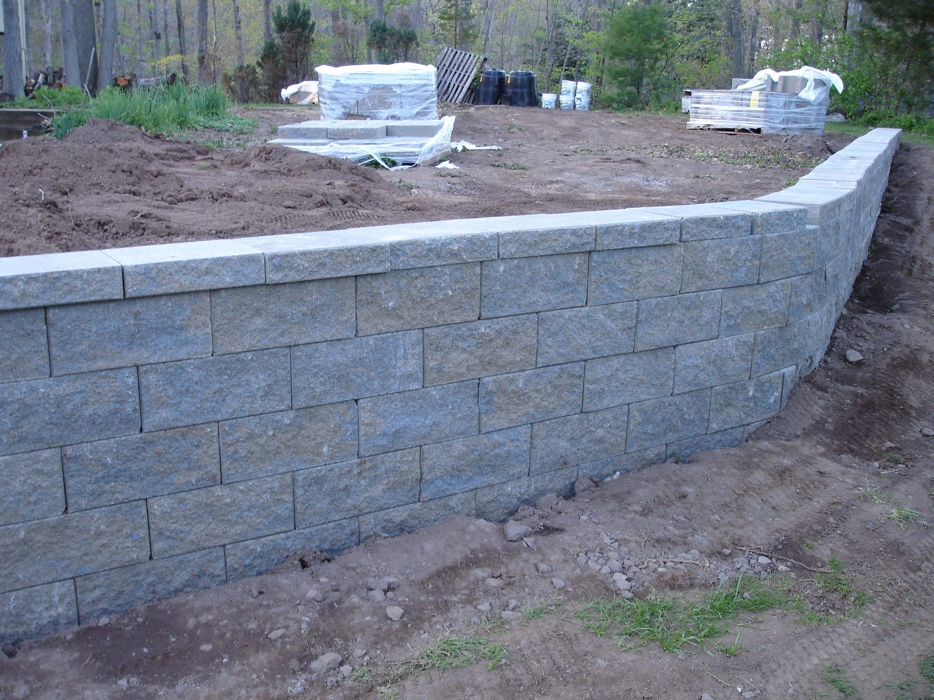

Day 12: The second 5 pictures were taken at the end of the day Monday. We finished another 20-25 feet plus the turn in for the staircase (or ramp...havent decided which way to go yet)
I am doing a poll. Should I keep the cap flush with the rest of the wall or have it stick out 3/4" to 1" to give it some character?

What is to keep this wall from pushing over from freezing/thawing cycle like the previous wood timber wall?
Are there ties back into the bank to hold it straight?

I like the inch over-hang myself.

Nice looking wall. But, no drainage or gravel backfill. Asking for trouble 10-15 years down the road. That earth will put a lot of pressure on that wall over time. Add some water... add freezing/thawing....pins and tabs aren't going to stop it. The higher the wall the more likely you'll have a problem too. There is a reason manufacturer's specify that it be built a certain way..
BTW my vote is slight overhang. Should reduce chances of staining from rain/runoff.

Under most circumstances I would say that gravel and a drainage system would be necessary but the soil is very rocky with soil that is sandy in nature and allows water to pass through it rather quckly. Plus the house was blasted and the sewer line was blasted nearby in order to be placed properly. The house is at the top of a hill which with the soil conditions I talked about would allow the water to pass through the soil under the wall and down the hill in the same trench that was blasted for the sewer line. The only reason why we removed the old wooden wall was because it was rotting and the possability of the old arsinic-treated timber seeping chemicals into the vegetables in the garden made us concerned.
